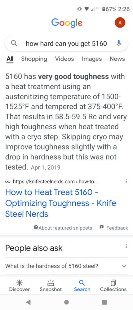

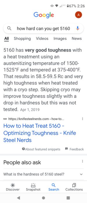

The trick is also to temper the back of the blade and not the edge. Tempering takes very little heat compared to the temperature needed to "set" the grain for hardening.
Leaves are 5160 steel.
