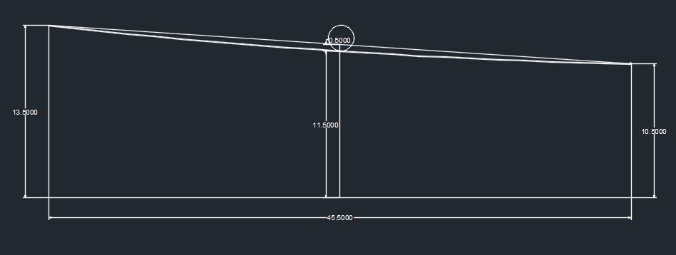

front axle - from rear chassis bolt to front upper shackle mount bolt - if you pulled a string between those two points whats the distance to center of the axle.
gotcha thx

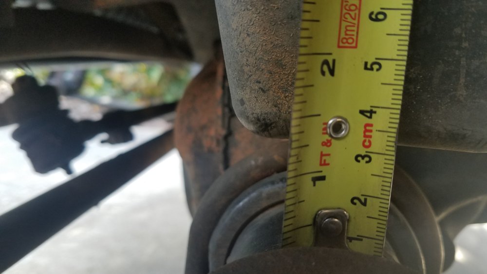

From centerline of bolt to centerline, a straight line the bottom of the axle rests just 1/2" above that line. But mine may be a bad example as the springs have settled. Apparently there is supposed to be 2" between top of axle and bottom of bump
bottom of axle or top of axle???
Sorry, did a little sketch to help understand my retarded measuring
Straight line between bolts, arc of spring, .5" between those two points
