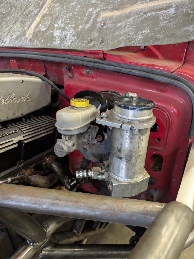

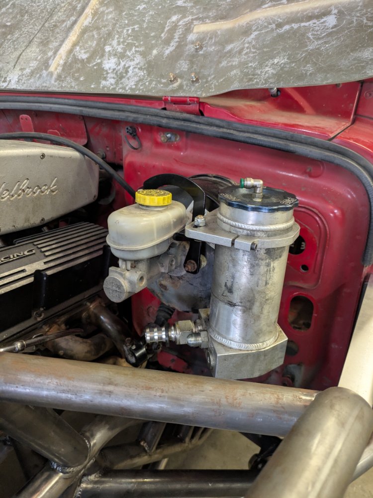

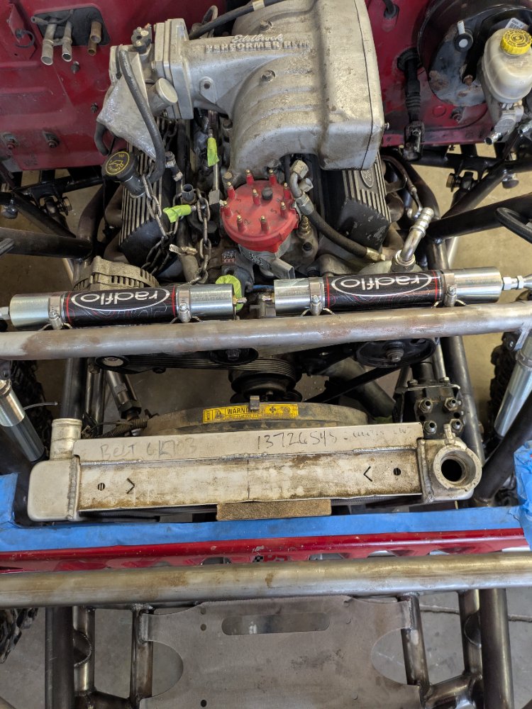

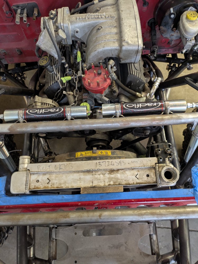

The filler neck on my radiator hits the hood. But luckily Ujoint Offroad is right down the road and they have some very talented aluminum welders. They're gonna move the filler down the side tank so it's the same height as the top. Adding a bleed port up top too.
