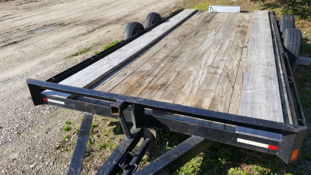

Can I see some pictures of winches on a regular tag along trailer for some mounting ideas?
I don't have any pictures, but on my last car trailer I put the winch in a mounting plate and bolted it directly down to the floor on the front of the trailer. Under the floor I used a piece of steel or another mounting plate to distribute the load. But that was because my deck was wood.

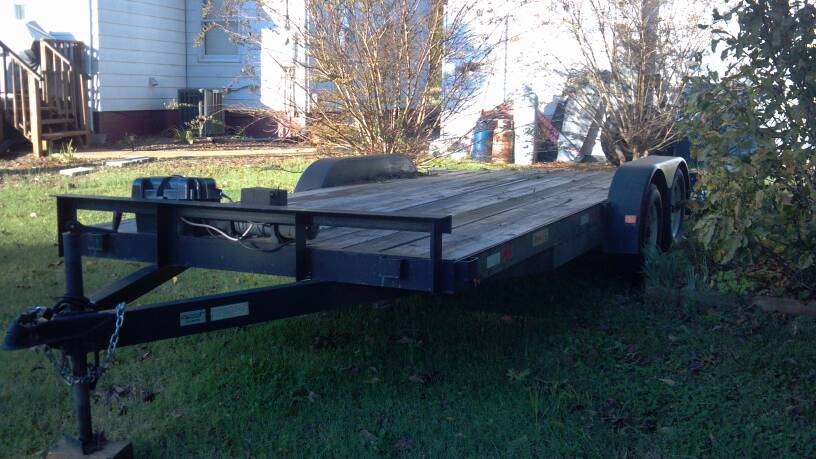

Edit: Here's the pic I have showing location.

Did you "sandwich" the wood between the winch mounting plate and the plate under the floor, and bolt the two plates together? Was thinking of doing the same on my trailer (with a wood deck) but didn't know if that would provide sufficient strength. Didn't want to rip the floor apart when I had to winch something on to the trailer.
Yeah, sandwich the wood & floor braces between the plates. It was also directly next to front plate/crossmember on the trailer.

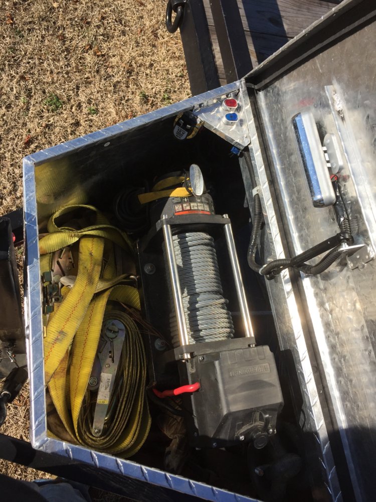

Here is the mount for my winch. My winch is an old used warn 12k lbs unit bolted to a 8 inch wide piece of 3/8 channel with 2" tall sides.
Also have a spare battery strapped to the channel.
Welded the channel to a receiver hitch so I can use it anywhere.
Can make several pulls on a charged battery, and usually just run my big jumper cables to my truck.
