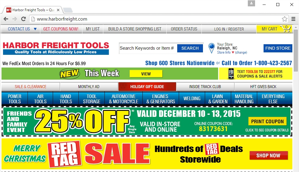

FYI - HF just dropped out a 25% off coupon...
Where would I find that coupon?
