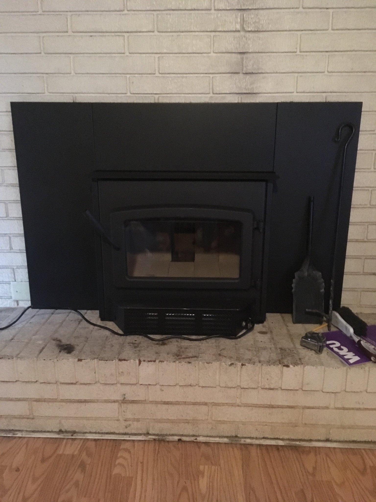

So I’m gonna update this. I turned the “credit” in and got the stove from northern tool. Installed it today with a new stove liner as well.
First impression is it’s a well built stove. All the welds looked good and without the fire bricks and front door it’s over 350lbs. The fire box is smaller on my old stove and my dads newer Appalachain but it was also 1500 cheaper so I can deal with a smaller fire box. Over all fit and finish was good. Haven’t built a fire in it yet but so far It looks like it will do a good job.

This one has a double liner that runs threw the old chimney. I know it’s a cheap stove but I don’t plan on staying in this for more than 4-5 years. I didn’t want to go with the top of the line stove and then leave it when I move.

It’s going 24/7 for about a week now, I’m able to go home at lunch and put more wood in.
Got the house to hot last Saturday hall said 75 so in living room area was 80+
Still would recommend a higher end stove like the Appalachain if you plan to be there a while. My dads just seems to operate better and heat better with a smaller fire.
