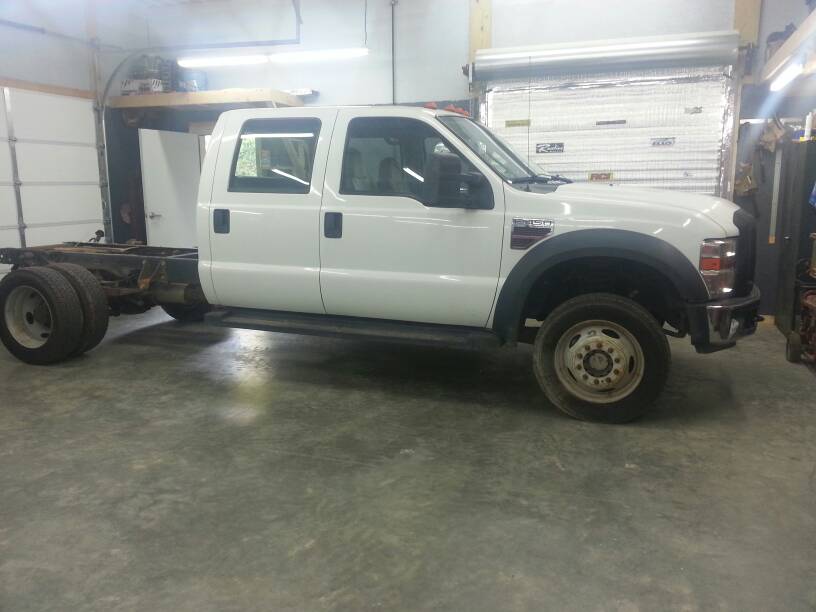

Platform- '08 f450 c&c, 6.4, 200k powrstroke, 4x4, auto, 19.5" wheels, and a purpose built flatbed, base model interior.
Plan- initially i had considered doing a crd 24 valve cummins. Through research I determined it not to be a cost worthy approach. So after talking to reputable diesel engine builders and aftermarket support manufacturers, I decided to use the 6.4.

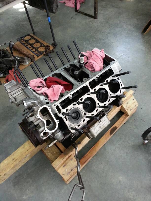

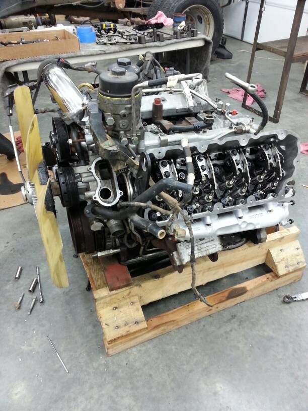

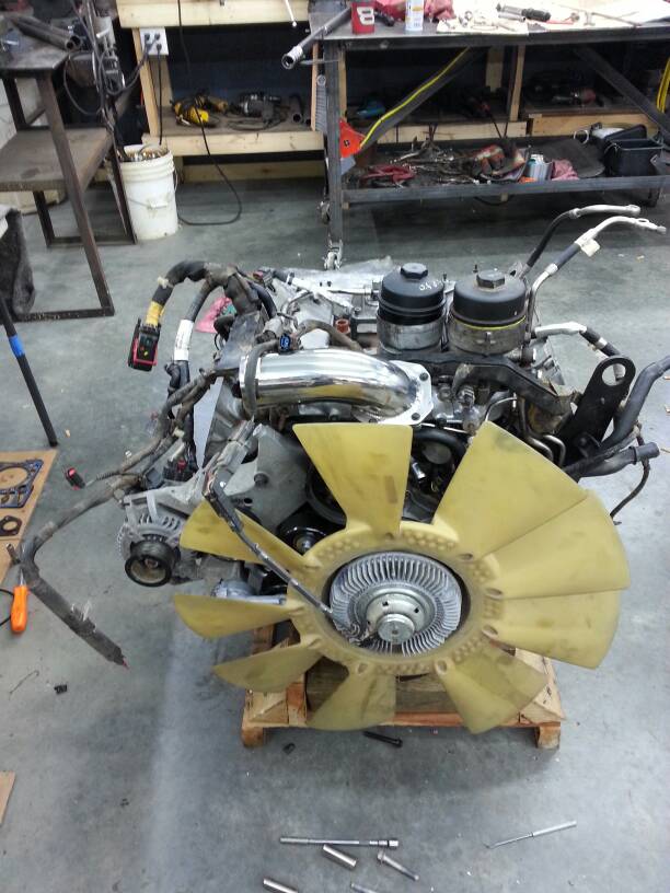

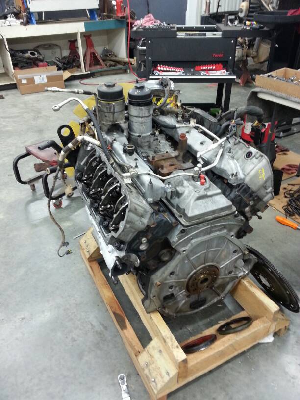

Engine build plan- I purchased a low mileage motor, 90k- for a song. Bad news is it had fuel delivery issues- no surprise there. Motor currently in truck had 200k and lifter issues.

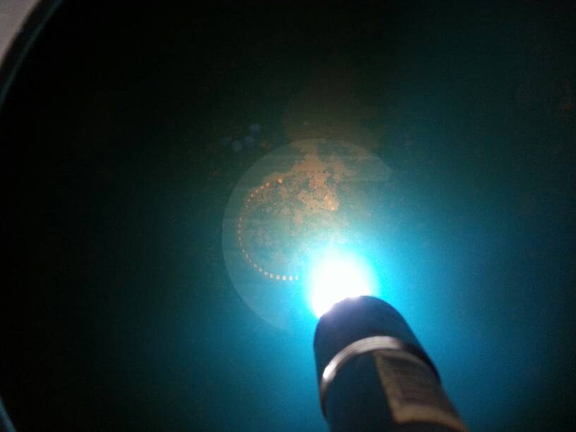

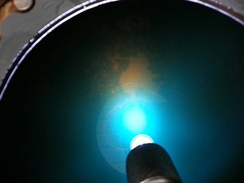

Bottom end on replacement motor is strong , good cross hatch on all cylinder walls, and tight crank.

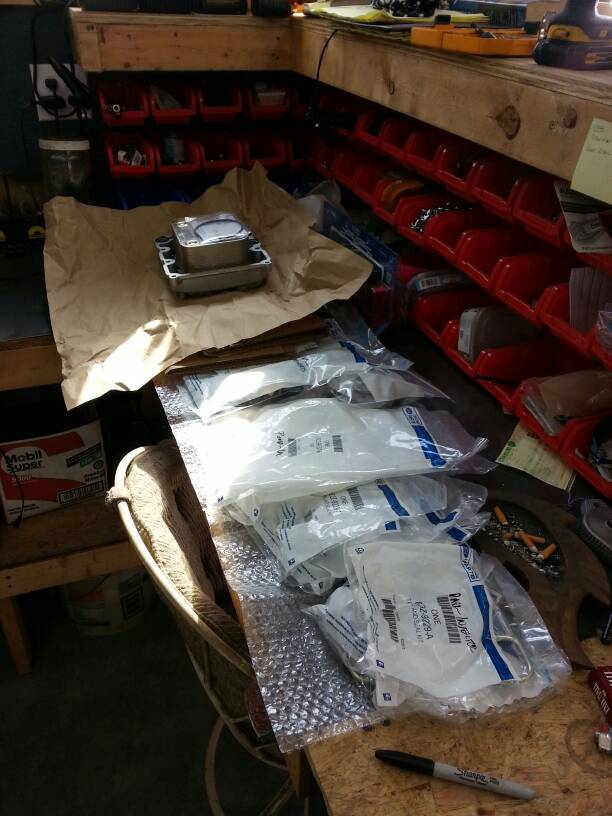

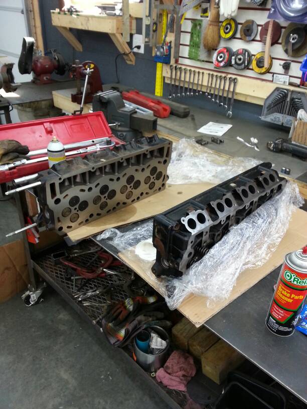

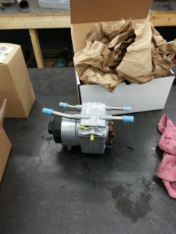

New Parts list for newer motor-
Arp head studs, gaskets, lifters, rockers, push rods, hpfp, all fuel lines, upper gasket set, hd up pipes, oil cooler, water pump, tstats, belts, idlers, radiator hoses, lift pump, rear main, cold air charge tube, intercooler boots, s&b intake, dpf delete pipe & egr delete, h&s mini maxx race tuner. Not trying to build a hot rod but a long term dependable truck.

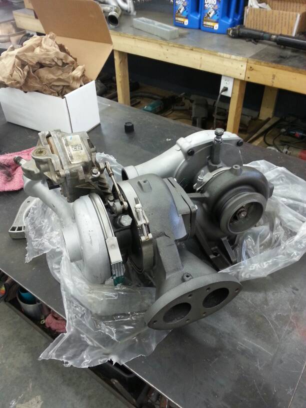

Rebuilt parts- both turbos, injectors, steam cleaned intake, heads fluxed and resurfaced, cleaned intercooler and hot side tube, relined fuel tank.
Fabricated parts- flat bed with trick removable metal side boards and tailgate, class 5 hitch, led lighting in tail and headache rack.
This is not a trick fab build so much as just sharing what I'm working on.
Few pics

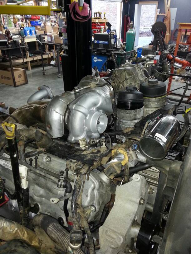

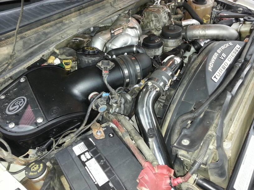

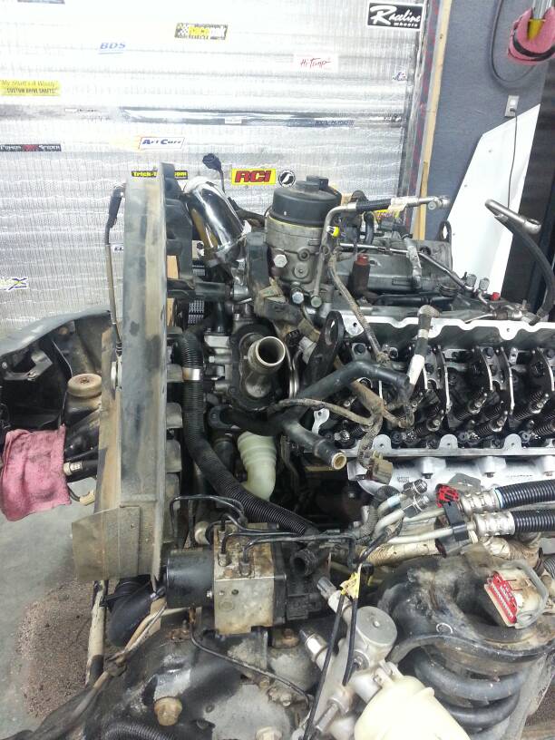

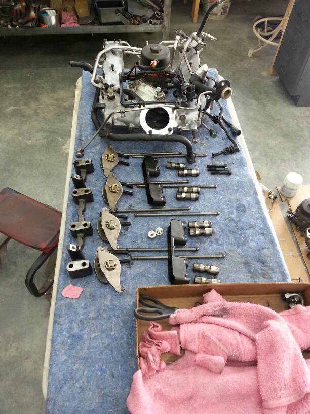

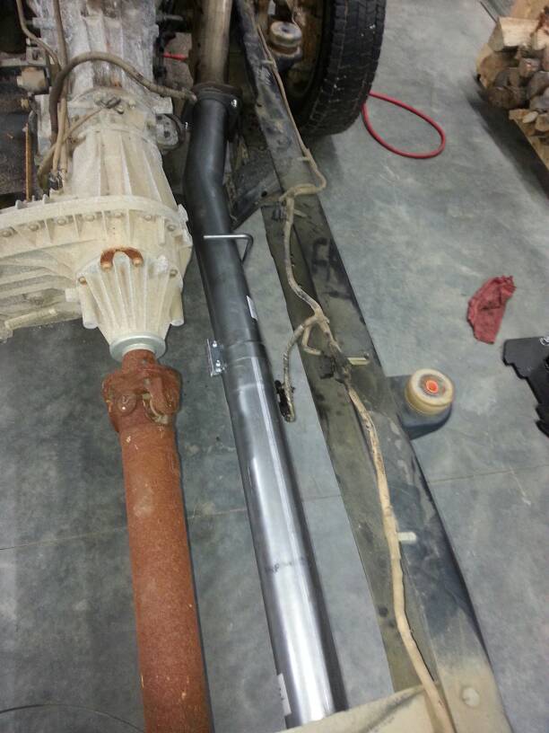

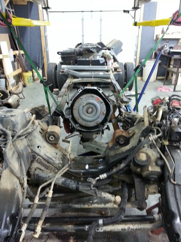

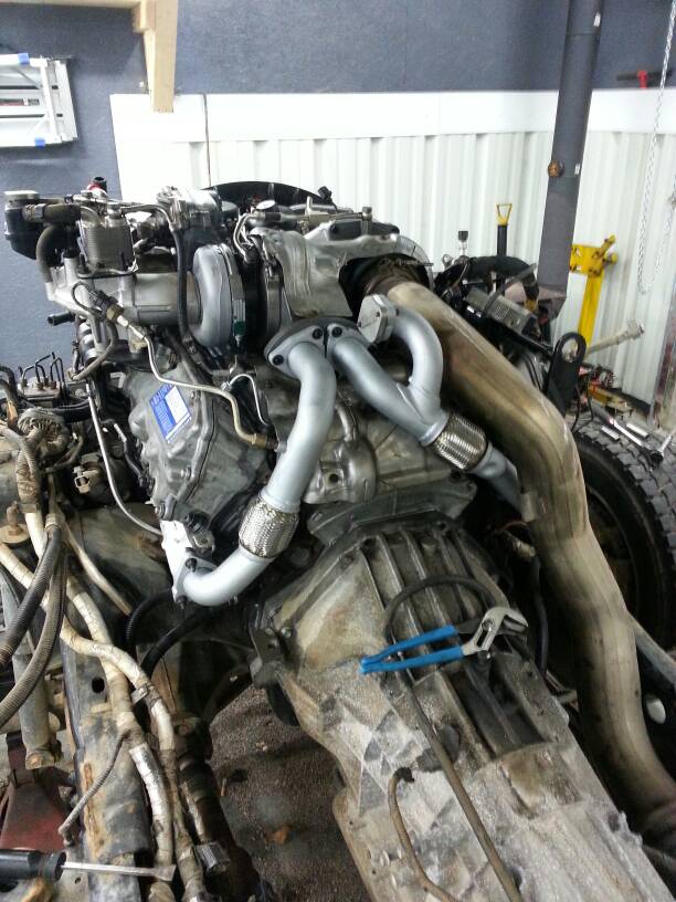

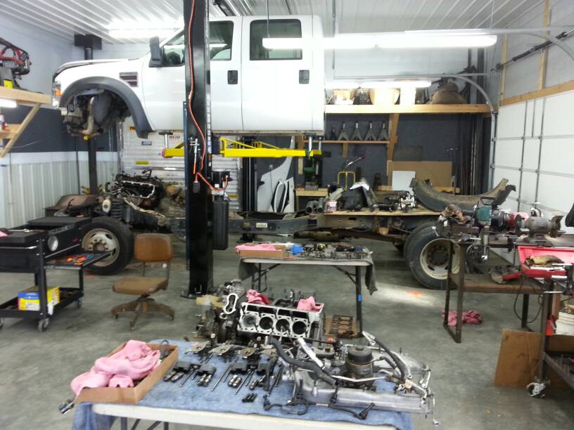

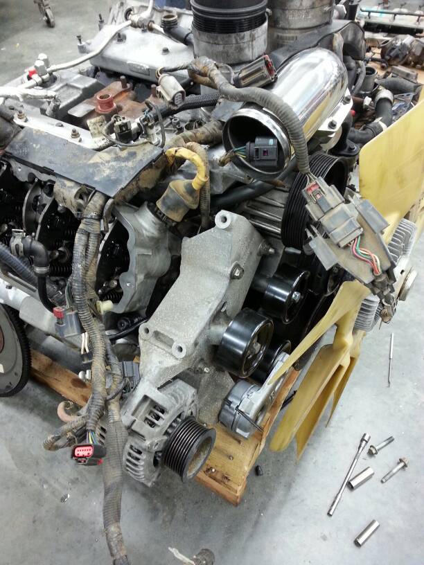

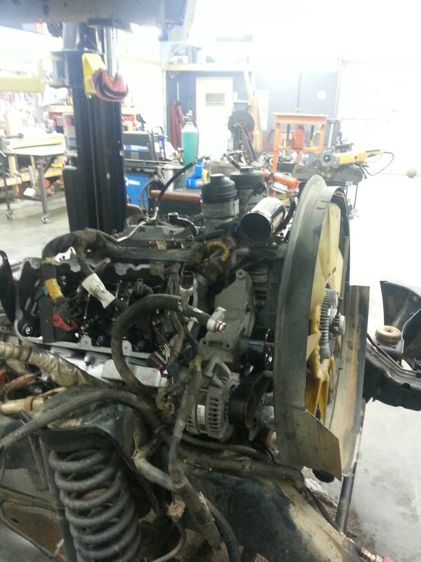

Made good progress last few days. Finished the head studs and gasket install. Installed the glow plugs, lifters, rockers and set lash, intake, hpfp, oil cooler, rear main, idlers and accessories, water pump and clutch fan, exh manifolds. Amidst all that I did the egr deletes and installed the flo pro intake horn. Basically everything torqued and ready sans turbos, injectors, and related pieces. Pick up the turbos and injectors from rebuilders on Wed.

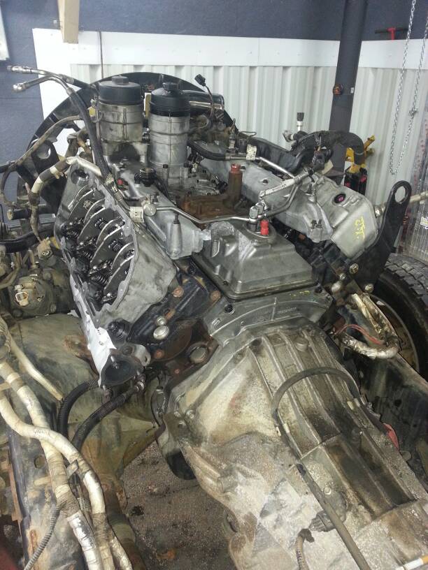

I also got the old motor out of the chassis. (Quite a task by myself). The torque converter bolts are a royal pain in the ass. Tomorrow I will place the fresh engine in the chassis and get it hooked up as far as I can.
Few pics;
I realize is not an insanely interesting build, and I was very intimidated when I decided to tackle this on my own, but with extensive research and my right hand man, ( my smart phone and pdf downloads of service manuals etc) it's actually turning out to be quite fun. ..... But wouldn't want to do it for a living.
Motor Inn its final place. Everything complete that can be until I pick up turbos, injectors, and lift pump in the a.m. Hopefully bringing the cab back down tomorrow. Then pull sending unit to inspect the tank liner and possibly replace if needed- before I start building the bed. Supposedly the biodiesel additives in today's pump diesel is a no go for previous years liners.

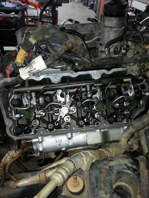

Will be dropping the cab back down on my next shop workday. Finished the motor today, all components and wiring. Picked up the turbos and injectors this morning, got back to shop about 2 and was in the recliner by 6...
There's a whole lot of shit going on under these valve covers. ..

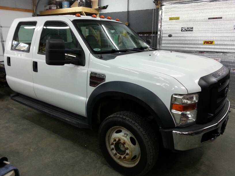

And here's a pic of the truck right after I purchased it. Cranked and ran but had a horrible lifter chirp. 200k on the ticker.

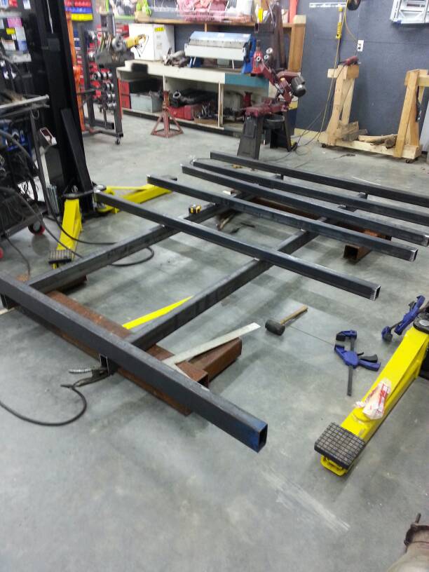

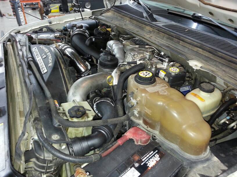

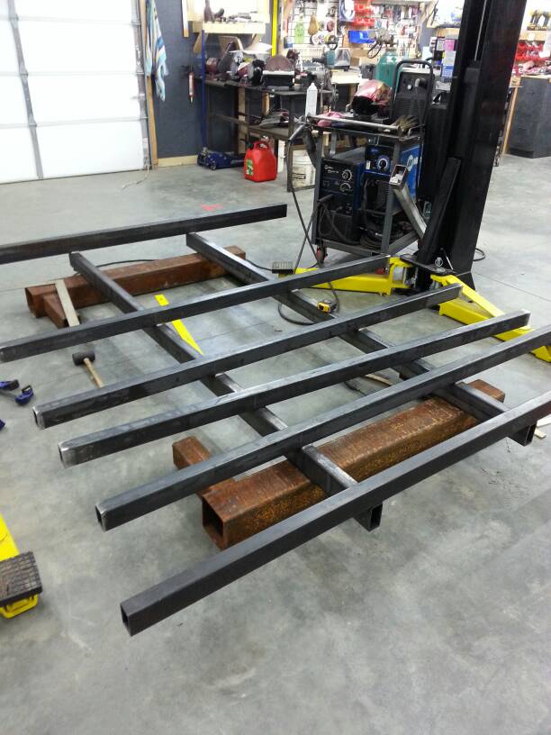

Motor is in and been running almost a week now. Substantial difference over my deleted, h&s tuned 08 cclb dmax. Much quicker spool and acceleration; ala 4.30 rearend and twin turbos. Began fabbing the flatbed today as well.
All waxed and cleaned up
should have framework close to complete tomorrow.
