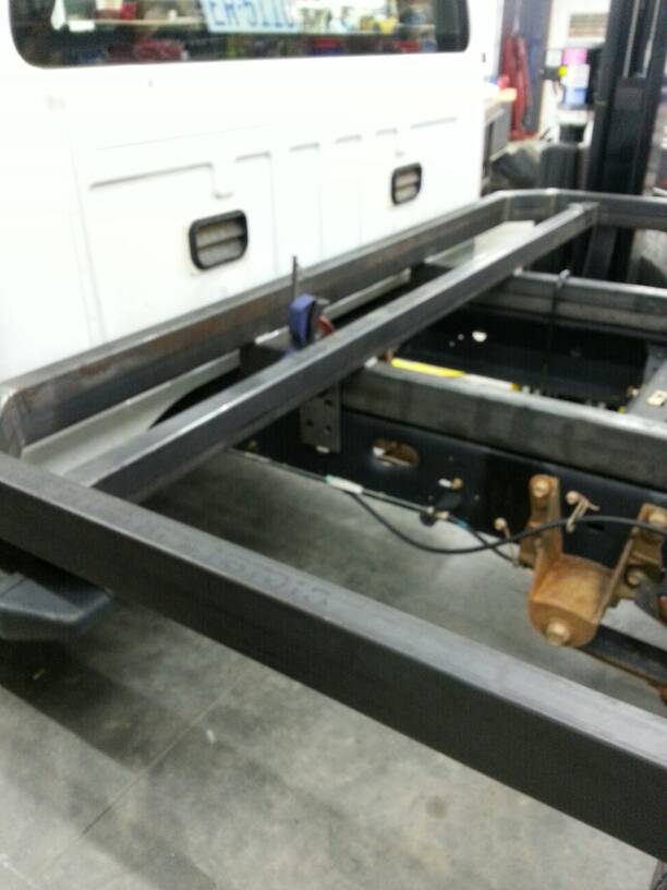

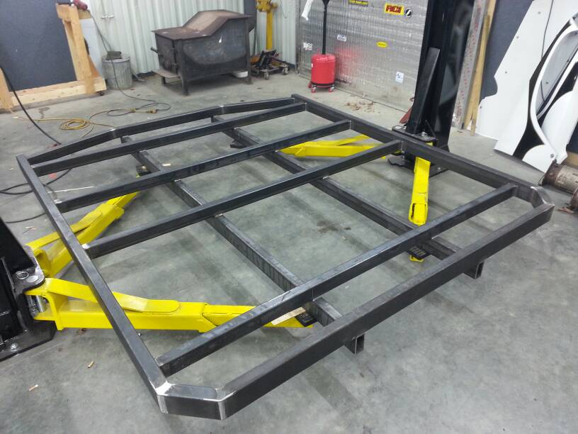

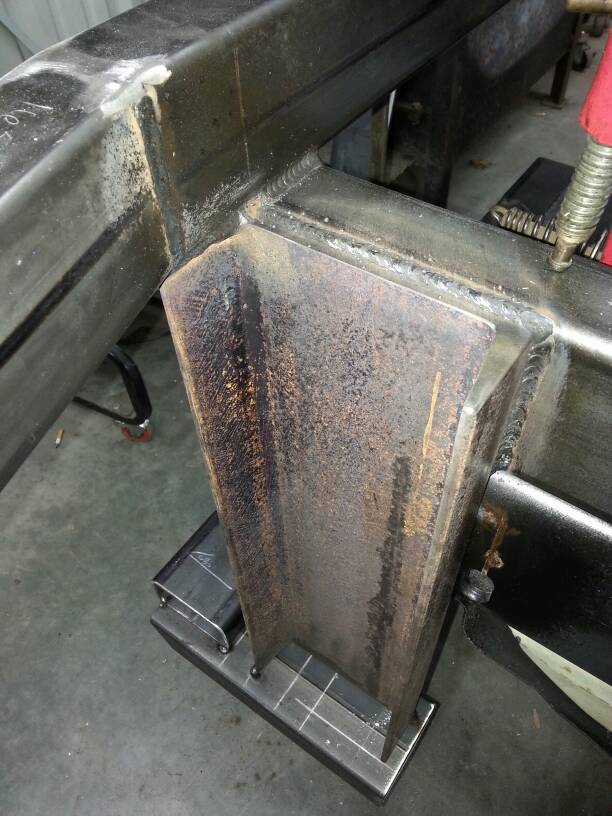

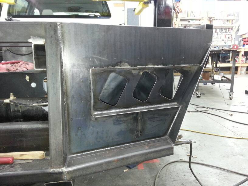

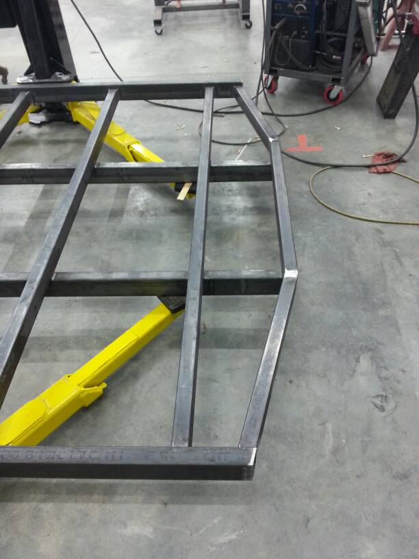

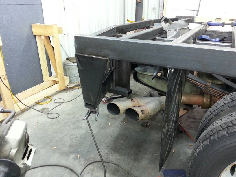

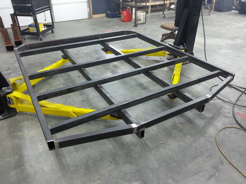

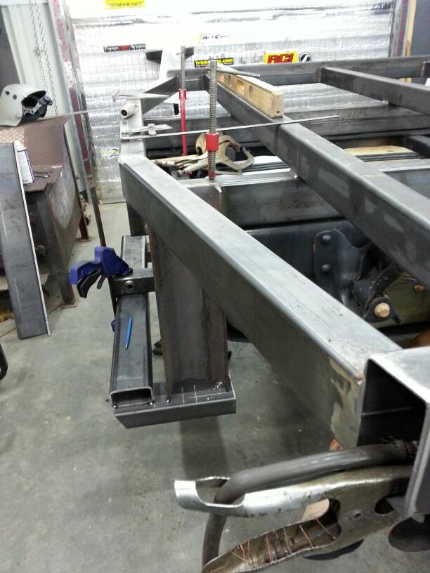

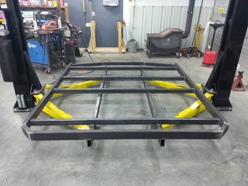

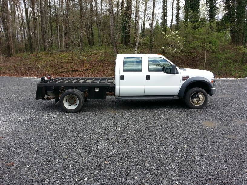

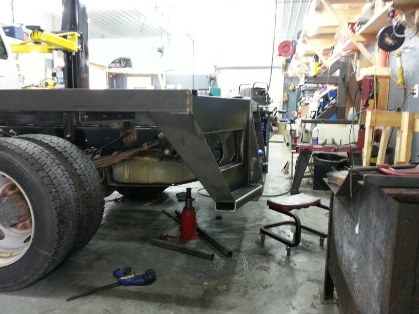

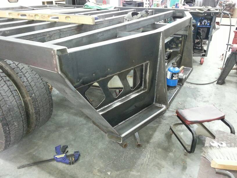

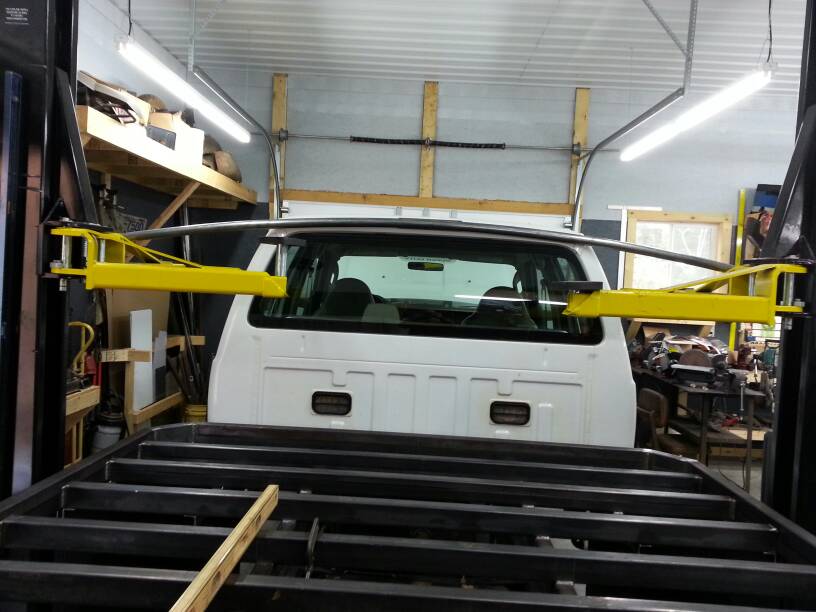

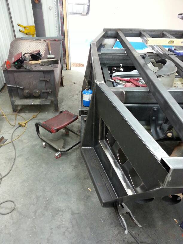

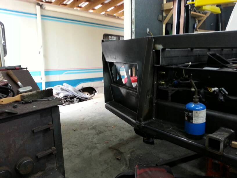

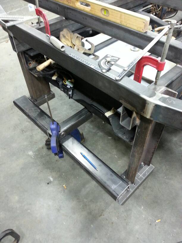

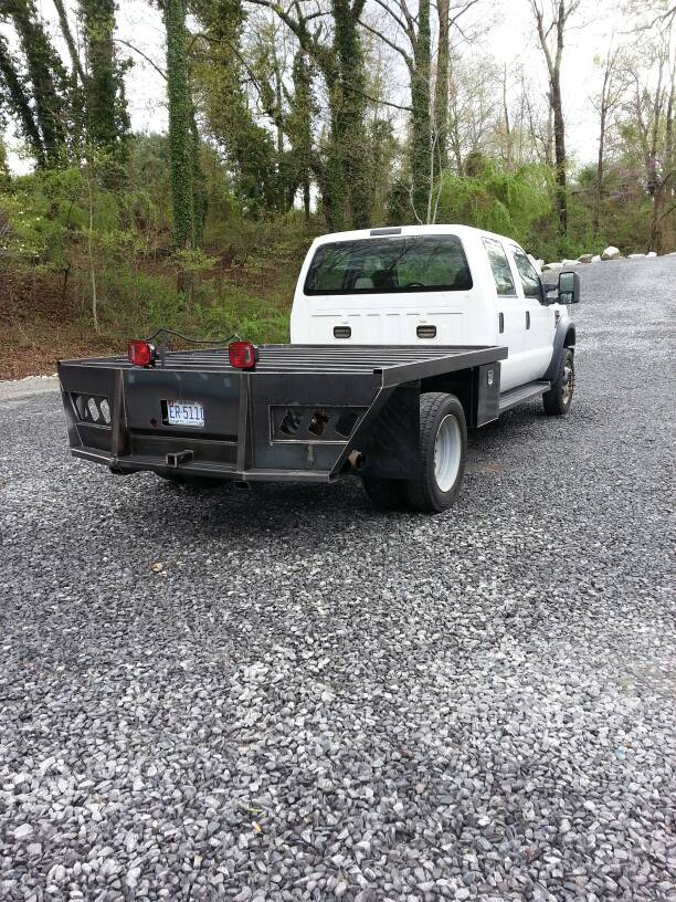

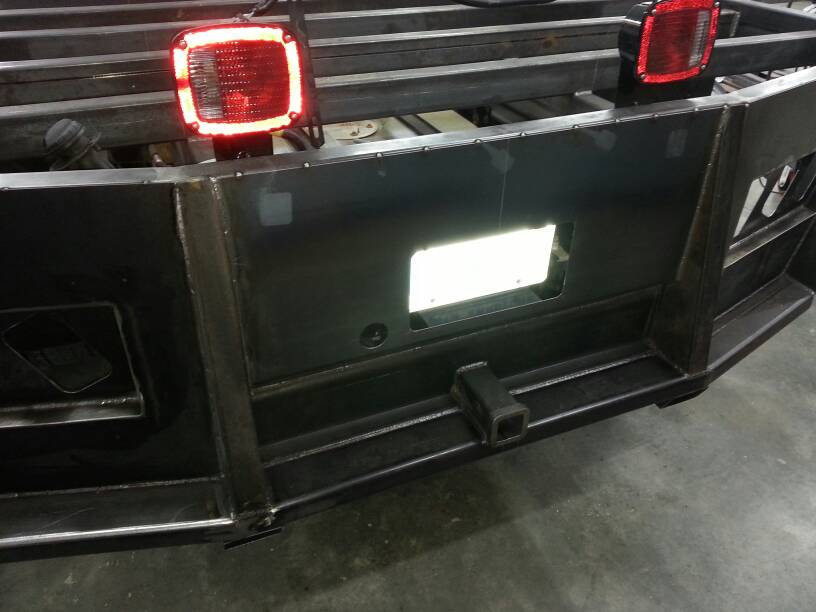

I'm short 3 cross beams but the basic frame work is done, minus the underside welding. I'll do that at the same time I stitch the floor in.
Overall dimensions are 9'at the longest and 8'3"at the shortest length. Width is 94" (just a tick more than outside of tires) with rub rails still to come.

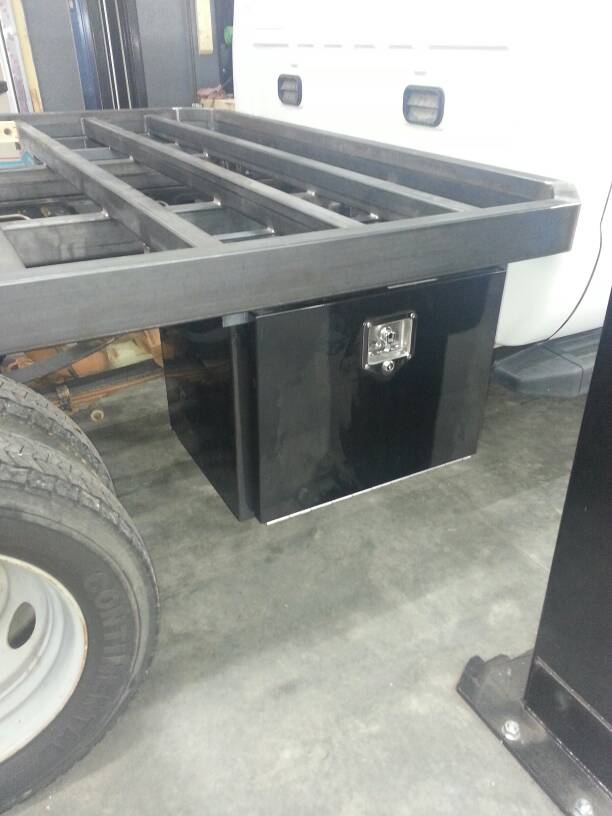

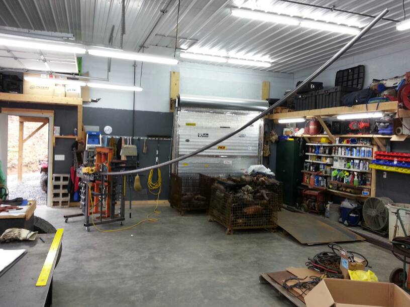

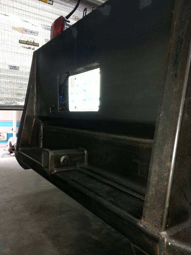

Will be adding a double tube headache rack and removable tube side rails. There will be 1 (each side) 18" under bed boxes at cab.
All my lights are here as well. Entire system is led. I'm taking the vision x spots off my buggy to use as work lights in headache rack. Also purchased a 20" light bar from Rides for the front bumper. (Will buy another single bar for buggy also. )
few pics

Sweet I just bought a 99 f550 6spd, pretty low mileage but been sitting since '10 so I was gonna check the tank out when I get the service bed off. May end up building a flat bed like yours vs buying one. What size steel did you use?
I got lucky with having the 4.30 limited slip Dana 110 rear. I hope you got the 4.30 gear and not 4.88. Talked to a guy today with the tall gears, 6 spd, 7.3....2600 revs at 70mph. I'm going to go up a tire size (from 225/70 to 245/70-gain just over and inch) to have an effective ratio of 4.10.
The main rails, head, and siderails are 2x4x.188. Crosses and tail are 2x3x.125. Intend to use .125 tread plate and crosses will be 12" on center. Have a few tricks up my sleeve for headache rack, rails and spare mount as well.

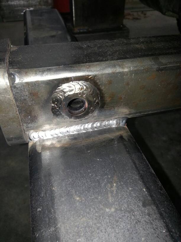

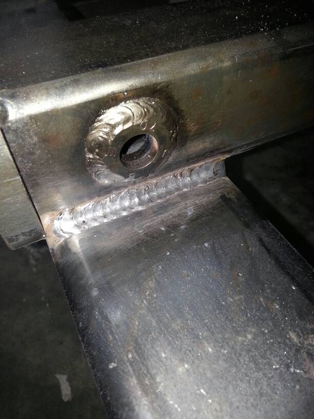

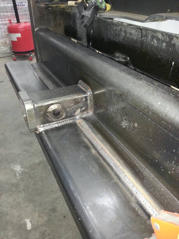

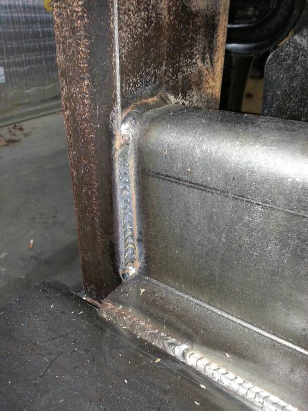

Those welds will never hold up. The design just absolutely sucks. Are you serious? why do you put this crap on here?
But since you are a good friend, I will give you $.10 a pound above scrap, and get it out of your way!
Yeah I know, what am I smoking?
