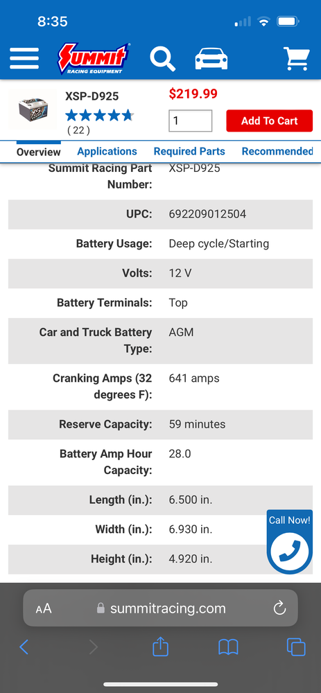

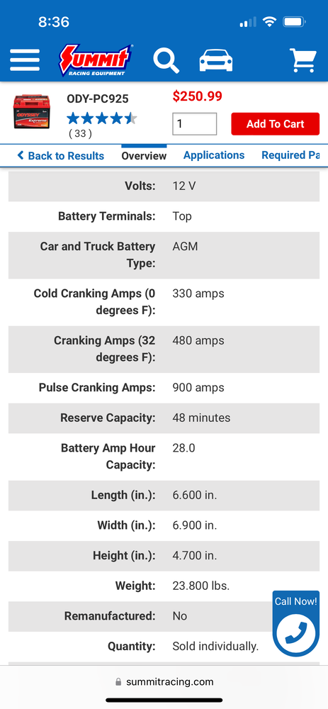

I know it’s not the battery’s fault. I’m not looking to get away from Odyssey. I just found the same battery from XS power with a little better specs on CCA and reserve time and they’re a little bit cheaper than Odyssey. Just looking for some real world experience with them.

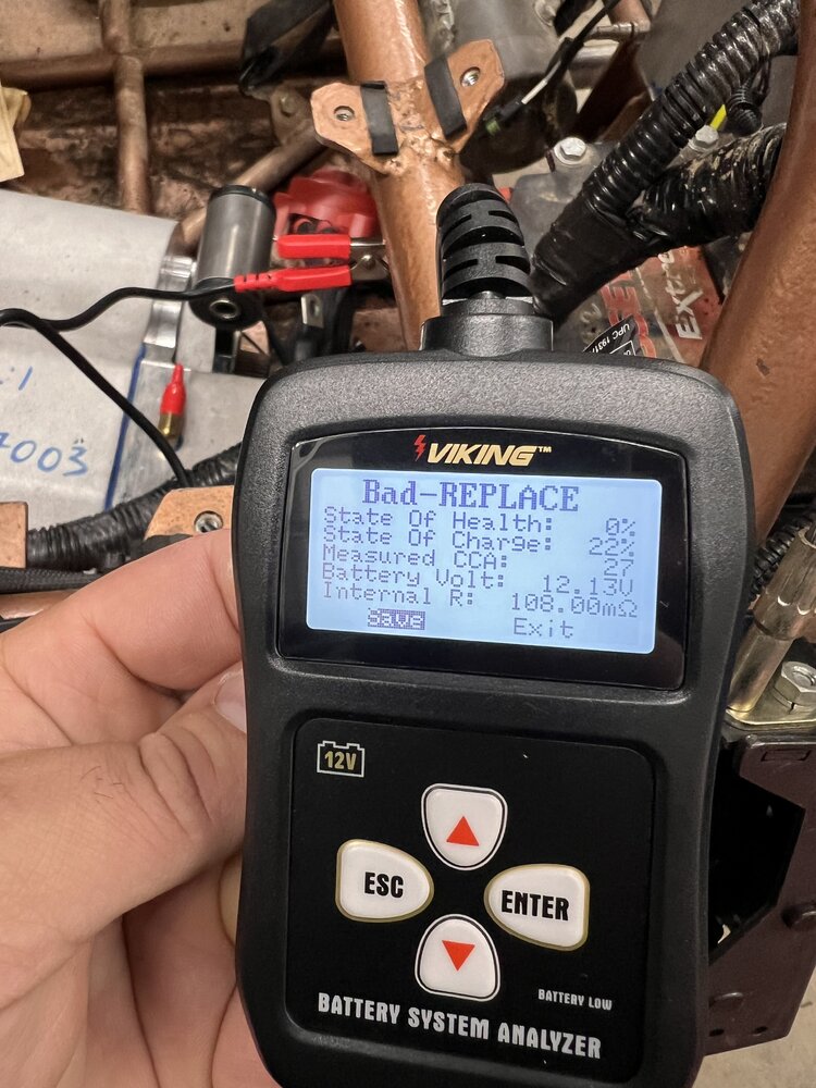

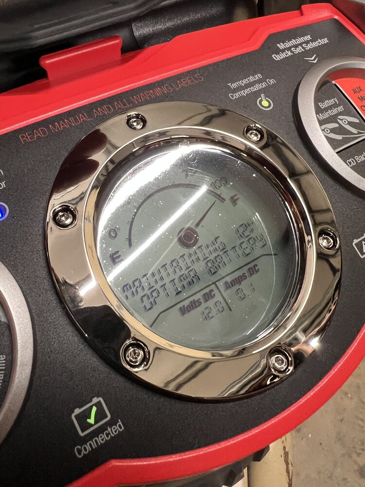

Well I hooked the Optima charger up to one of them this morning and it immediately went in to re-conditioning mode. I was just getting off work so I went to bed and let it charge. I checked it about 4:30 this evening and it was showing full charge and had switched into maintain mode. I hooked my battery tester up to it and it may have taken a charge, but I think it’s toast. I guess I can’t expect too much from a 8+ year old battery that has sat without a charger for 6 years. Being stupid tends to get expensive. :laughing:
I hooked the charger back up and left for work. I’ll check it again in the morning, but I don’t have much hope for it.
