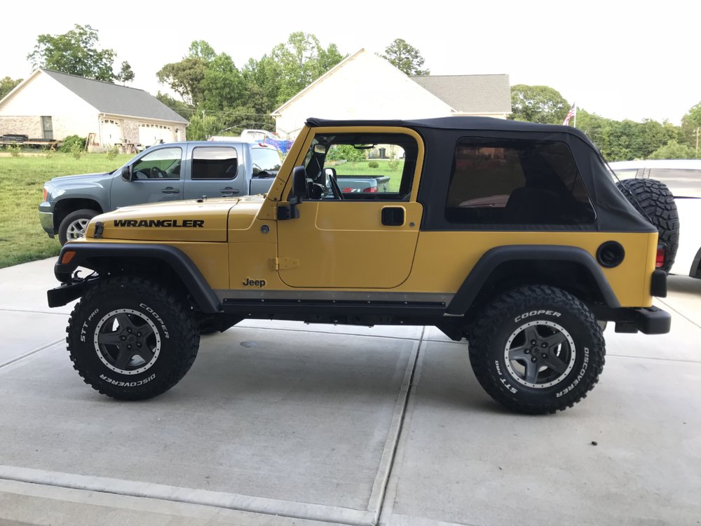

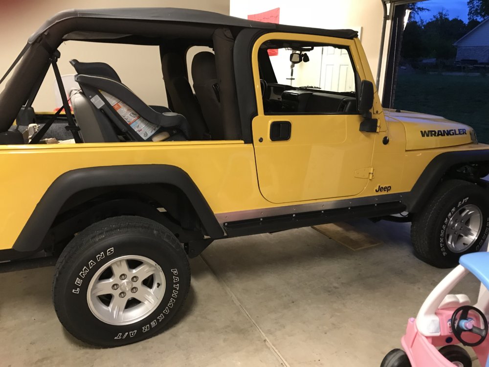

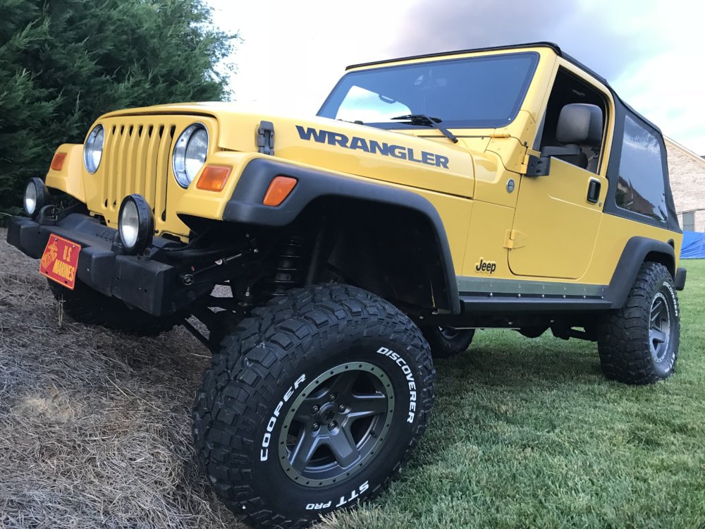

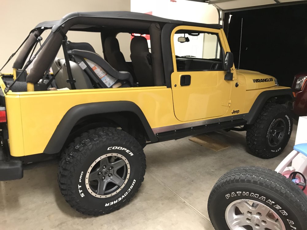

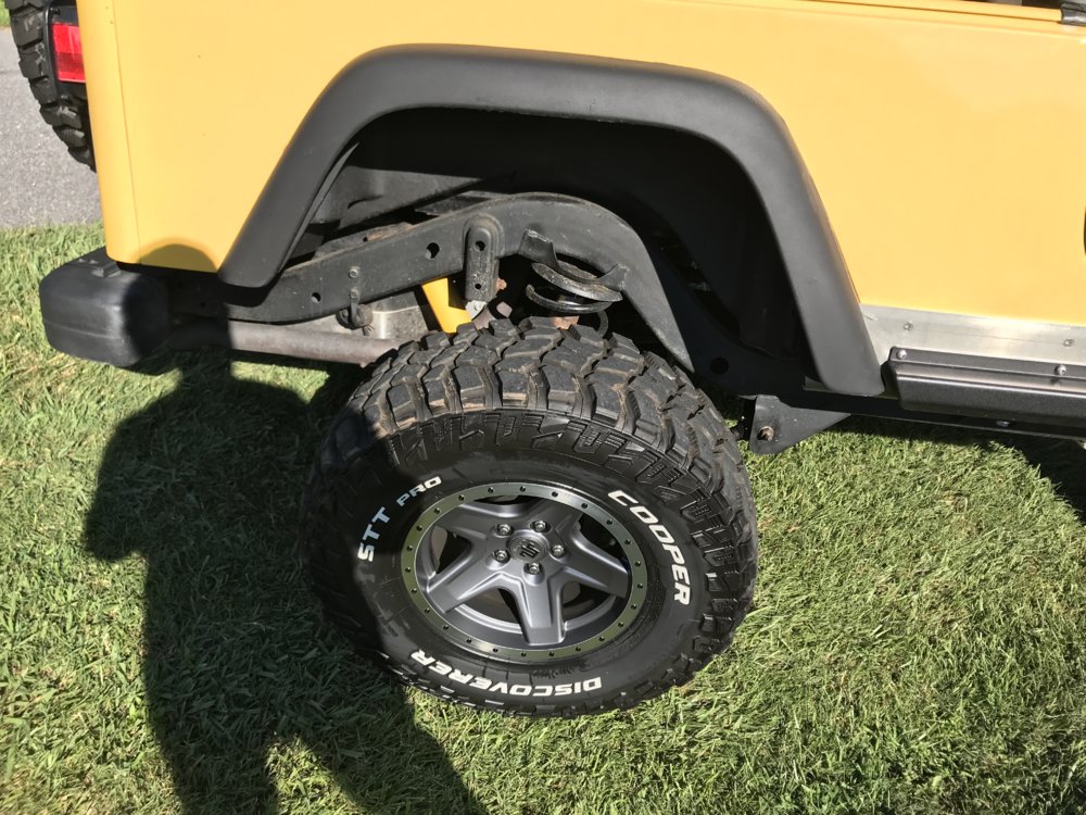

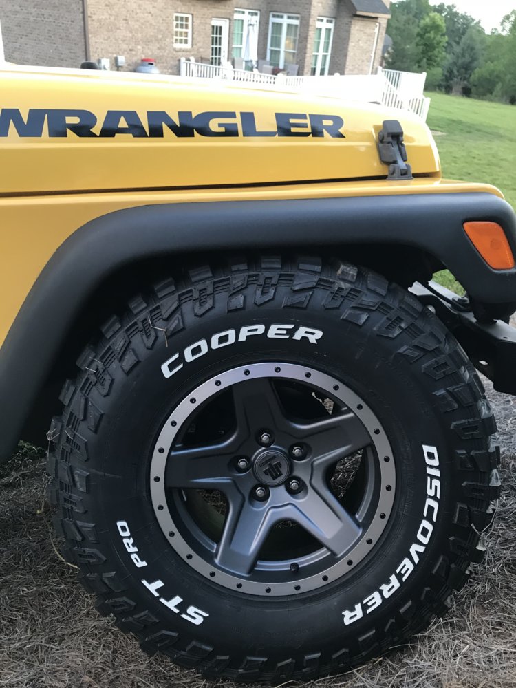

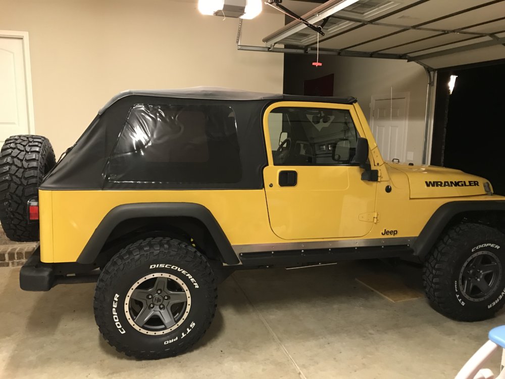

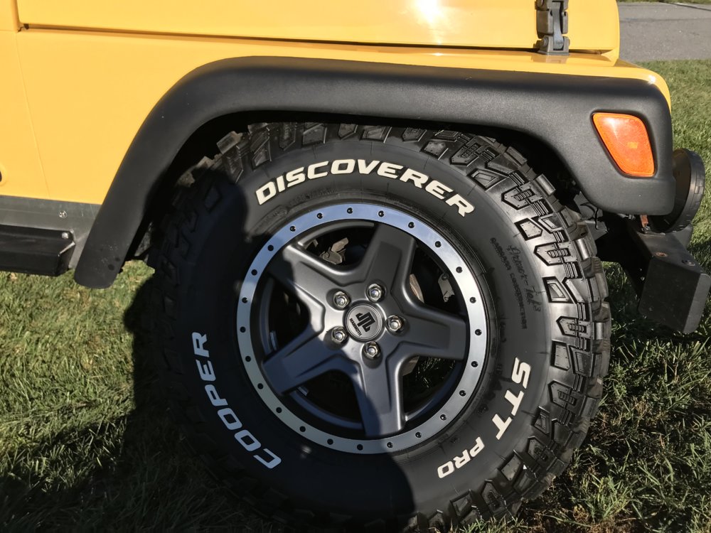

Got the tires mounted and balanced, one wheel needed 4 oz but the others were great! I’m hoping to get the tru-trac and 4:56 in the rear, install the 4:56 into the rubi axle then all that is left is the steering box skid, winch, and final wiring of the rubi pump! Looks like I may be done by mid June!!! Some before and after pics. Tires are 32.6 mounted with 29 psi... no rubing, bumpstops put the wheels about .25 to .5” from the fenders.

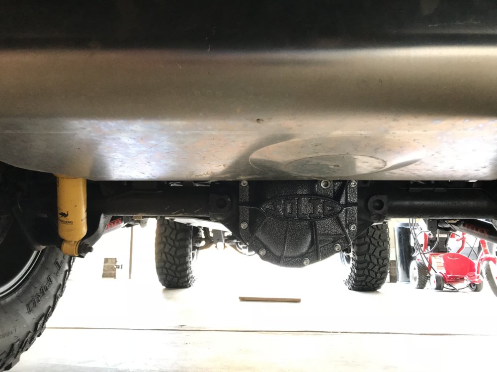

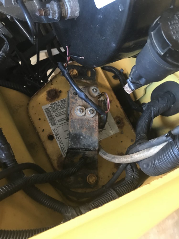

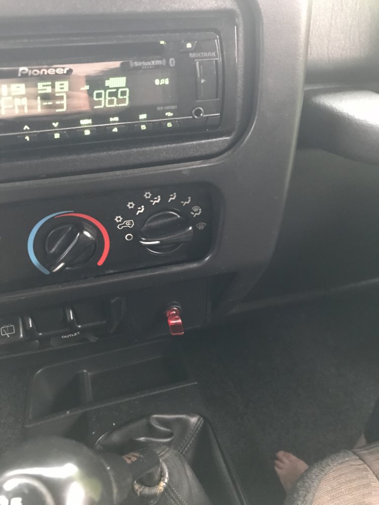

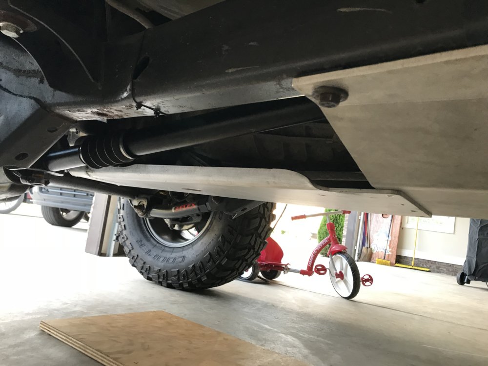

Rubi pump in and plumbed, just need to wire the switch. Also put in the steering skid...gears and Rubi axle goes in this week!!! (To terrified to re gear myself, so this will be outsourced..) also ordered warn vr winch, winch plate, and Speedo gear!

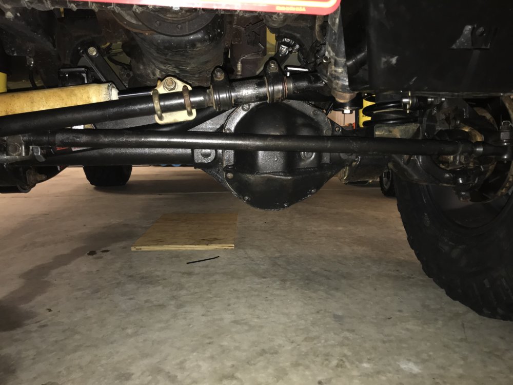

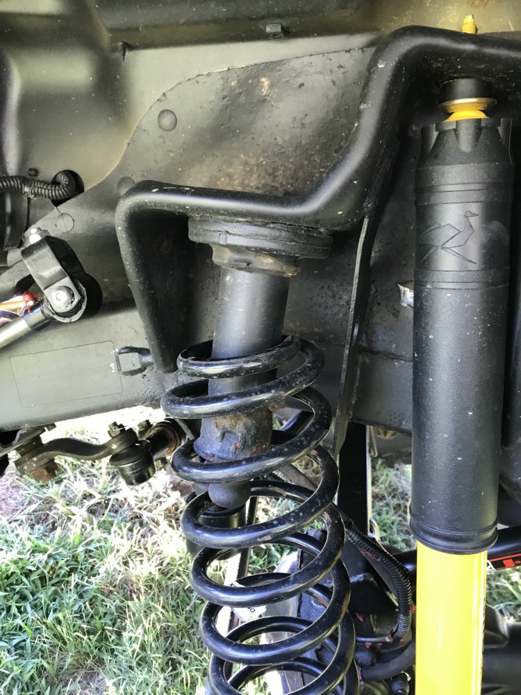

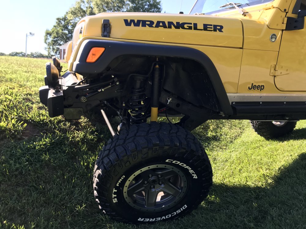

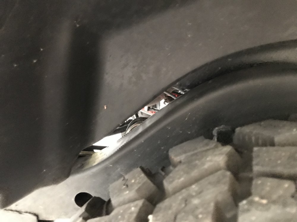

58C8B05F-778A-42CE-AAF0-2D1BA4048851.jpeg 80220BF7-5514-4CBE-B055-6DBBCCE567AA.jpeg 6CD48F67-E60A-4947-A2AA-0C1781CD3A57.jpeg 899B1290-F6F4-48C5-A41D-DFCBDCFF6900.jpeg Tested the flex, I need to lengthen the locker wires and the vent tube. I still have some more droop, not sure of how much but it’s pretty dang flexy!!!

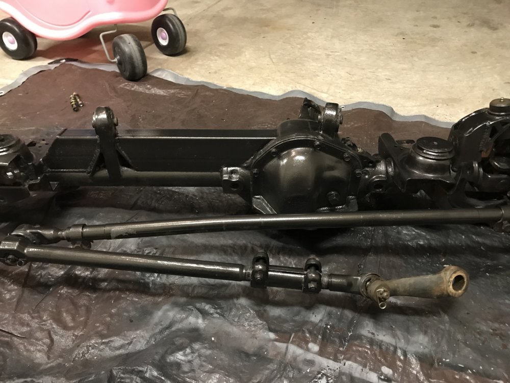

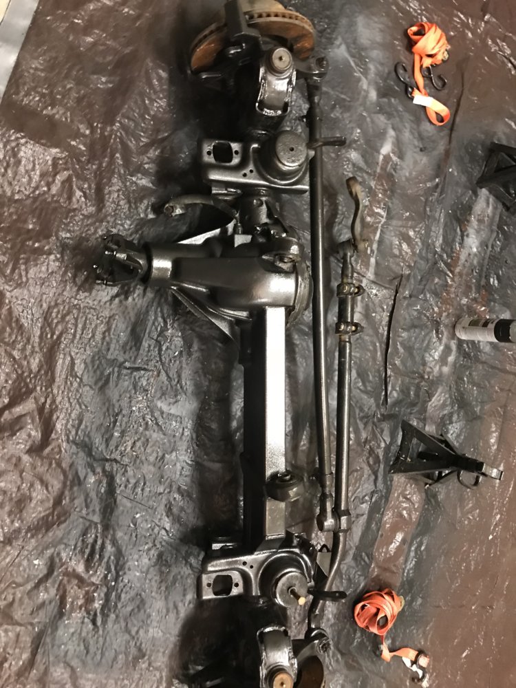

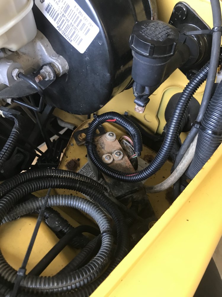

View attachment 267984 View attachment 267985 Tires and wheels finally ordered, got the Rubi 44 (gussed, sleeved, trussed, shafts, Currie 1 Ton etc.) which should be easily strong enough for the 33” tires. Went back and forth on gears and have decided 4:56. 4:88 will be to deep for my purpose. Checked the rubi pump and locker and all is well! Aim is to have tires and wheels mounted, axle in and geared by the first week in June...

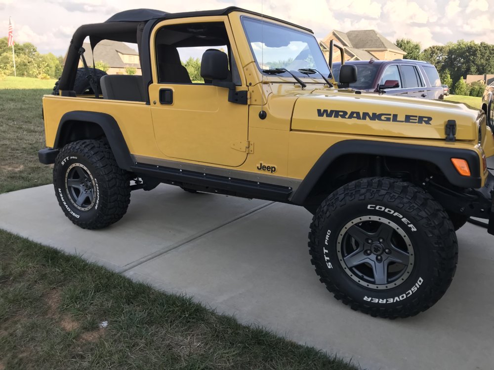

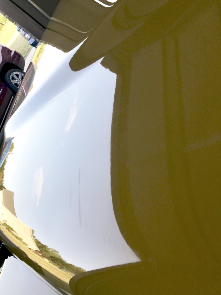

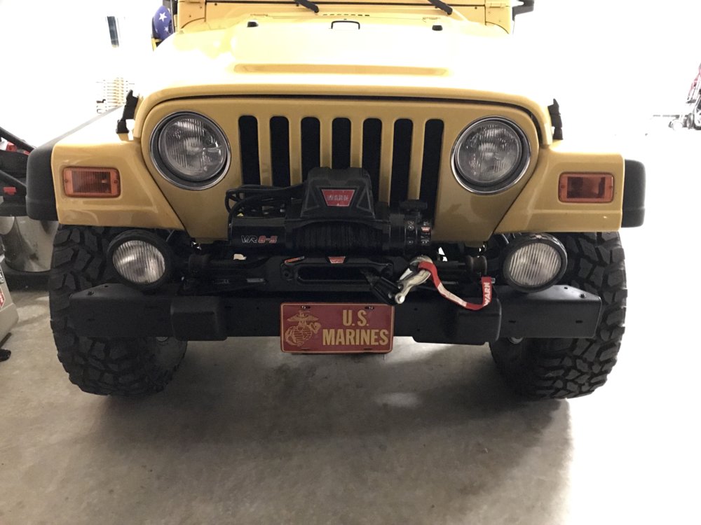

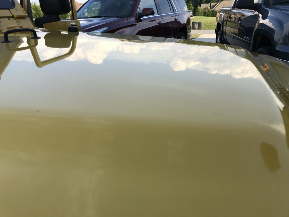

Finished compounding and polishing. Add a ceramic coat which was a nightmare to put on. Also got the winch mounted! Ready to wheel! She has to 4+ hour trips on her. Averaging around 15.5 with the cruise set at 70 and ac on. Not bad! Maybe I will sale her before she gets an trail rash......

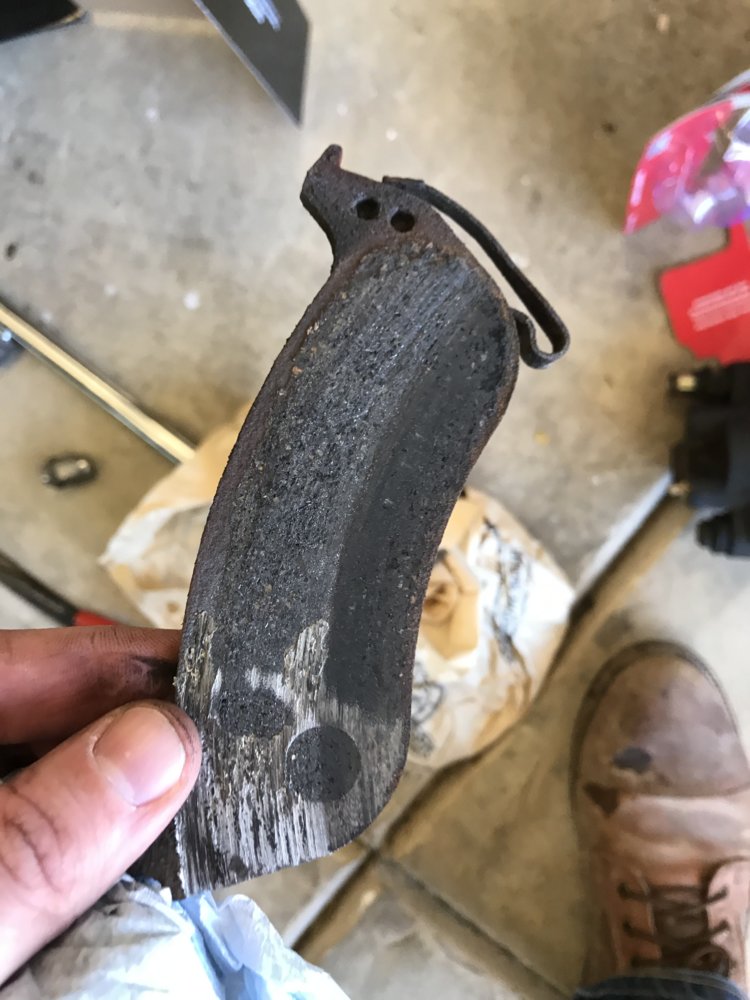

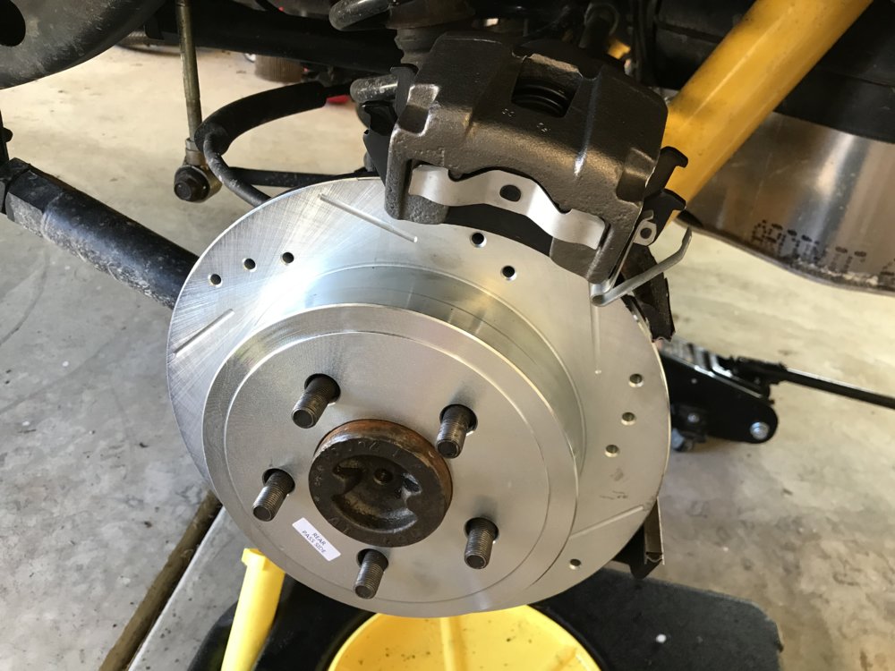

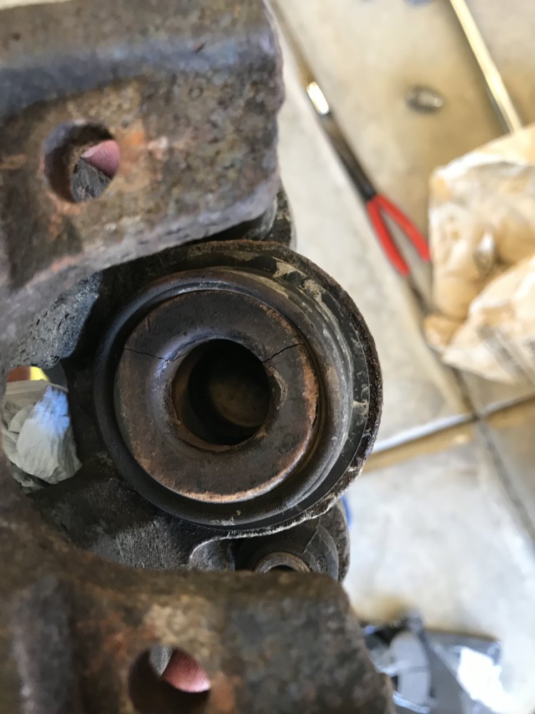

Went to ebc rotors and yellow stuff pads in the front and added powerstops to the rear after a left rear caliper seized....
