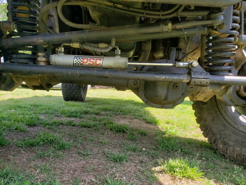

Here is how I did mine. This is with a wj knuckle swap and barnes 1 ton offset steering kit.
My track bar is still in the stock location so I am going to have to work around that. I also have a y-link style steering.
