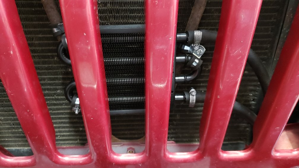

I'm putting a cooler in mine right now. $30 off of Summit.
A cooler makes all the difference and keeps things turning properly. Keith I thought you had the Iron Man Andy steering box brace? If you do, you have nothing to worry about. If you don't, spend the hydro money on that. Even without it you have the bumper that takes a lot of the force and protects it. I wheeled my XJ for years with only the bumper that stiffens the steering box, and all was good. Then I spent the $250 on the steering box brace and feel 100% confident I cannot rip that steering box off.
I agree with everyone above that you don't need hydro assist. Your tires, light foot, and the trails you usually hit you are in good shape. Even as you step up you'll be fine. My XJ has been all over places like Harlan and such without it. But I did have to add the cooler, which make a massive difference.
