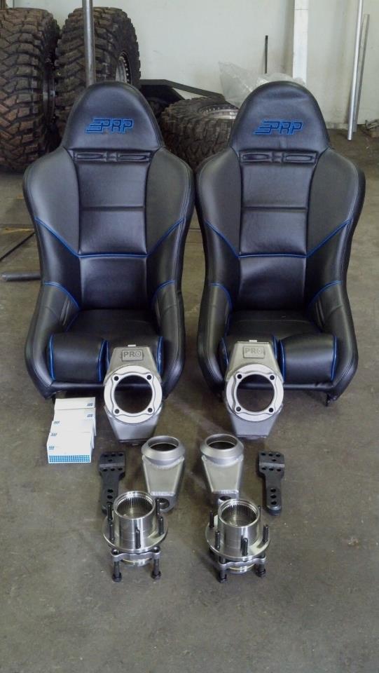

SpiderTrax Pro Knuckels with SpiderTrax Arms

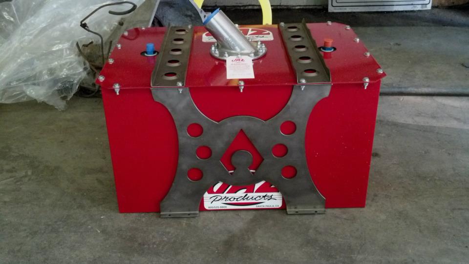

22 Gal Jaz Cell
PRP Podium Seats

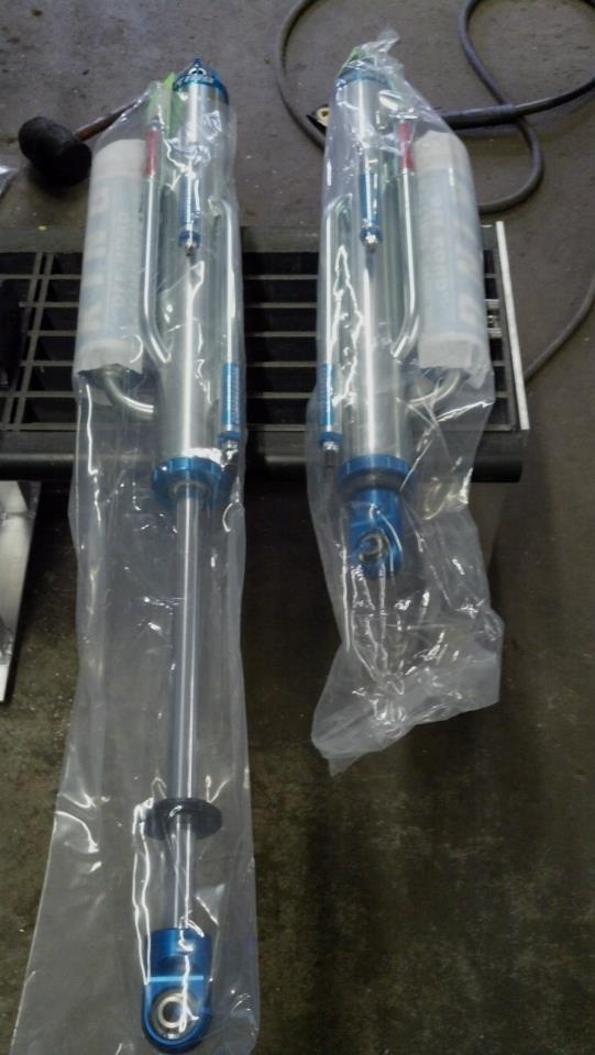

KING 16" 2.5 CO Front 18" Travel
Trailing Arm Rear with 2.5 16" KING CO and 14" KING 2.5 3 Bypass Shocks. 20" travel

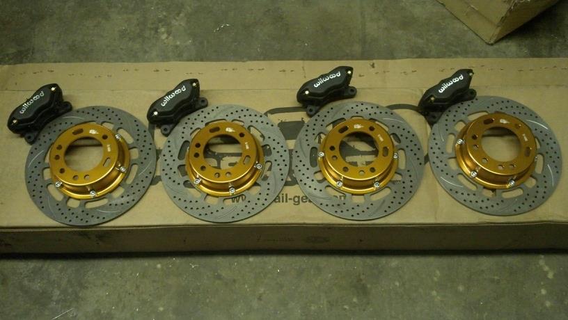

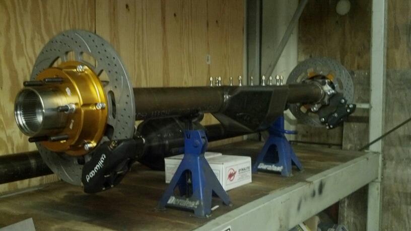

Trail Gear Brakes
TG Unit Hubs

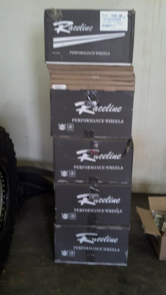

40" Maxxis Treps on Raceline Wheels

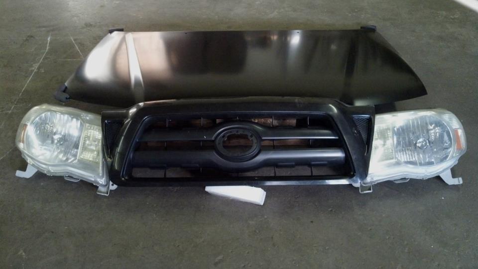

Our 2011 Tacoma Clip hope we can get this cut down and still look good.
Trail Gear Brake Setup Front & Rear
22 Jaz Cell with Artec Mount
TG Rear 65" WMS to WMS

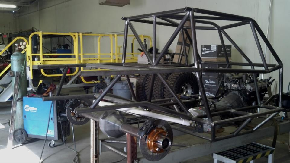

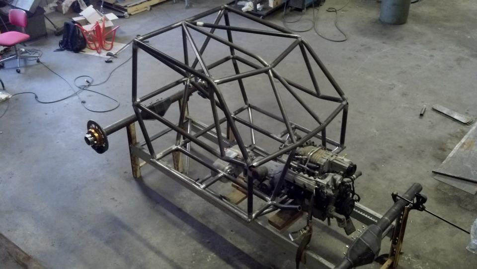

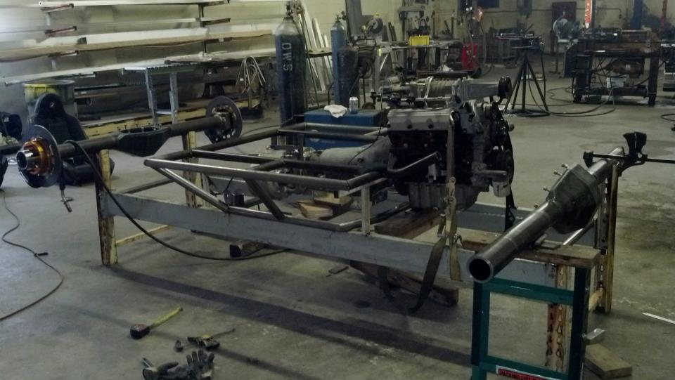

Our Sub frame is going to be very similar to the Miller build. My sub frame is probably deeper than most at 12", but wanted a higher capacity trans pan with the Atlas completler under a flat floor pan to keep interior as simple as possible.

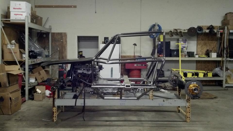

Some Chassis Specs are:
110" Wheelbase
19" Belly
10" Up travel Front & Rear
Main Chassis is 56" Outside of tube
A & B pillars are 54" Outside of tube
Top of Cage will be 75" with 4.5" of clearance with Helmet on.

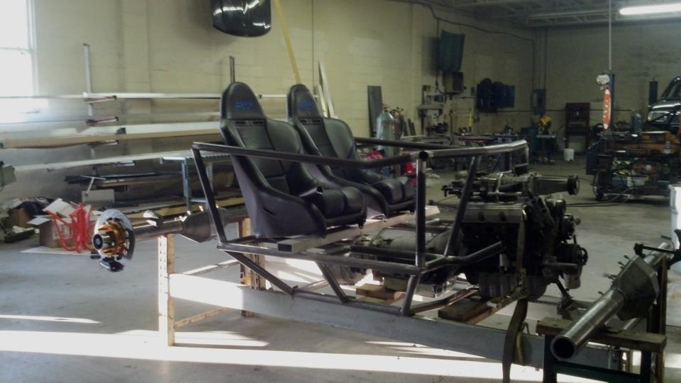

The build will not be a crazy 2 month build. Tommy and I are working on it about 10 - 15 hrs a week as of now, but as more parts show up and more time frees up hopefully that will change. MY goal is to have it complete in June with hopes to races the Ultra 4 @ Badlands June 23.

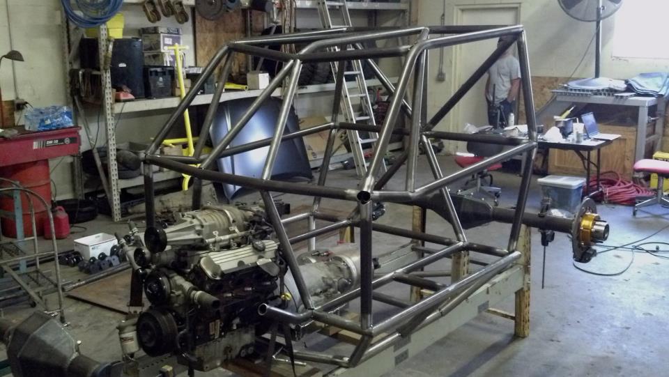

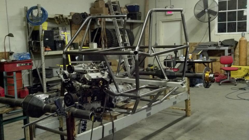

Got a couple hours in tonight.

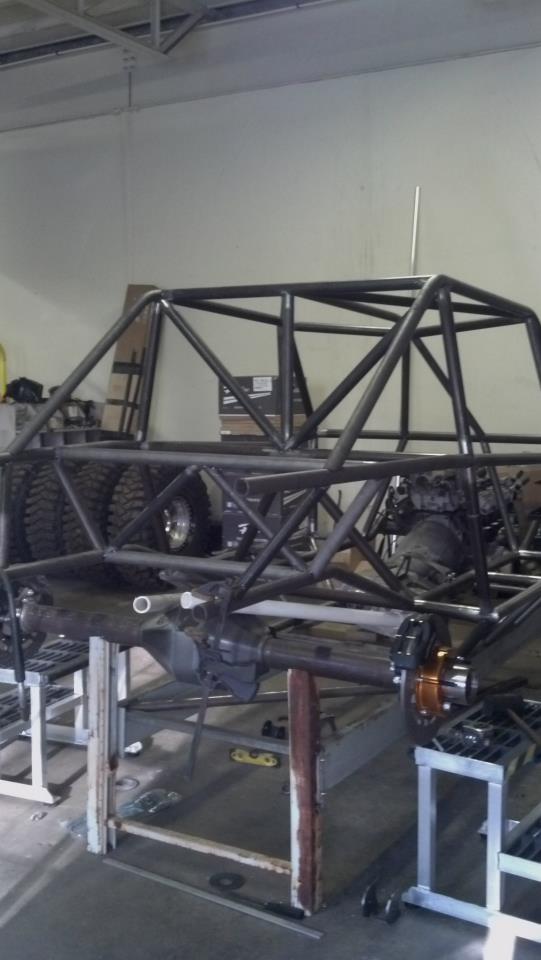

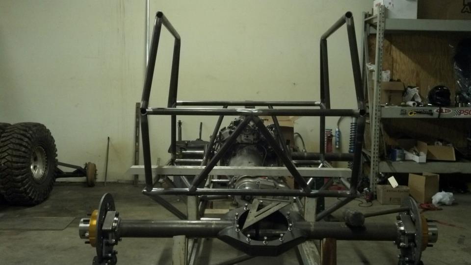

I really like the look so far. The roof and door bar have a 2 degree angle to them. The top of the roof is 46" outside of tube. My concern is the window area seems rather large. Its roughly 21" x 34" x 41". We talked about a double B pillar, but I really don't like the look of the Double B pillar. What are some of the bigger U4 Cars window net area?

New Racelines!

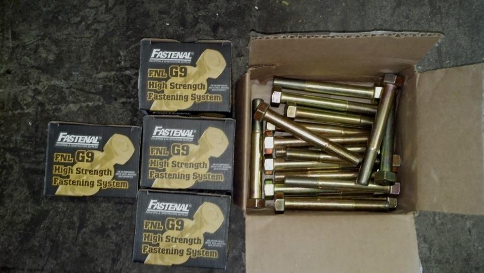

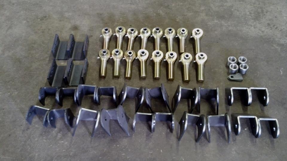

Grade 9 Hardware for Links and Shocks

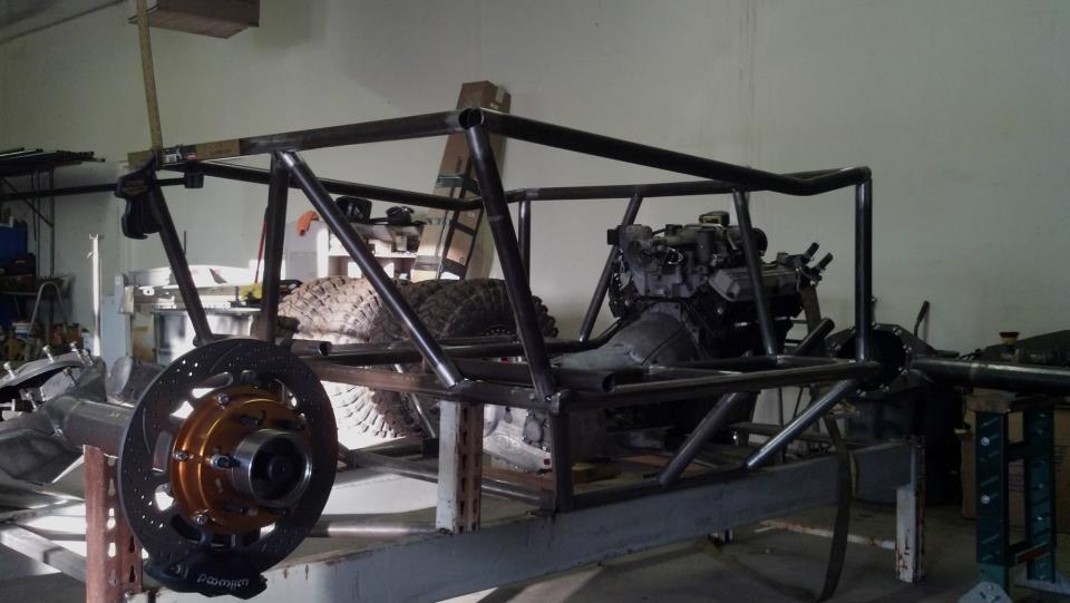

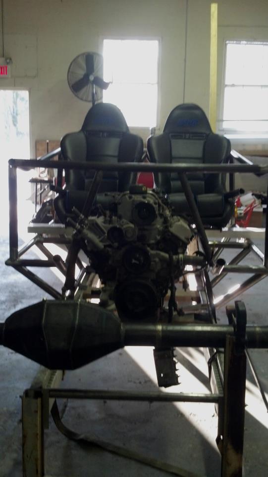

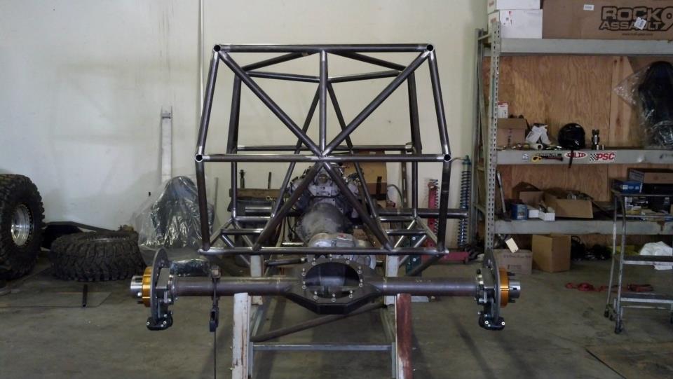

The rear is right at 41" wide so we can mount a spare on the back of the car. The frame on the car will be 18" behind center of rear axle. The spare tire will have a bumper built into it that will be behind the rear tire.
That motor and trans setup will never work!! Lol rig is looking good. Can't wait to see it in action..

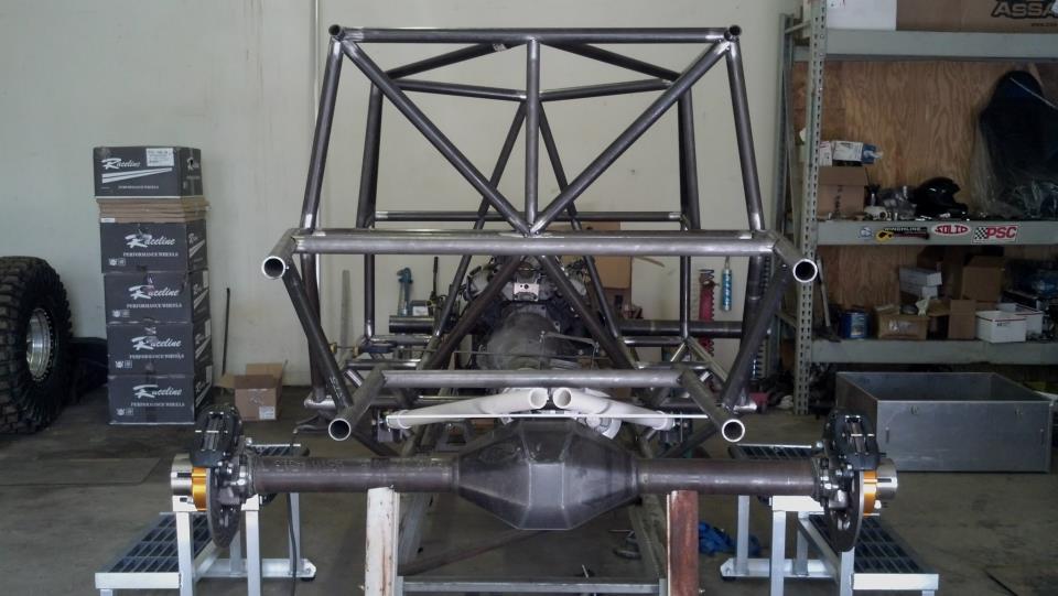

The chassis is 54" wide. The front axle is 67" wide WMD to WMS and the rear axle is 65" wide.
