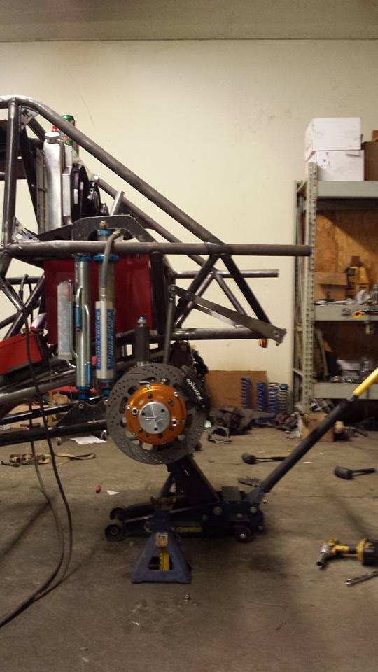

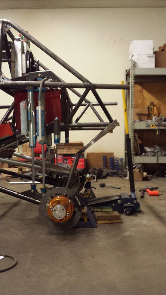

Double shear plate

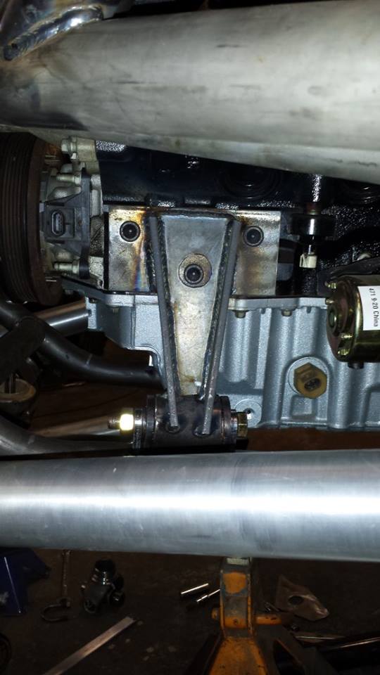

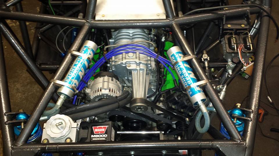

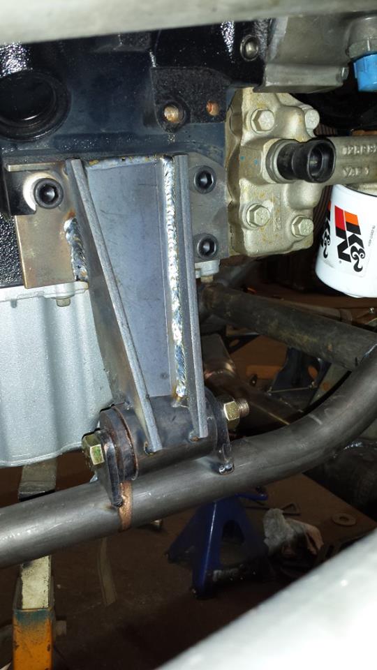

Lower Engine Mounts

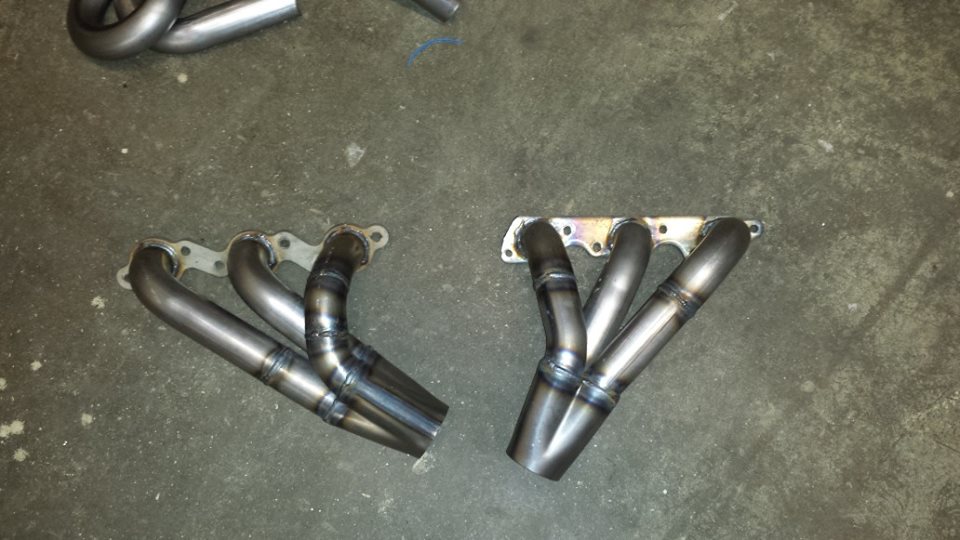

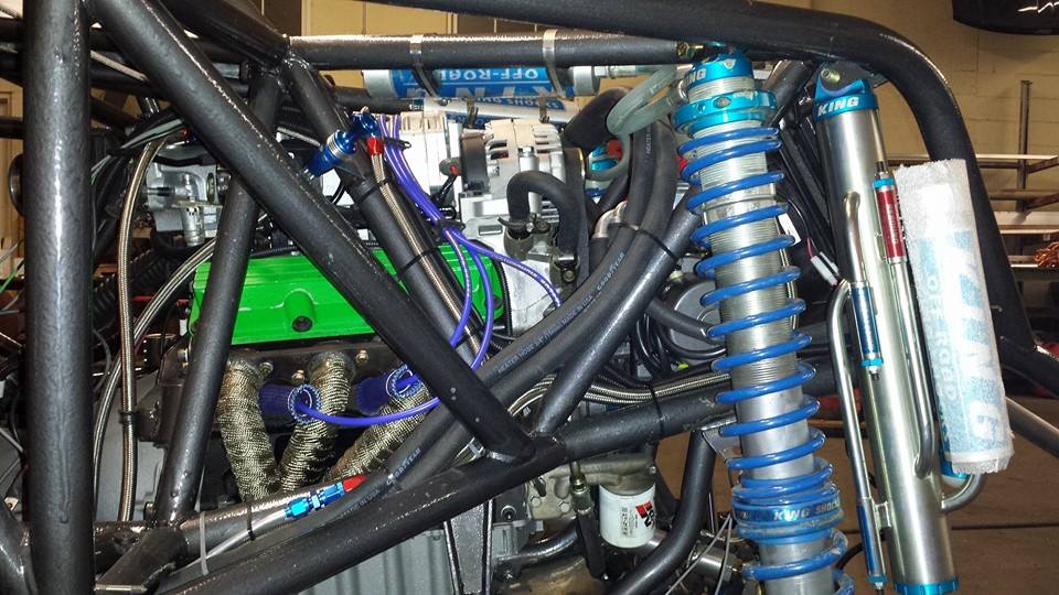

Headers.

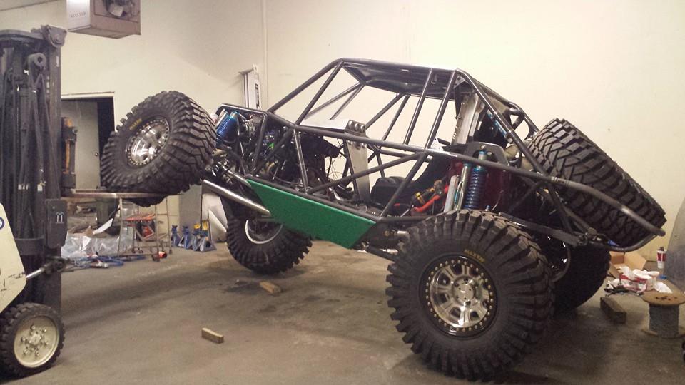

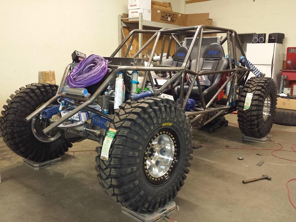

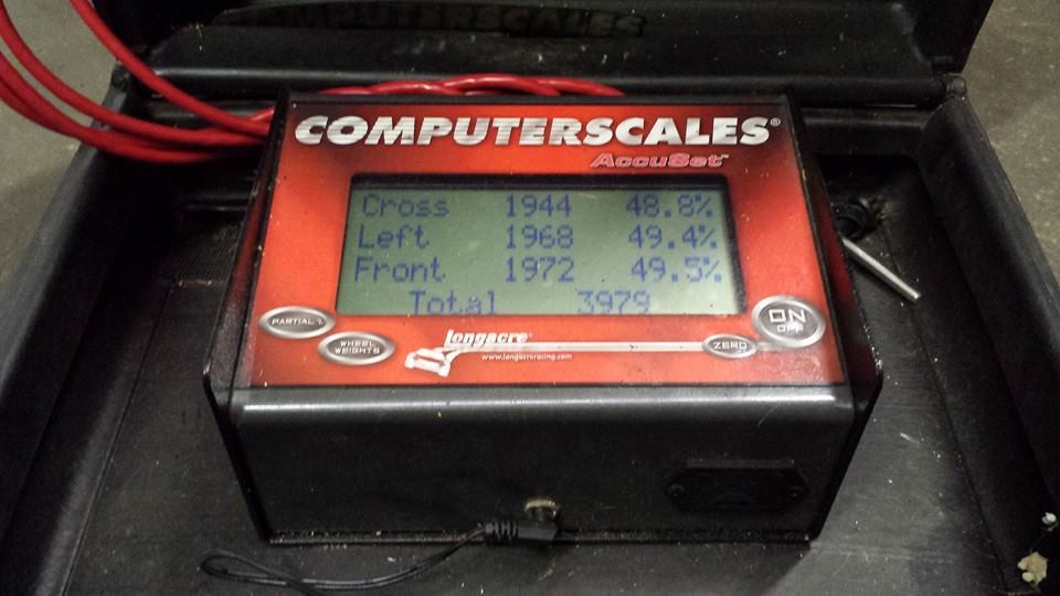

Was getting curious on the weight before we added a lot more stuff to car so tonight I got some scales.
With everything piled on it the total weight was 3390. Yea I'm still missing a good bit of stuff but 4000lbs with a spare mounted I think is very realistic.

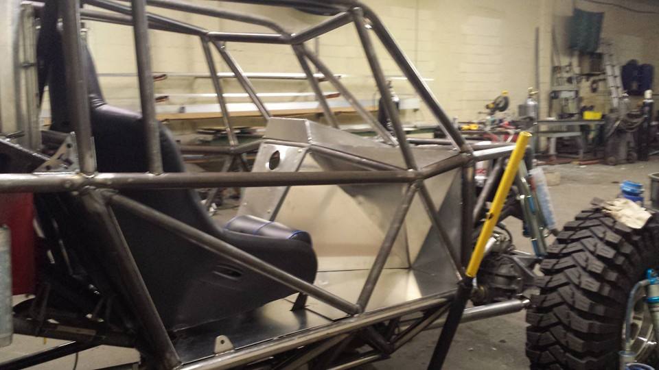

All the interior is cut and ready to mount!

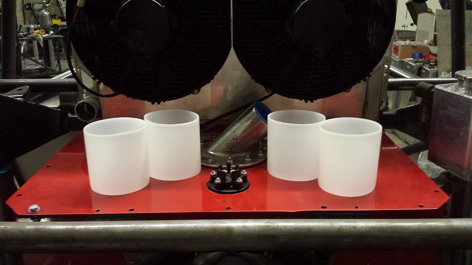

Got all but 4 pieces in my 22gal cell.

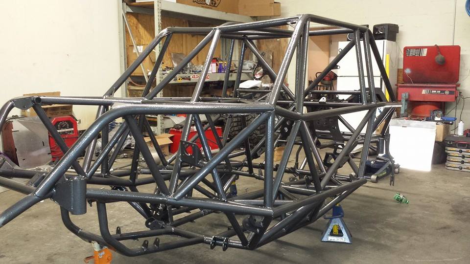

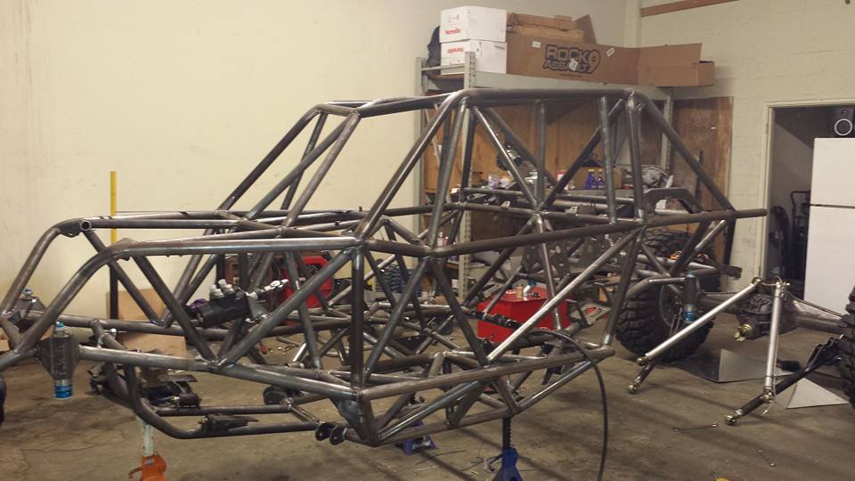

Got the chassis tore down for final welding, skid plates, and a few other things. I am gonna try the Hammered paint for now, i figured after a year of racing and some changes i may powder coat.
Chassis is painted. Used the brush on hammered Rust oleum. Turned out pretty good I think.

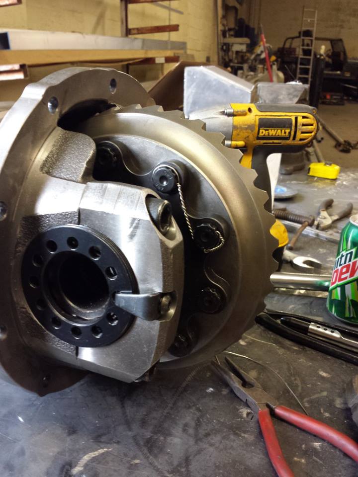

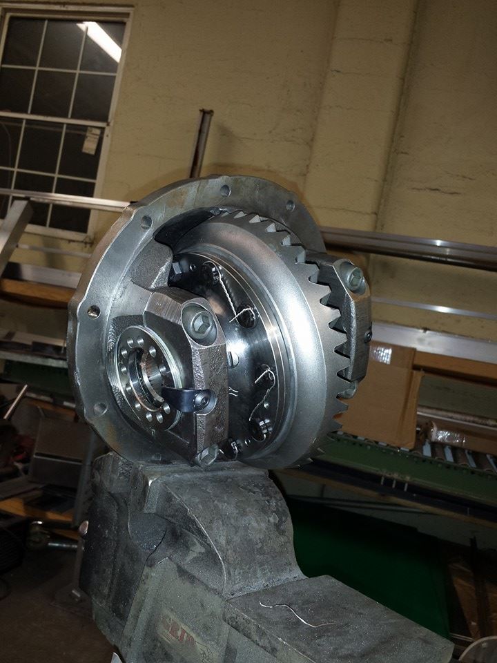

Front and Rear Diffs Safety Wired

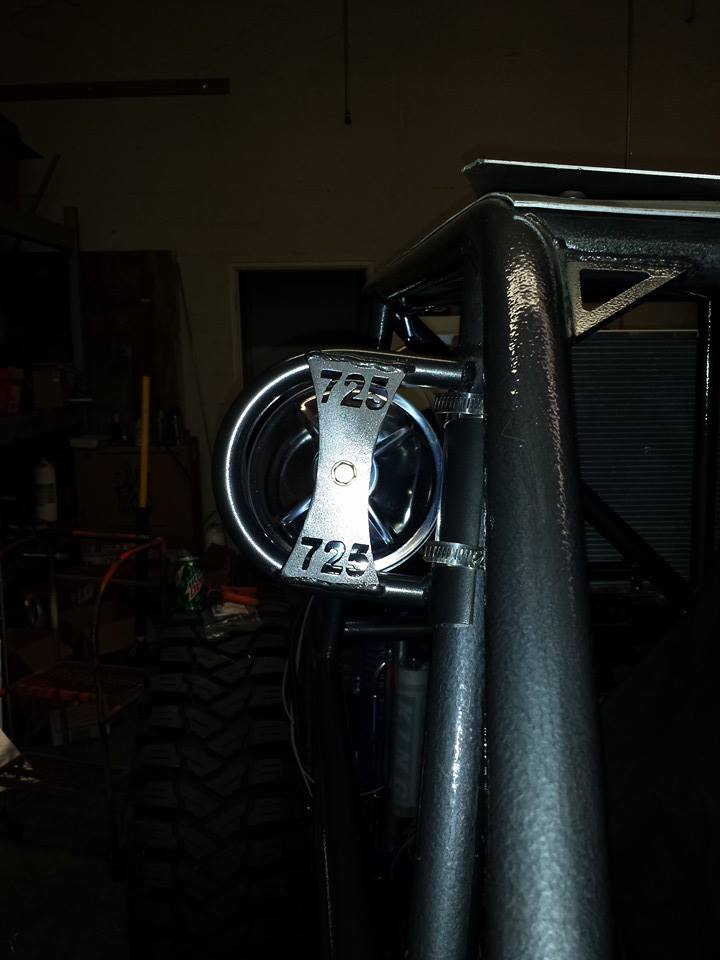

Rear bumper is completly removable, spare tire is mounted on a unit bearing in case we need one. Also the spare tire carrier is built like a trunk, pop the pin and the spare will hinge up with gas shocks and there is a storage space under it for anything you need.

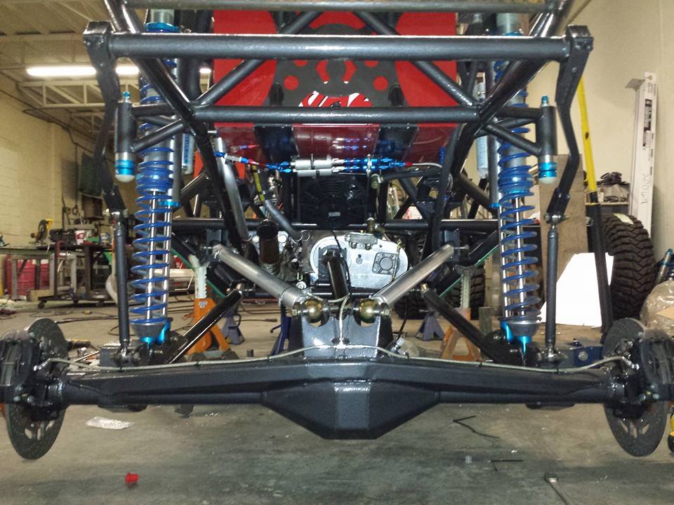

quick question...

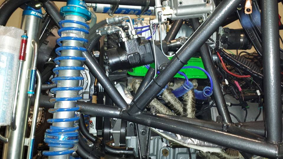

How are you keeping the rear lower links from rolling over with the shocks mounted to them? I couldn't see really good but looks like heim joints on both ends?
Nice headers. The gran prix I bought had a brand new set of stainless FWD headers in the truck. I'm going to cut the pass side one up and re do it
Headers.
