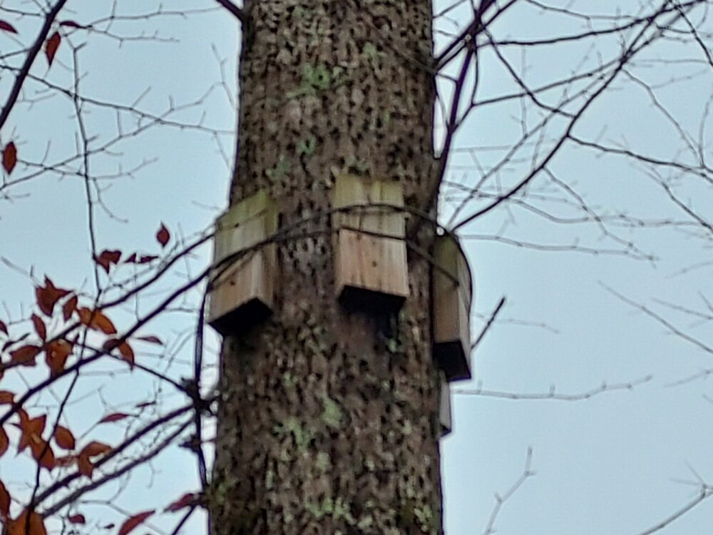

-Put something around the tree to protect it. The cable around the bark will cut through and kill the tree. I had some 1/2"x2" board laying around, so I cut it into about 2" long pieces and put it between the cable and the tree.

I will second what @jeepinmatt said about protecting the tree. I screwed some pieces of 2x4 to the tree in a few places so the cable only contacts the 2x4's, and not the trunk of the tree. I will take a picture of what I did this Saturday when it is light out when I am at my house.

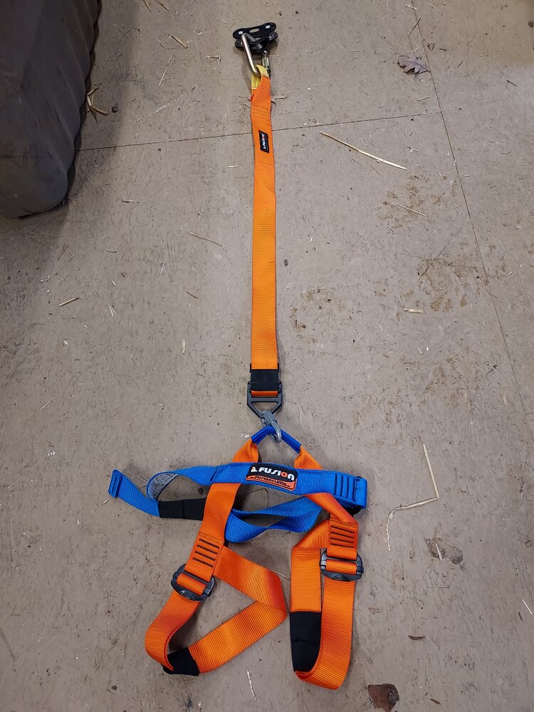

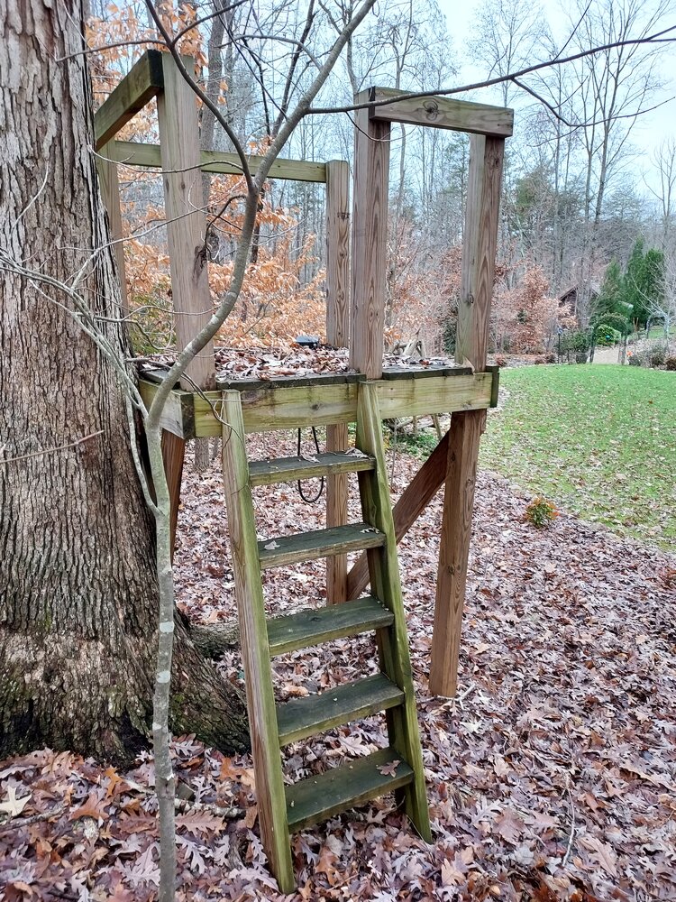

Took some pictures this morning.
Tree protection
Take off platform
Trolley
Trolley and harness
