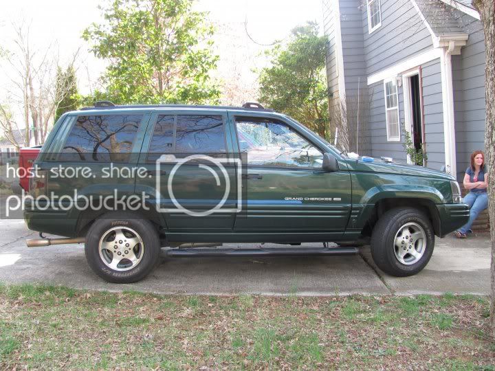

first pic is how it looked when I bought it with only 120,000miles

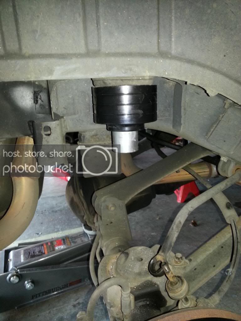

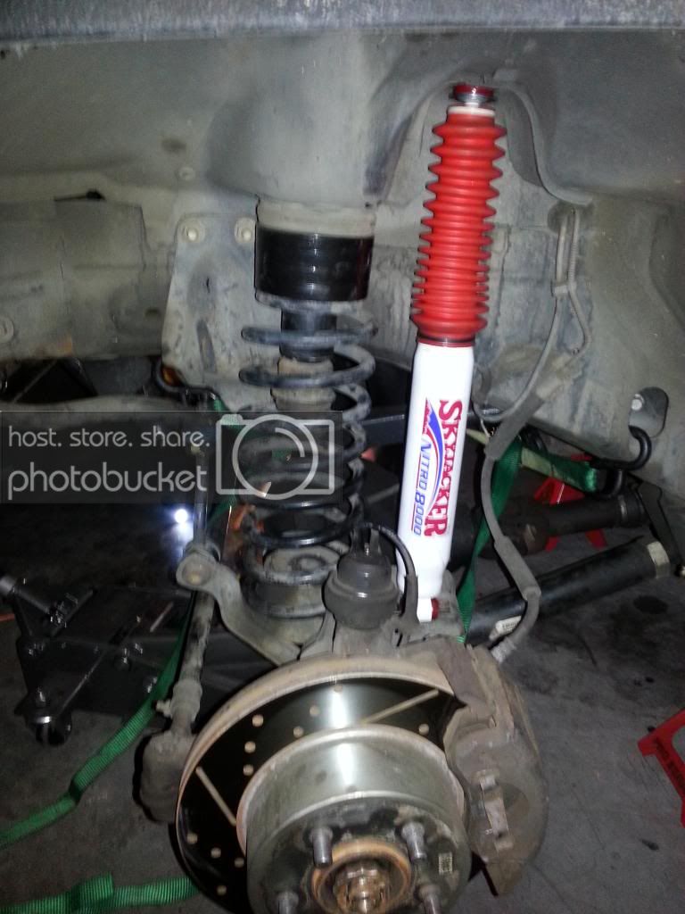

2.5 BB lift to fit bigger tires and aftermarket wheels.

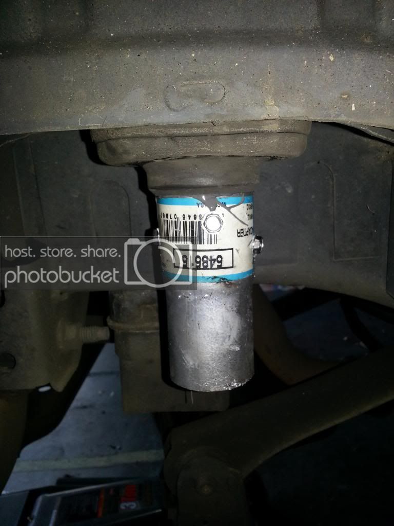

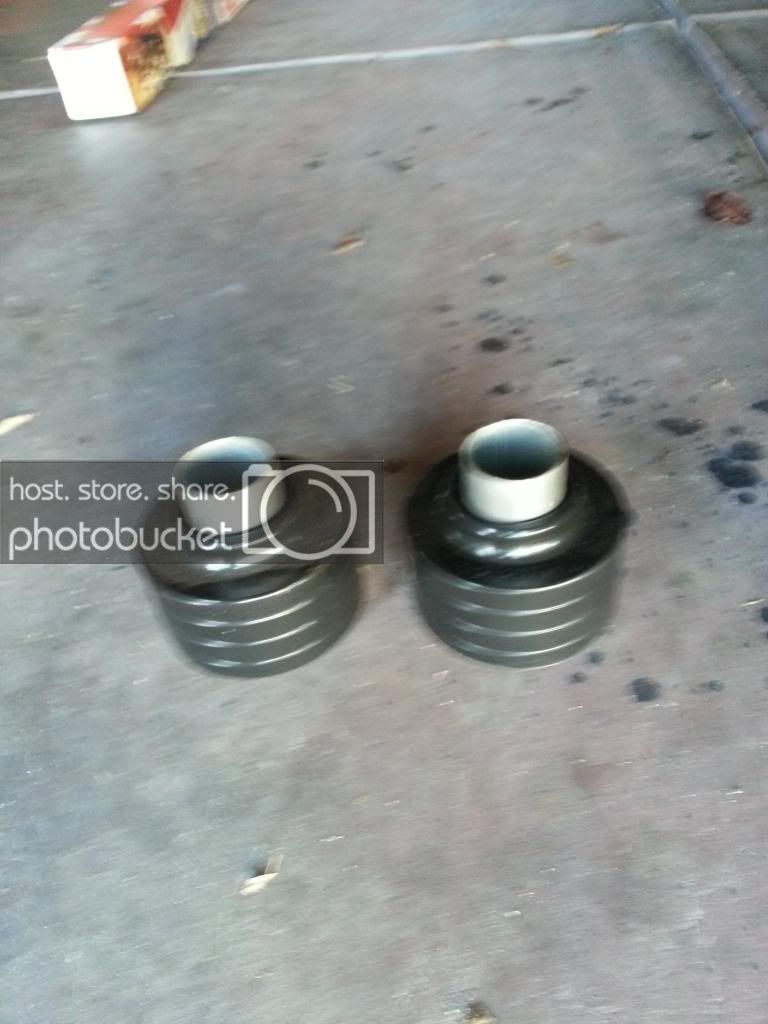

I heard that the springs like to pop out on the higher BB lifts and saw on another forum someone use exhaust piping to prevent it from happening
worked out pretty well I would say

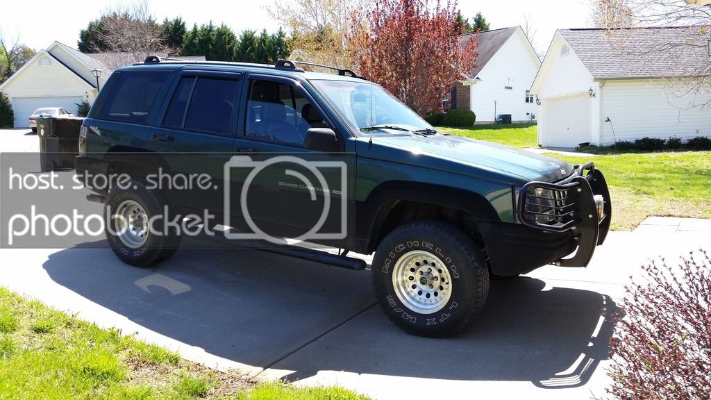

Final product after the BB lift, front upper and lower control arm upgrade by rough country, American racing wheels with 31s (craigslist find for $180).
I think this improved the stance and look dramatically

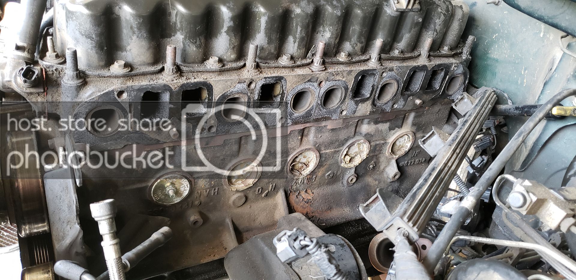

Inlets look terrible

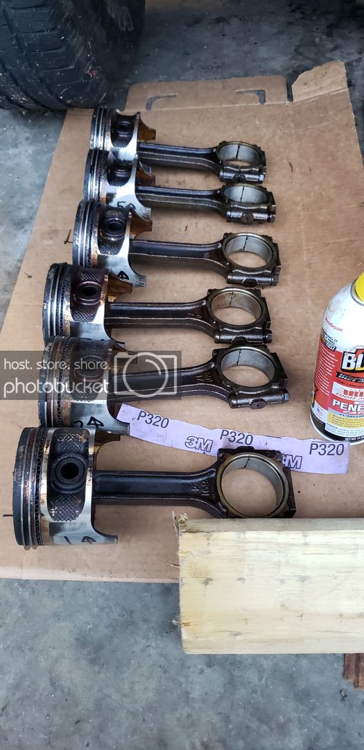

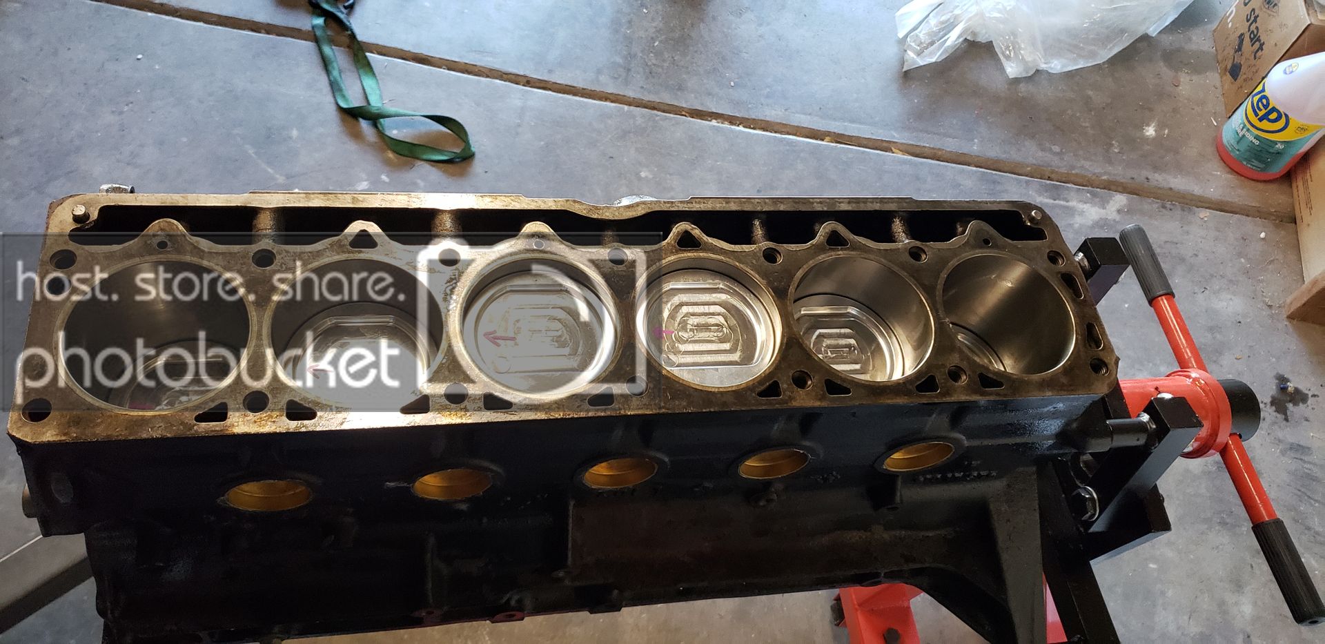

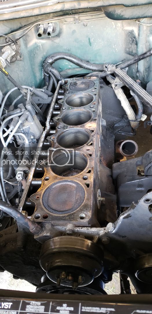

after removing the head the pistons dont look in that bad of shape

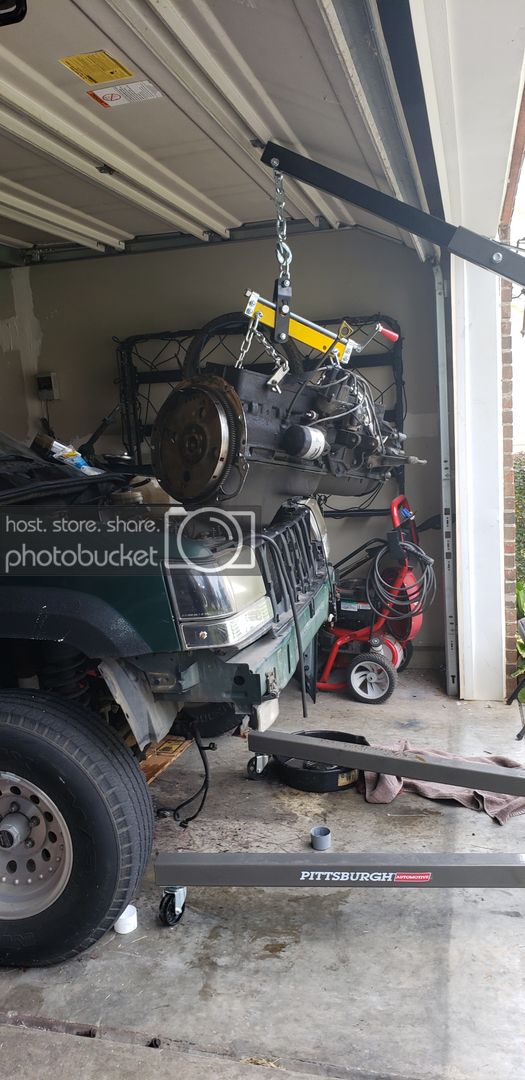

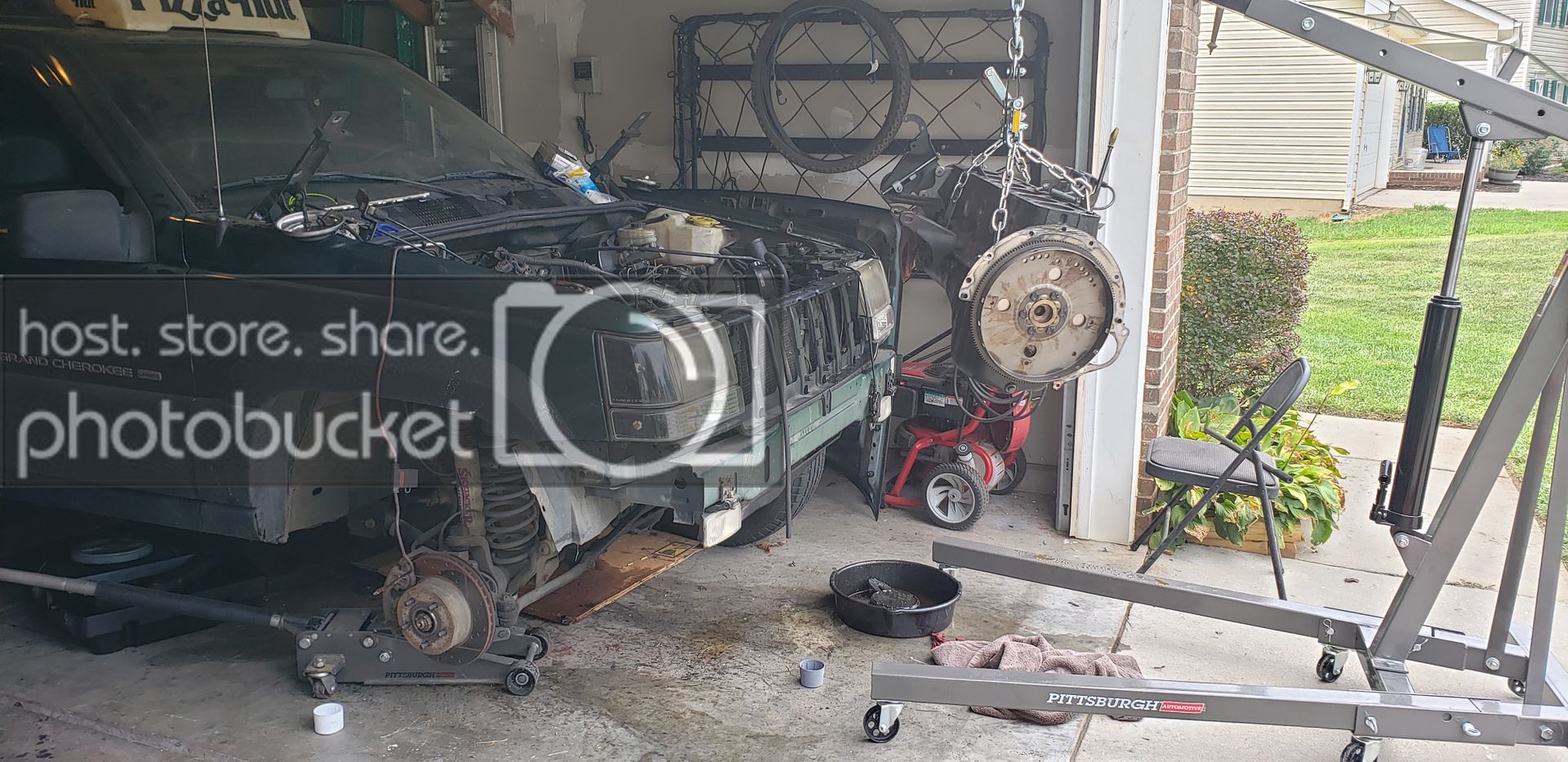

As you can see I should have planned better. between the garage door and the lifted jeep there just wasn't enough room to get the 4.0 out so I had to improvise.
removing the wheel and tire did the trick

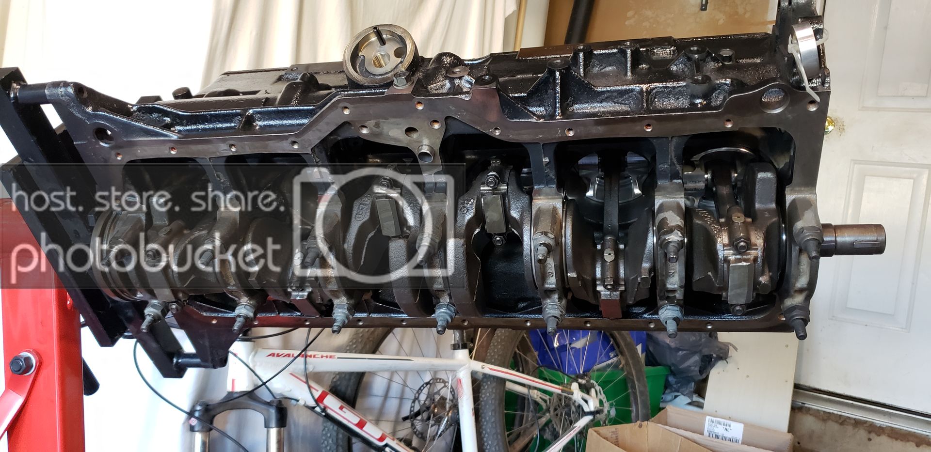

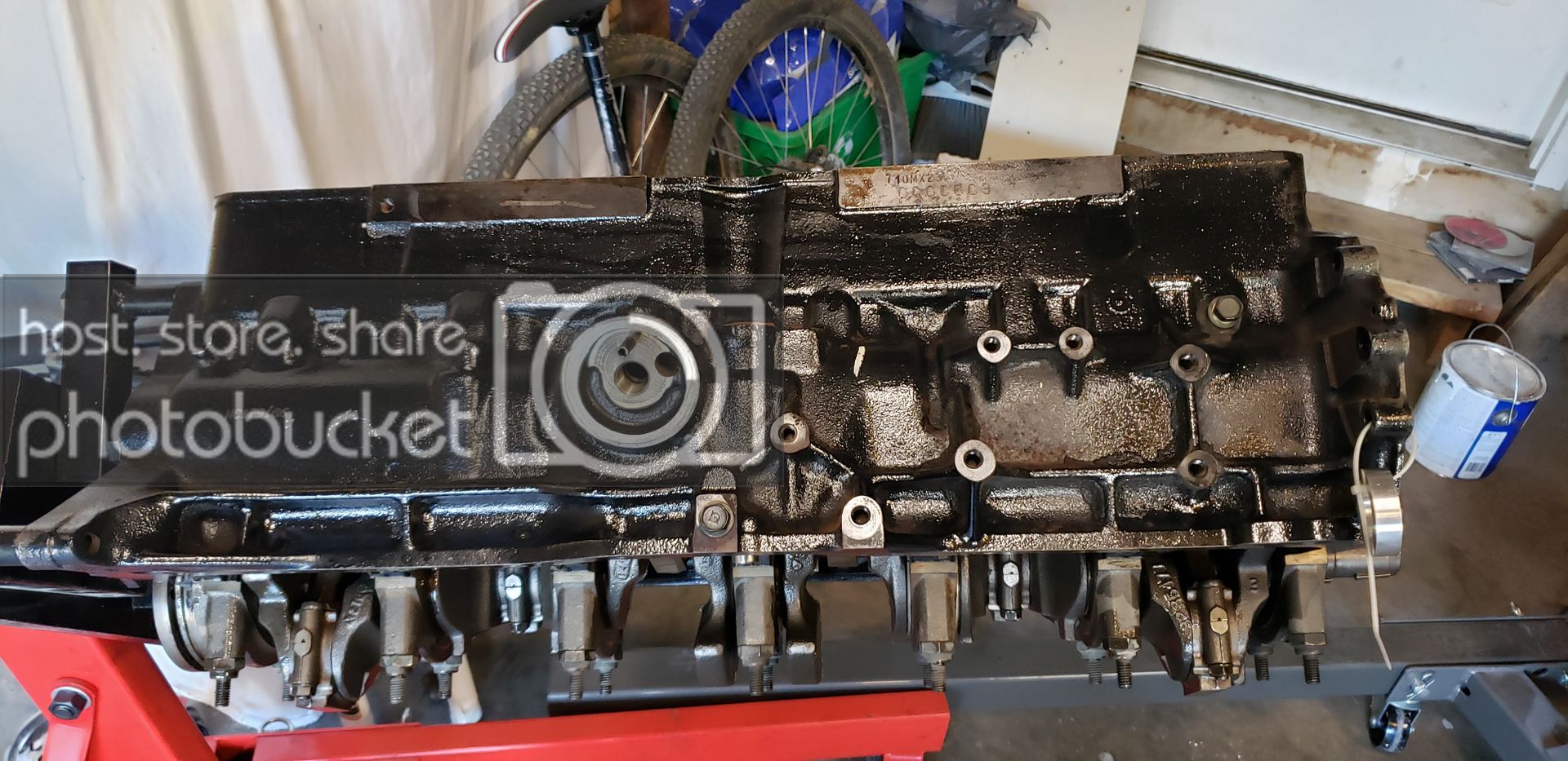

Old 4.0 block torn down and ready for machine shop

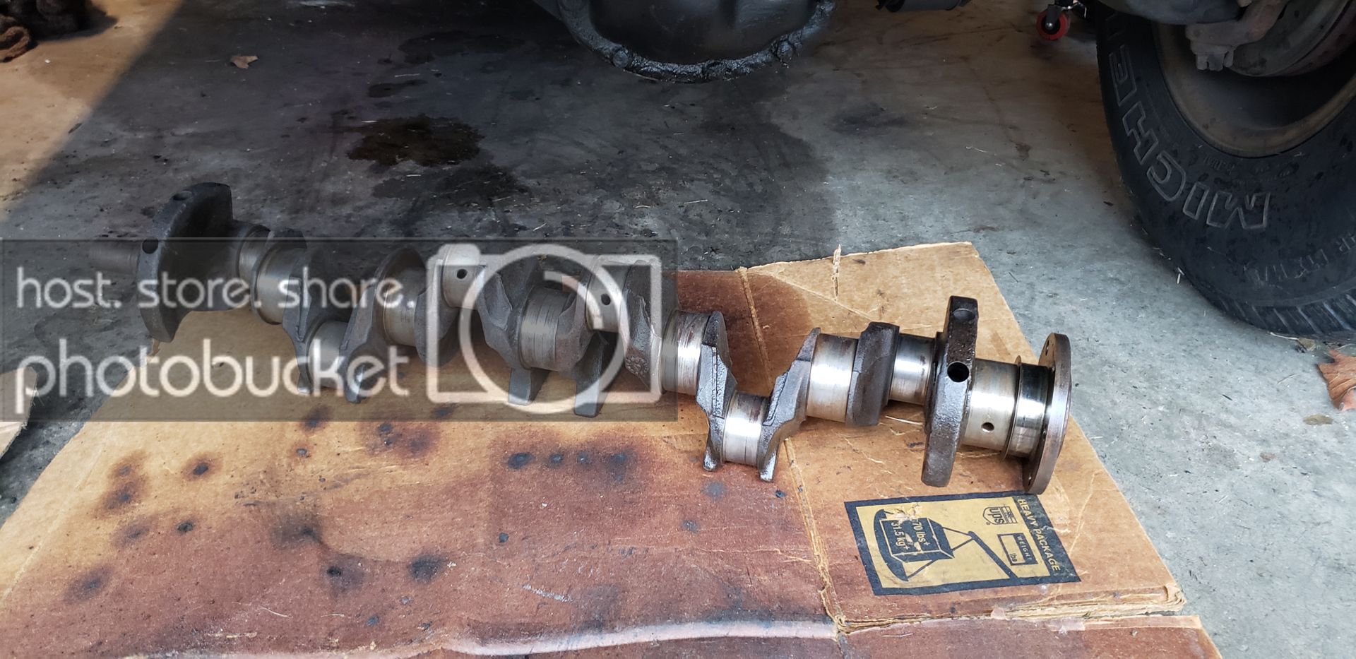

4.2 crank from @a_kelley after being cleaned up and ready to be turned and polished
After talking with russ I decided to go with the stock 4.0 rods and some of his custom forged pistons.
So I will be taking the block to the machine shop to make sure that the cylinder walls clean up at .030 before ordering the pistons from russ. Also dropping off the crank shaft and will hopefully get the Ok to start ordering parts!

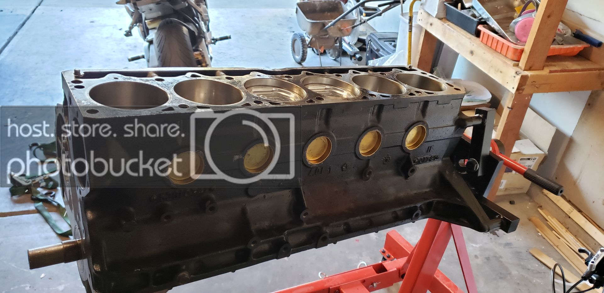

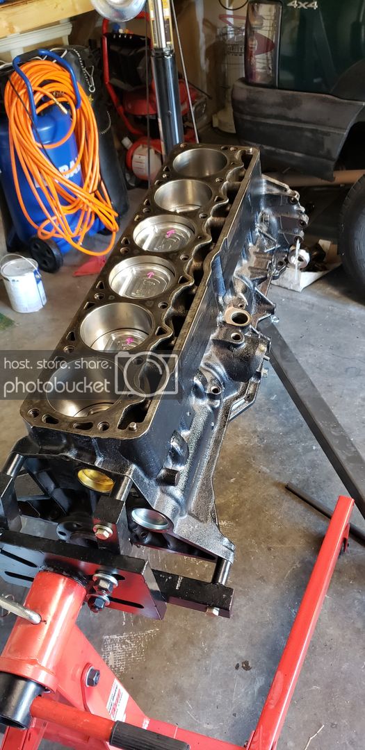

update.... got the engine block back last week.
It had to be bored .040 over due to scaring in the cylinder walls which was more then I was initially going for but whatever (no big deal). Aslo had the 258 crank turned and decided to have the machine shop put the pistons, rods, and crank in (only cost extra 150)
The pistons from russ were adjusted prior to ordering due to the larger diameter, they are forged aluminum pistons by race tec at 3.915 bore and an inverted dome at -28.000 cc. Estimated compression ratio I believe we talked about was somewhere near the 9.4-9.6 range.
