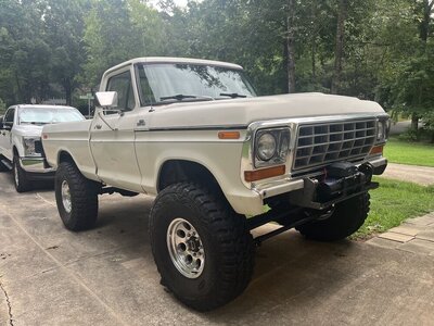

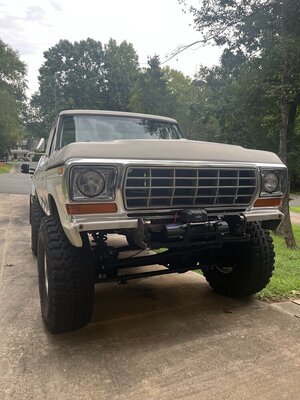

Then we decided to move to Charlotte. This brings us to today where I'm currently working on correcting/redoing my hack wiring and installing a Dakota Digital gauge cluster. I haven't even had a chance to do a real shakedown run yet but I daily drove it around town from December to April. Then I got myself a 2018 Super duty to DD and eventually use as a tow rig.
Here are some pictures:
