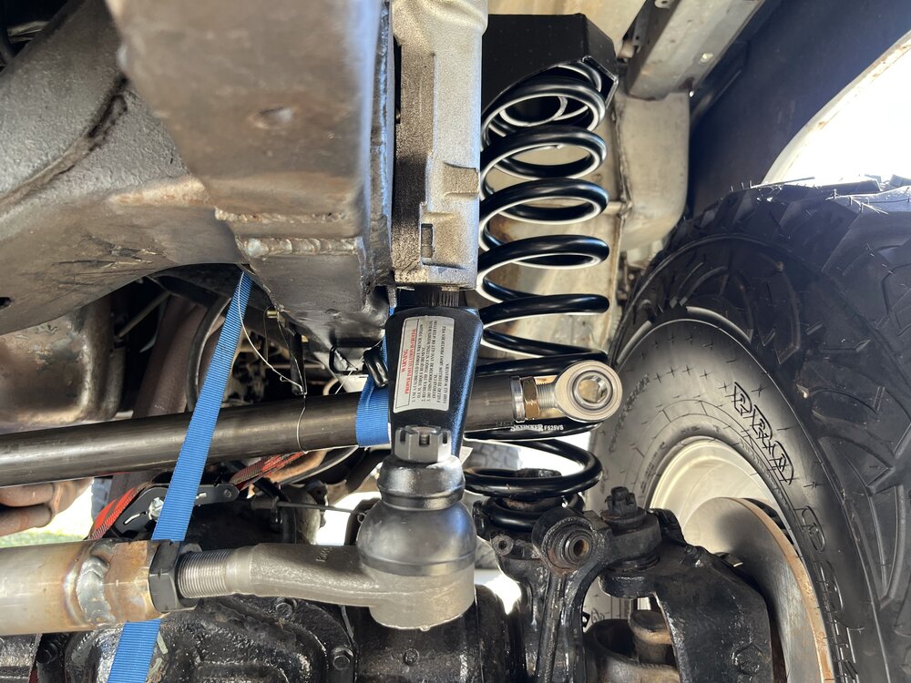

- WFO's Super Duty drag-link, uses rod end on the frame and stock tie-rod end at the knuckle
- DOM and Rod ends for the trackbar
- Barnes trackbar mount on the axle
- Custom trackbar mount on the frame out-boarded 8"

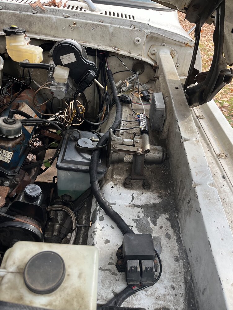

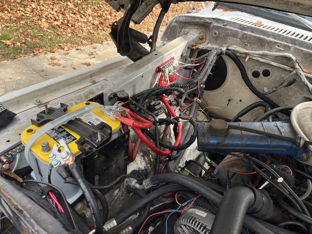

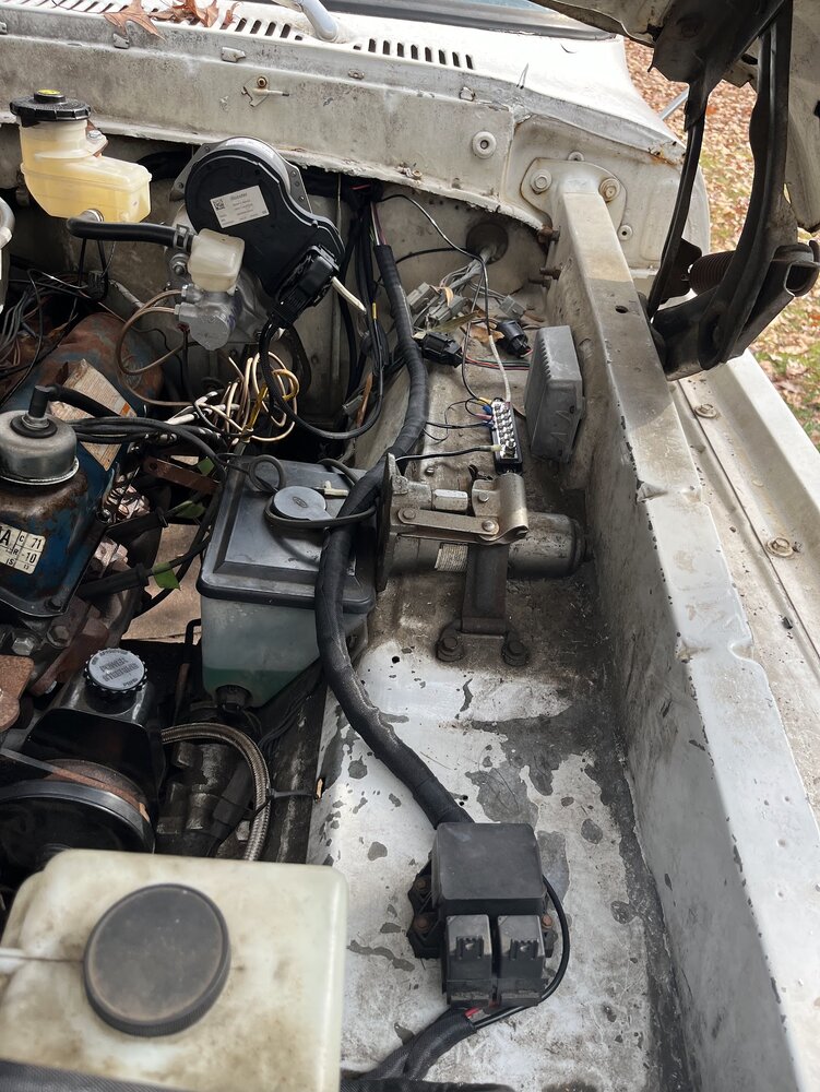

Then we decided to move to Charlotte. This brings us to today where I'm currently working on correcting/redoing my hack wiring and installing a Dakota Digital gauge cluster. I haven't even had a chance to do a real shakedown run yet but I daily drove it around town from December to April. Then I got myself a 2018 Super duty to DD and eventually use as a tow rig.
Here are some pictures:

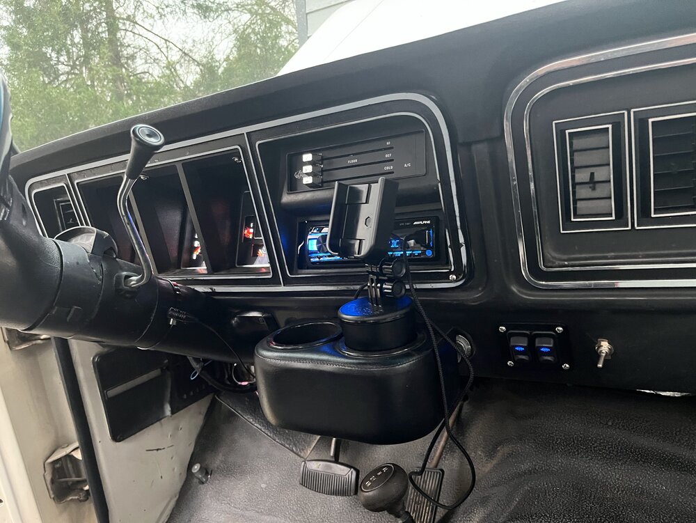

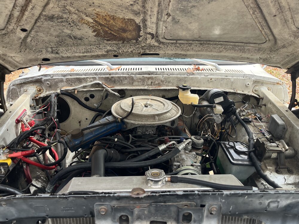

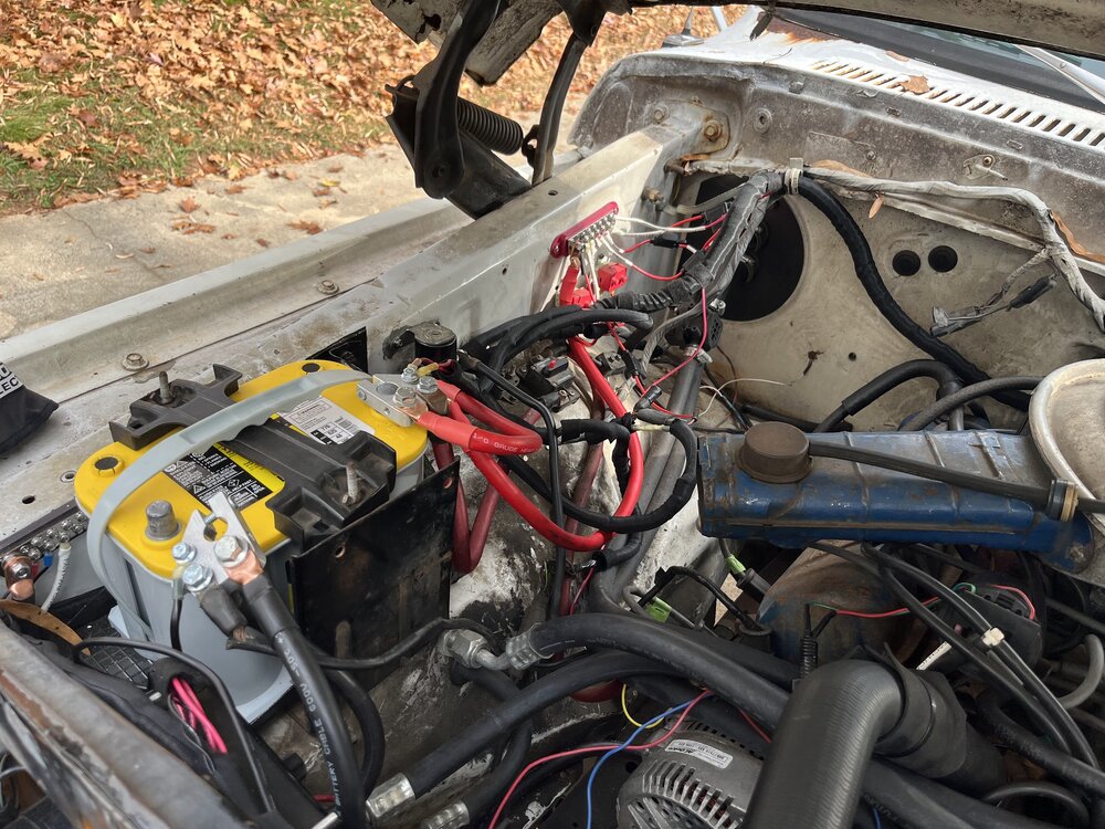

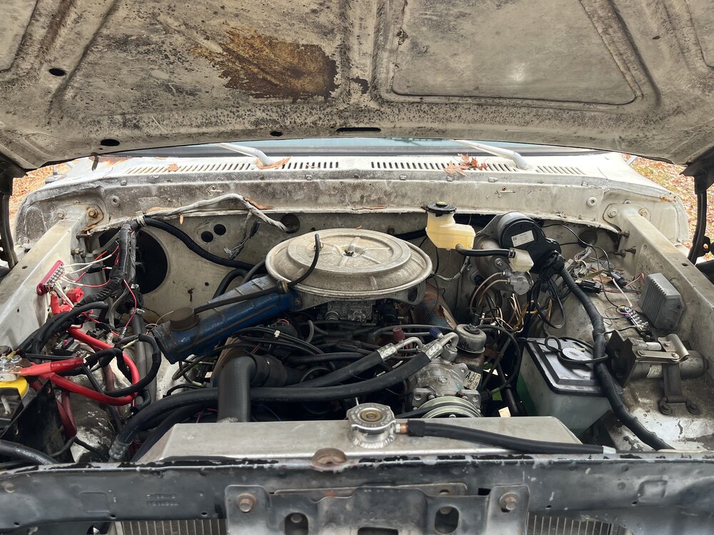

I thought I had my electrical issues all sorted out after the re-wire but I started it up yesterday after a few weeks sitting.. warmed up, sounded good, everything works. I hop in, put my foot on the brake (remember, iBooster..) and the truck shuts off.
Dakota Digital Gauge cluster isn't coming to life but the control box status light is blink fine, dome light is on, but no headlights, no stereo in ACC or ON. Thinking I blew another ignition switch or the connector is bad but will have to mess with that later. Fusible link looks fine but will go through diagnostic steps to make sure.
The iBooster is on the Painless 7 Circuit box that uses relays to switch the IGN ON circuits so I'm not really understanding what's up.

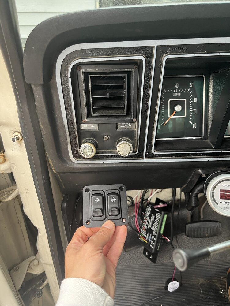

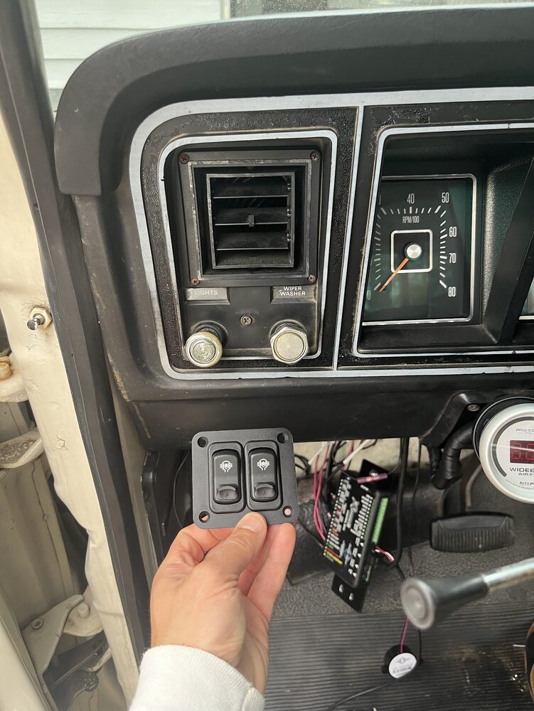

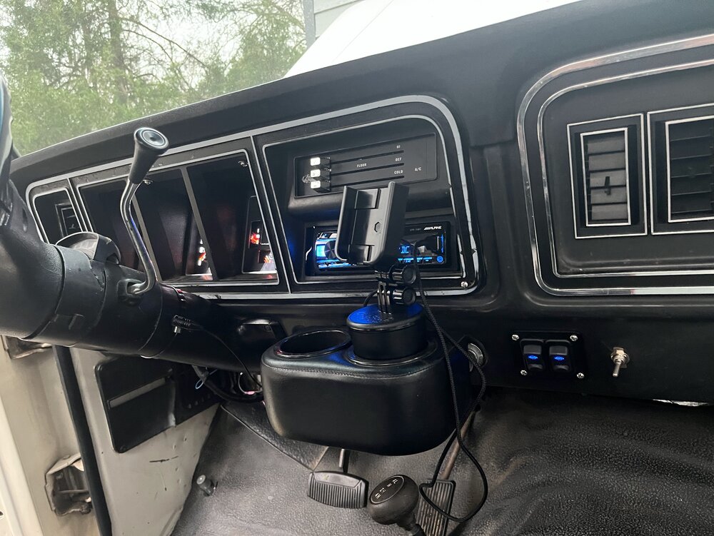

Just another hurdle. I was planning on finally wiring up my e-lockers. Designing a "pod" for the two switches for the e-lockers, the dakota digital switch, and my fan's manual override switch.
The re-wire job is still a bit like spaghetti but it's not as chaotic and shitty as before and easy to trace.

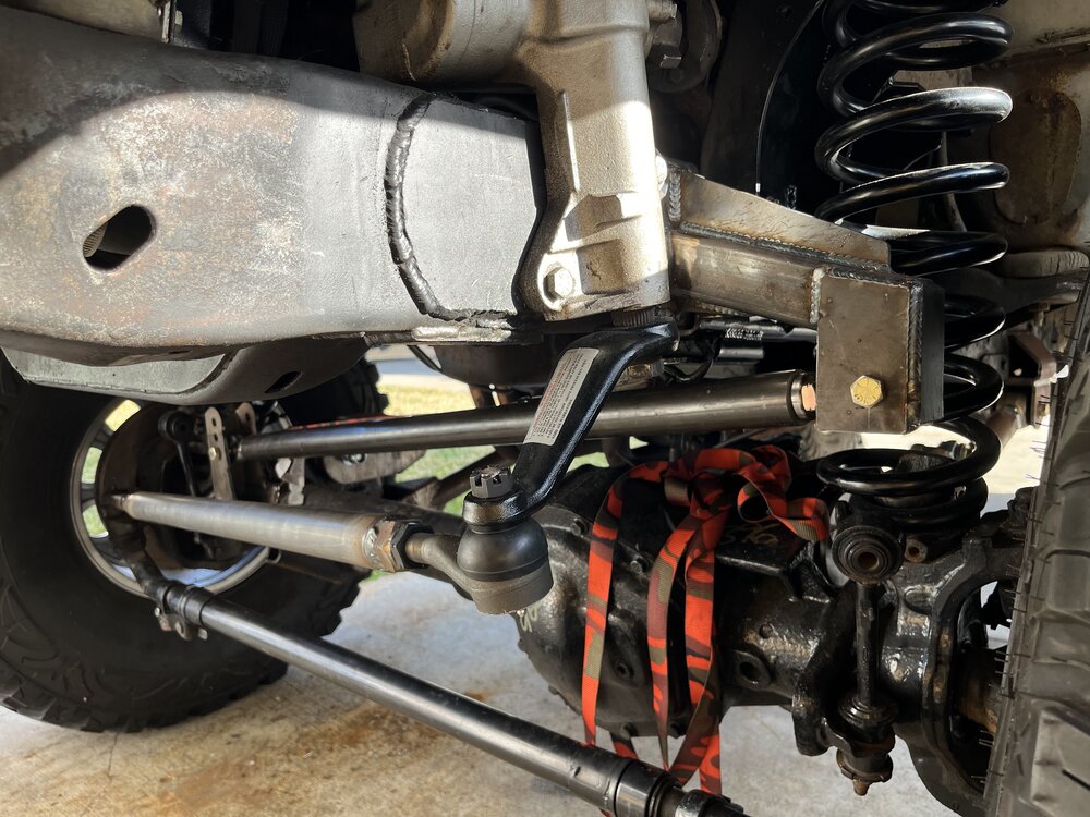

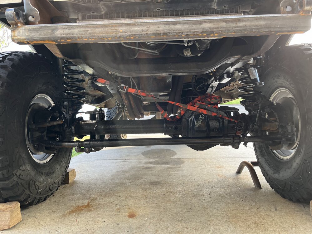

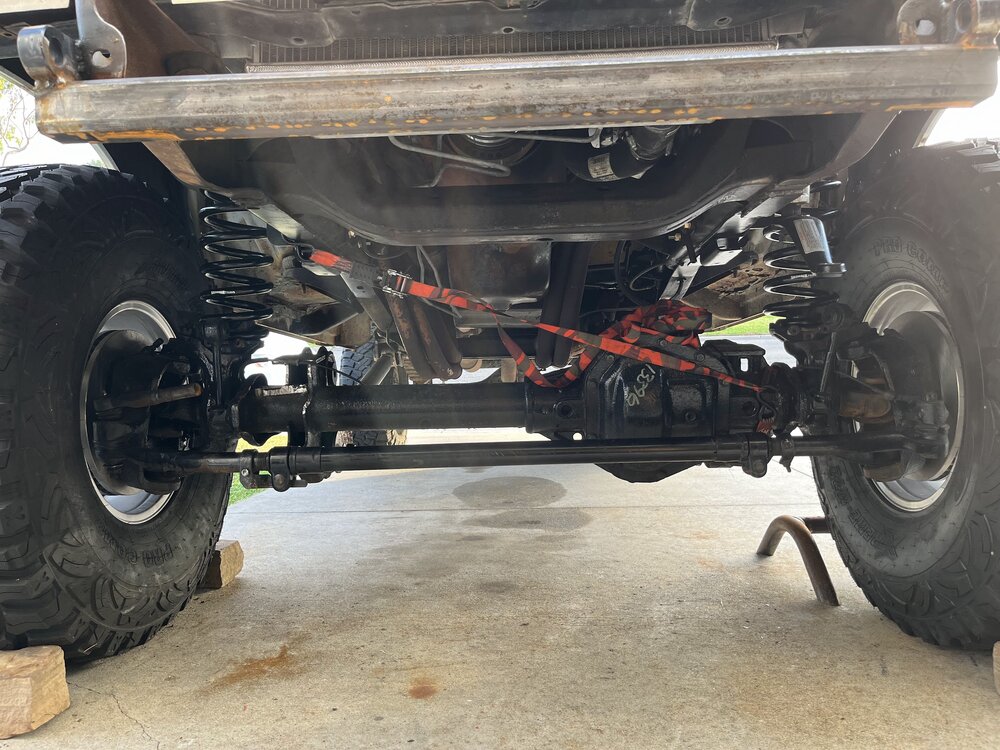

Have any good pictures of the front suspension? I am interested to see how you attached the axle. Radius arms?
Edit: I just read you used the WFO radius arms, but I'd still like to see what it looks like.

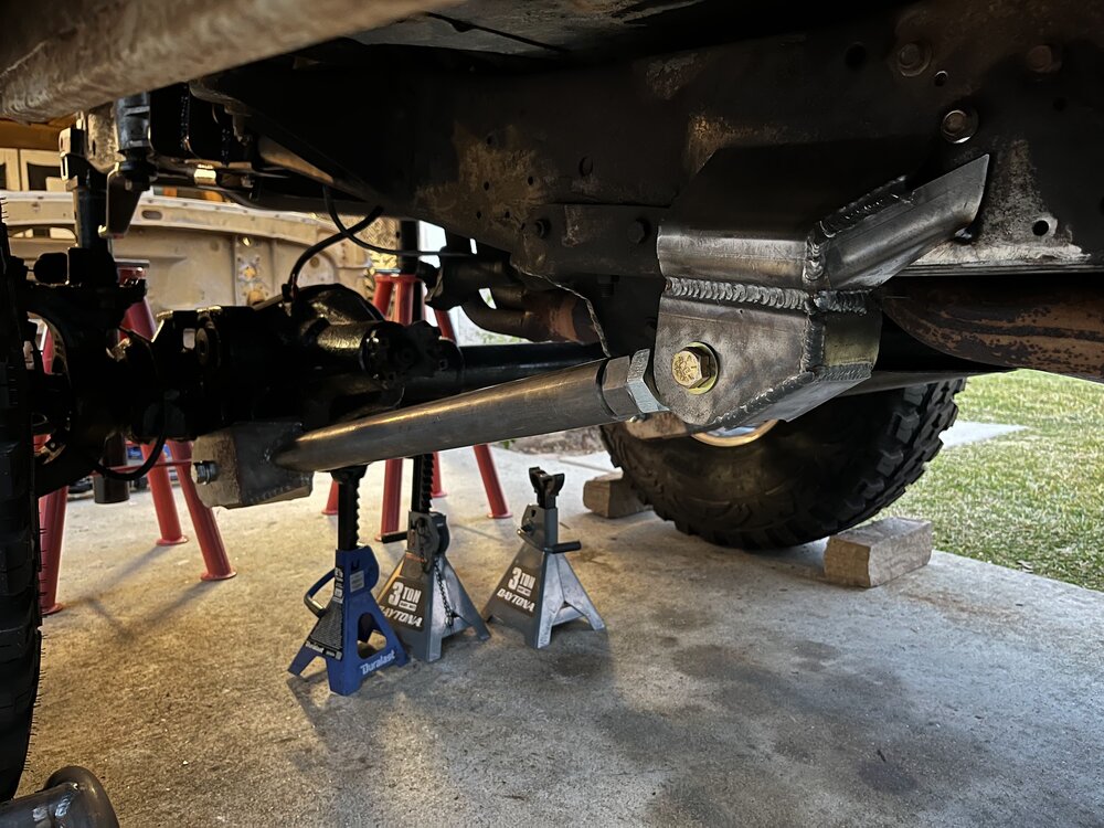

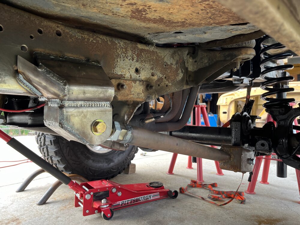

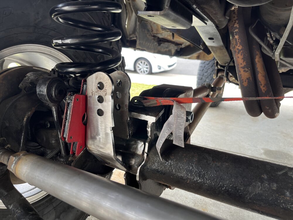

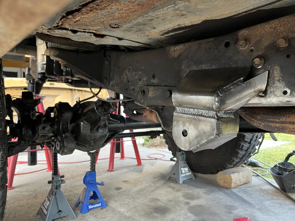

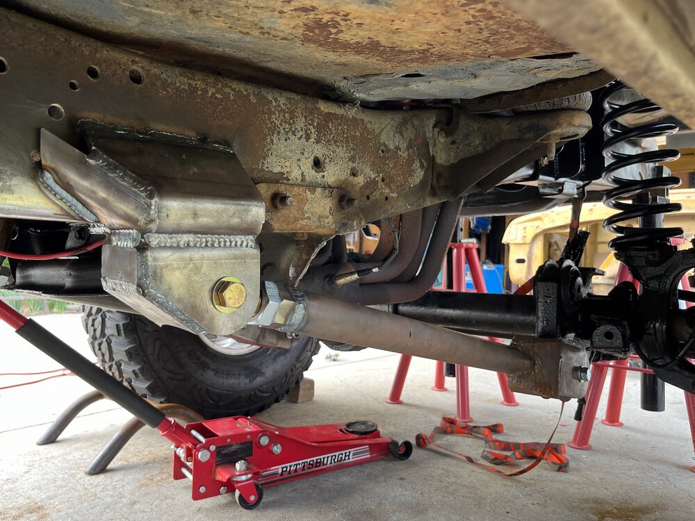

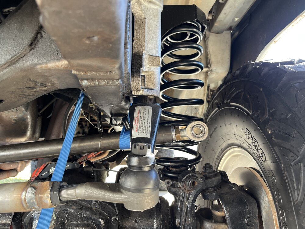

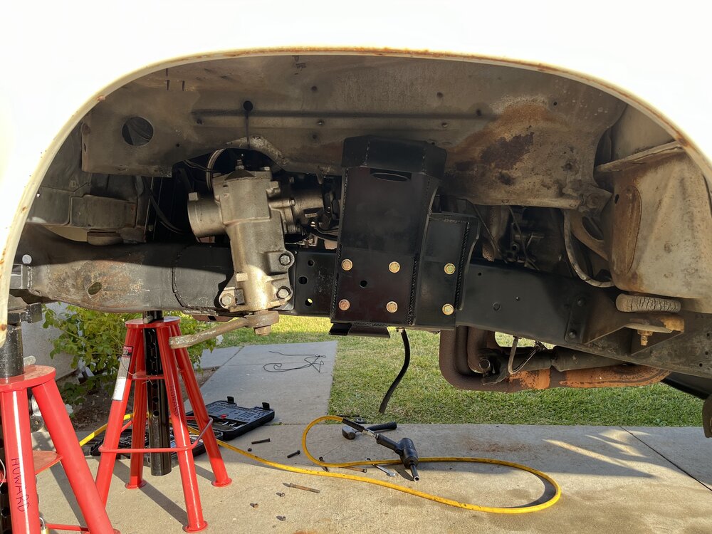

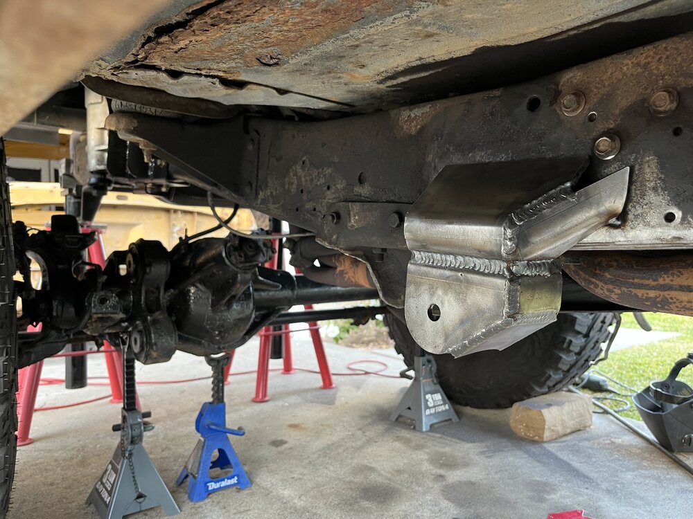

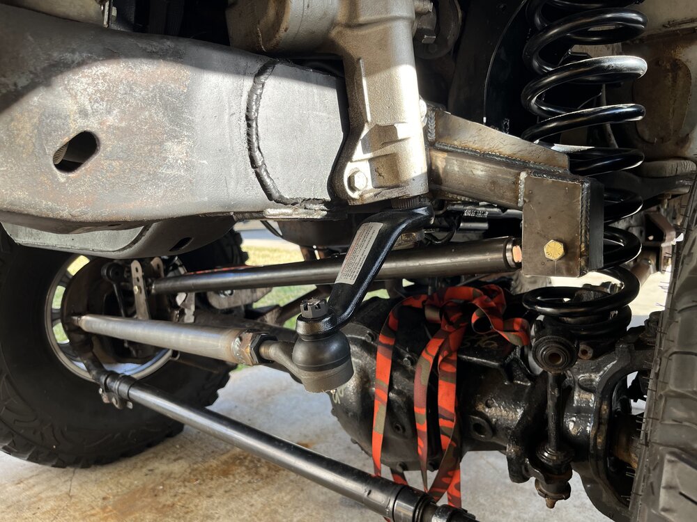

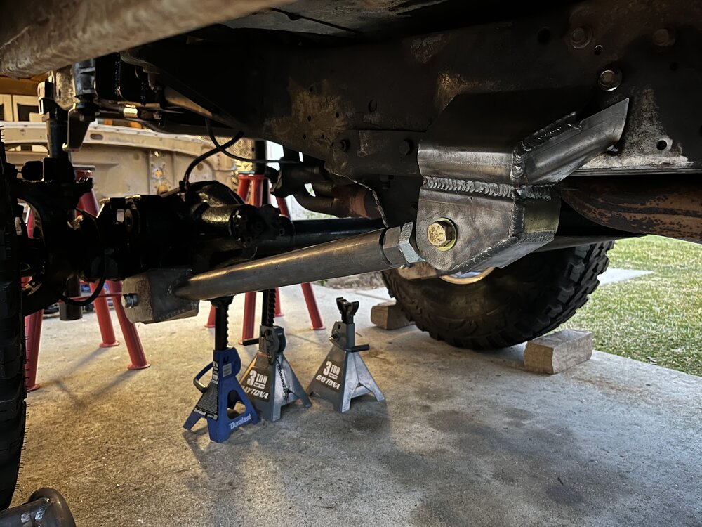

Yup, WFO arms and RuffStuff brackets for the rear mounting point. This is kind of the time-line of that part of the build:
I used BattleBornBrakes.com coil-bucket+shock mount to keep things simple. Pricey but saved me a ton of time and headache; they bolt right up.
This is the RuffStuff frame out-boarding bracket with the WFO supplied rear radius arm bracket welded to it.

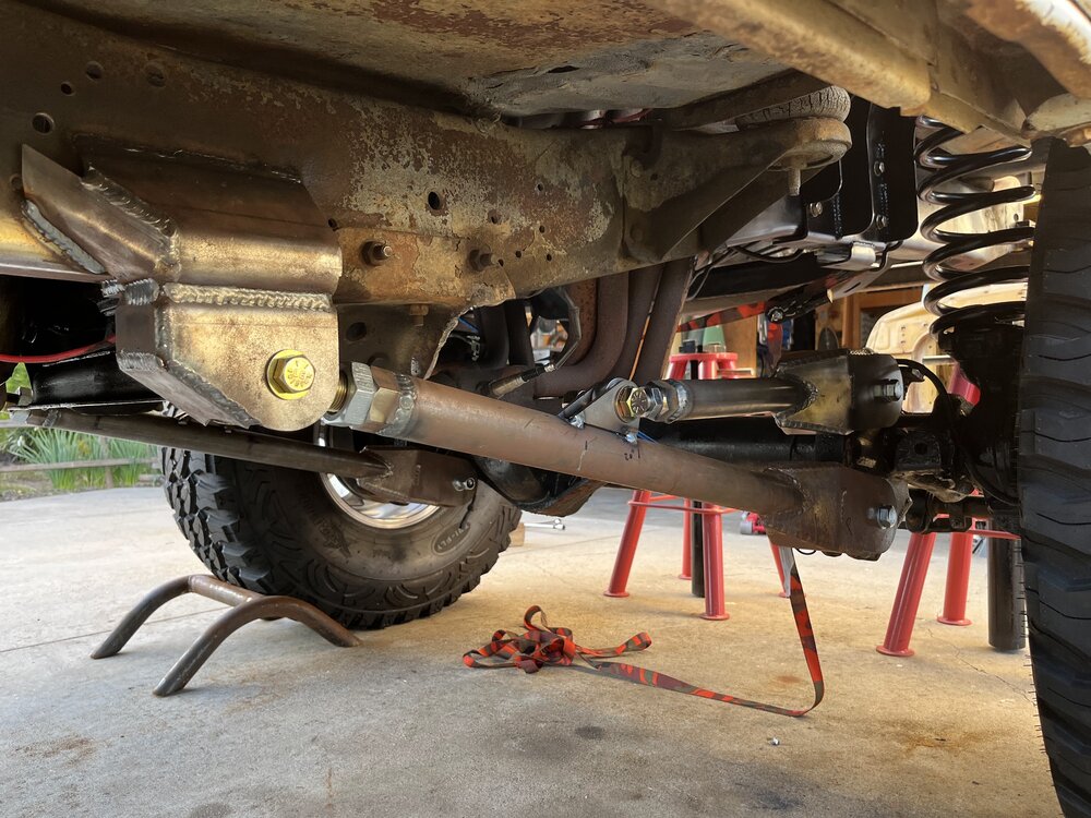

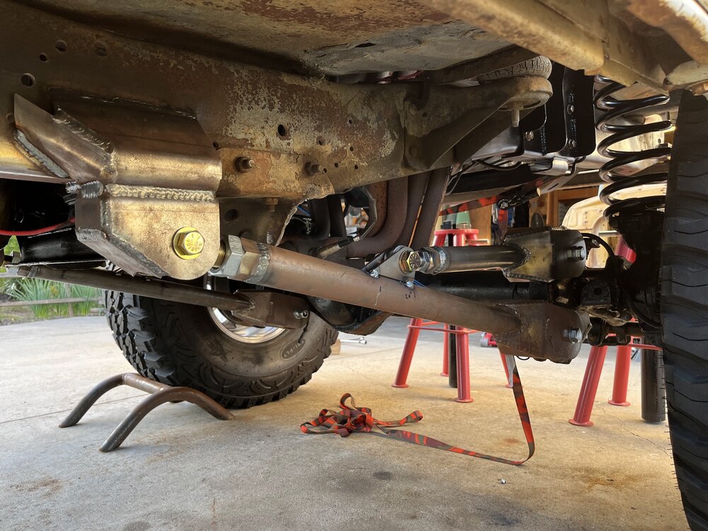

Lower arm.

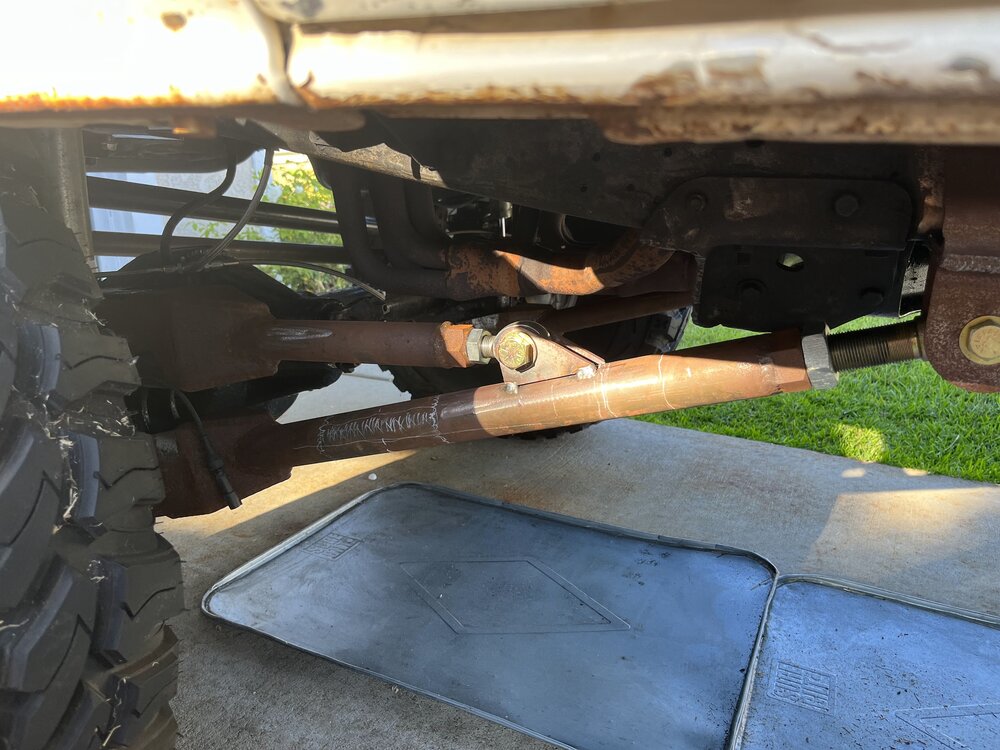

Passenger lower arm.
Upper tacked in place.
40's don't rub on the arms at full lock.. that was nice.

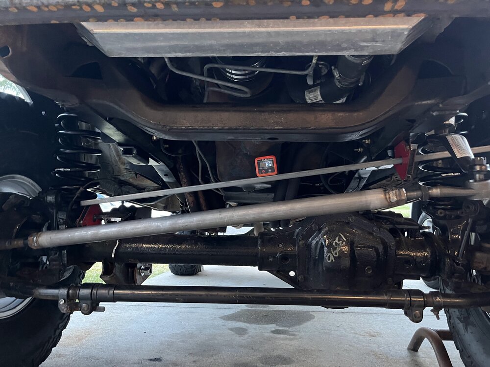

This is when I realized I screwed up my caster measurements and made the lower too short. That sucked but ended up not being a big deal. Look at how unthreaded the heim is on the frame.

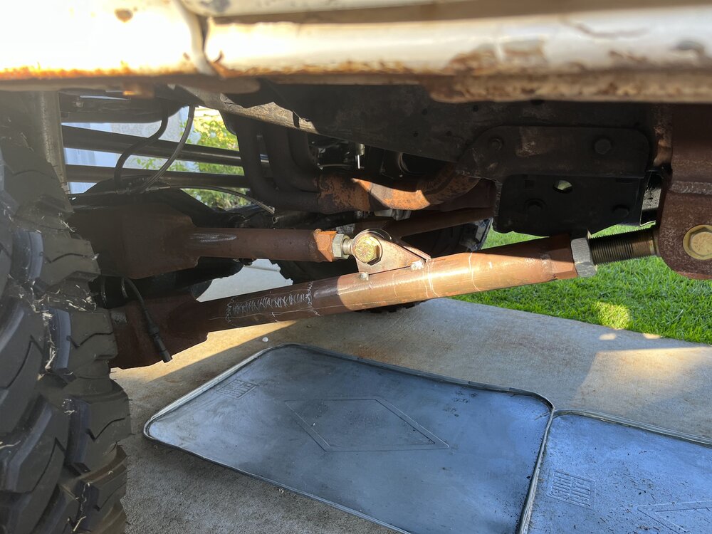

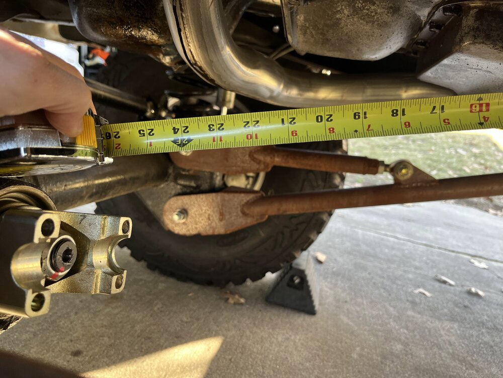

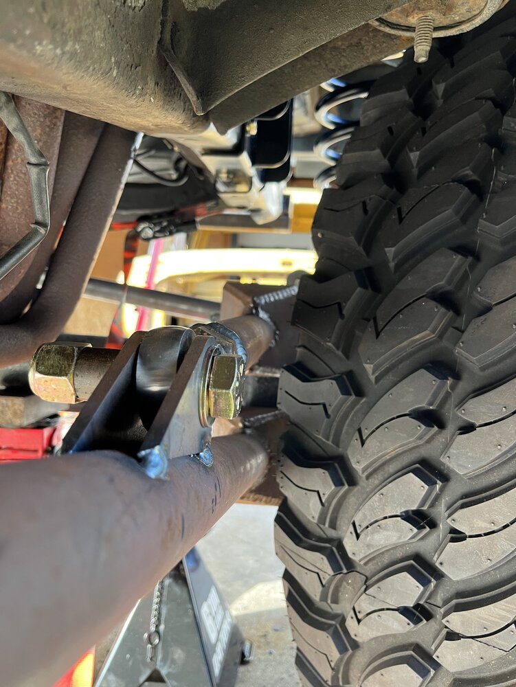

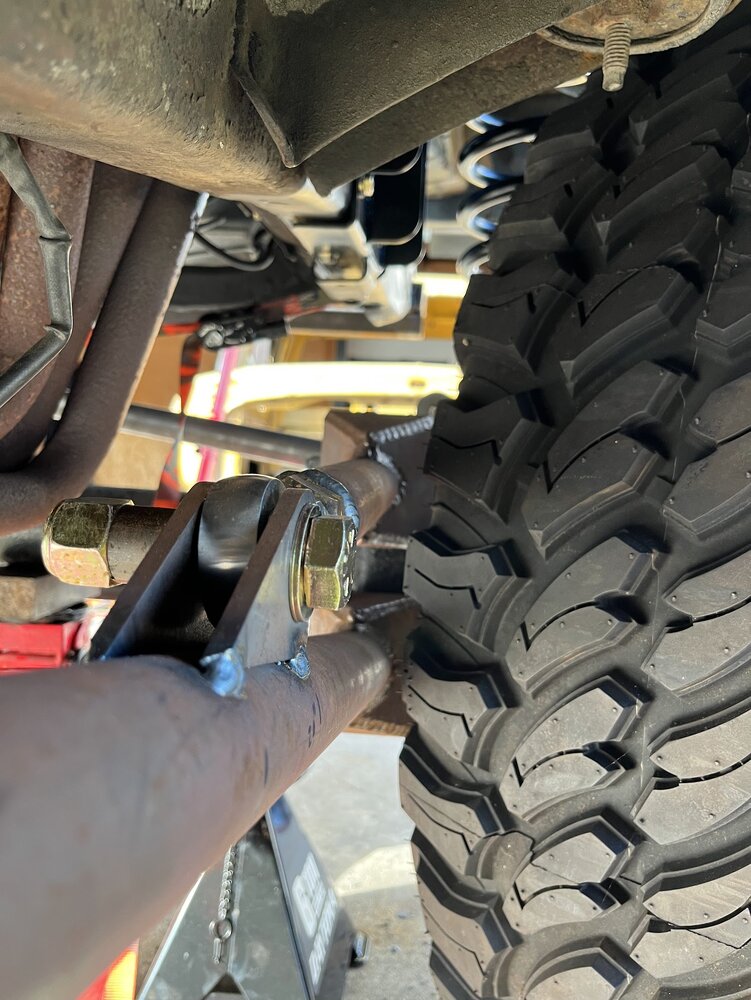

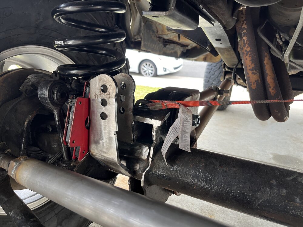

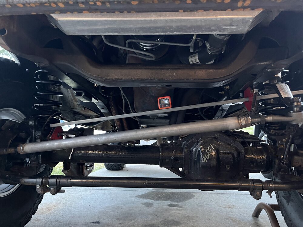

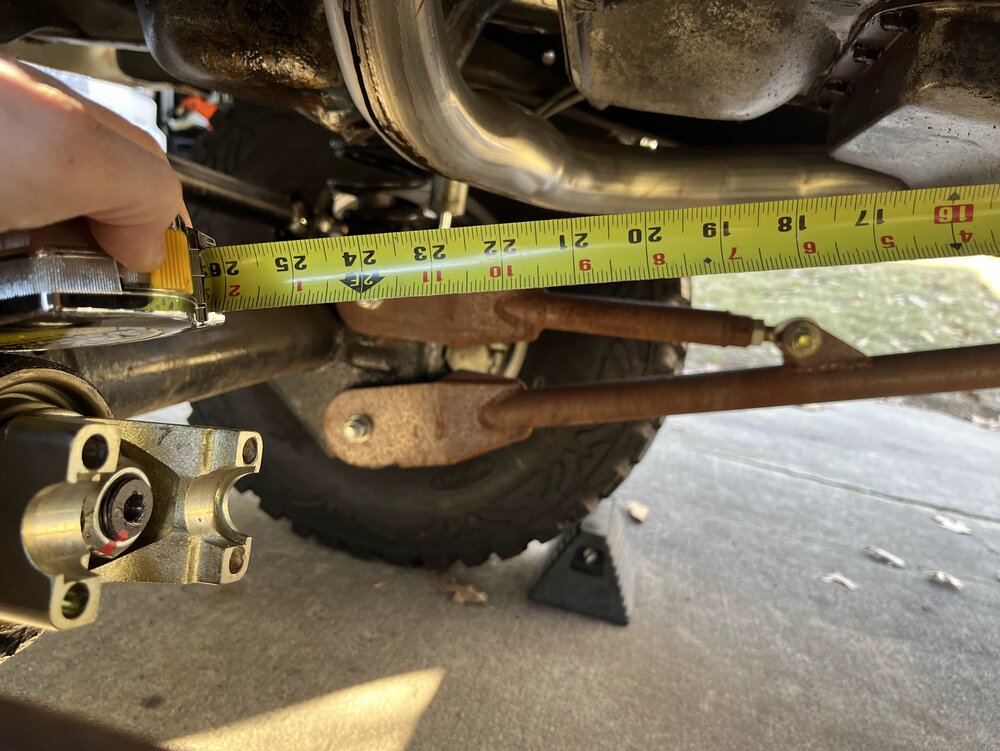

Lining things up for trackbar measurement.
Found my target angle, noting where the mounts need to land.
Axle-side. Grinding out the original mount took a lot of time. I wish I did that ahead of time instead of being lazy.
Measuring the frame-side. I got 8" off the frame before the. mount would hit the tire.
Trackbar mount made out of trailer stock and some plate I had laying around. I had one designed in CAD to have made by SendCutSend.com but I was in a rush getting ready to move.

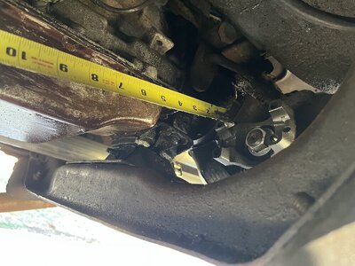

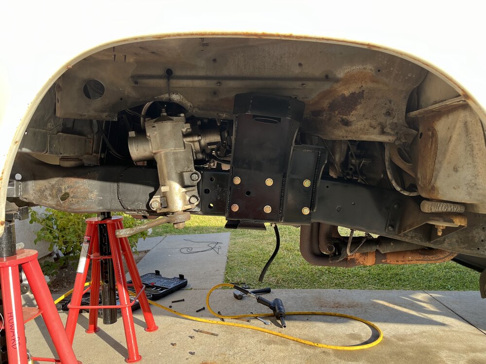

1. To start I would have used a steering box that mounted on the inside of the frame rail to shorten up the drag-link and get the length of that closer to the trackbar if not exactly the same. I'd probably use a newer Super Duty steering box.

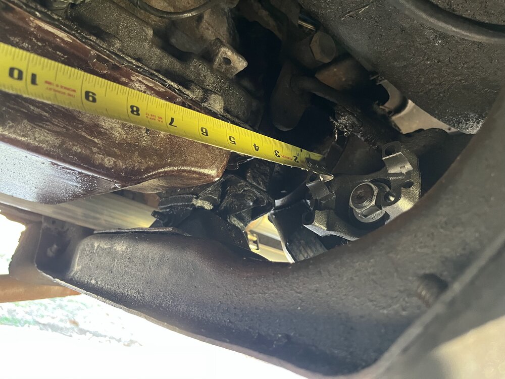

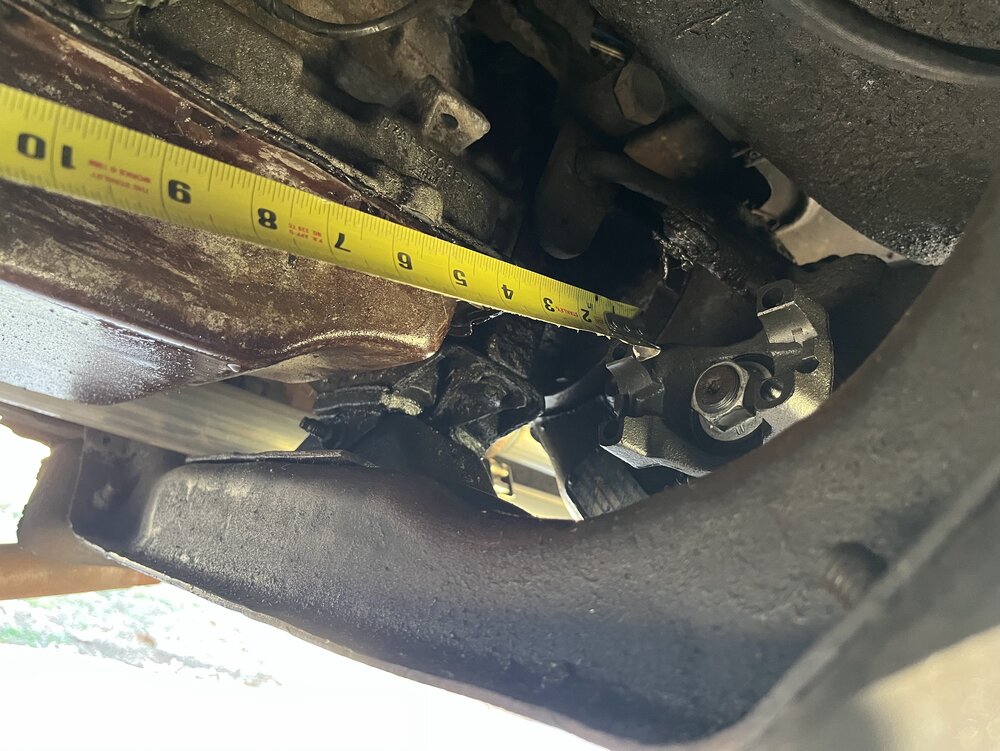

3. The front driveshaft has put me in a conundrum. My C6/NP205 uses the short transmission adapter which puts the front output yoke very close to the transmission body. This means I cant run a CV joint (even a 1310 and I am running 1350). The answer will likely be a Tom Woods off-set u-joint to provide more angle to the single u-joints at the axle/transfercase. The right way to fix this is source the longer transmission adapter and shorten my brand new rear driveshaft.

Last night I (think I) figured out why the truck had no power... hit the headlight switch (which made the dome light turn off) and then went under the hood and started wiggling all the grounds/cables etc. Seems like the cable coming off the solenoid to the starter was the culprit as I wiggled that my headlights came on and everything worked again. Not even surprised since I pulled that out of my buddy's spare parts bin when he helped me stick the remanufactured motor in this thing. I always meant to replace it.. funny how you never get around to those things. Anyway, made a new one out of 1/0 which is way overkill and presented its own problems routing because it's thicker and stiffer but no big deal.
With that said, I'm still a little suspicious as I don't see how that would disrupt power to the ignition switch so if someone has any ideas... going to make more time this week to really go over grounds and check everything over.

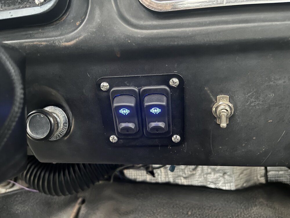

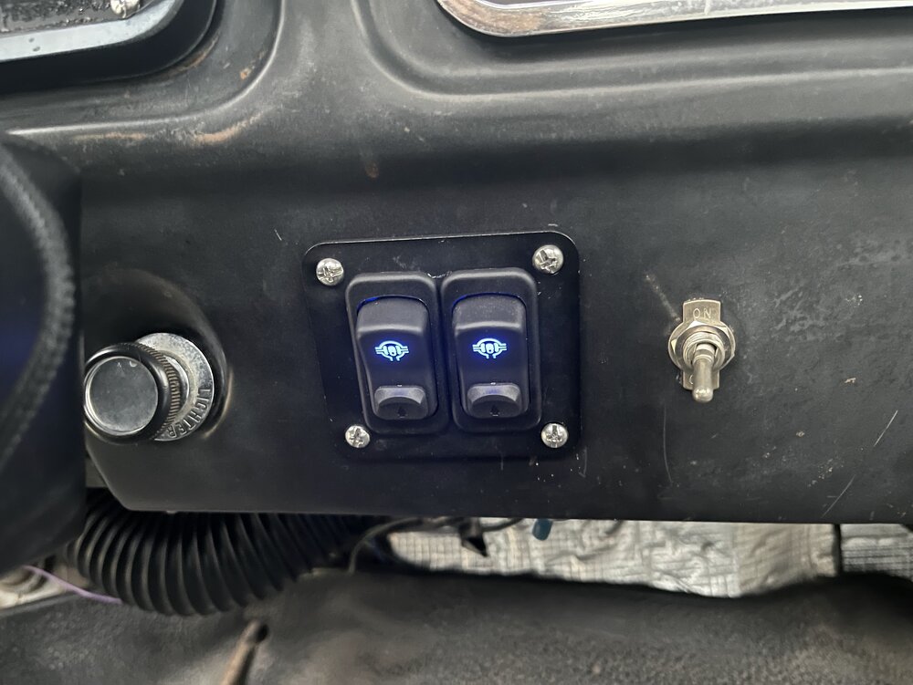

Fast forward to the last few weeks and I finished wiring up my e-lockers using Deutsch connectors (I love these things and will do the next version of this truck using these everywhere I can, especially at the firewall), and then ordered/installed a 2" tube, 1350 front driveshaft with an offset u-joint on the transfercase side to handle the angle/clearance with the transmission adapter.
Frame-flex is doing a lot of work in the video I think but this should get me out on the trail well-enough for now. I may or may not decide to lower the truck a bit (maybe 2" with stock super duty coils and adjusting the shackle flip), I will cut and graft the fenders to widen them, and still need to add limit-straps/bump stops, then rock sliders and probably just a roll bar in the bed instead of an internal cage... depends on when I start building the new chassis on which I plan to "do everything better than the first time around".

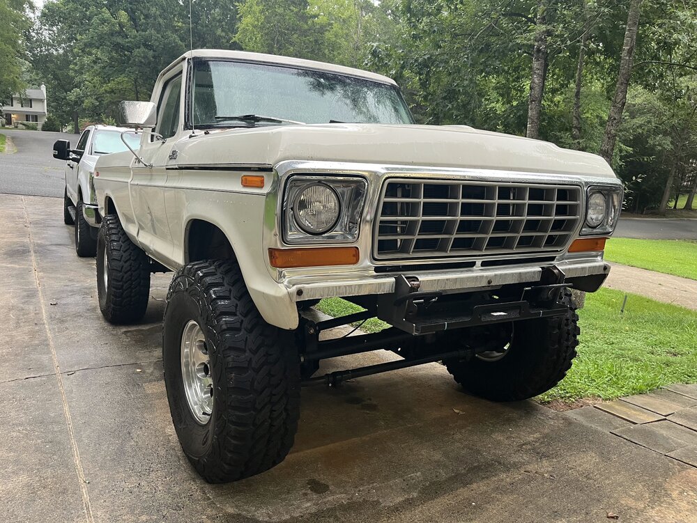

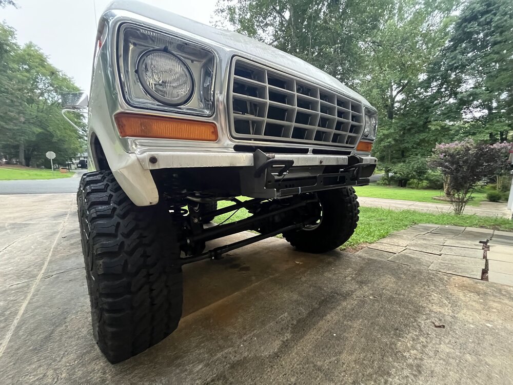

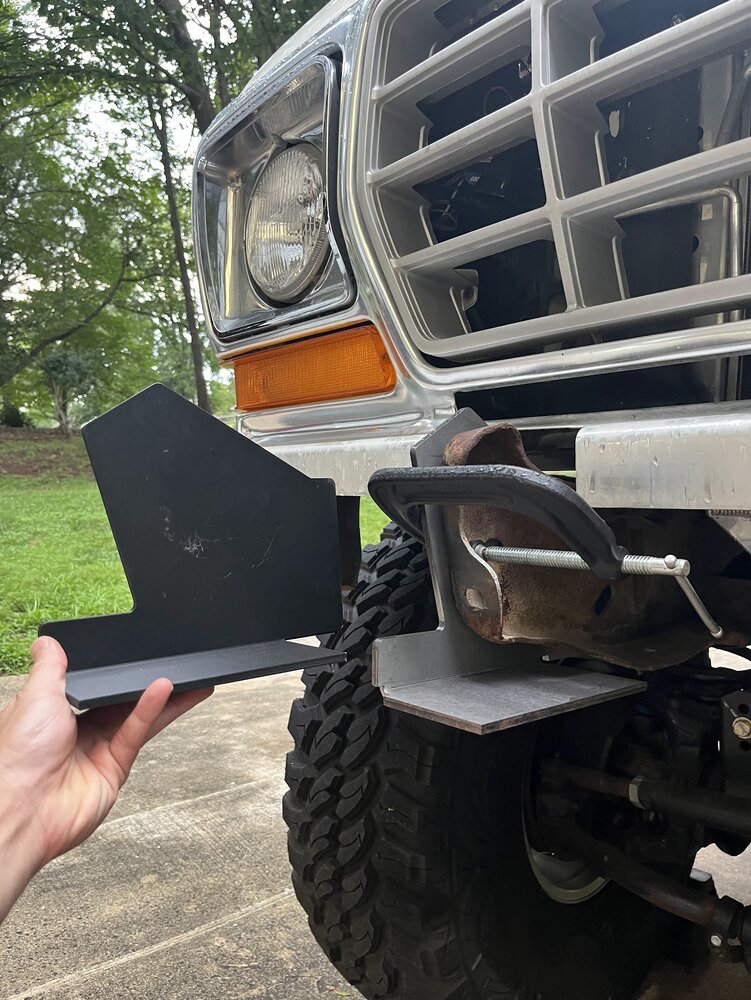

Designed this winch-plate-mount for the front frame horns so I can rest a winch-plate on it and bolt to that to make it removable. 3D printed it first for test-fit, then I sent it to sendcutsend.com to be cut and bent. I originally had tabs for the existing frame horn holes but to bend them it would have interfered and sendcutsend.com wouldn't accept that design. Instead I'll cut a few tabs and weld them to the bracket then drill the holes.

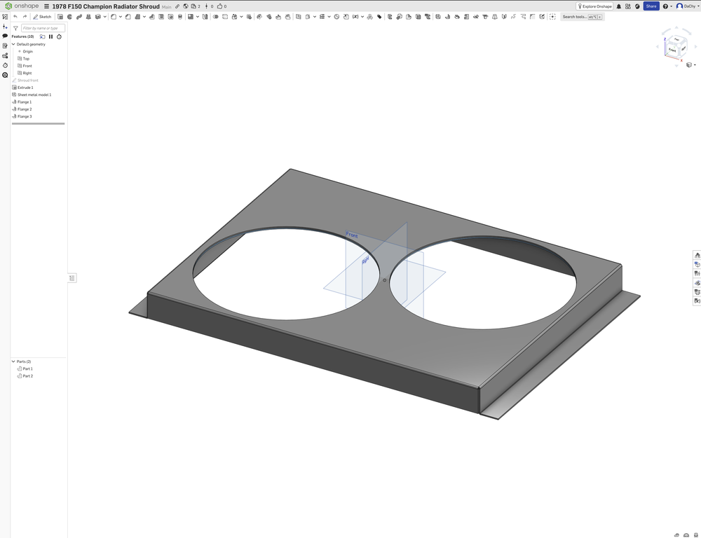

The Lincoln MKVII fan with PWM controller works great but the shroud doesn't completely cover my radiator which makes it run a bit warm up to 210 if I run the AC and drive around town.
I took that as a warning that once I finally take this thing out on the trail it might run a bit hot so I bought a Chevy Volt fan (comes with two 12" brushes Spal fans) and I've designed a custom shroud which I'll send to sendcutsend.com to have cut and bent out of 1/4" aluminum once I get to the re-wiring for the new fan set-up using the Widget Man controller.
The controller isn't very waterproof/dust-proof so I 3D printed an enclosure from McMaster Carr's catalog to mock it all up and test-fit. Pretty sweet feature they have on that site that someone posted about here. Many of their products have CAD drawings available.

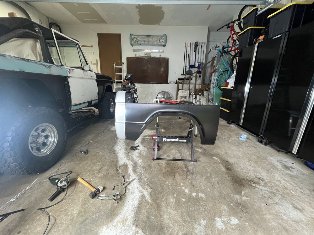

It's slow-going because the 67 Bronco project is still very much taking up a lot of my garage time:
Test fit and trimmed the grill. Waiting on grade 8 hardware. Debating whether or not to add the plates to capture the two frame horn bolt holes on each side. I have three 1/2-20 bolts into the side of the frame rail on each side. I don't feel like those two frame horn bolts would do a ton going through a couple of tabs. Will probably throw a couple weld beads on it anyway.
Annoyingly the driver's side frame-rail is pushed toward the passenger side at least a 1/2 inch. This was never meant to be a restoration but it's noticeable. I checked the other frame for the future swap over and it's nice and straight at least but that will be a whole other beast. This iteration of this truck is all about going wheeling and learning what I like/want in the next one.

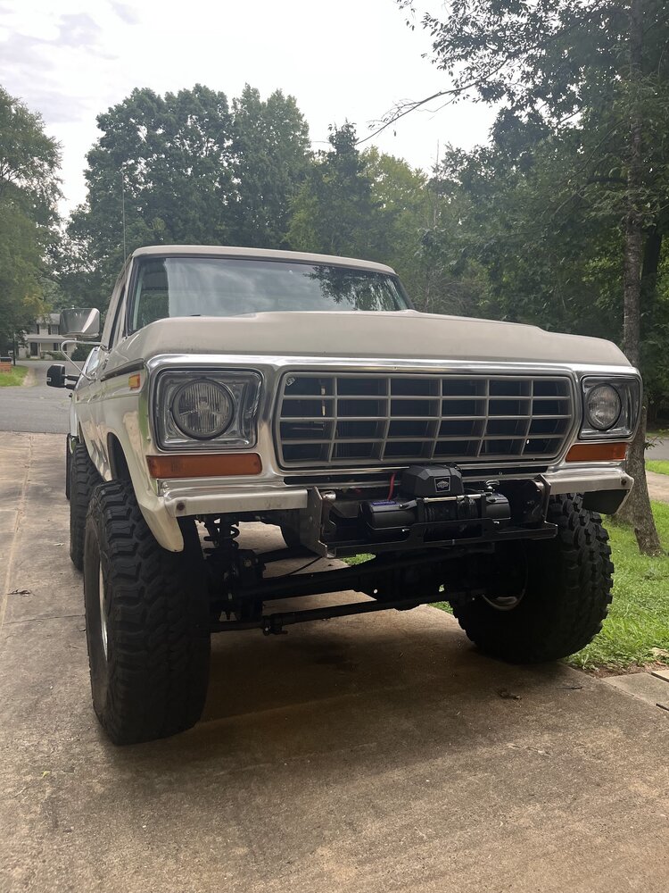

Finished up the winch mount, got it all wired up and working.
