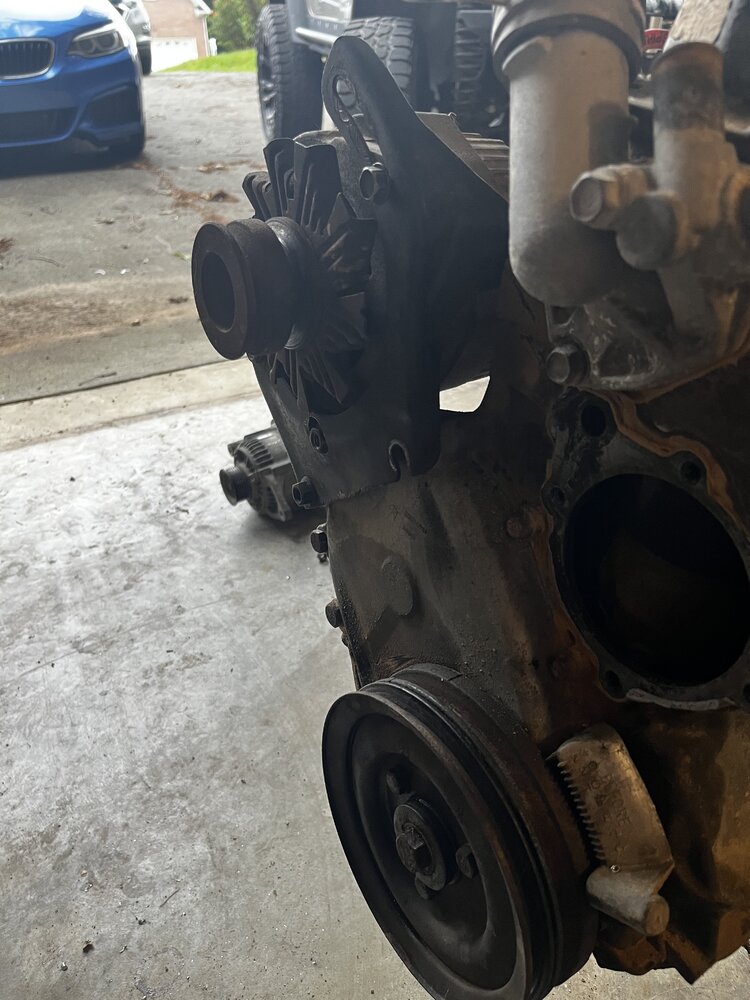

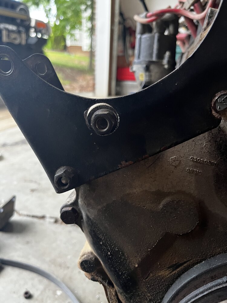

Crank pulley is swapped over. To make the alternator bracket fit and clear all of the front cover bolts a hole had to be drilled for access to one of the bolts.

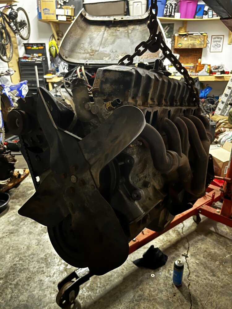

I’ll swing by the parts store and grab a new water pump. The Vbelt pumps spin opposite of the serpentine pumps so that needs to be swapped. Once that is on the accessory side is done since I am not diving into a power steering swap right now.

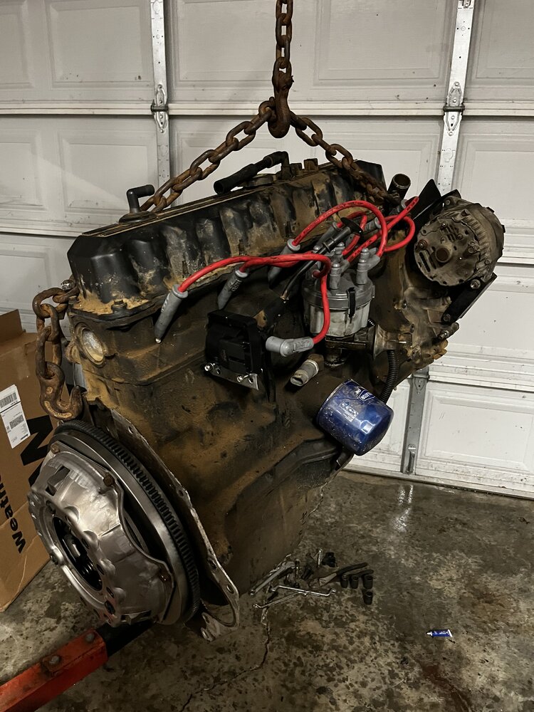

Accessories are done, clutch and flywheel on. Got a line on a few intake manifolds so once that is on it can go back in the Jeep.

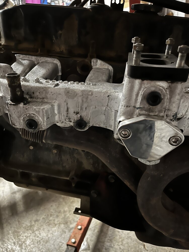

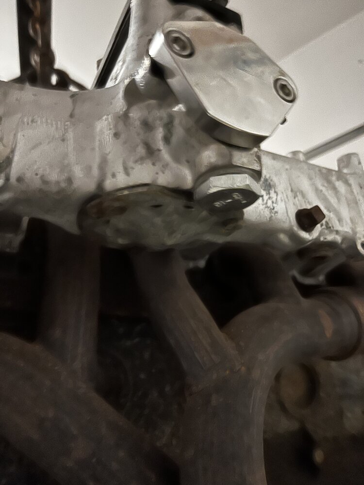

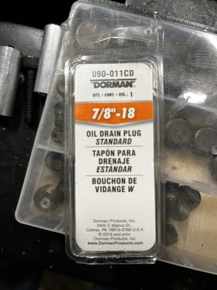

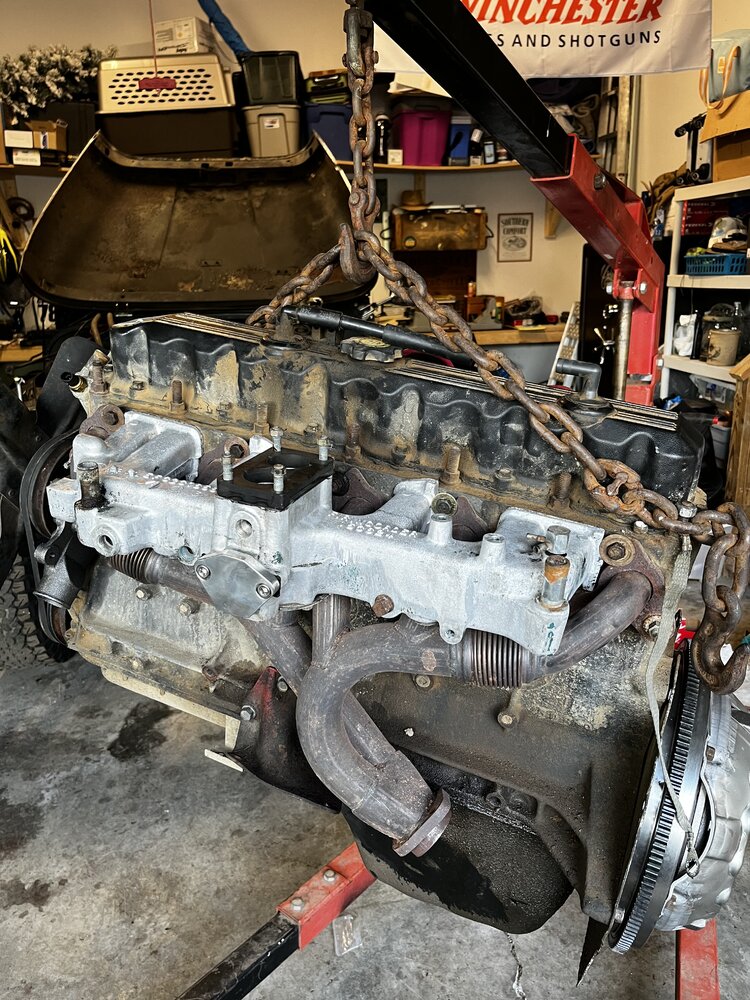

Got the dowel holes ground off and everything loosely bolted up today. I need to make a hardware run for some more fender washers. There is enough difference in the castings and manifold flanges that the oem washers don’t work. Simple fix though. Next was removing the EGR, intake heater hoses and other sensors that don’t get reused without a carb. I’ll figure out the thread pitch and size and get some plugs from McMaster to clean up the holes they left.

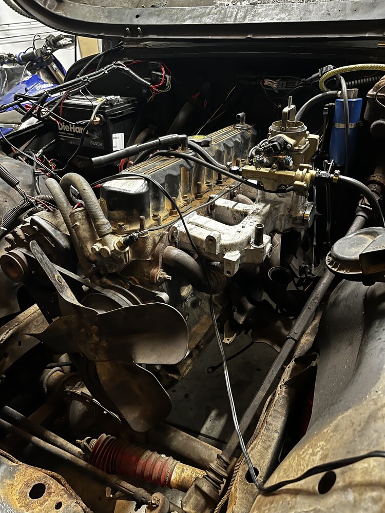

Work has been whipping my ass so this sat for a few weeks. Over the weekend I got the garage organized and the engine sat in place to where I could start on it again. Tonight I was able to get everything hooked back up. So far minimal hardware leftover and it’s been fairly uneventful. The battery wasn’t charged enough to make the Holley happy so it’s on the trickle charger and will hopefully fire up this week sometime. Once I know it’s running I have some fittings and routing on the fuel lines that I want to change.
