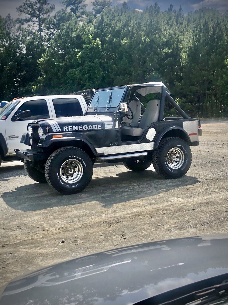

So little update, I’ve had this thing back at the farm for a month or so driving it around. Little oil consumption has become big oil consumption and a little miss has become a bigger miss. Going to try to do a compression and leak down test next weekend but freshening up the engine may happen sooner than I anticipated. 🤣 this is a stupid hobby.

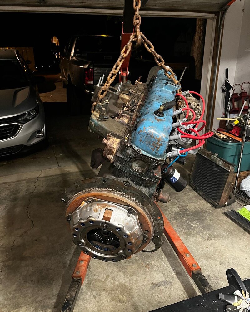

The 4.0 long block will get my 4.2 intake, Holley EFI, TFI ignition and a fresh clutch using the 258 flywheel to maintain the proper depth for the throw out bearing. 258 starter will also be used.

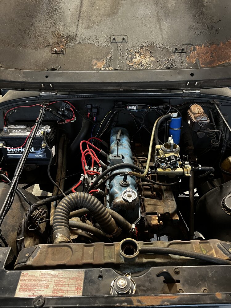

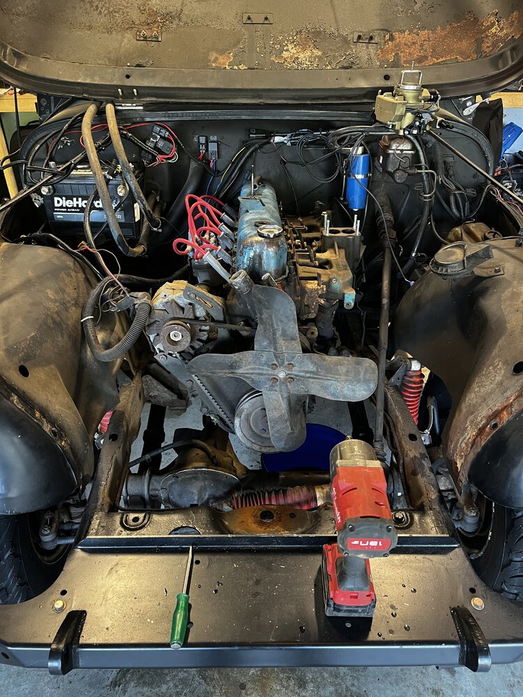

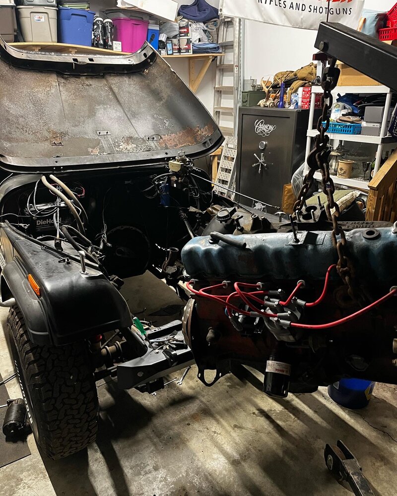

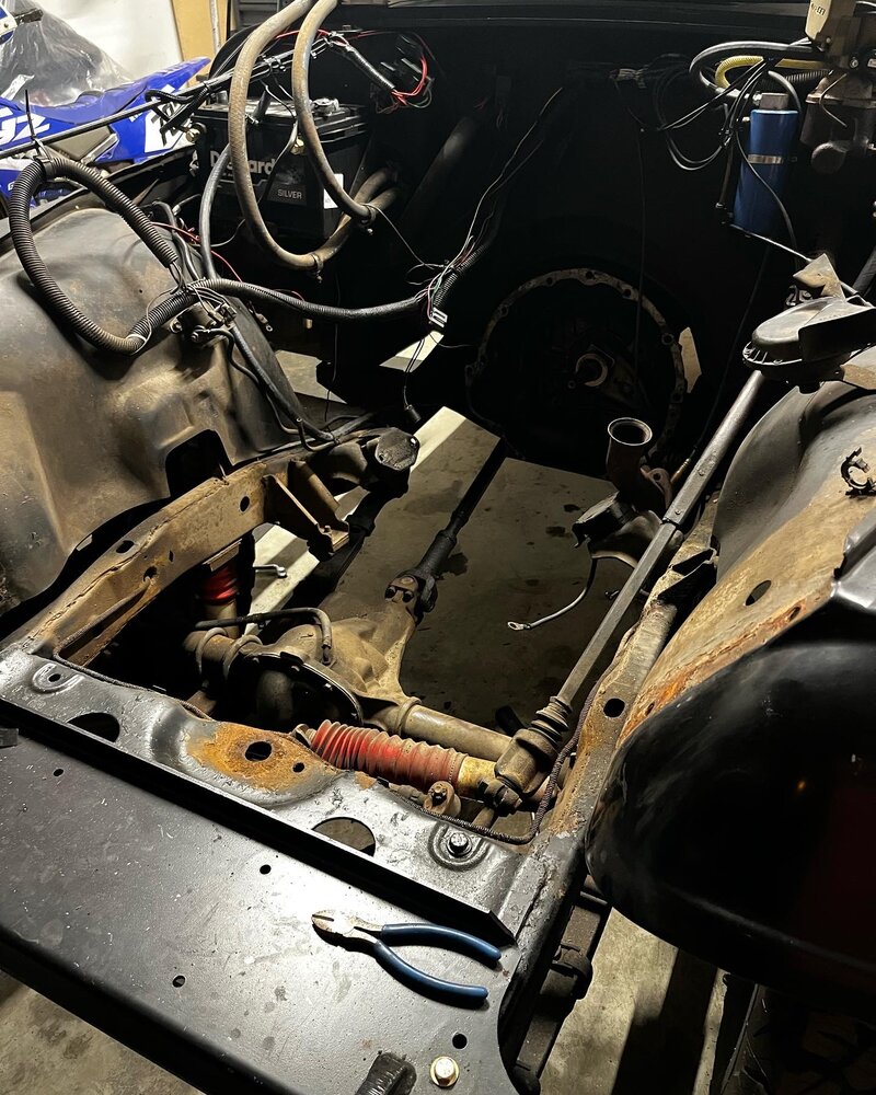

It’s home and tear down has started. I still need to bring my engine hoist back and get the donor engine from @tobaccoroad4wd’s shop but this gives me some time to label everything as it comes apart. Tonight I was able to get the coolant drained, radiator out and the wiring out of the way so I can pull the grill. All of those bolts are currently soaking in PB for another night.
Grille came out without much issue. Everything electrical and plumbing related is disconnected and zip tied out of the way. The coolant temp sensor that goes in the block for the Sniper has been pulled and set aside. The same goes for the O2 sensor, clamps and gasket which will go back into the new exhaust. I still need to make a decision on the muffler but it will not be a cherry bomb that dumps under the tub like it does now. The drone is audible over wind noise.
I will swing by the store this week and grab a clutch kit and flywheel. At this point I just need to bring my hoist back and pull a few final bolts.

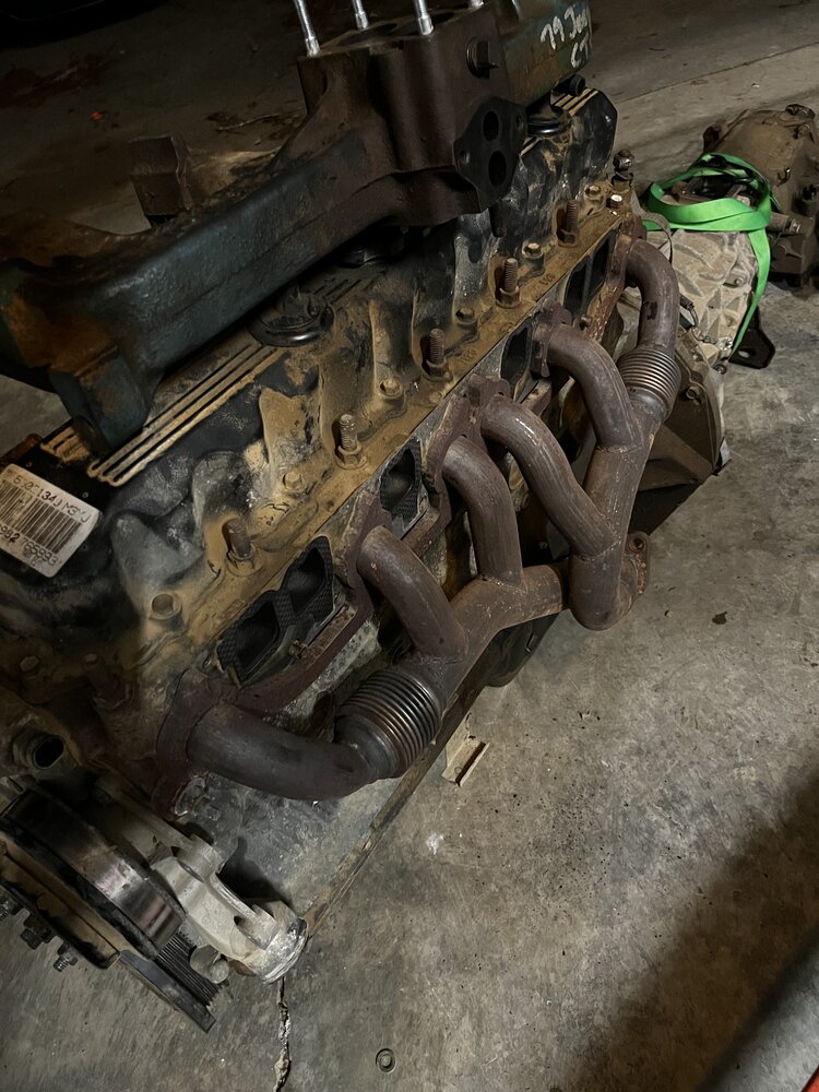

Got the new to me driveline back to the house tonight. I started by removing the intake, power steering pump bracket and motor mounts. Then pulled the intake off the 4.2.

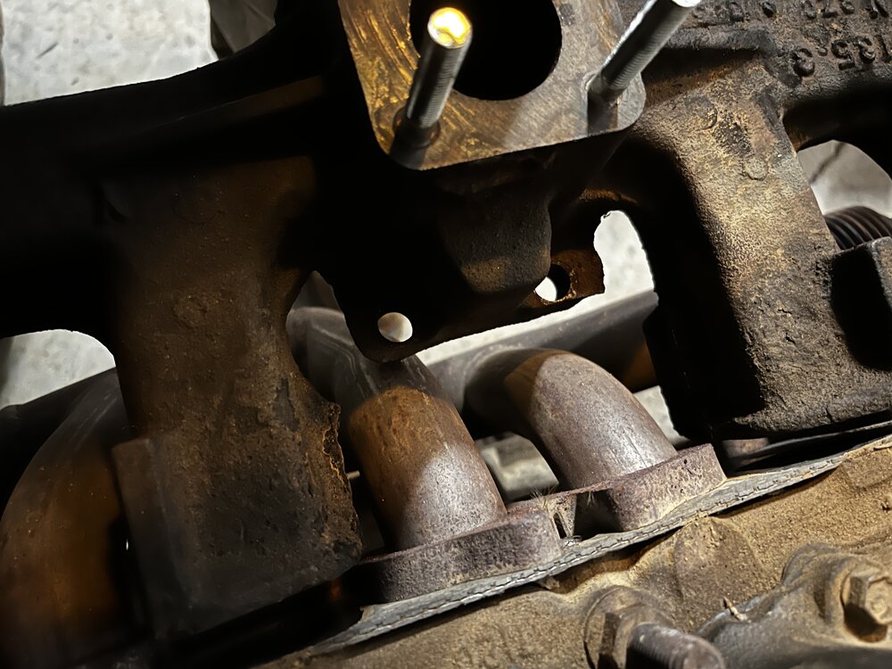

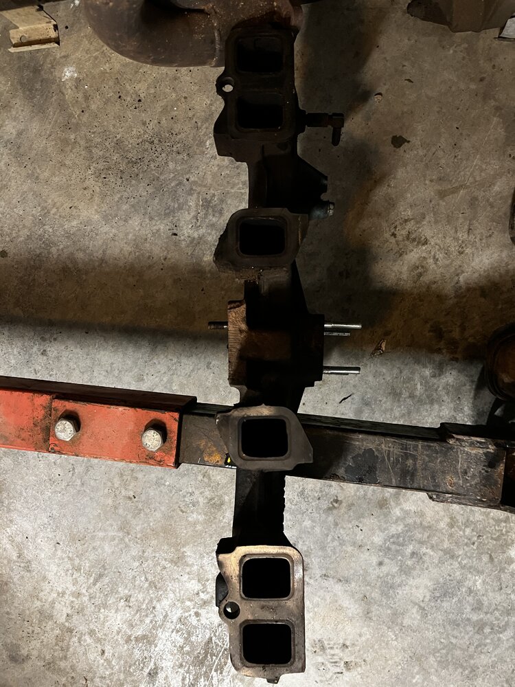

Here you see the few spots that need grinding. I will knock that one corner off of the manifold to clear the header then reinstall the EGR block off plates. Next step to the 4.2 manifold on the 4.0 head is to grind off the dowel holes so they’re half moons. They will just sit on the dowels for the 4.0 head to align the ports rather than sit in the holes. It’s not perfect alignment when it’s done, but it works. It will take some oversized fender washers to pinch everything like the OEM washers with the larger gap between flanges with this setup.

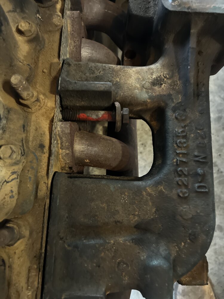

First hiccup. The bosses that catch the manifold bolts and washers are a different depth…only on the cast iron pre-81 manifolds like I have. On the hunt for an 81+ aluminum manifold where the bosses match the exhaust flange. Solveable problem.

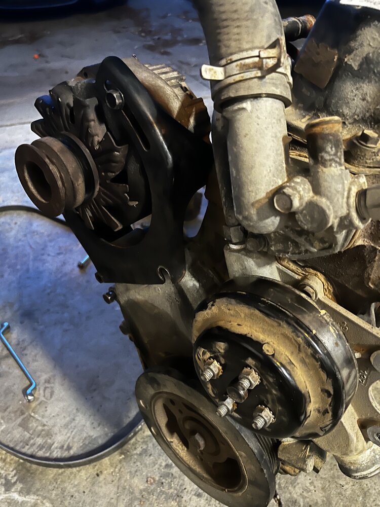

I moved on to the accessories. A few small notches and some washers to shim with will be needed to clear/reinstall bolts in the front cover but the alternator bracket bolts up just fine. The water pump needs to be swapped over to a forward rotation pump since the serp belt spins the other way. The crank pulley will be changed out to the v belt pulley and that should do it for the accessories.
