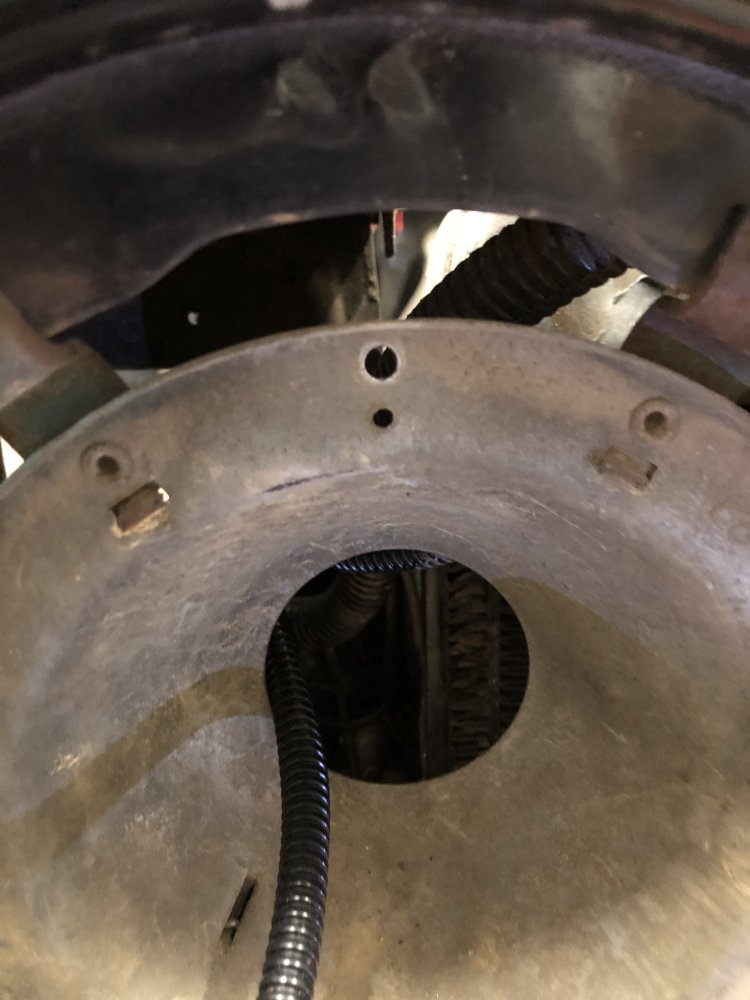

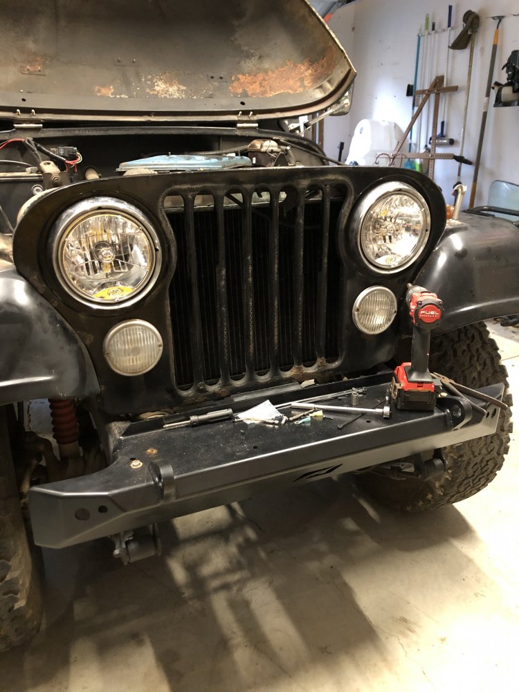

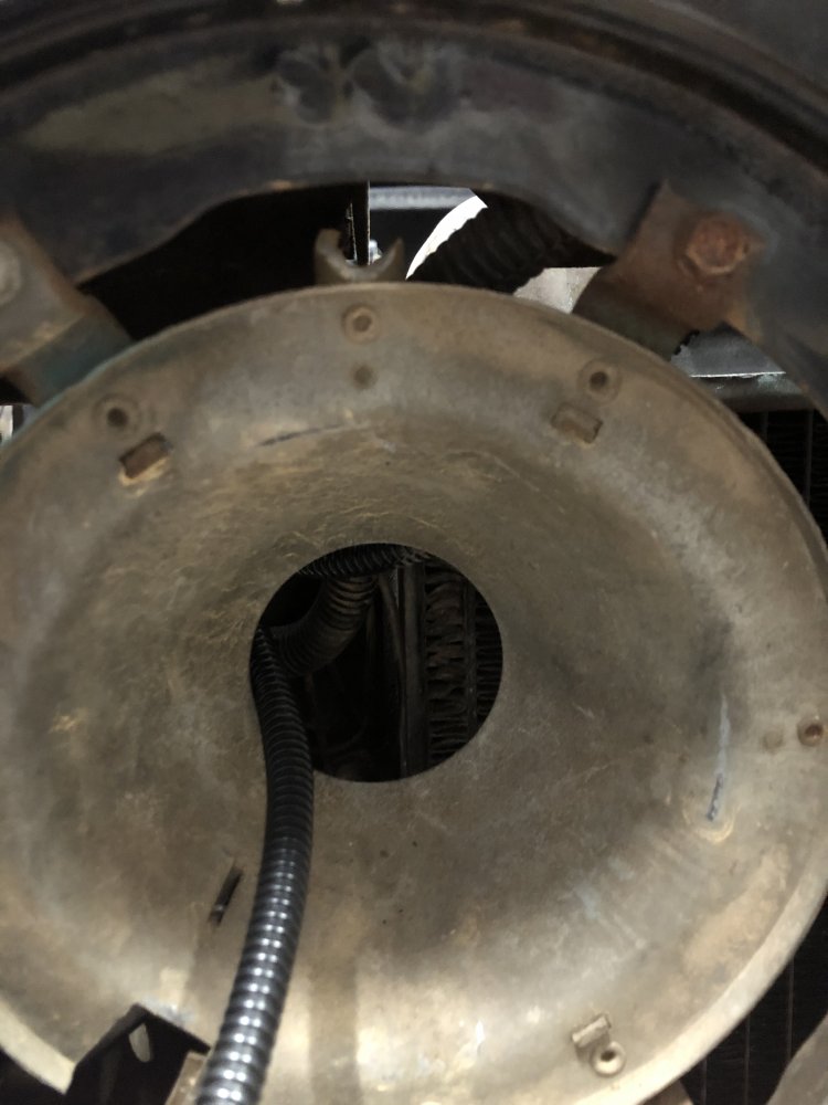

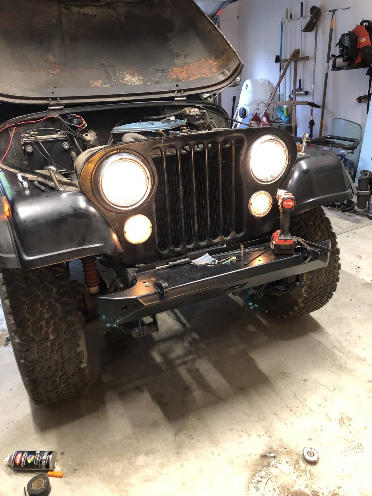

Got a chance to finish up the H4 headlight swap. It’s very straightforward using the Painless relay harness. There are a few cheaper options for relay harnesses, but I returned them after inspecting the harnesses before install. Loose connections, bad soldering jobs etc. No OEM wiring has to be cut with this harness and it is all plug and play.
I had to replace one headlight adjuster. Drill the old one, bolt the new one in and move on.

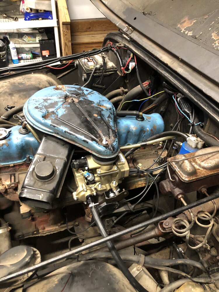

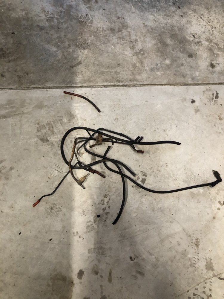

Next, I got started tracking down all of these loose vacuum lines. These are all of the lines that were unhooked, capped and/or hanging around the engine bay. They’re all dry rotted or swollen so even if they go back on, they’ll be replaced.

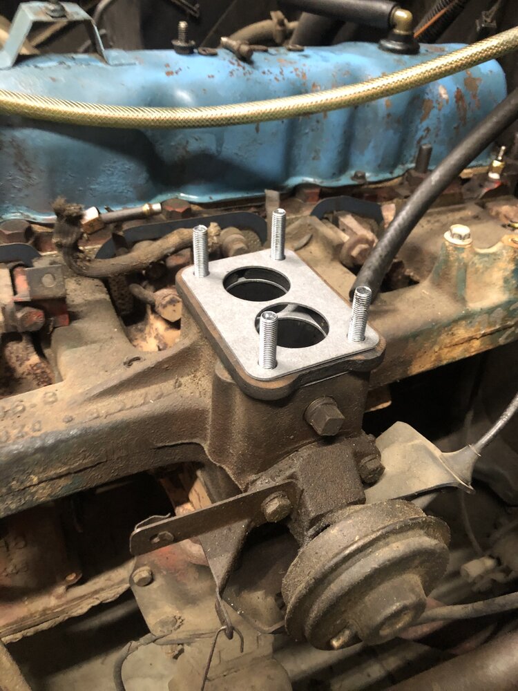

Got started on the EFI swap tonight.

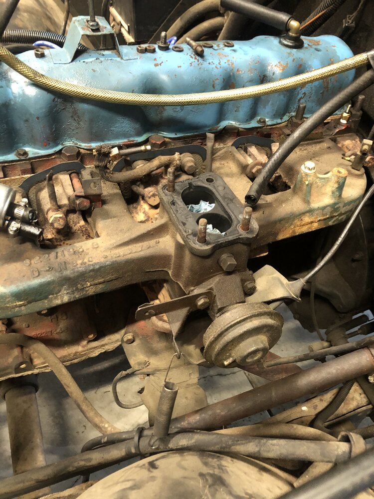

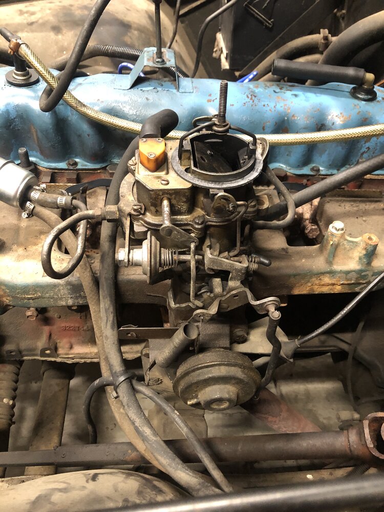

Removing the old stuff is straightforward. Just be sure to label any hoses that will get hooked back up. Since this one was partially smog deleted and doesn’t have a vac brake booster, the only vac line to hook back up is for the distributor advance.

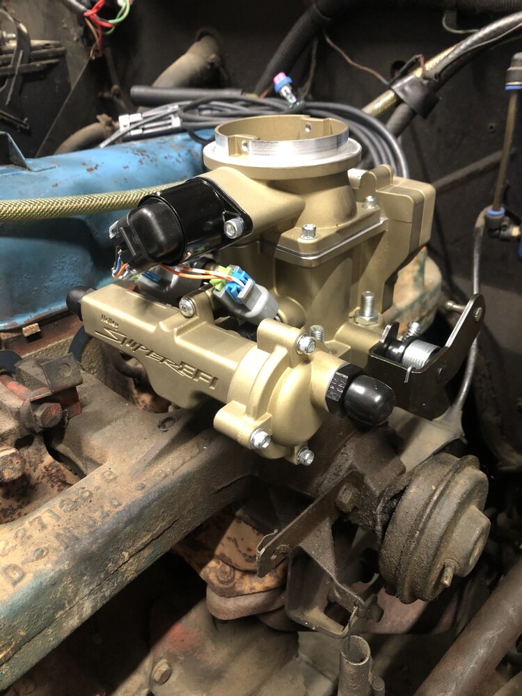

Remove old carb, clean gasket surfaces, install new studs and gaskets, drop on the Sniper. Have a good swivel and 1/2” to get the flange bolts back on as it’s tight on the passenger side to clear the TPS. Block off the stock fuel pump with a plate from a Chevy big block or any number of other plates/gaskets that fit. This is one thing the kit doesn’t come with.
There is a plug in the block under the intake manifold that fits the new temp sending unit for the Sniper computer perfectly. Just be quick with the new one ready to go in unless you’ve drained all the coolant.

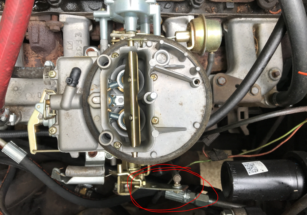

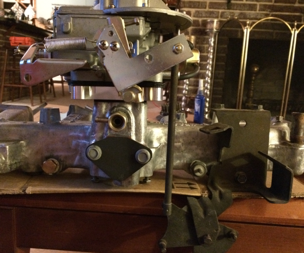

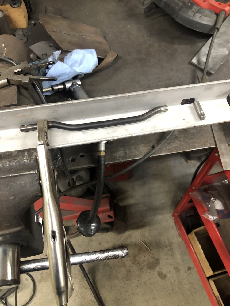

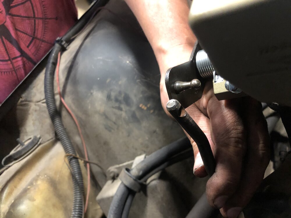

The only pretty asinine thing with this kit is the throttle linkage on the throttle body end. It faces the passenger side. Factory carb setup, the pin faces the drivers side. They could at least make it threaded instead of splined and pressed in so you can change the orientation to fit multiple styles of linkage rods. Results may vary if someone has swapped to an MC2100 or Weber and has already rebuilt their linkage, but for a kit marketed to replace the stock carb, this is a dumb but solvable problem.
Still need to finish up the fuel plumbing, wiring, cut and turn the stock linkage arm, block off the EGR and install the O2 sensor.

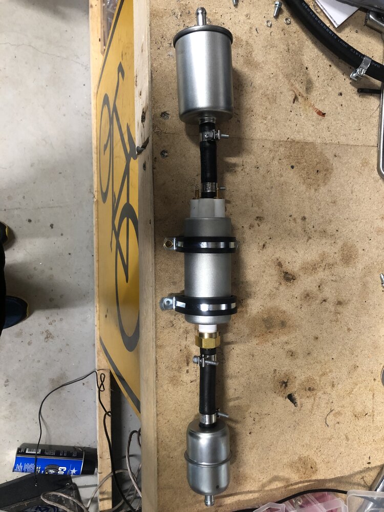

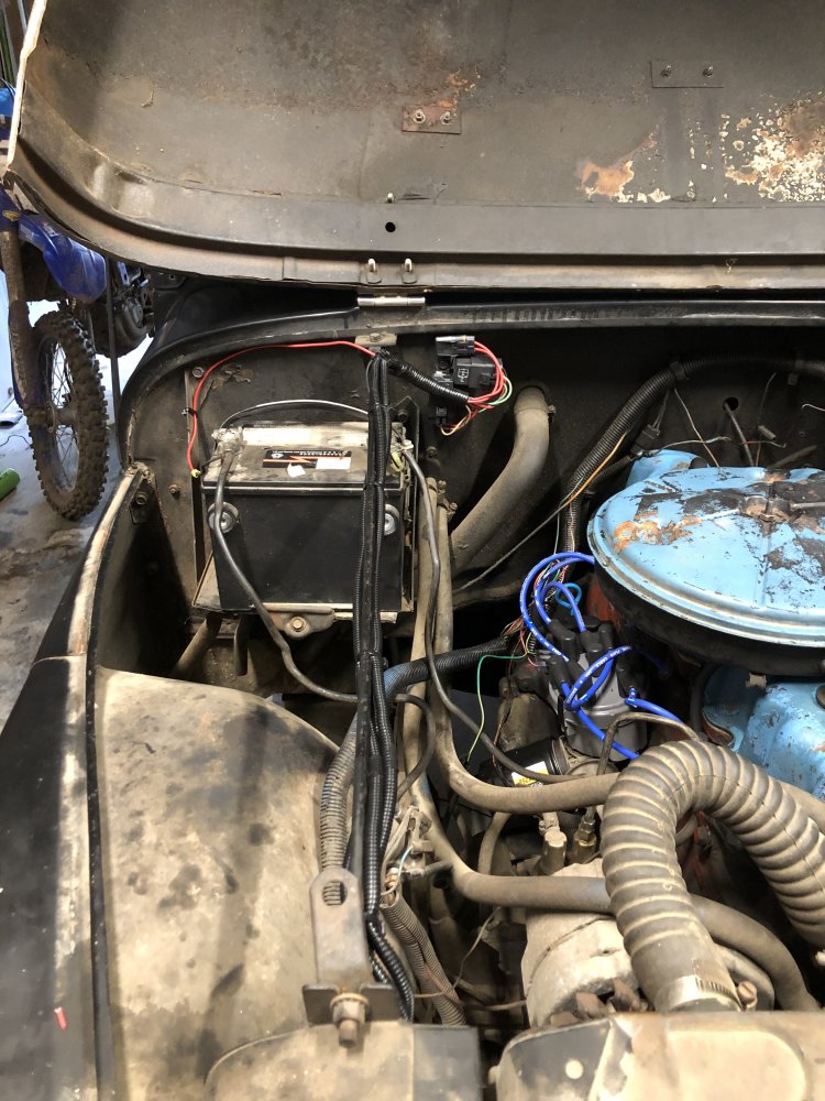

Got the fuel system plumbed and wired in tonight. All that is left is to figure out a good switched 12v source thats hot during cranking as well to trigger the relay, drill in the O2 sensor and modify the linkage arm.

Got home tonight and tightened up the last few bolts and wiring connections. It fired up on the 3rd crank…after I unreversed the fuel pump. The relay trigger requires a switched 12v that is hot during cranking. I tied it in to the windshield wiper circuit at the fuse block with an Add a circuit. Simple, easy to access.
The startup is simple. Scroll through a few menu options on the touch screen for which kit you’re using, set your displacement, ignition style, idle rpm and send the settings to the ECU, it does the rest.

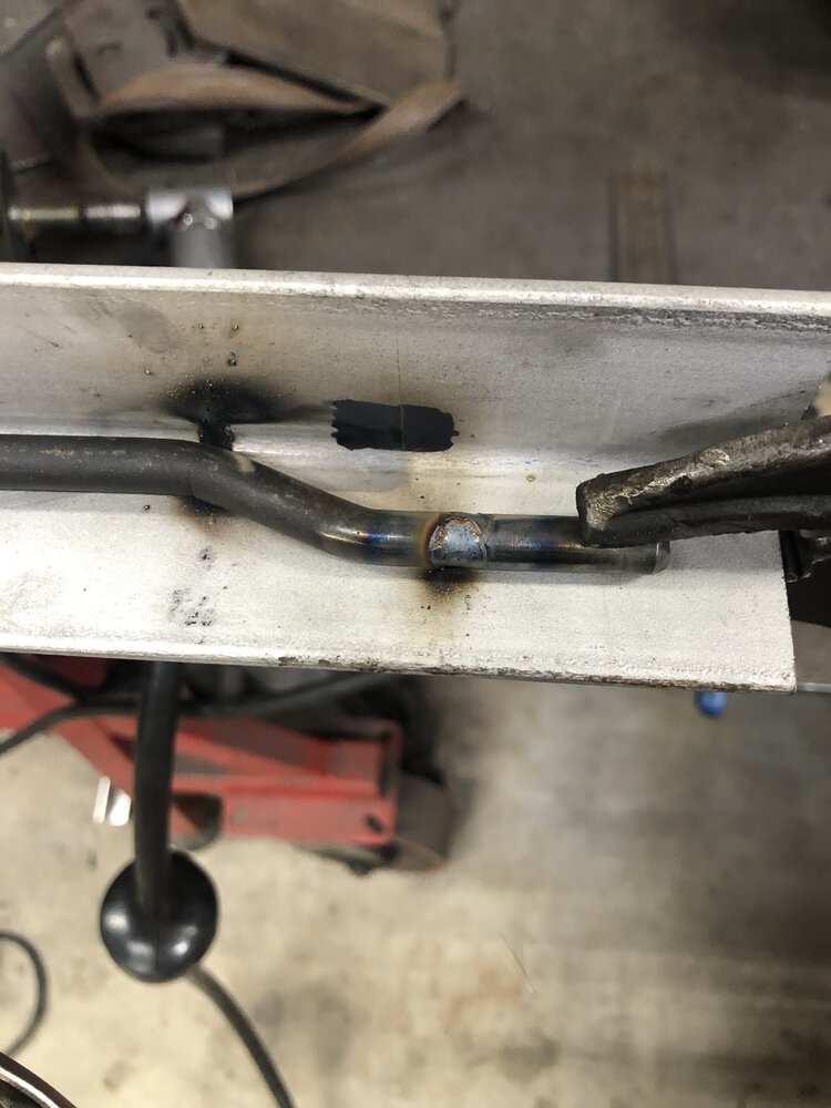

A beer and running some parts to @stinkbomb and he fixed the linkage issue for me.

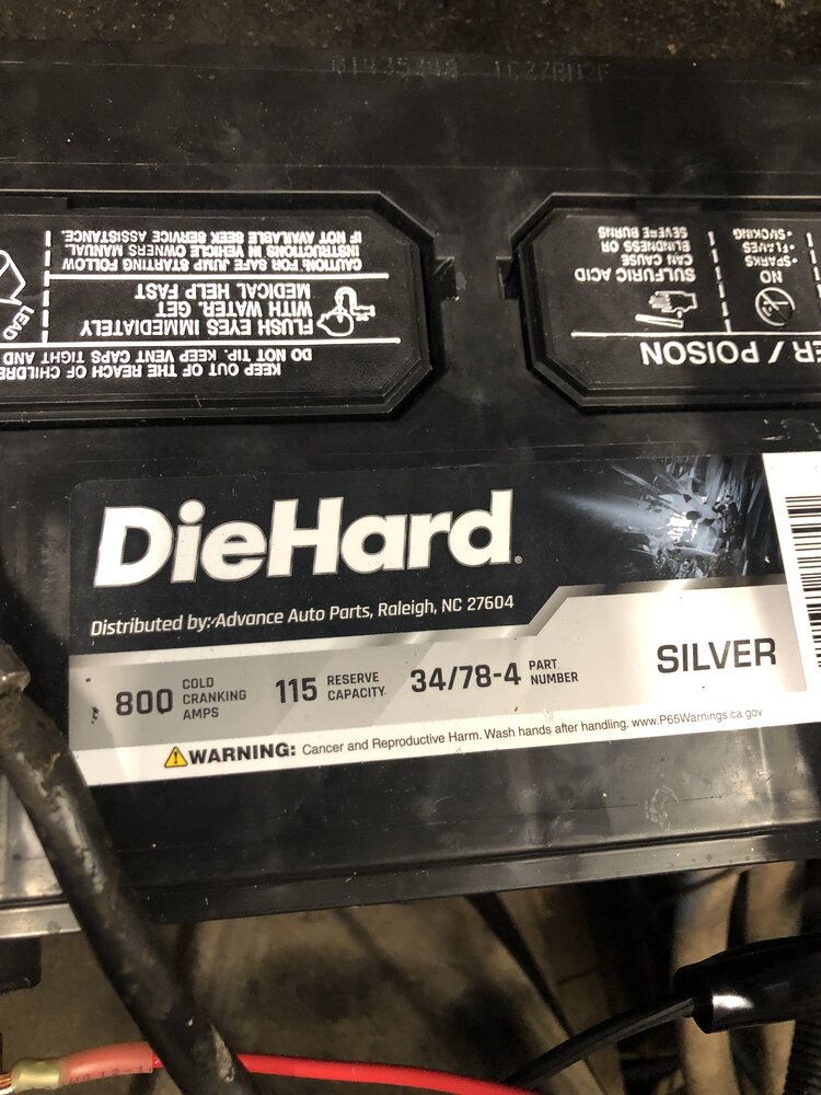

The only thing I need to get dialed is the starting. Holley is very clear that it needs 12v during cranking and it’s slow to start from time to time mainly after driving. I’ve kept it on a tender since we got it so I’ve probably been masking that issue at cold start. The alternator is charging and the monitor is reading 13-14v when running. But the battery sits around 11.8-12.2 unless I keep the tender on it overnight. It’s dated 2016 so I’ll swap it out for good measure, replace the terminals and clean up all the grounds.
Much more consistent starting and a LOT faster engine turnover than the old 450cca battery that was in it.
