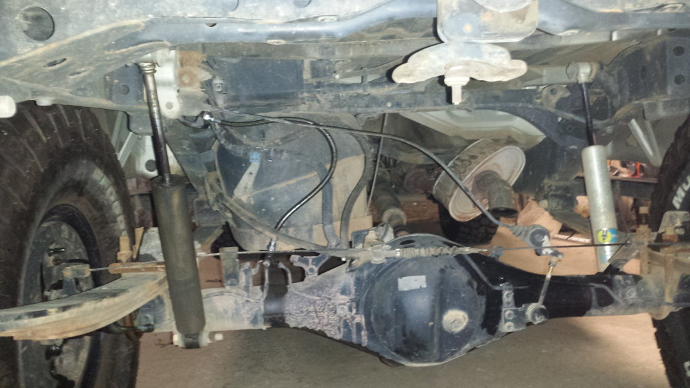

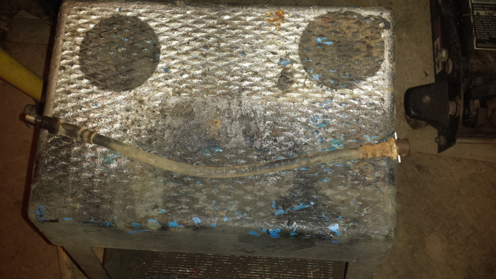

Anyways finally installed my new rear brake line from toytec. A lot better than the old stretched factory piece. Need to swap the front hoses out for new braided ones, pedal is still a slight bit soft for my liking.
Old short hose

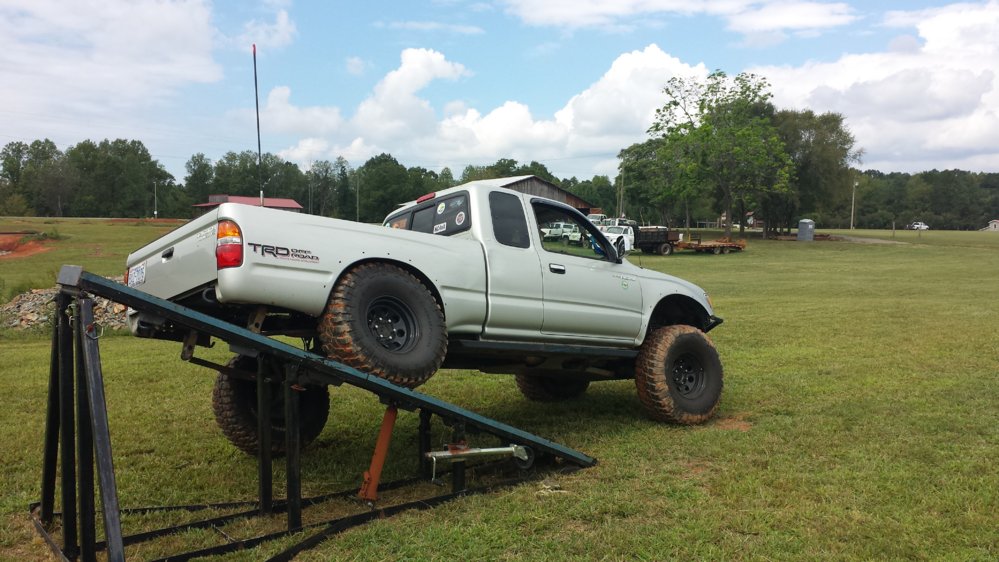

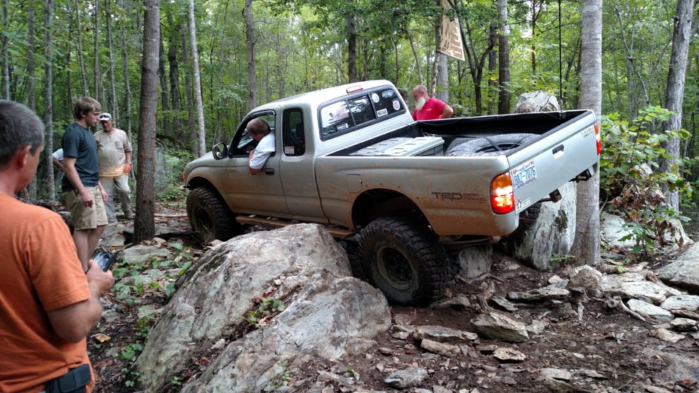

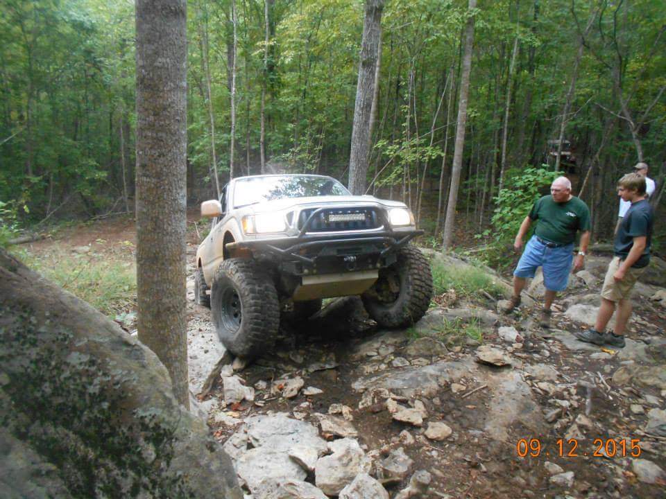

Finally got some more wheeling in and the truck let me know countless times how much I need to regear. Still did really well, can defiantly tell the increased clearance of the 35s. Hit the skids and sliders way less than usual. Anyways on to the few pics I have.
This was a redemption spot, never made on 32s or 33s. Just needed a little bump with 35s.

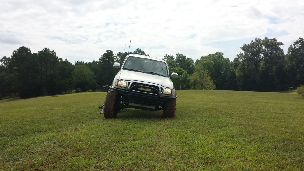

Some flex shots of the shitty ifs flex.

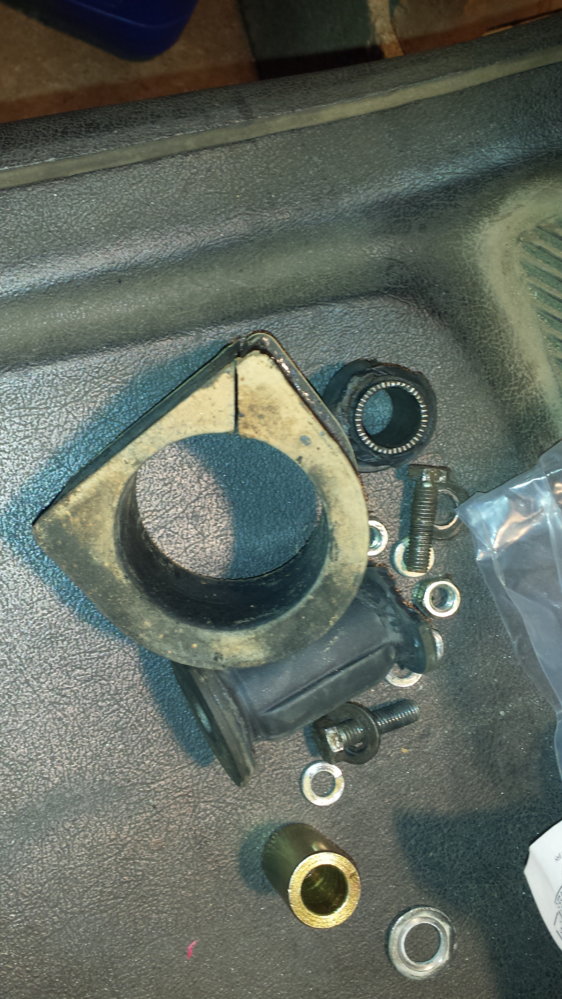

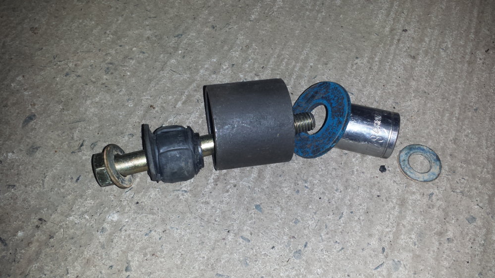

Also last week got my poly rack bushings. Tighten steering up some but need to do the steering column mod and check my itre. Think the tire rods are showing their age finally.
Old rubber bushings
Easy way to get the vertical bushing out

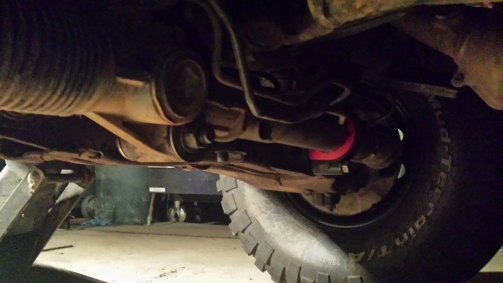

New shiny red bushings, hear it adds hp
Those poly bushing tighten it up a good bit, but also point out the weakness of worn TRE's. What is this column mod?
The steering column slip shaft has some play. If you ever hear a clunk in the steering off-road it's the play in that shaft. The fix is to pull it apart and tack weld it so it doesn't have that play anymore. It'll be a few weeks maybe more till I do mine but I'll take pics when I do. There's a write up on TacomaWorld I think.
