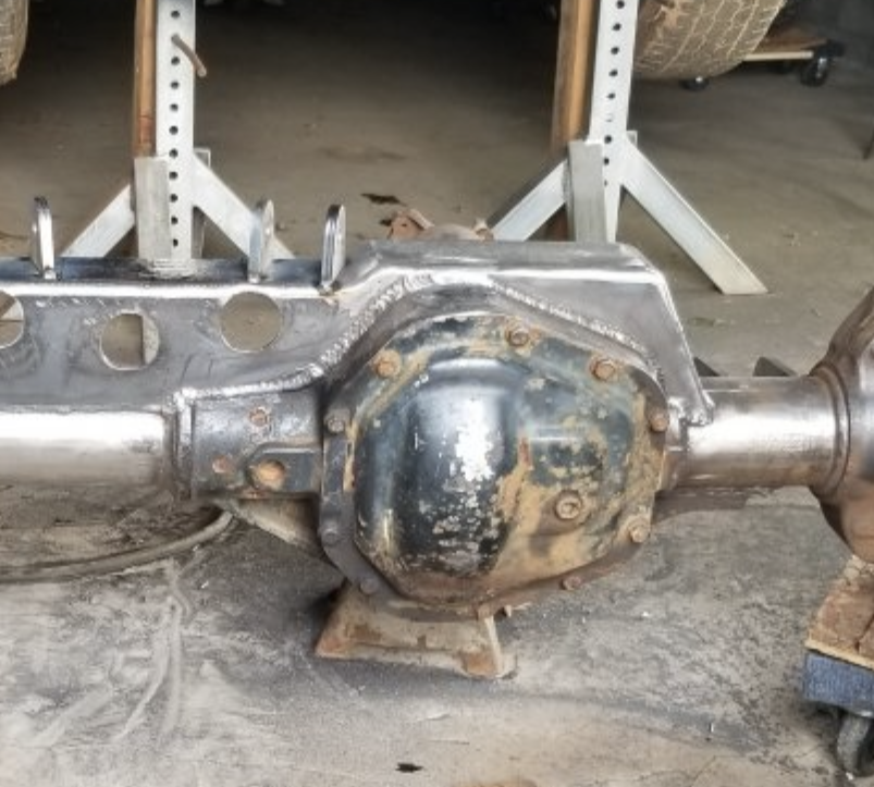

How does a “low profile” truss affect suspension performance?
The chassis side mounts are already figured out on the goatbuilt subframe. So I haven’t messed with a link calculator. And it’s designed to clear the motor so I assume I don’t need a truss to stay low profile.
Does the truss need to weld all the way around the casting? Like fuller did?
Truss doesn't "need" to weld all the way around the casting. A low profile won't affect performance. You will get more strength out of a "standard" height truss and you won't have to worry as much about the forces on your upper link mounts since they won't be as tall/cantilevered off the truss.

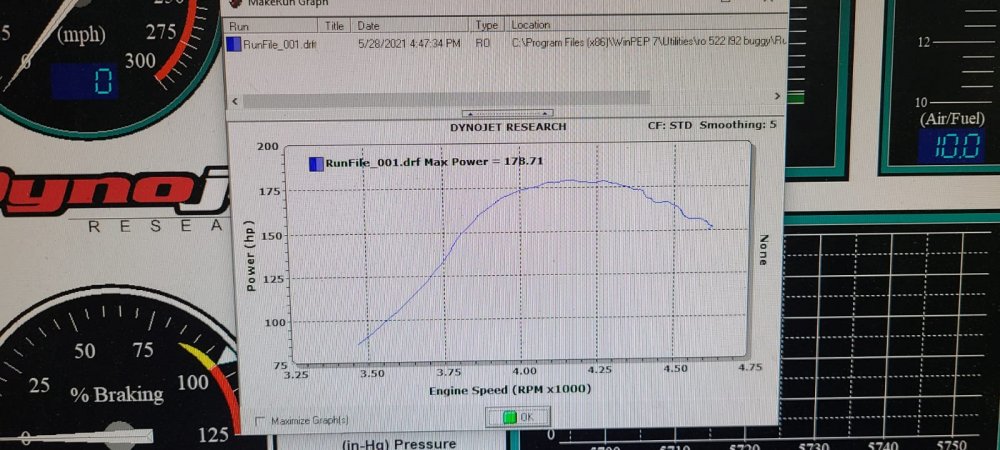

Hopefully around 400-450
So like Derek is learning today......around 165hp to the ground once it goes thru the trans, transfer case, axles and stickies
Pretty much right. The TH400 robs a bunch of power
