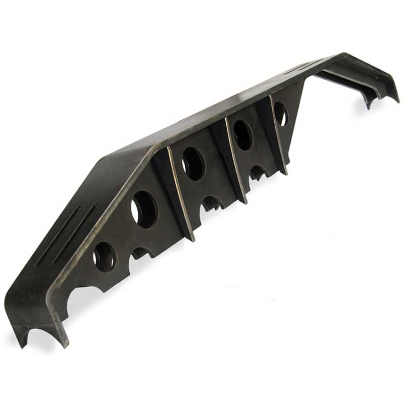

I don’t like TMR’s truss from just looking at it. Doesn’t leave a good place to mount coil overs to.
do you have a link to Artec’s? All I could find was their low profile truss.

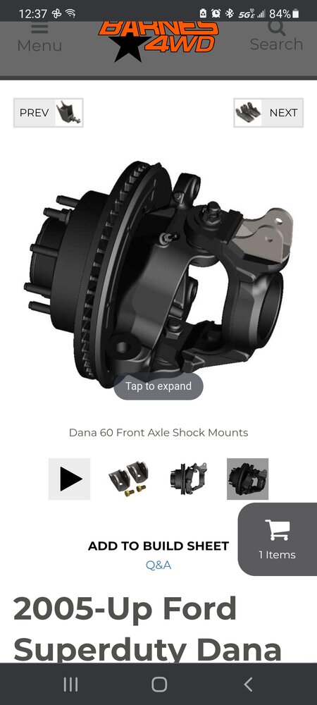

You not gonna run these mounts for the coilovers?

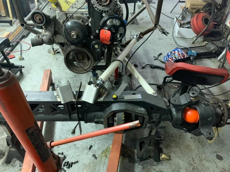

You don’t get a lot of room to drop the coilover mount on the drivers side. I plan on using OE Ford steelies so I didn’t put them out on top of the knuckle. If you put a truss all the way over to the DS knuckle then you just have to build on top of it. But I am just a fucking web wheeler so I don’t know what I am doing.
I’ve got that setup for my swap, but I’m curious if that will have negative effects on how well the shock responds since it’s so high over the centerline of the axle. Also curious on anyone else’s thoughts on that line of thinking. I got excited when I ordered them so I could be one of the cool kids with coilovers sticking through the hood.
This is the truss I'm running
Edit* Read the bright red print at the beginning of the description of the truss
I like this truss, would just need to build up the passenger side where the upper link mount is.
cut that factory coil spring perch off the C or mount the shocks off the back of the truss/front of the truss. How would you set up a mount for coil overs and bypasses with this axle?
not doing it right off, but down the road maybe.
building the chassis to accommodate for trailing arms in the rear and bypasses up front in the future just in case.

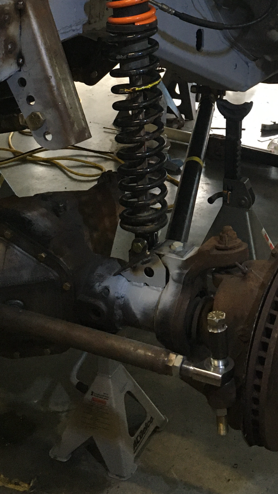

Those are the same as the mounts in my WFO SAS kit. I can tell you that they work great with a radius arm setup. Not sure how much different a link setup would be.
I like how the other setup was just inside of the inner Cs too though. Definitely gives you more room vertically if you can spare the room on the width.

Going in a buggy. Axle will clear front of motor so no need for low profile truss.
