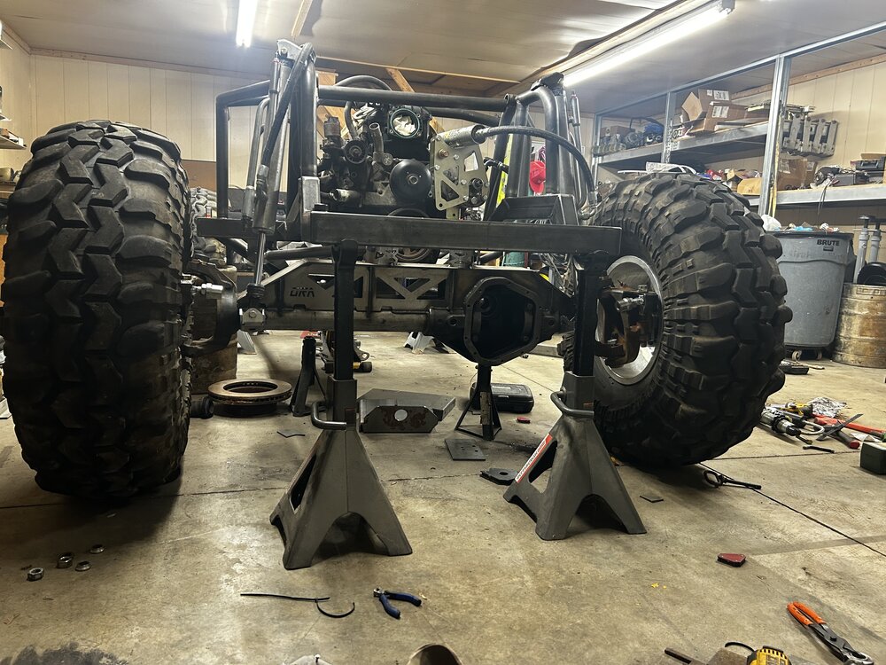

Does the truss need to weld all the way around the casting? Like fuller did?
I love when my name gets thrown around and I magically come across it lol!!
well you know me, I've always done my trusses that way cause well, my nickname is "overkill" lol. I've not had any of my axles break any welds or anything but welding is one thing I'm very proficient at so it doesn't scare me.

maybe good time to design a new one and cut it on my table. I have a couple files for D60 trusses that someone gave me...could start with that and modify it for your needs?? just thinking out loud
Going back to throw, if you want to max out steering angle, you can push to a 8.75 (close to 45deg of steering) or 9 (will get to 45) or 10" (all the degrees but you'll have to limit it to keep the shafts alive. 8.75 and 10" options

This is what I did on an '05 build...
axles- stock 1550 shaft upgrade
ECGS drive slugs
riffraff diesel abs blockoff grease fittings
artec weld on high steer arms
surplus center 10" single ended ram
motobilt diff cover(maaybe ruffstuff?)
Busted knuckle offroad brake kit
and then custom bent mini truss that is just around the diff, not a full width like most.
