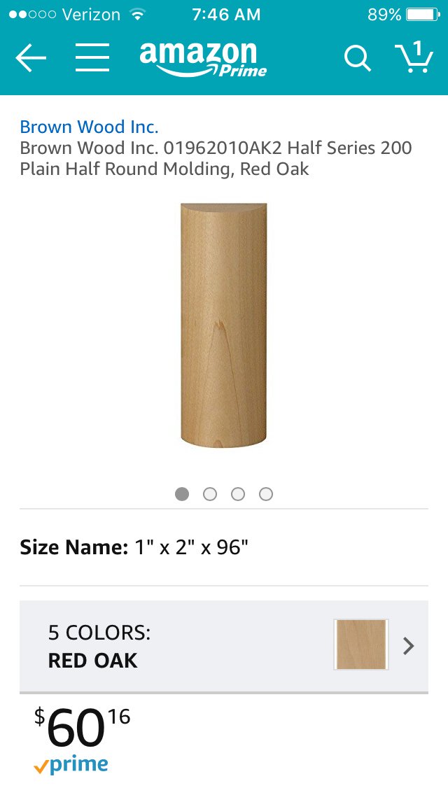

Jakmoulding.com has it. But they are in Walstonburg, NC, close to Greenville.

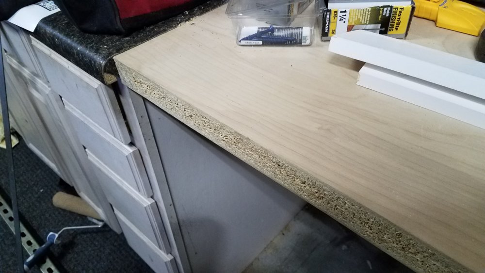

I scored a solid core birch door, and I'm butting it up to counter in my garage. 1/2 round will be the nose
If it's for a garage table made out of a re-purposed door, why not just put a piece of rectangular stock as an edge closeout, then hit it with a roundover bit on the top edge?

How about glueing two pieces of 1/4 round together? Buy it at any home improvement store cheap. Actually, if you want to exactly match the profile of the counter beside it, it looks like 1/4 round and square stock glued together will fit the bill.
1/4 round I have found is much too small. If I remember correctly it's .558 or something. 2 pieces glued together may be 1/2 of a 1" wooden dowel (At least at Lowes...Shhhhh HD is twice as far away from me)
