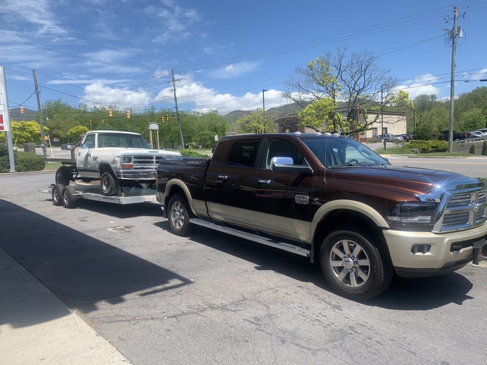

This thing popped up for sale a few weeks ago and I looked away as long as I could. Struck up a barter deal with @unbrokenchain and I think we both walked away pretty happy. I’ve been wanting something around the farm to bounce around between my house and the other family members that share the farm with me. The old man volunteered his truck for the road trip.

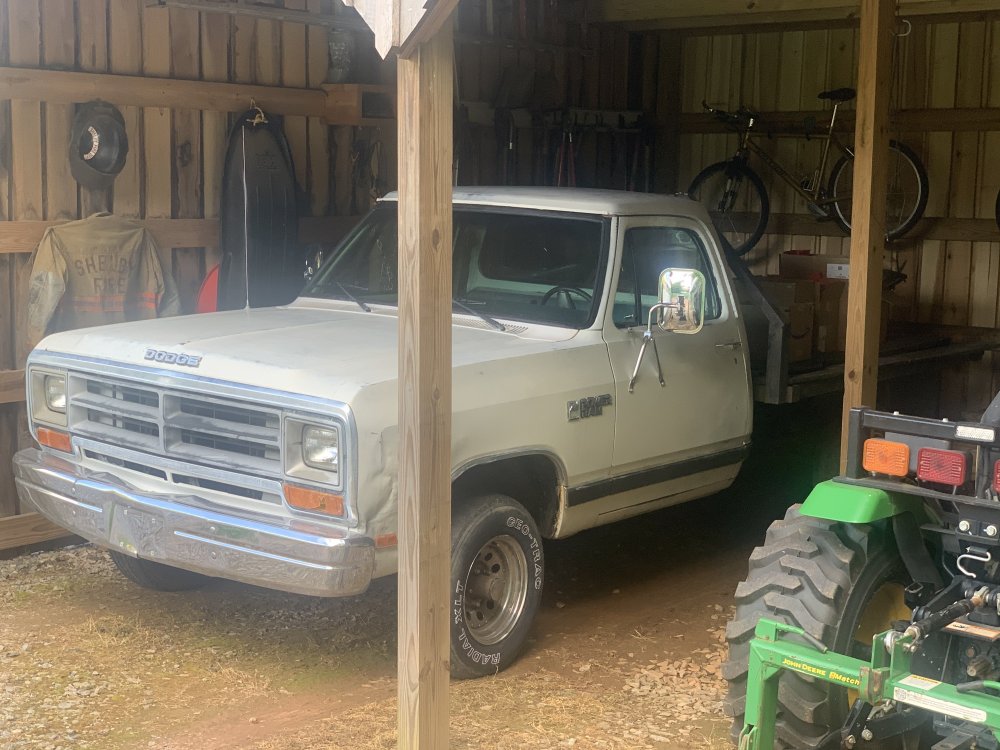

Parked in her new home. Recently finished up my barn and it seems to be a fitting parking spot.

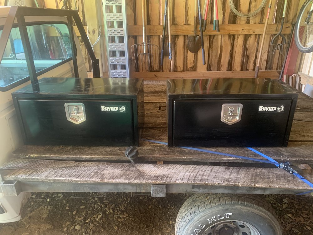

First few dollars spent were on a lucky Craigslist find. Matching set of underbody tool boxes with the keys. I’m gonna cut the old flat bed off tomorrow and start stripping it down. Lots of scrap metal added over the years that needs to go. The basic flatbed seems solid and just needs a proper mount, fresh paint, new lumber, and probably some new LED lights all around. The new boxes will also make a solid mount for the fuel filler. I’ll post up when there’s more to see.

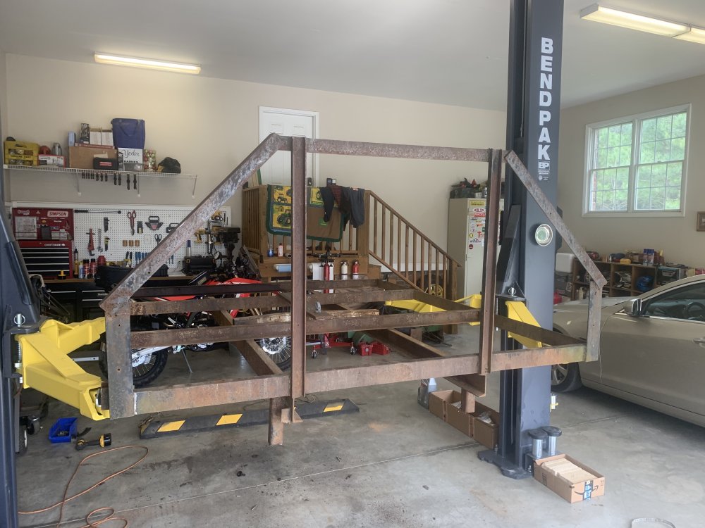

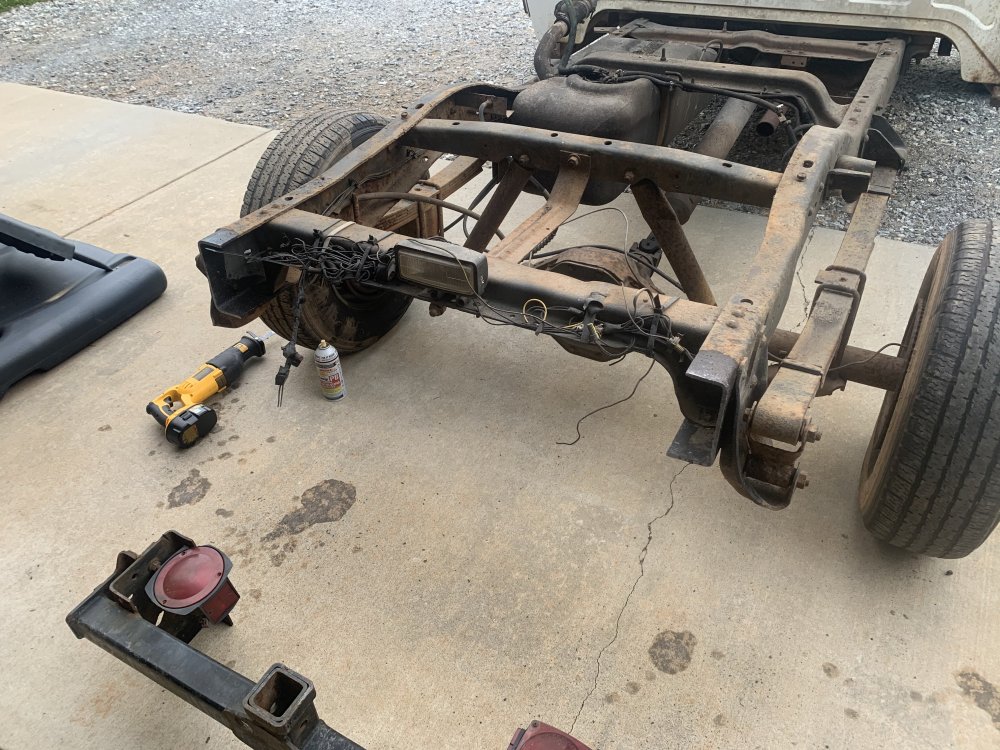

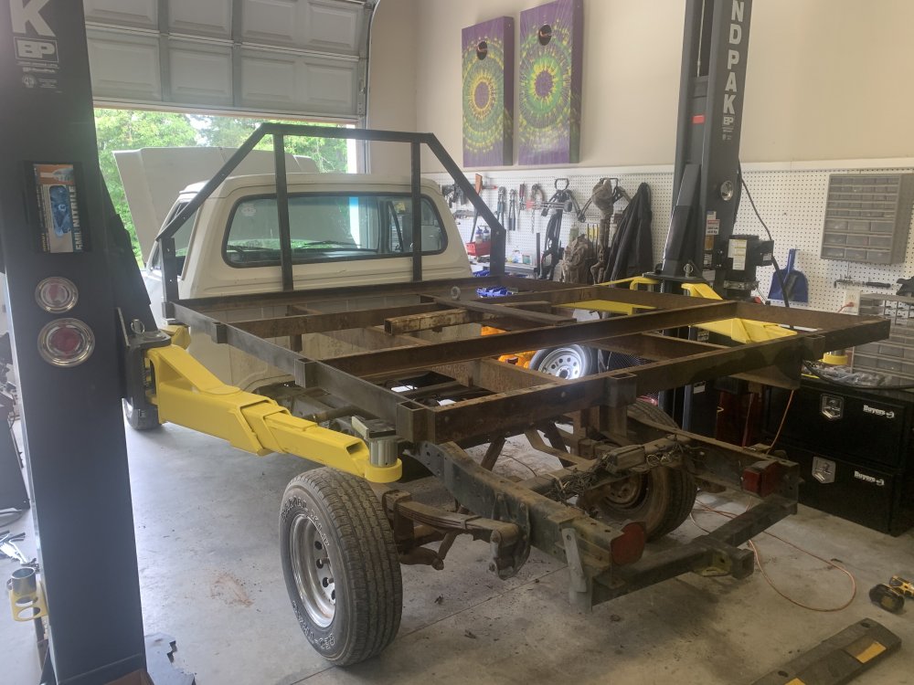

Got ol girl in the garage today and started getting rid of some of the ugly. Stripped off all the old rotted boards from the flatbed. Then I cut it loose and lifted it on up and off.

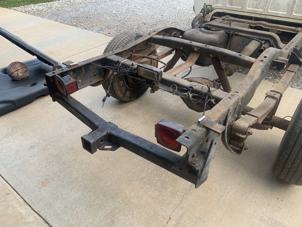

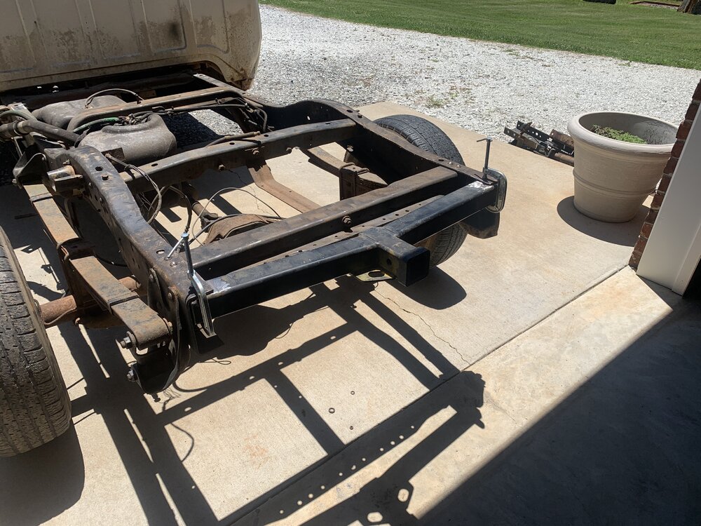

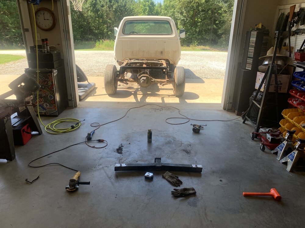

Probably gonna chop this ugly headache rack down to just an even 12” high rail across the front. Let’s be honest, this truck is gonna live the good life from now on. I won’t need the headache rack anyway. Next up was the hack job of a rear hitch. I was getting tetanus just looking at it. Before:
Might as well improve departure angle while I’m at it. I’ll cut the hitch down and weld it solid between the frame rails. After:
Everything from the cab back is gonna get the old booger welds removed, wire wheeled down, and a fresh coat of satin black. While the bed is off, now is the best time to redo the fire hazard of wiring and fuel lines. It all needs redoing.

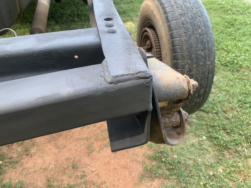

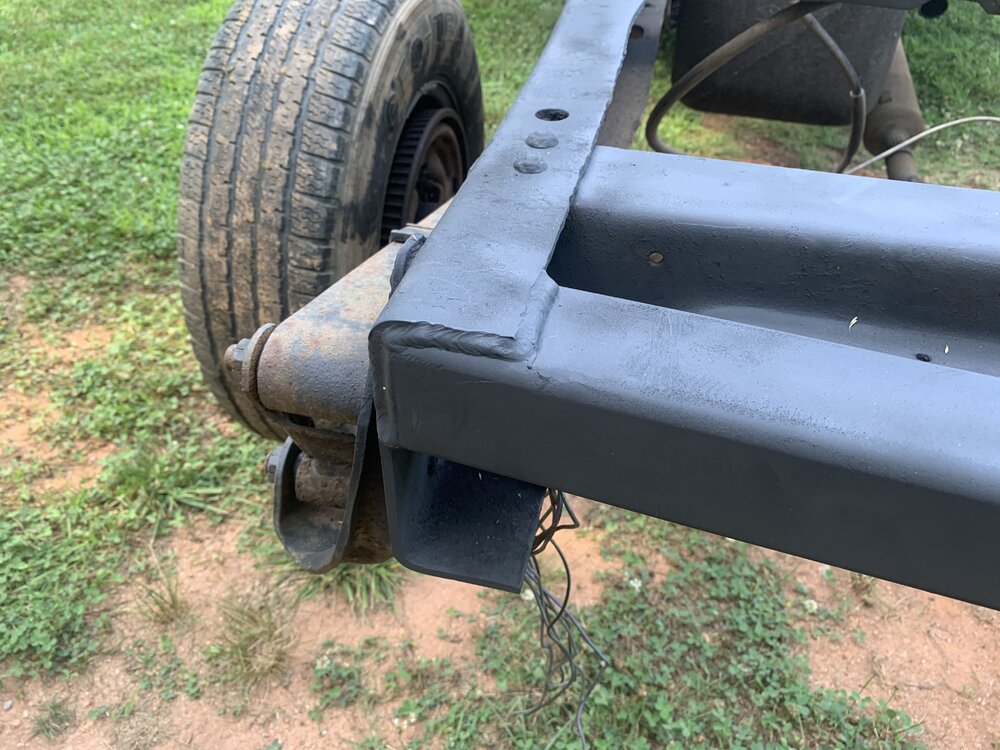

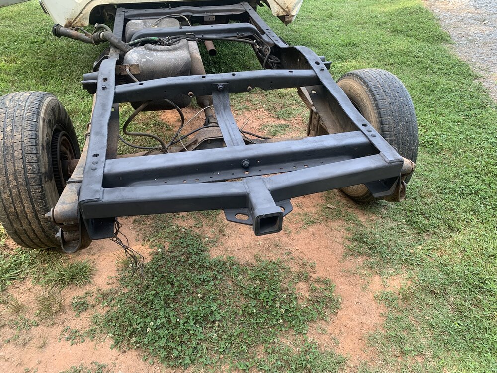

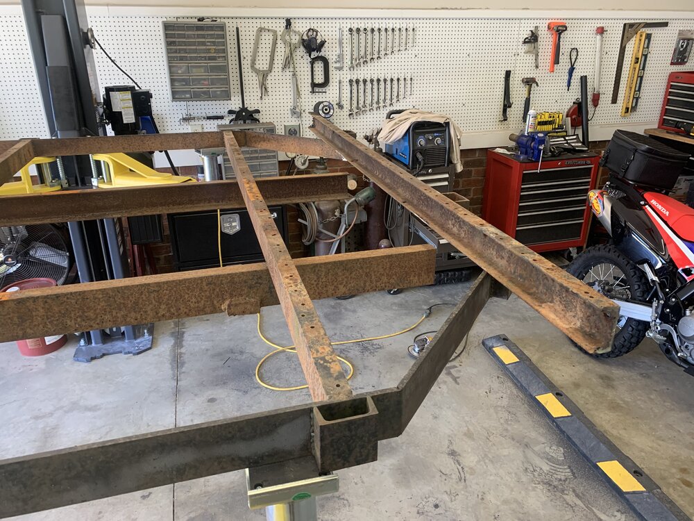

Finally got a day to get back on the old farm truck. Trimmed back all the wiring to just the OEM harness. Cut down the cobbled mess of a hitch and welded it securely between the frame rails. Also got rid of the last few random brackets on the frame rails and shot some primer on it to keep it clean.

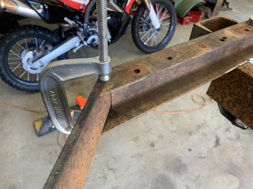

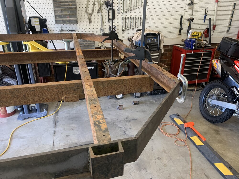

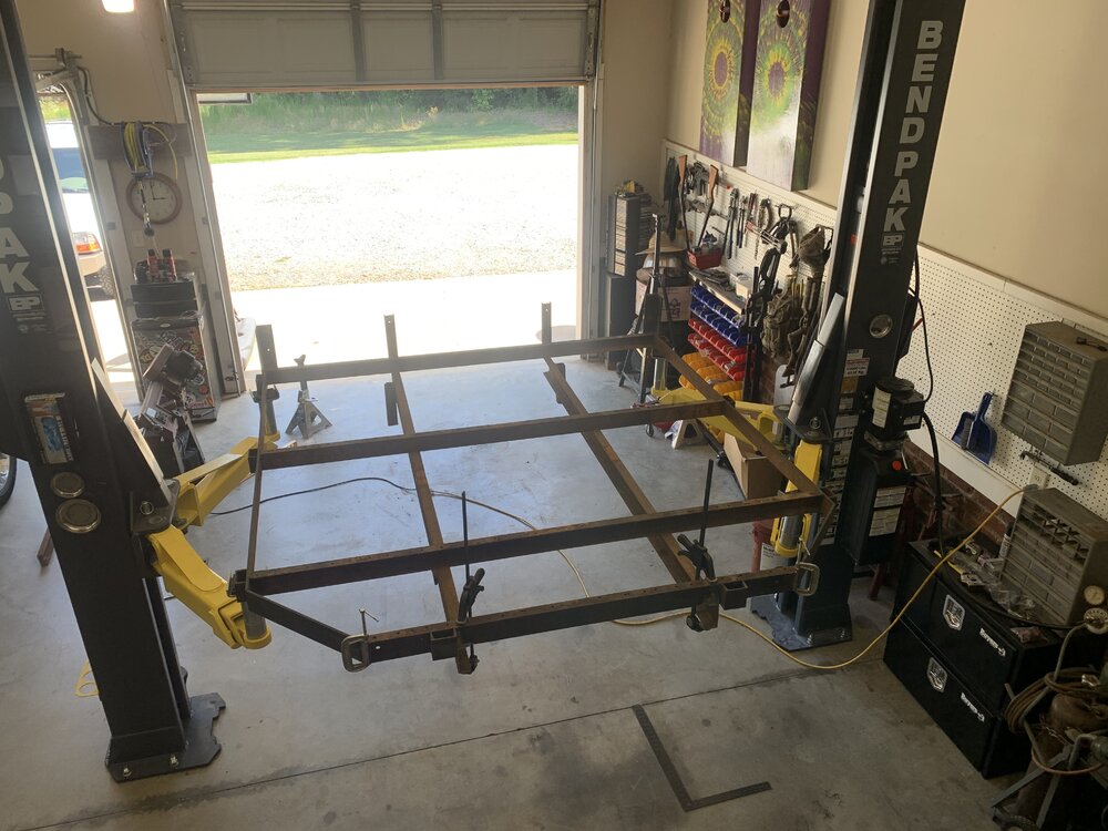

Also started reshaping the flat bed. Headache rack is cut down to 12” tall. Shortened the bed length by another 10” and gave it a dovetail. If I hadn’t run out of wire, I’d have it all welded up by now. Mock-up is all I got for now.

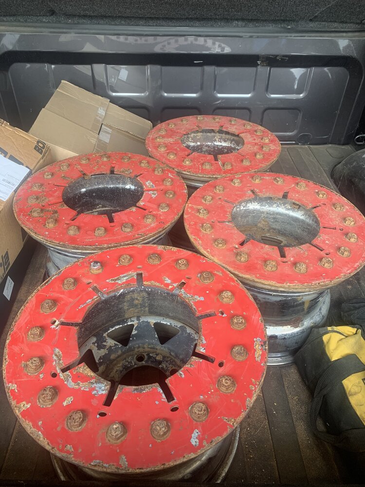

Picked these up today from @skyhighZJ …. should work good, last long time!

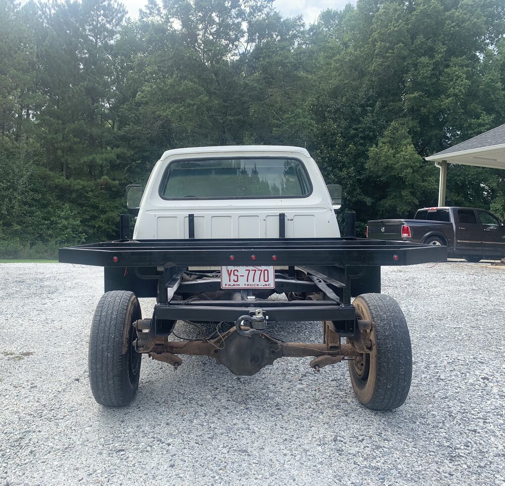

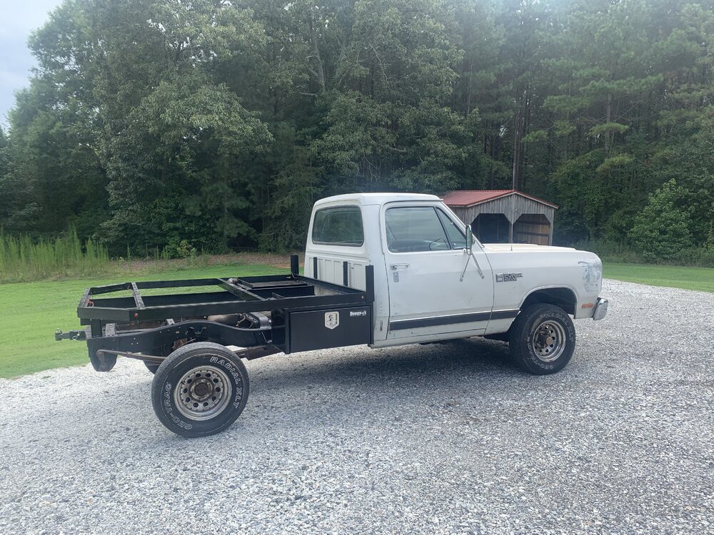

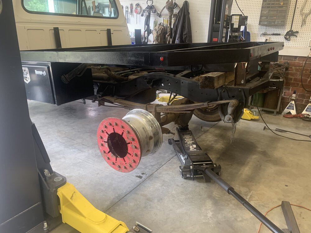

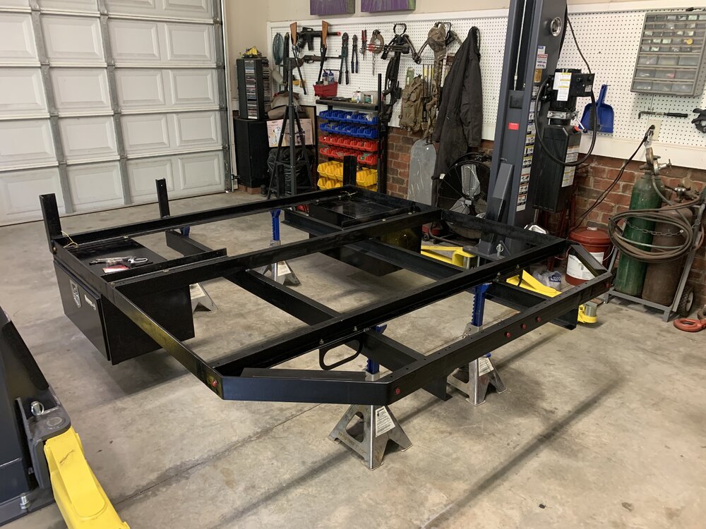

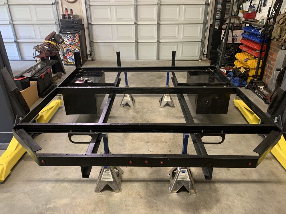

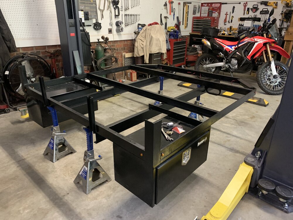

Solid day in the shop working on this flatbed. I need this thing off my lift so I can do some vehicle maintenance. All the welding is done. 2 coats of Rustoleum satin black. Holes drilled and 3/4” bullet LED clearance lights installed. Boxes are mounted with new Grade 8 bolts. Tail light brackets are there, but I still need to pick out my lights. I’m wanting the “all in one” ovals that have tail/stop/turn and reverse lights. I’ll let the paint cure a day or two and then it’s time to get her back on the farm truck.

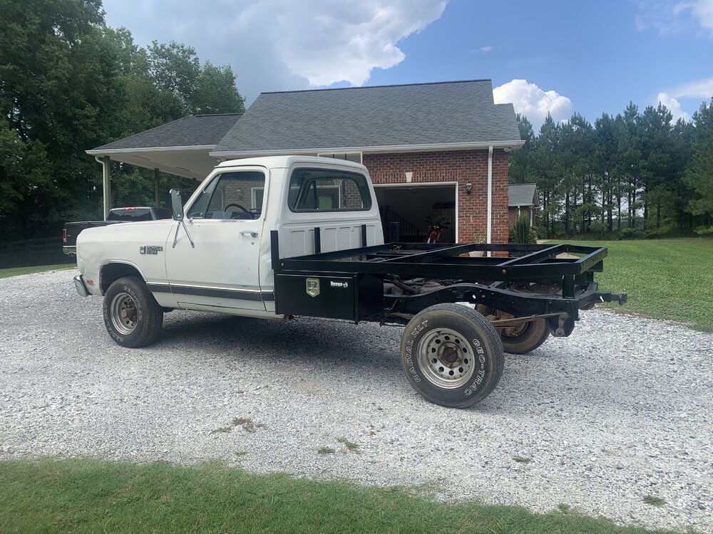

Welded on and off my lift finally. Everything appears to be straight, but there’s no guarantee anything else on the truck is straight. With the tag on, took her out for a victory lap around the farm.
And just for giggles, threw on a beadlock I picked up from @skyhighZJ to get a teaser on how she’ll look. She looks like she’ll fill out quite nicely. I can’t wait to see this truck 4” higher with 35” TSL’s.
