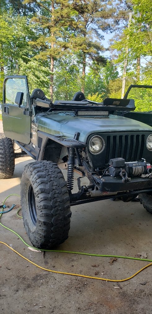

I get full stroke on the ram, but it still rubs on the LCAs causing the passenger side to loosen the jam nuts from time to time. I dont know the exact backspacing on the wheels, but I believe they are 4in backspacing. The width makes it a little difficult with loading on a trailer. So on my trailer I made "custom" drive over fenders with 4x6s and 2x12s temporarily until I get around to fabing up some metal drive over fenders.

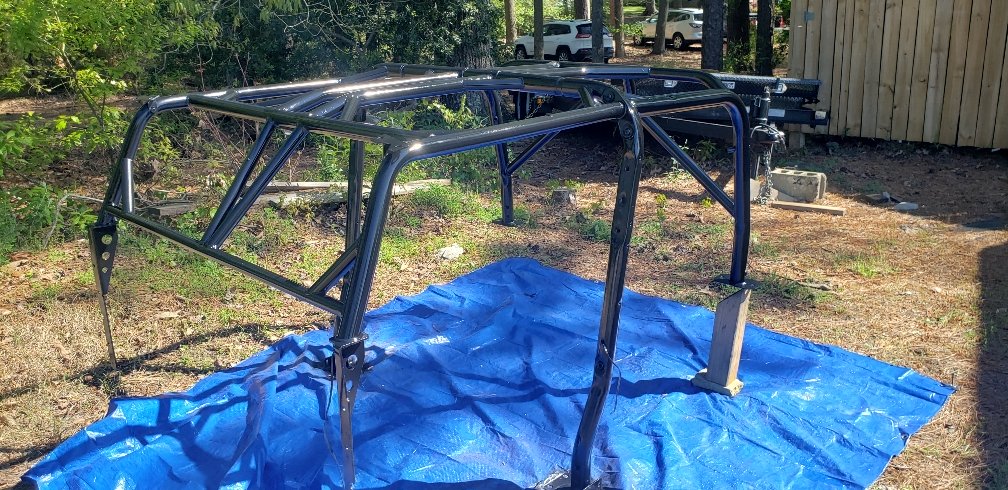

Old cage out, new cage almost installed! I will get a picture of the new cage tomorrow when I am off of work. The bolt holes for the A pillars are not quiet lined up, and the doors are a little hard to shut currently. The removable door seal is contacting the top frame of the door, hopefully I can correct the issue with adjusting the top hinge.

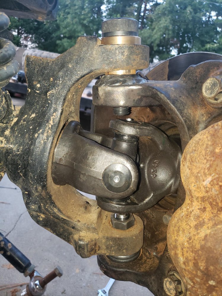

Figured I would make another update post. Over the past year I had my first break. I broke the u joint on the drive side axle shaft. When this happened I also unfortunately found out that the upper ball joints snap ring came out the hard way. It pulled the upper ball joint out of the knuckle and broke the lower ball joint out of the socket. Since then I have upgraded to 4340 chromoly shafts with billet 1550 joints from ECGS and ball joint eliminators from Nick Barna. Since then I have wheeled it pretty hard at Morris Mountain and AOP without any real issues. I have also put in an actual fuel cell instead of the stock gas tank ratchet strapped in the back. Next trip is to Harlan later this month!
