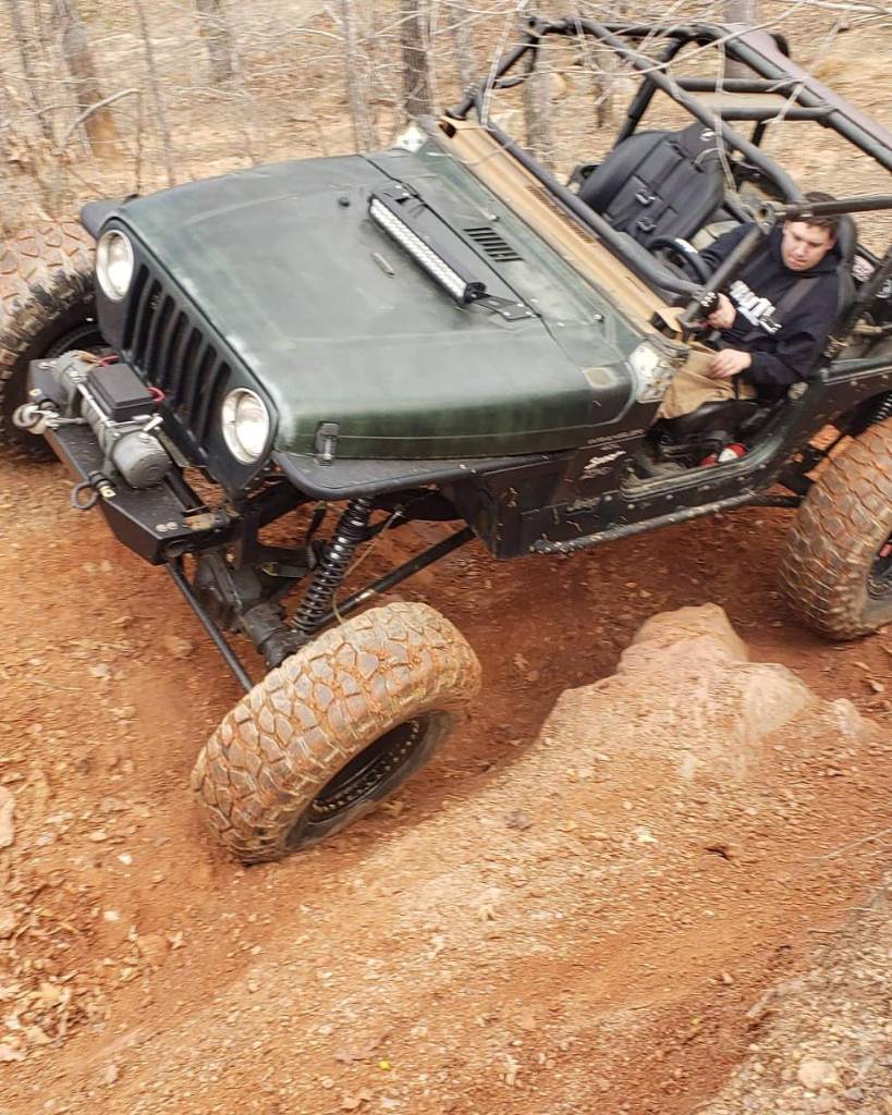

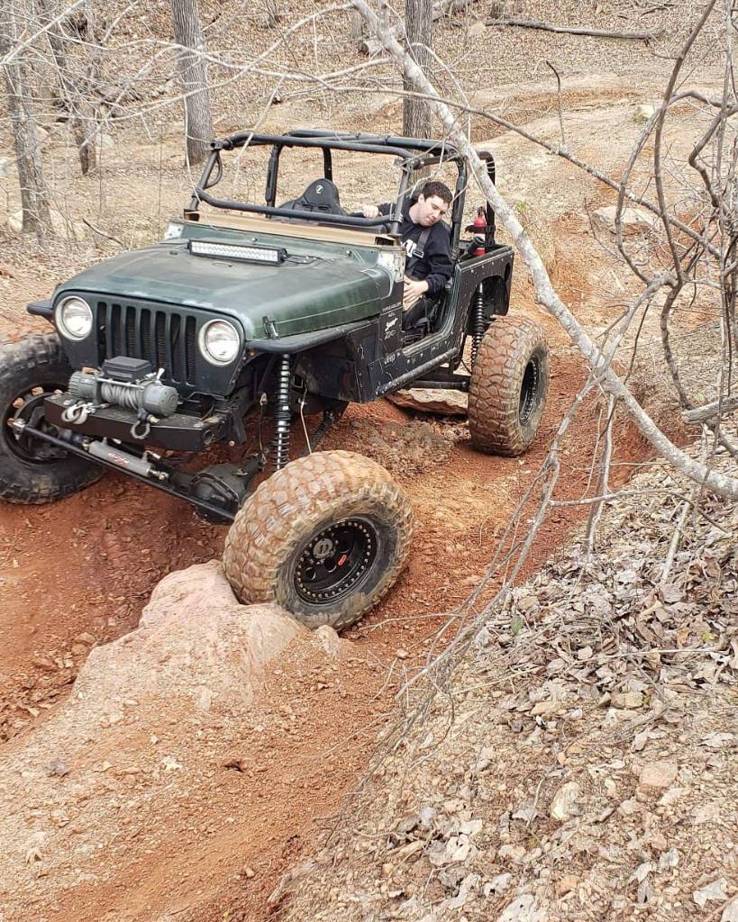

rear flexes great, may need to soften the front to get a little more flex out of it.
If the front rides well, don't change springs for flex. Add a rear swaybar if you want to force the front to work more.

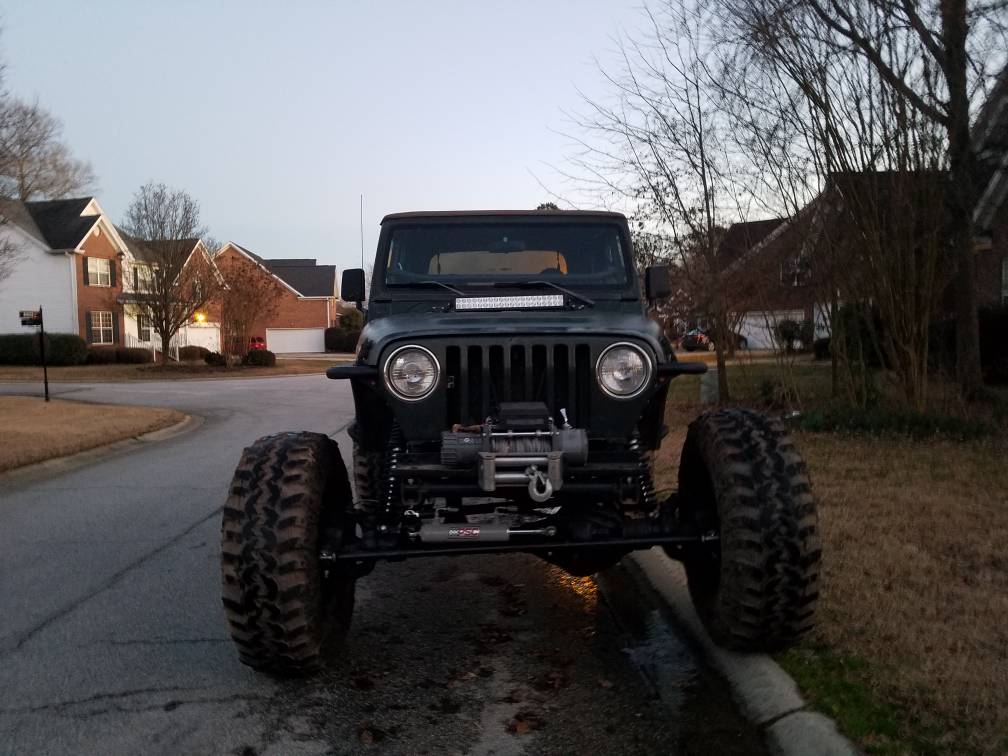

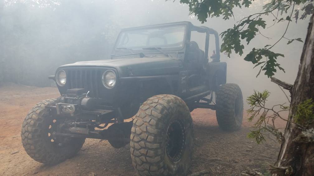

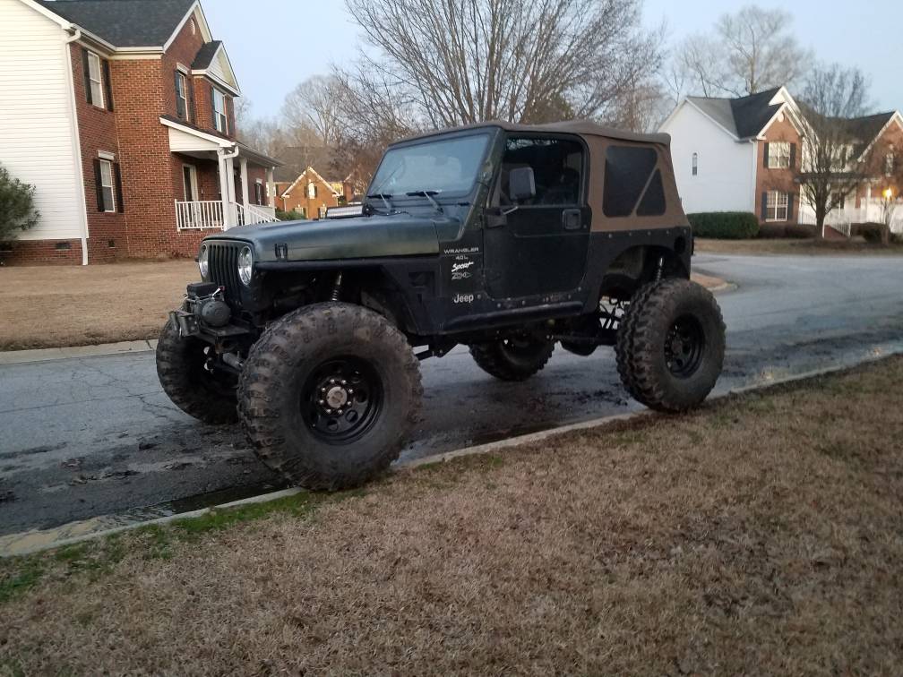

Decided to make it street legal thanks to the relaxed laws in SC compared to other states. All I had to do was one phone call to put insurance on it, run the title to the county treasury office ($19 vehicle tax lol) then swing by the dmv on my way home and got a tag. Only the insurance company asked for a picture of the vehicle to put it on file.
As far as wheels and tires go, I did not want to damage my reds while driving down the road, nor did I want to unmount them off of the beadlocks. So thanks to the for sale section on here, I got a really good deal on a set of rims with the correct 8-170 bolt pattern, and a set of 39.5 Iroks.
The rims had a second valve stem hole drilled for running an internal beadlock. So I drilled and tapped it for a 1/8 NPT plug that I can remove with the tire still mounted. I used this to add antifreeze to the tires to balance them. I put about a quart in each tire and it seems to work great!

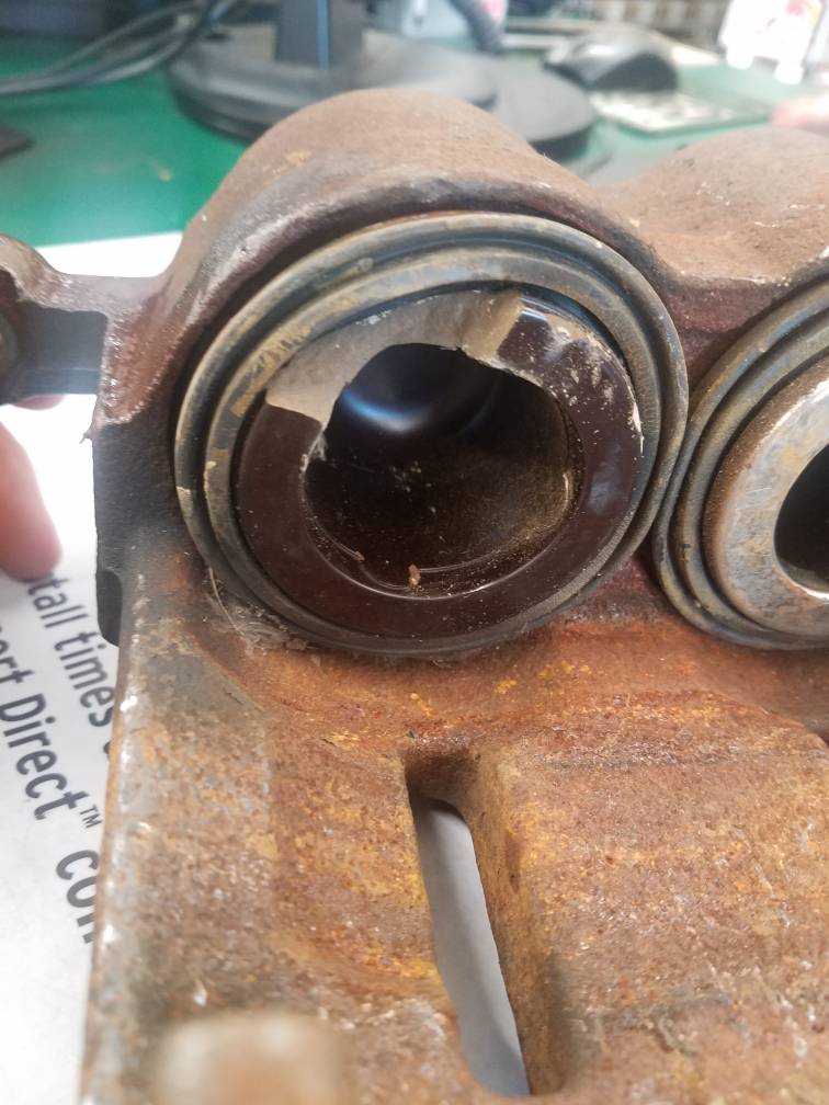

The first test drive was 20miles, which normally takes 30mins or so. I took it slow due to a couple issues so it turned into a 45min trip. The front right brake rotor was bent due to a rock, which shattered one of the pistons in the caliper. The back right brake caliper was dragging causing it to get a little toasty. The steering was something else, I had a dead spot in the center and had about an 1/8th of a turn where pretty much nothing happened. But the Jeep survived the trip!
I found a little air bubble in the ram and that really helped the steering, I put new rotors on the front, and replaced both calipers on the right side fixing those issues.

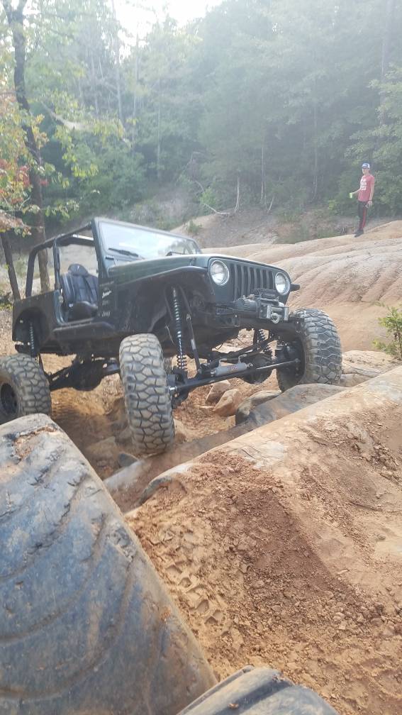

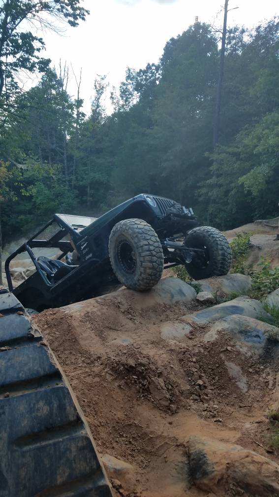

After this weekends wheeling trip to river rock, I probably should start looking for a 42in sticky. The sterling 10.5 hangs low and catches everything. But besides smashing my diff on every rock, the jeep did great!
