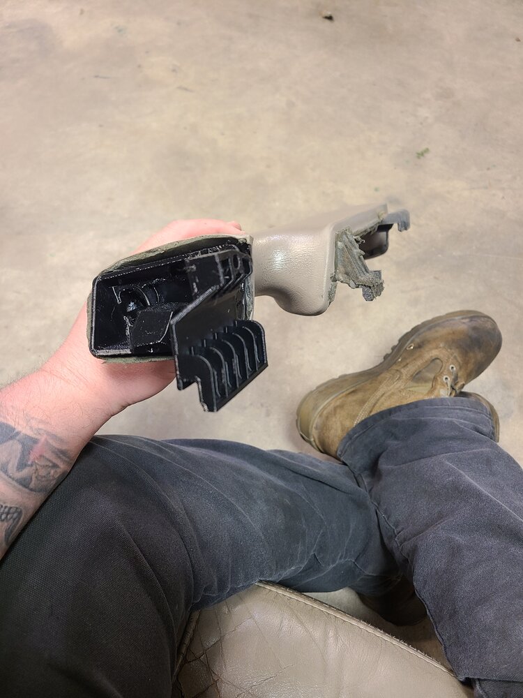

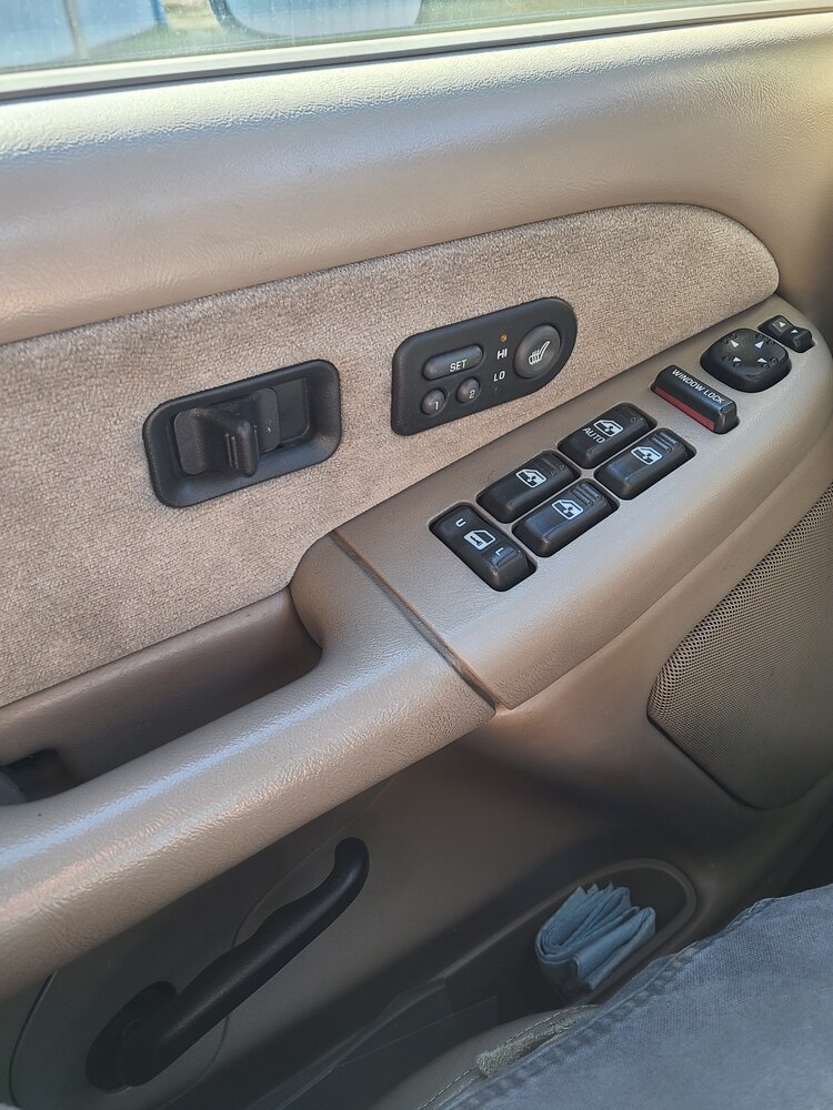

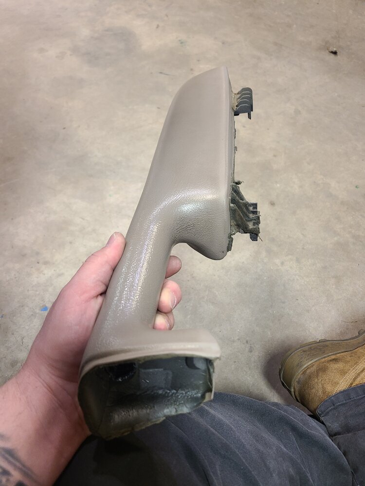

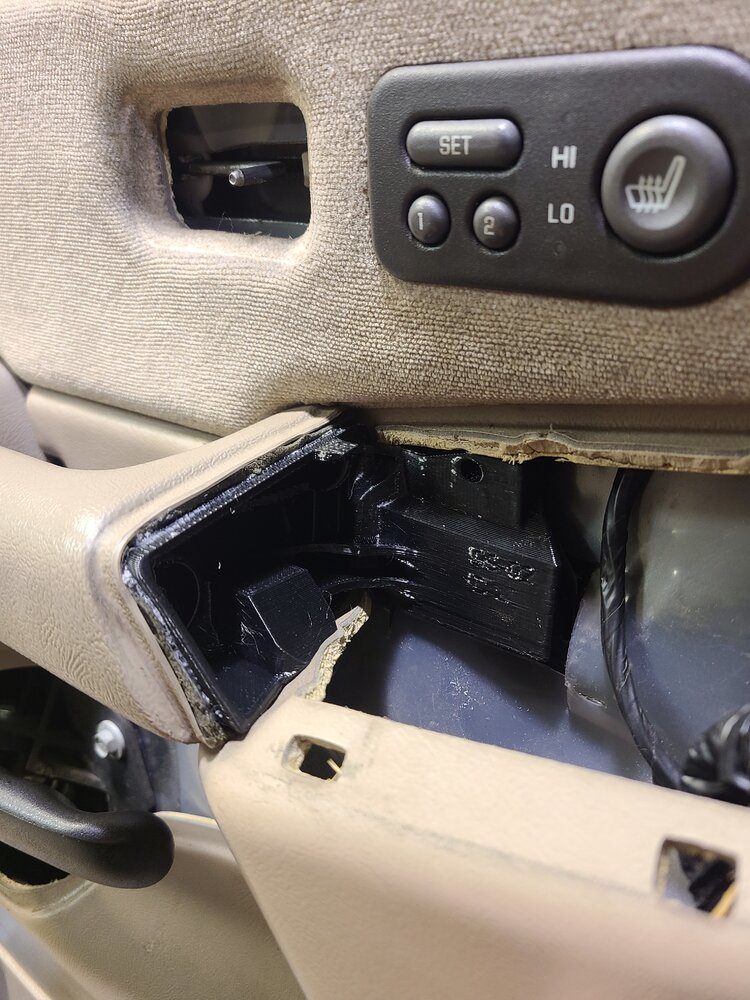

So...I tinkered with the "new" HD. The driver's side door pull was busted and suuuper annoying. eBay for the win! Picked up some 3D printed door pull repair brackets and some super glue. Easy enough and took maybe 45 minutes with varioua gluing and holding until the glue kicked off. I think both brackets were 28 bucks shipped. Made by some dude in Texas. Figured I'd go ahead and get both sides, just in case I need the passenger's side later on, plus he knocks off a few bucks if you get them both.

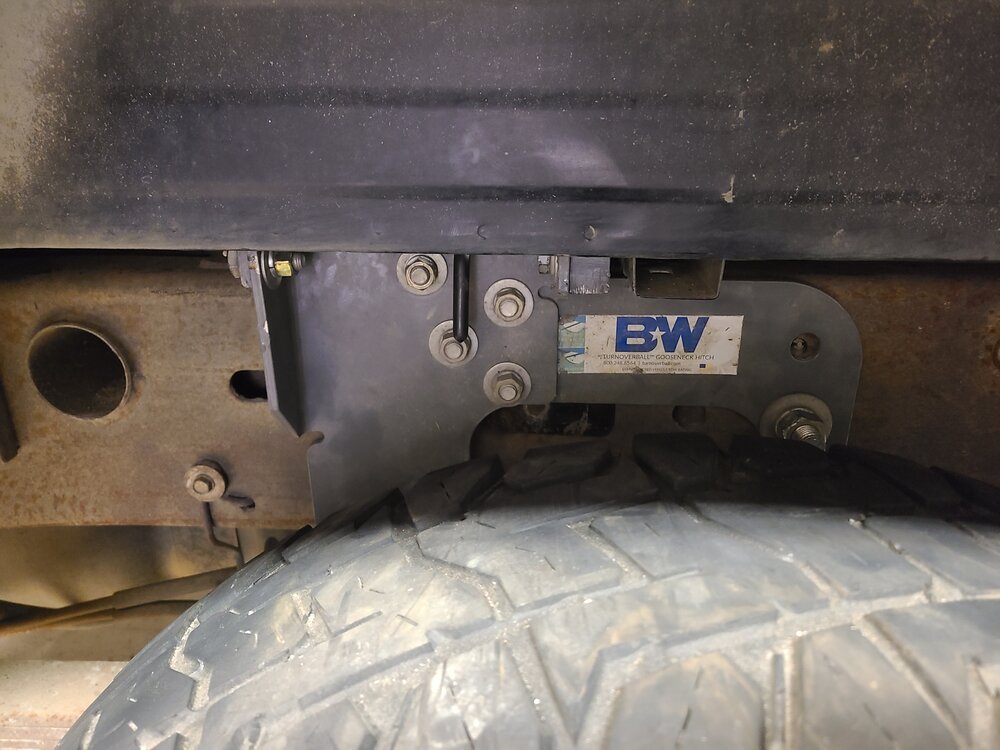

Motivation has been eluding me, but a buddy needs a truck fixed and I don't feel like driving an hour each way every time I need to work on it. Finally started swapping the B&W to the "new" truck.

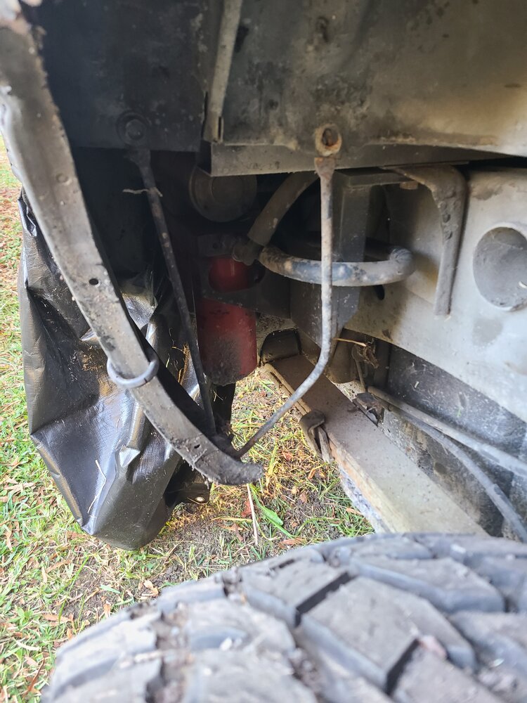

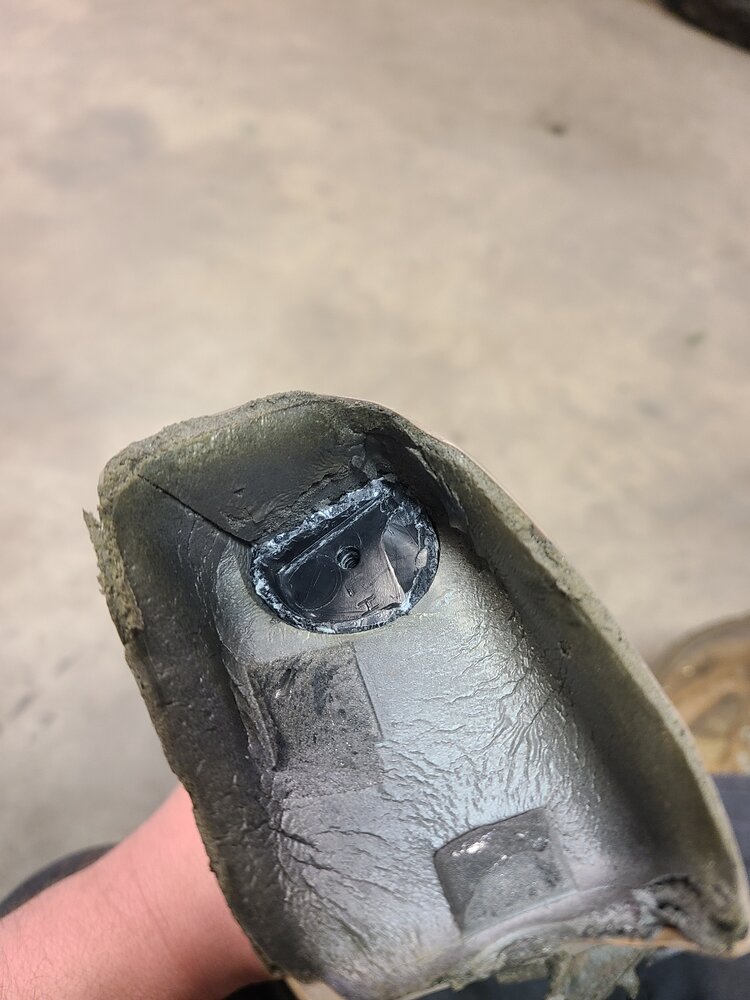

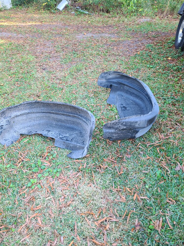

Had to pull out the inner fender liners I had added to protect the lift pump. Luckily, they're able to be saved. I got the old crap unbolted from the new truck and the side plates unbolted from the old truck. I can't access the bolts on the cross braces because the S&B tank is massive, so I unbolted the bed. I'll block it up this afternoon and pull the center section out as one piece, disassemble, and then install in the new truck. At least I'll finally be able to move my trailer again!

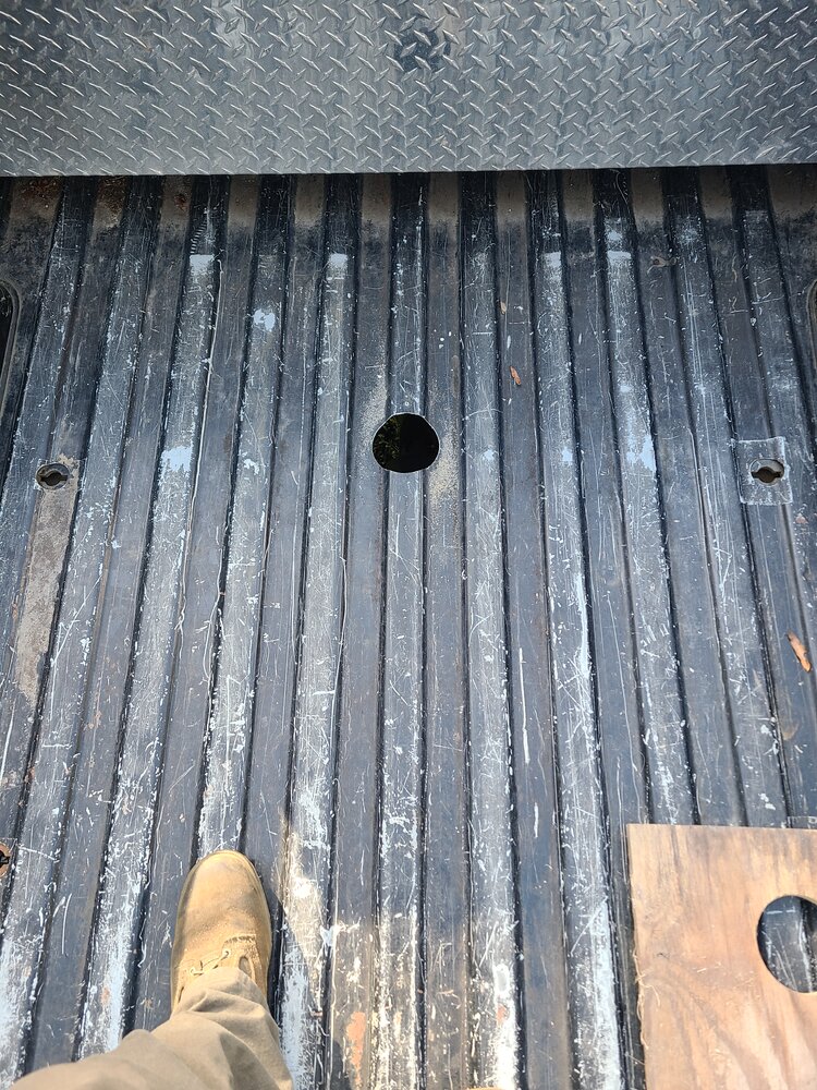

At some point, I'll take a hole saw and cut out some patches to weld up the four holes from the Curt or Reese setup that was in it. I don't like the cradle mounts. B&W is where it's at.
I do, still, need to drill the four 1/2 inch holes for the safety chain loops, but that has to wait until the center section is in and you use it as a guide to drill from the bottom. (That's what she said!)

As you may have seen, the gooseneck hitch was successfully swapped over. Now I need to check the wiring, run the 7 way up in to the bed, and add the brake controller.

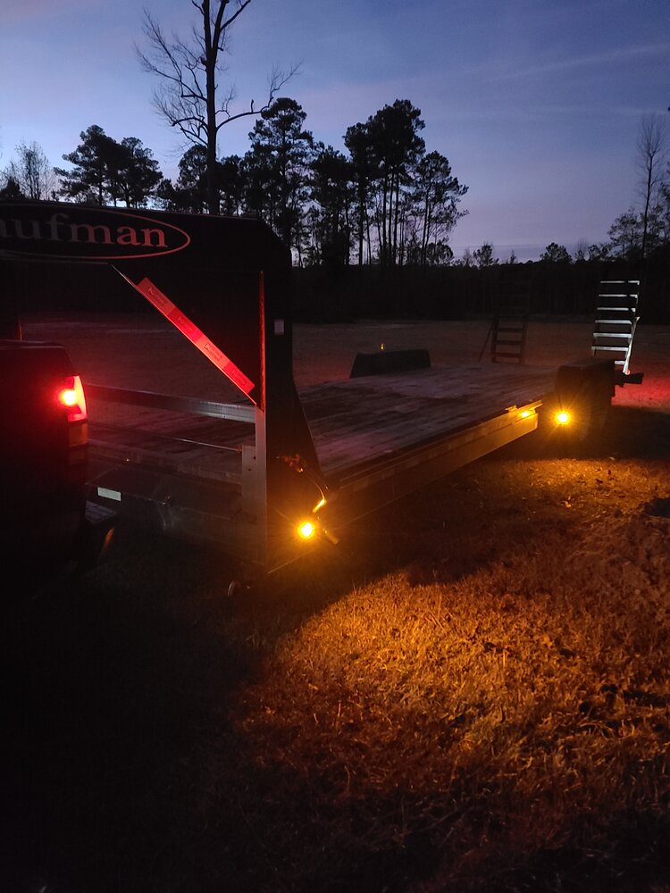

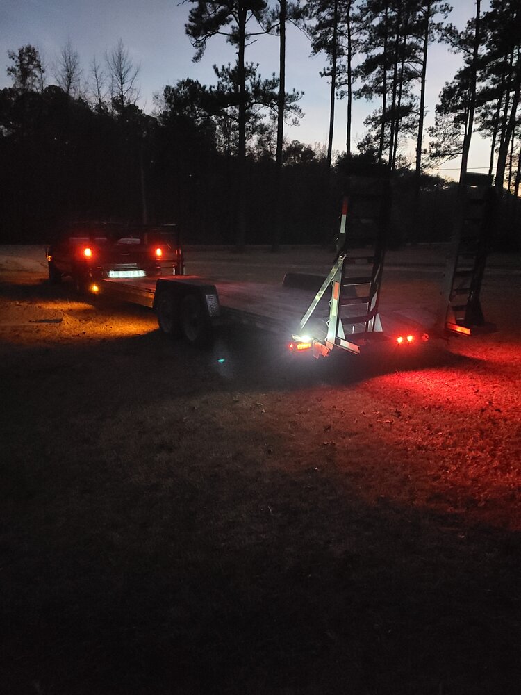

Got outside yesterday afternoon and used what teeny amount of daylight I had after work to get my trailer wiring sorted out and working.

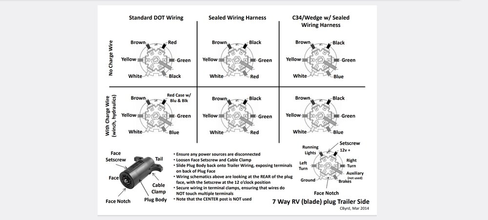

I *did* have an issue on the truck side, but it's temporarily rigged up. Only three other people have ever used my trailer and after looking at it some more, I realized the plug didn't look right. I think my cousin either broke it or drug it down the road and replaced it. Naturally, the 6 wires in the trailer harness aren't entirely the normal colors. I managed to find a diagram on Kaufman's website and quickly got it rectified :D

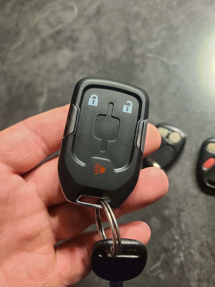

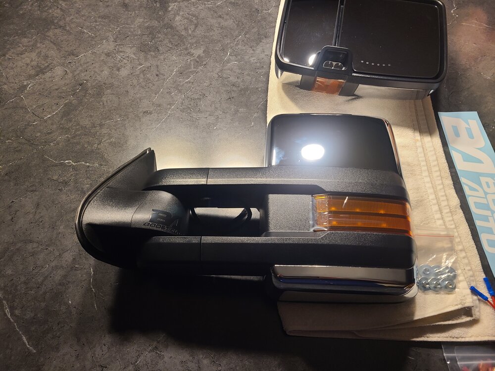

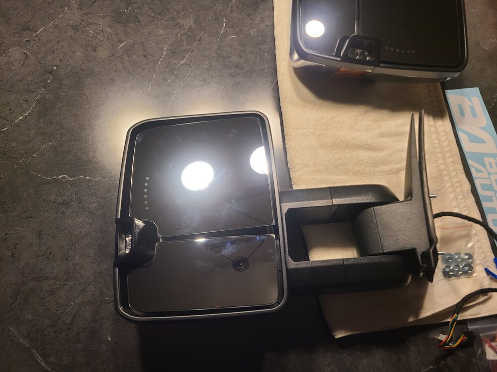

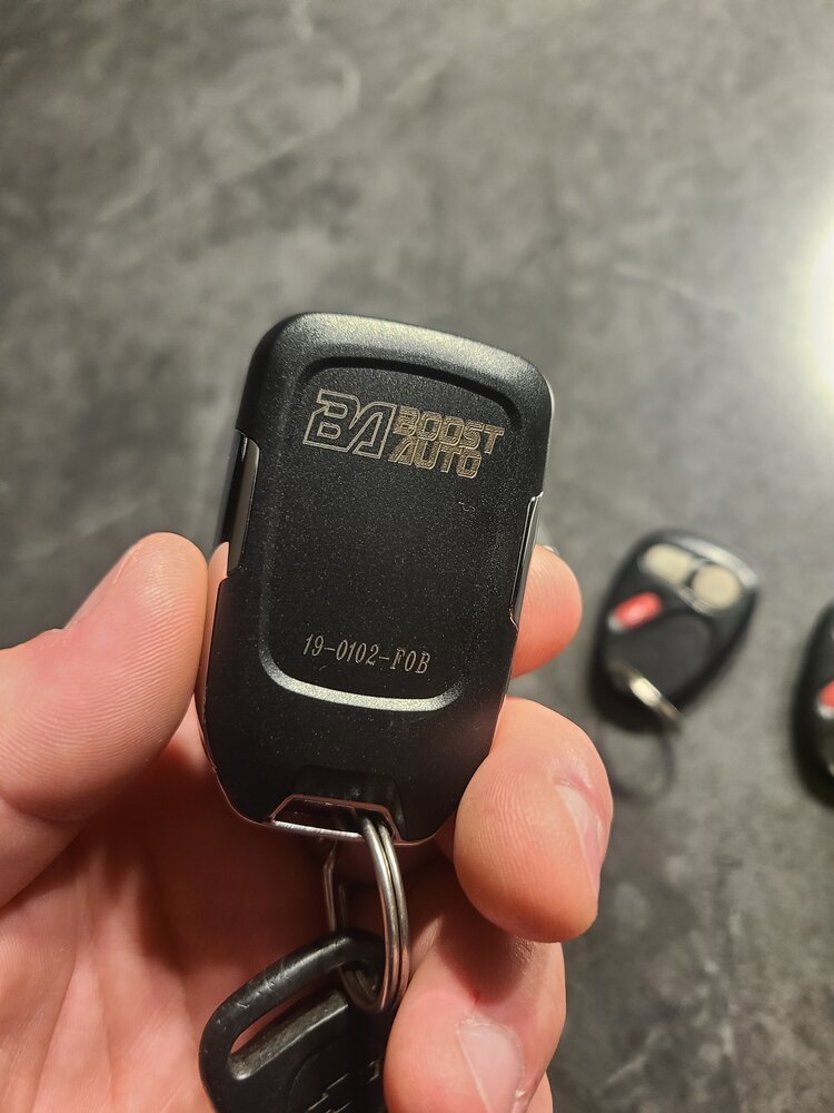

Anyway, I said "F it" and did it myself. After having 2015+ style mirrors, anything else absolutely sucks. Spent about 700 bucks at Boost Auto and got new mirrors and a 2020 style retrofit key fob. They just showed up today. I'll get them bolted on one afternoon this week and, hopefully, get around to wiring them up and leveling them maybe this coming Friday. I need to snag the solid state/LED flasher relay from under the dash of my old truck and pop that in there too. Quick flashing turn signals annoy the hell out of me.

I had cheap mirrors on my last truck the first time I replaced them and the glass shook constantly. I like the extras on the Boost Auto stuff too. The backup lights in the mirrors, both panes defrost, and the way the turn signals/markers function are on point. They're probably the closest thing you can get to OEM. I think they were 615 bucks all in.

I finally bolted the mirrors on yesterday afternoon. I still need to wire up the marker lights, turn signals, and backup lights. Luckily, they have a separate harness. I do have to run it down through the door and wiring sleeve between the door and cab. Oh, and I still need to level them. That involves popping the cover off, putting two to three thin washers behind the upper two bolts, and filing the lip off of the inside of the cover. Easy enough and it looks soooo much better afterwards.
