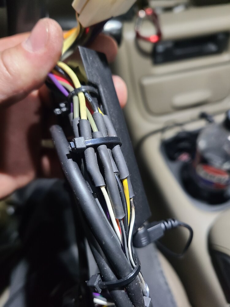

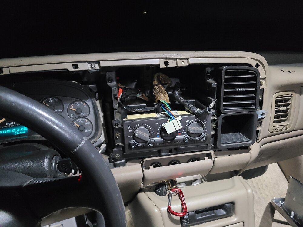

I snagged the radio, floor mats, and a handful of other small things out of the other truck. Had to spend some time unfcking some stuff from the previous owners. I forget how awesome I am sometimes...just look at that radio harness! Solder AND heat shrink! To think, I did that 8 years ago. The one that was in it had wire nuts on it....
Finally got all of the speakers working for now until I can swap in the ones from my old truck.
The cab lights are 100% getting gone, but since they're there for now...they're going to work. What a fuster cluck that was, but I got it. For the record, I hate it. Cab lights and marker lights should 100% be amber. This looks stupid.
The driver's seat doesn't move, so I've got to swap some stuff over from my other truck on that as well. The heat pads work though and that makes me happy.

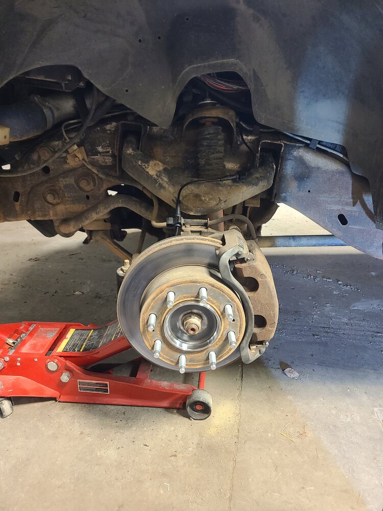

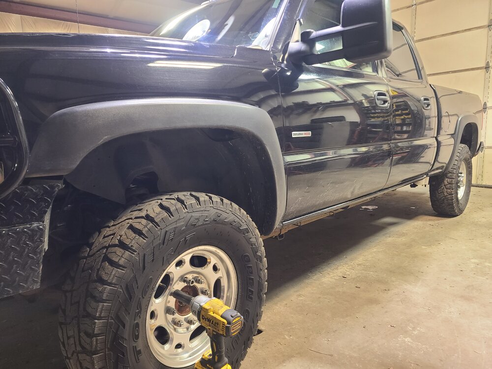

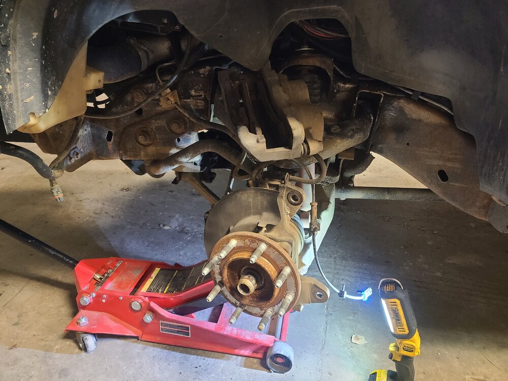

The left front wheel bearing is noisy. Just has me motivated to swap the Dana 60 under it sooner.

I went and dropped her car back off and got my truck so I could do put a wheel bearing on it too. I guess it was wheel bearing day. I didn't really want to spend the money on it, but I need to be able to drive it until I can get the 60 stuffed under it. Plus, I have a buddy with an 04 Dmax and another buddy with an 05 Dmax, so it won't go to waste.

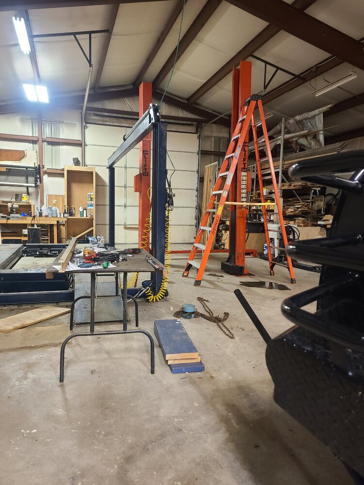

We kind of agreed that neither of us would get "paid" for the lift we did on that 2024 Denali HD Ultimate a couple of weeks ago and we'd snag a two post lift. That'll be a big help with getting the cab and bed off my old truck AND for slightly lifting up the cab on the new truck when it gets some S&B body mounts :D
You can see the two post standing next to the four post. It's going to be realllly nice to be able to back a trailer under it too!

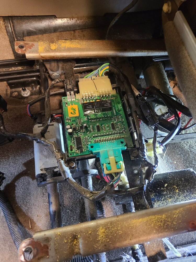

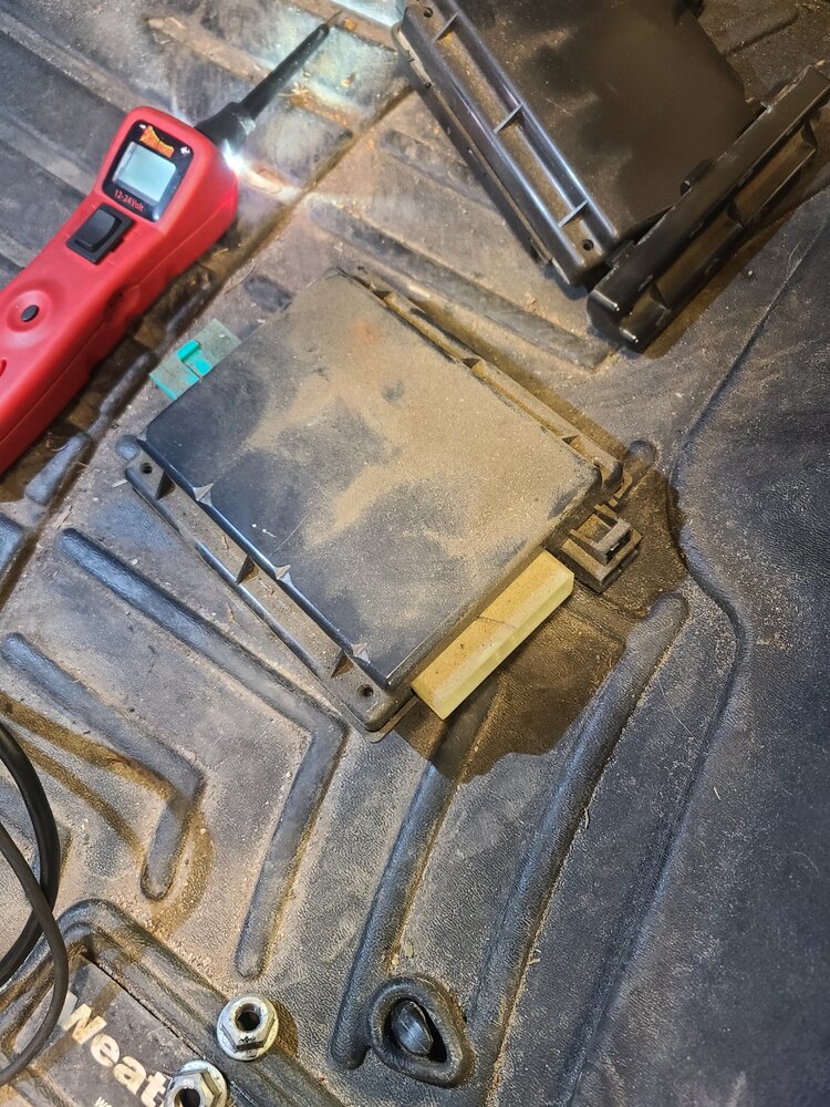

Good first: I got the driver's seat in the new truck working. Had to go in to work 3 hrs early and left 3 hrs early. I had taken the seat out of the old truck over to my buddy's shop so I could mess with them.
I popped the seat bases off their frames and saw that the seat control module wasn't plugged in. The housing was also broken because dude before me had adjusted the seat all the way down and crushed it. It still worked one I plugged it in, but I swapped the one over from my old seat anyway.
It's a much more enjoyable driving experience now, I must say.

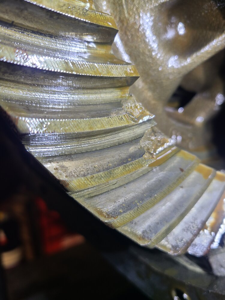

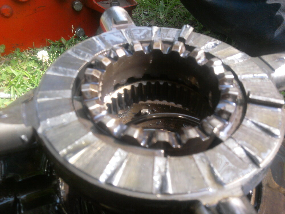

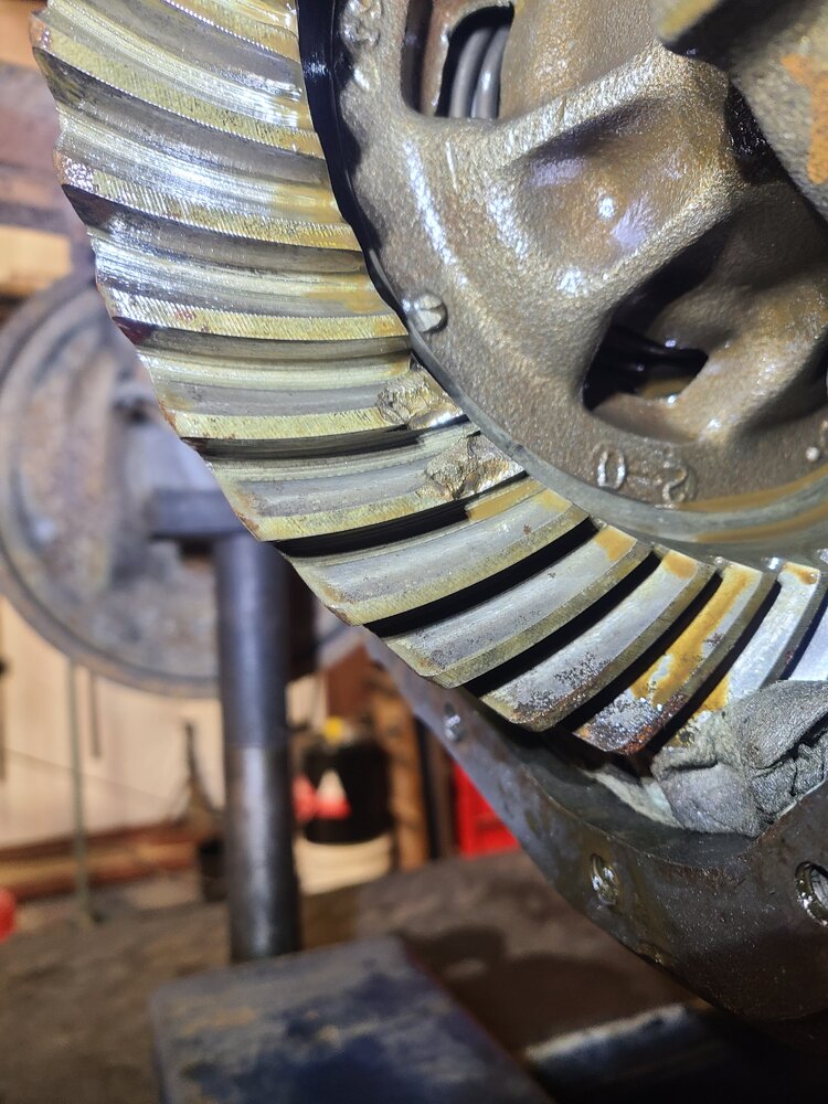

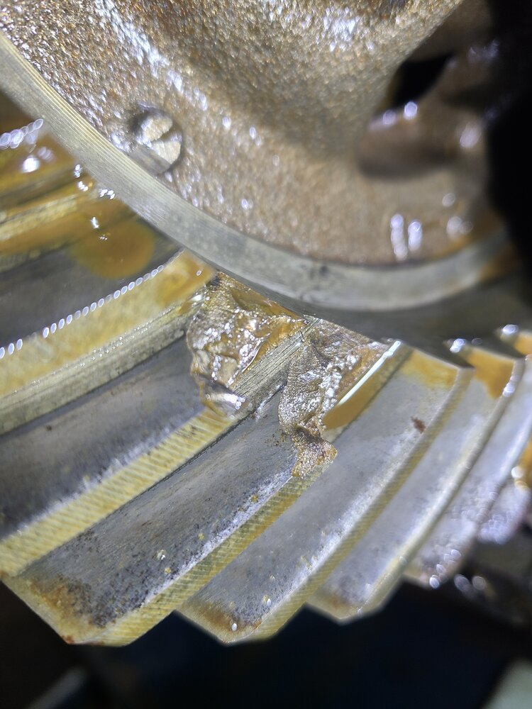

I started dicking with the CUCV's rear brakes. Popped the diff cover off to let the gear oil drain. I figured it needed to be changed anyway and I was entirely correct. However, I was not expecting to see these shenanigans...
As disappointing as that is, the pinion looks fine, all the bearings are tight, and the magnet definitely did its job. Now then, this has VERY likely been this way for many, many years. I broke a shaft and that took out the Detroit a while ago. I'm thinking that spot was where the shock load hit the ring gear when those two teeth were up against the pinion. I swear I didn't see it when I replaced the axle shaft and the Detroit! Hell, I had the entire carrier out for that process. So, I'm guessing it fractured and the chunks came loose later on.
I watch a LOT of "Air Disasters" on The Smithsonian Channel. I'm basically an accident investigator, as you can tell :D
Most of me wants to replace it, but the logical side of me says it's been that way for almost 13 years and held up to dozens of WOT pulls at 57 lbs of boost and north of 1000 ft/lbs of torque. Soooo, F it, right? 🤷‍♂️ What say you, @Jody Treadway ?

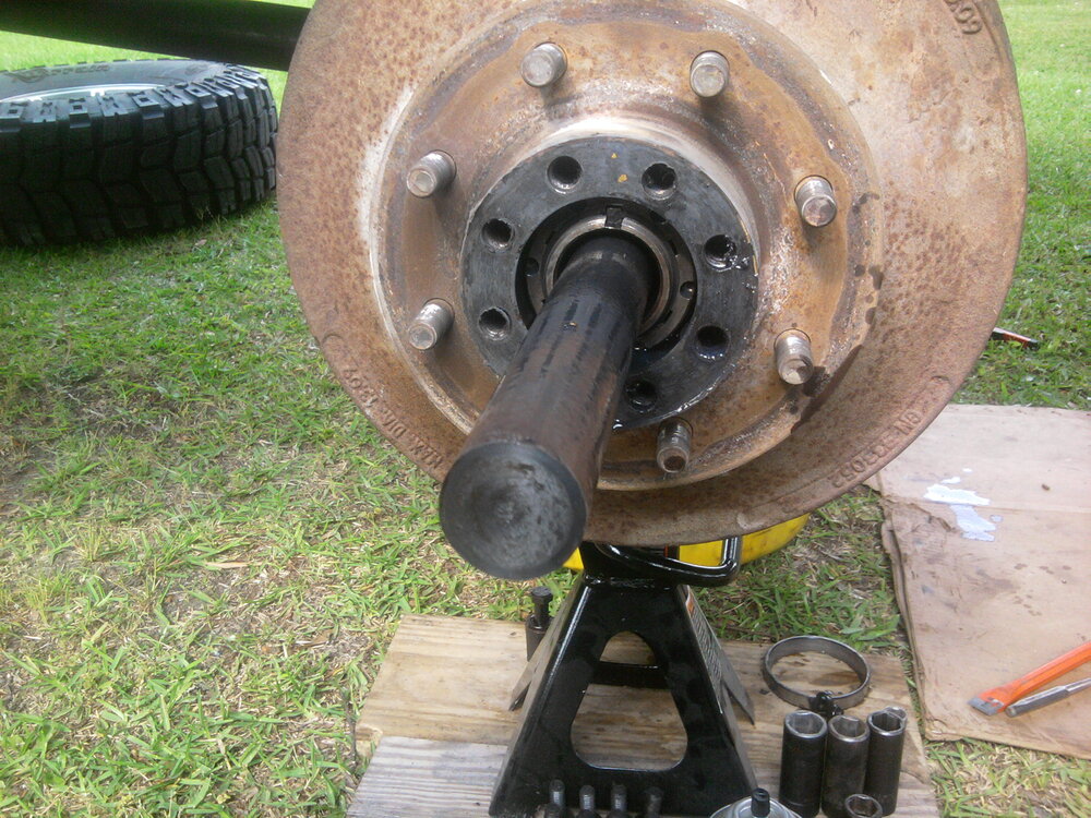

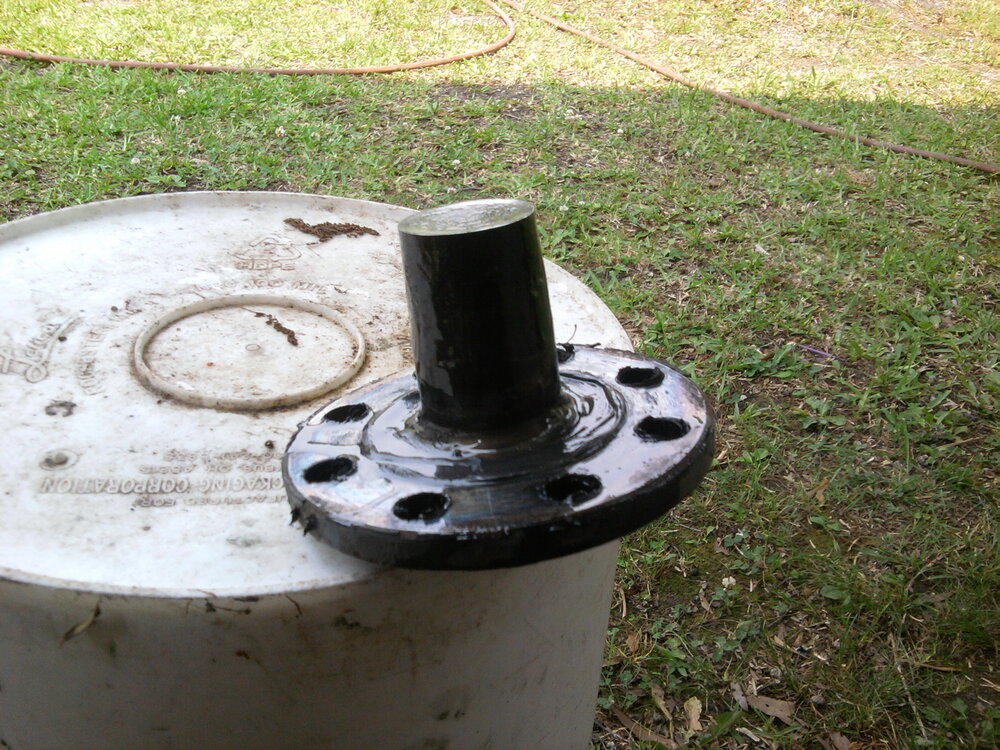

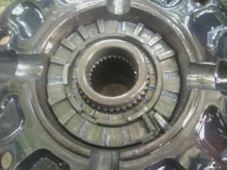

This was the carnage from years ago. May of 2011, to be exact. Like I said, this probably had something to do with it.

This brings one question to mind though. If it's off the contact patch, why did it fracture? Deflection from over power when it broke the axle and locker?
A large chunk of the broken *edit* locker wedged in there, likely in the middle of the tooth. The middle of the tooth is strong AF whereas the inner portion is the weakest. It's simple physics that if the tooth had to break somewhere, the inside edge is where it would have.
Probably a chunk of the locker drive teeth. The shaft broke clean and out towards the flanged end. The splined end looked fine.
