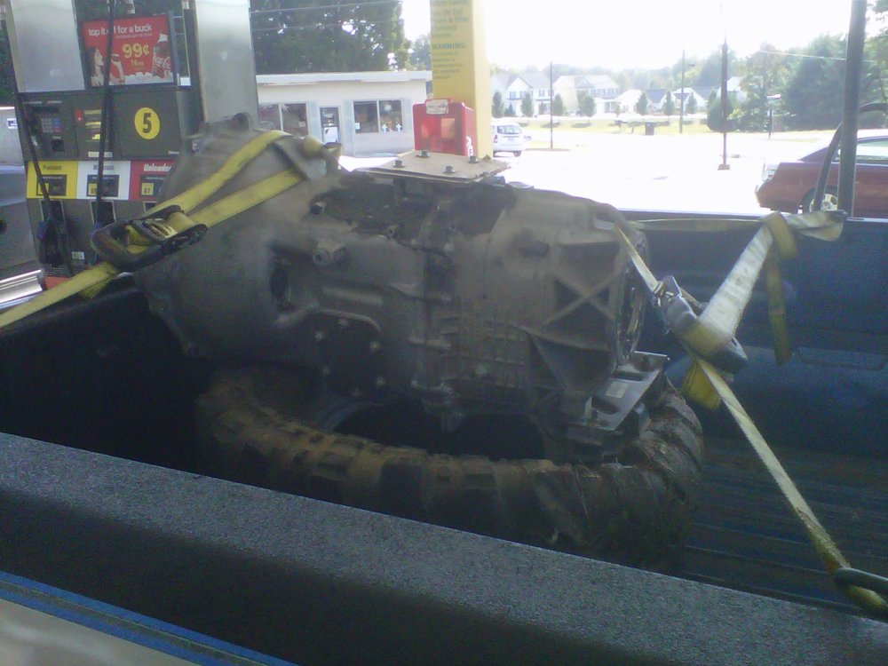

If you do get a truck with the g56 don't plan on throwing a lot of extra power at it. G56 will start grenading around 600hp.
My g56 has seen a few rides in another truck

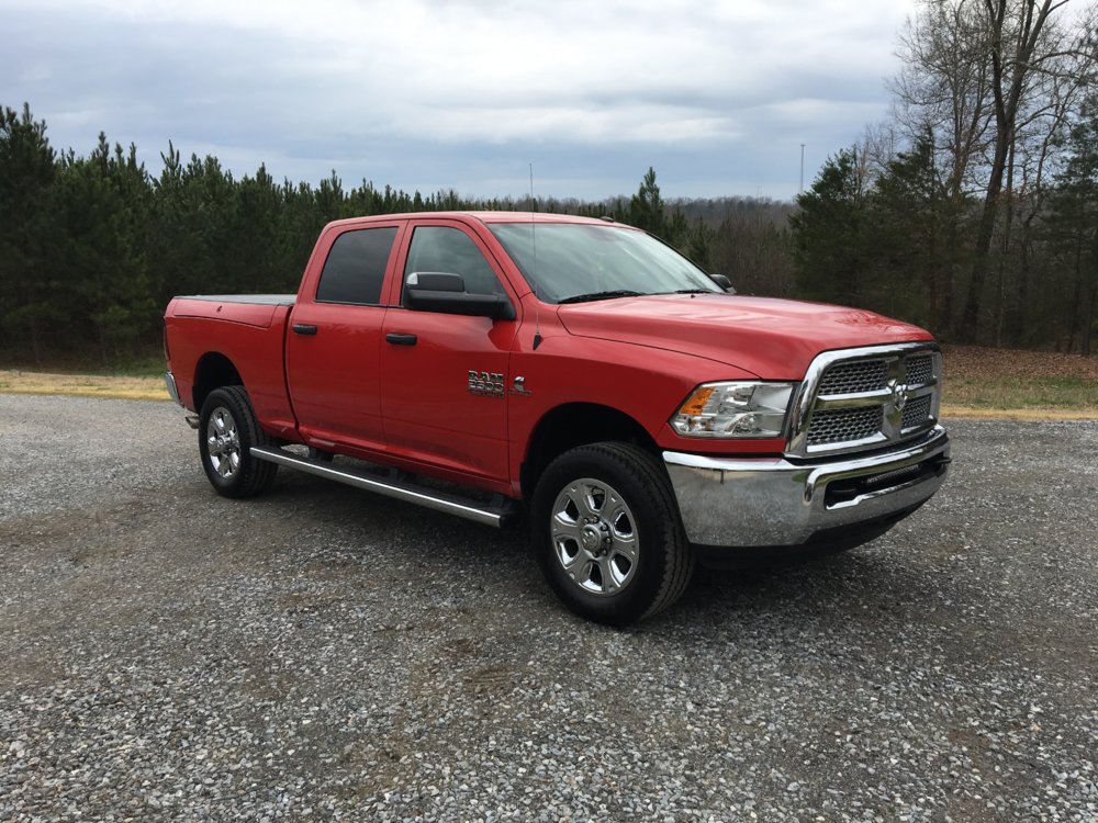

I've got a 2015, 4X4, 2500 crew cab Cummins automatic. In my opinion, the coil sprung rear end rides like a dream. Huge improvement over leaf sprung previous years. Air pressure is key. I dropped mine to 70# and that doesn't piss off the TPMS light. I can get 23 mpg rolling down the highway at 60-70 mph unloaded. That's mostly a result of those 3.42 gears. I only tow once or twice in a month, and that's to the trail with my S10. Easily a 10K load and fuel economy drops off quickly. I'm talking 12-14 mpg. I could do better, but I set the cruise control and let that Cummins earn its keep. I'm in the same boat as @Jody Treadway when it comes to trailers. I just traded mine in on a PJ 34' triple axle bumper pull (ETA 2 months). Trailer with 2 rigs is gonna put me right at rated capacity and we're gonna see just what that Cummins is made of. So far, 17K miles and not a single issue. The first 5K miles was in the first month with a cross country trip to Moab hauling my 18' PJ and a side by side.
