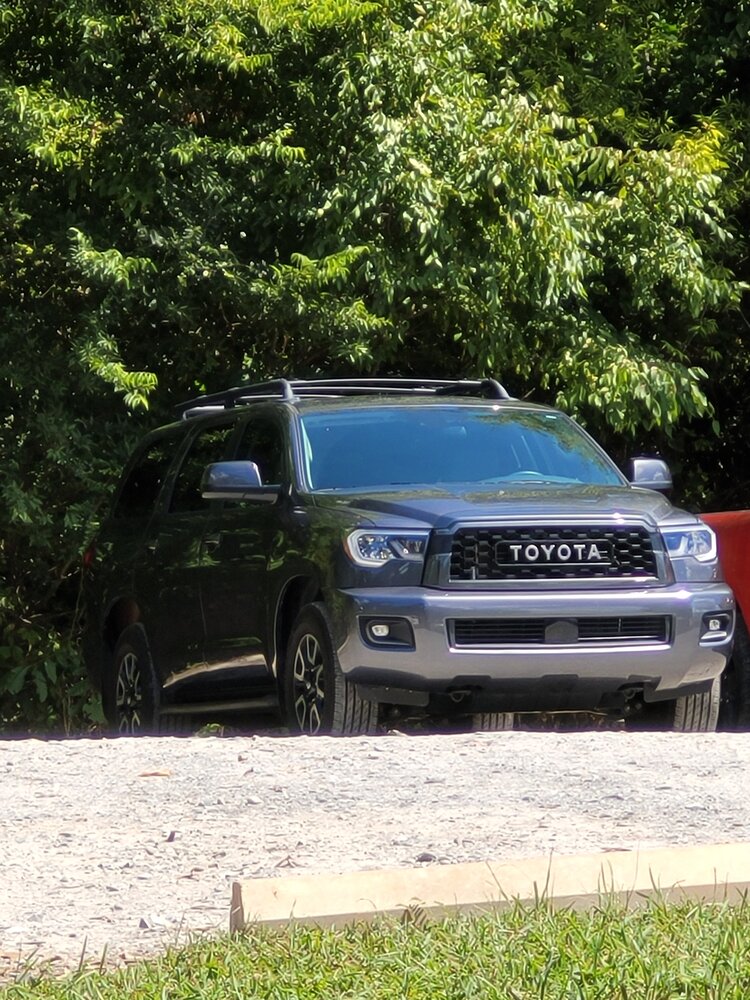

My wife had a 2019 expedition that she really liked but I made her trade it in. It was a comfortable vehicle and the gas mileage was decent. However, the turbo never really sounded right (rattled at start up and when idling) and at about 30k miles the noise was getting more and more pronounced. I figured if the morons at the dealership started digging into it I would be visiting them on a regular basis to keep fixing it and no one has time for that. With the market the way it was/is, I was able to get more on trade in than what we paid for it initially so I sat patient to find a sequoia.
October 21 I ended up finding a 2022 sequoia that the dealer wasn't trying to markup with bs charges so we moved on it. While the mileage is obviously worse with the 5.7 and the 6 sp, if I'm conservative on the throttle I can actually pull better mpgs than what it's rated for (13/17, but I can pull 19 on the highway). The interior is dated but ok. Runs like a champ, fun to drive with the power and gear ratio (4.30) and overall just feels way more rugged and better built. She wants a small lift and bigger tires but we love it and know it'll last for a while.
