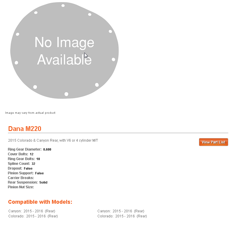

https://www.ringpinion.com/b2c/DiffDetails.aspx?DiffID=352&SearchMode=Diff&TypeID=3
Actually even more useful info here if it's correct:
