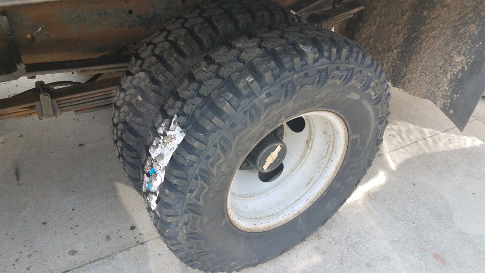

I bought the 1-1/2" spacers and no stud clearance issues
Had NO intention of using spacers, but once the tires went on....well, kinda HAD too. They've been on for 9 months now, and no issues. I've hauled 3 tons of rock per load with no problems.
I've got Stahl hub centrics on my 2500. I think they were like 200 bucks? I don't worry about them at all.
