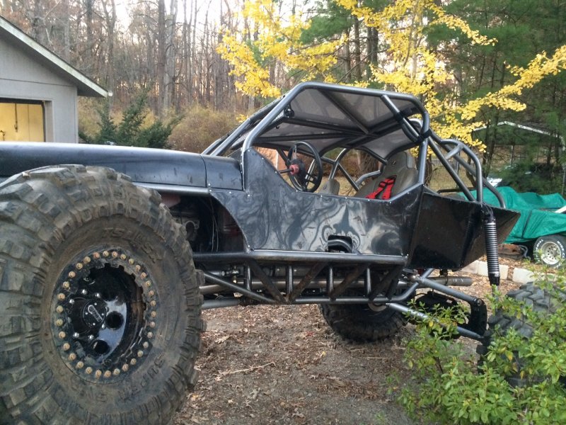

buggy ran good, worked out a few issues, ready to try it again

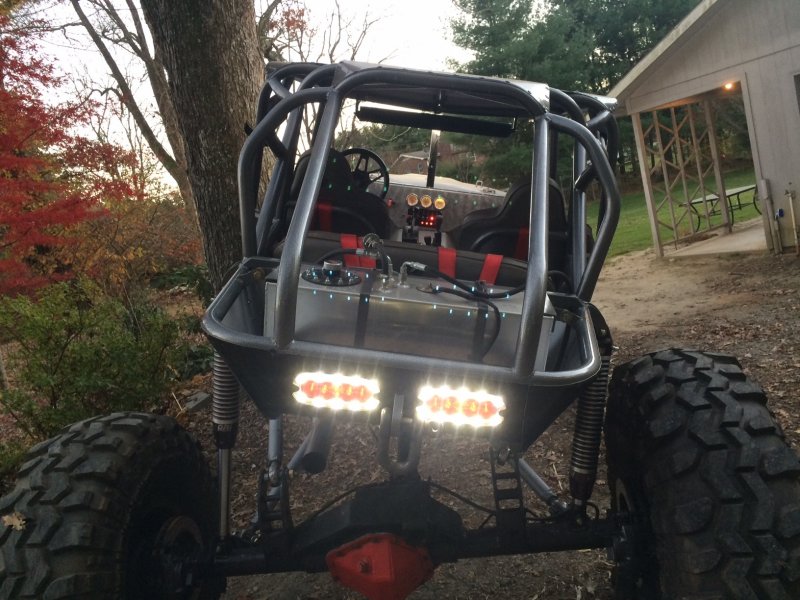

BTW be watchful on your fuel cell. Same cell several of us had. Had 4 of them split and fail in one day at The Dixie Run.
Flex is what kills em.
Mine, Matt's, Chris Griggs, and Tony Wilson's, all split.
If and when it happens, I called and got all of us new tanks.
Don't feel it's flex, i had zero deflection in my mounting. Purely quality control, fusion welding on too thin of material.
I agree that it is likely this plus some flex/vibration. I think that the weak weld/heat zones are moving causing them to be weaker, and the force from fuel sloshing kills them.
