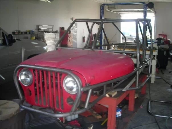

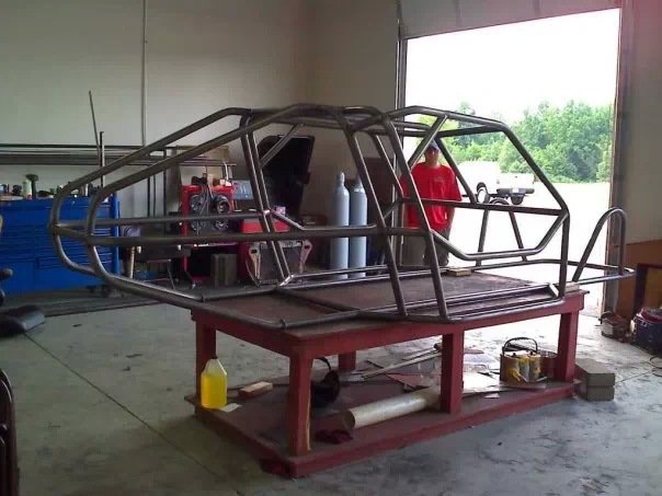

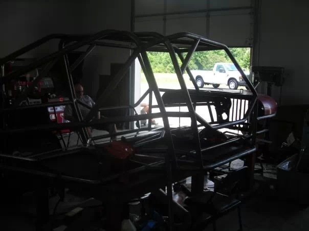

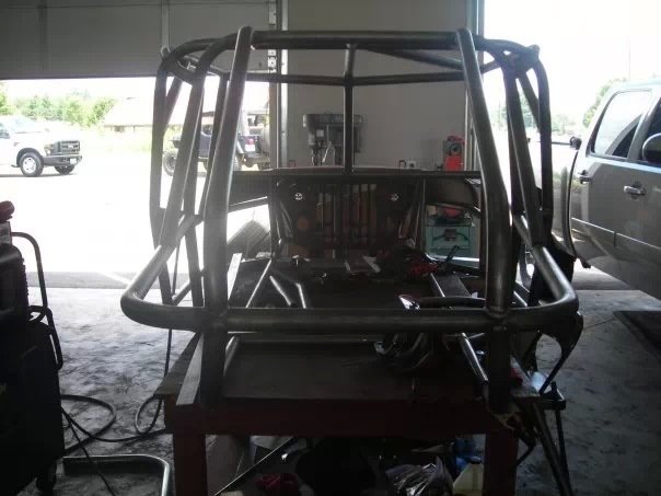

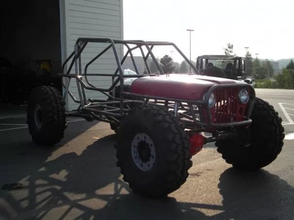

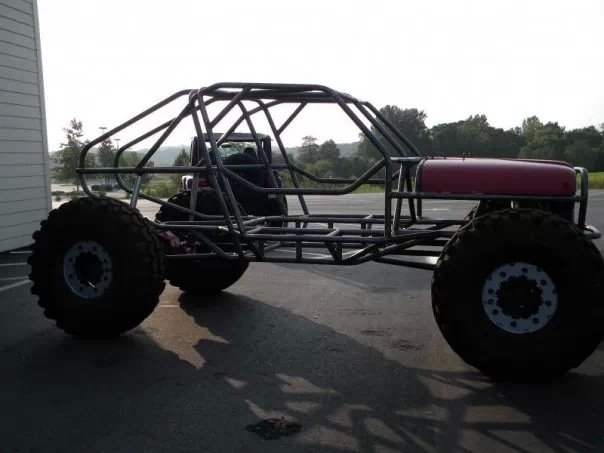

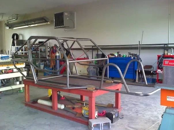

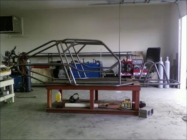

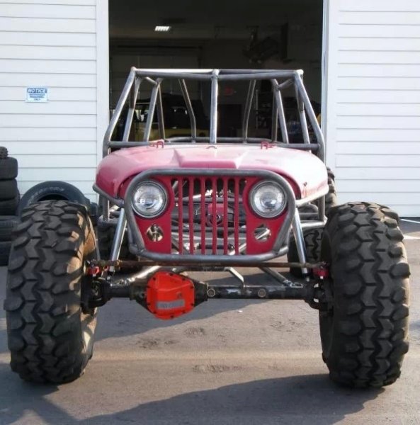

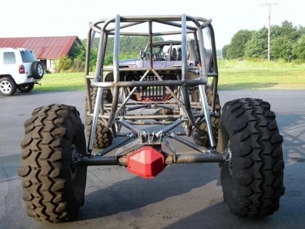

This is what it looked like 6 years ago

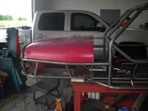

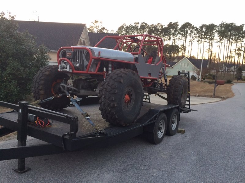

Here is what it looked like when I picked it up, he took the air shocks off and put ORI's on it, which was a plus, he also put steering Rockwells under it and it sat a little to tall for me, and I am not a fan of Rockwells
Fast forward to now, I got it home and debated on finishing it up and wheeling it like it was, steering Rocks, 44" TSL's, 16.5 H1's, 6.0, turbo 350, 203/205 doubler

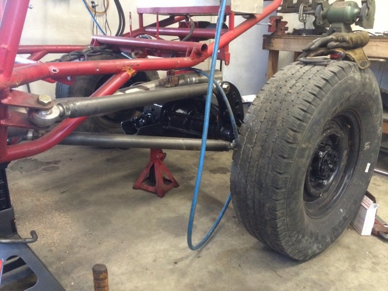

NOPE, not gonna happen, sold a bunch of the other stuff on it and started tearing it down to make it mine again

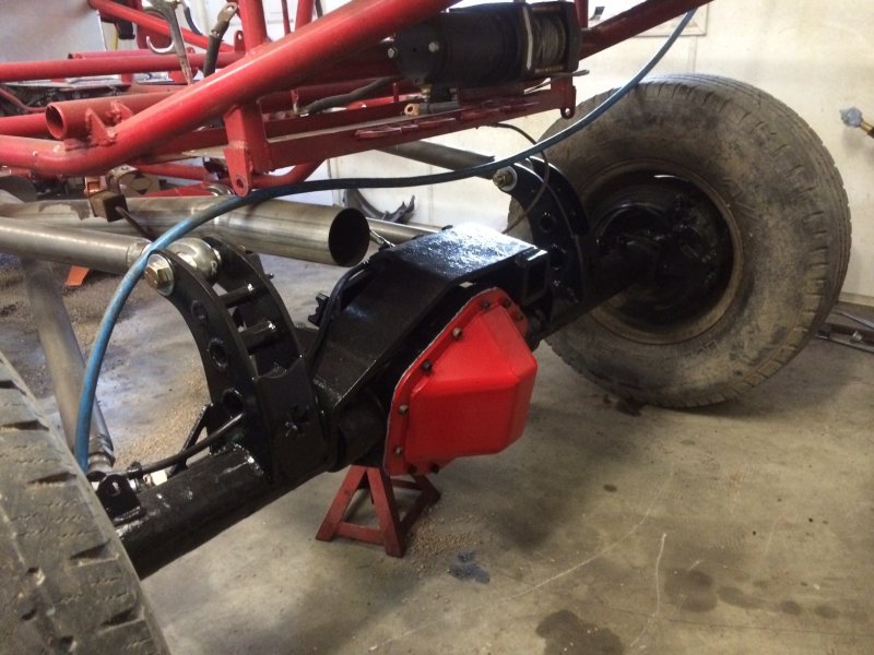

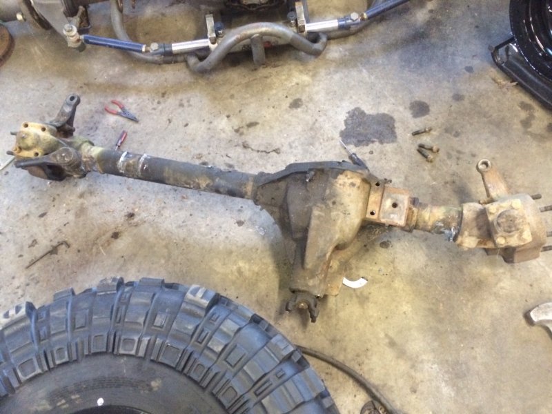

Plans, CUCV 60 and a 14 bolt, funny story, I actually bought back the 14 bolt that was under it when I sold it from Dave at Oliver's, long story
the 60 will have 4340 inners and outers, Yukon super joints, Spartan locker, and a bunch of other ECGS goodies, thanks Chase, and some brackets and cover from Barnes4wd

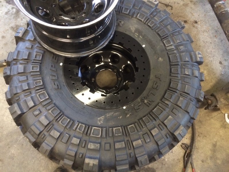

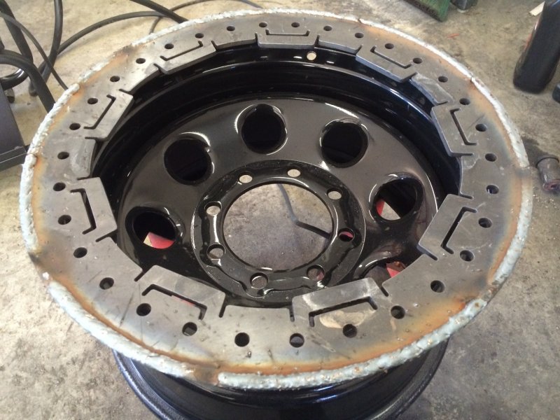

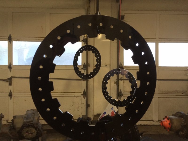

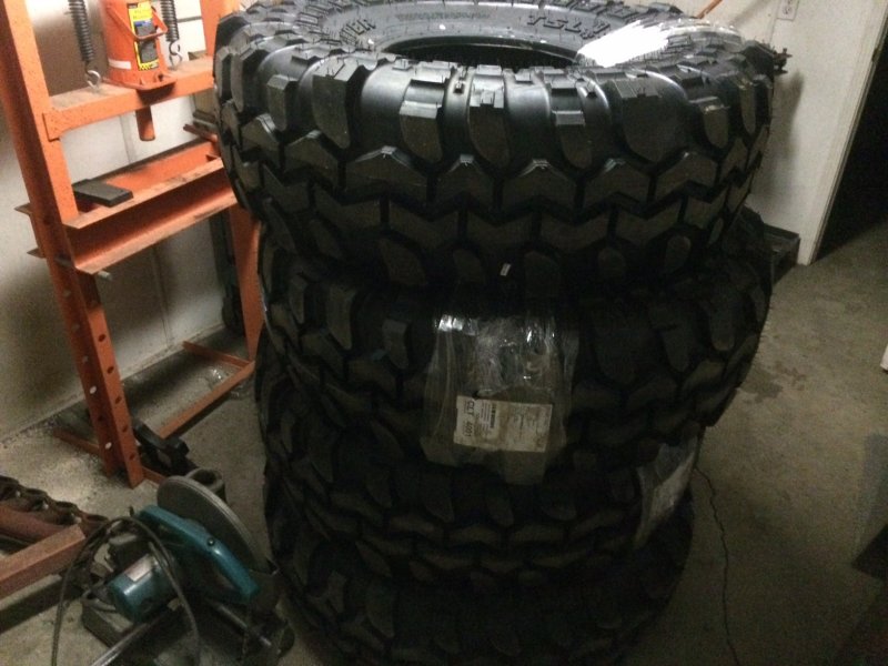

6.0, jims tune and harness, Cooks turbo 350, Atlas 4-speed, TMI customs 17" Beadlocks, and 43" SX's, Thanks Brandon at RIDES, and I am lowering it back down

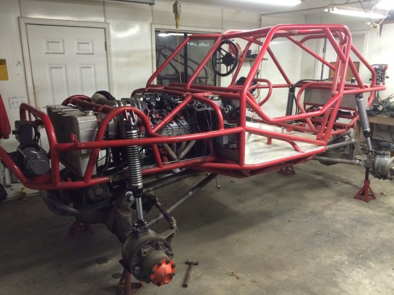

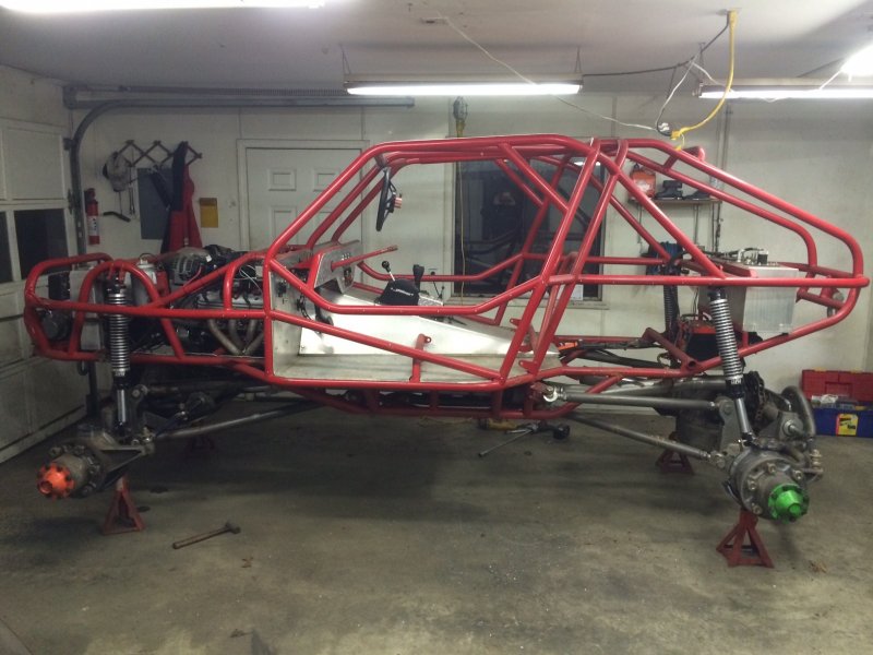

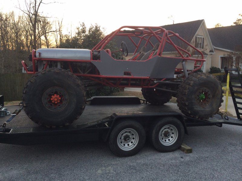

here is how she sits now
