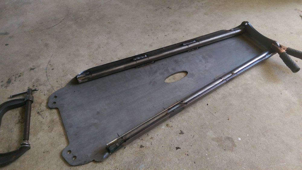

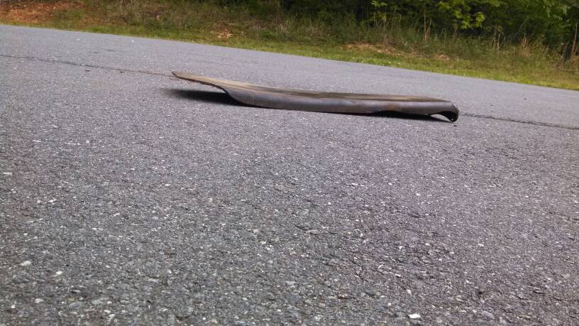

Actually I have had their oil pan skid and unless it's reinforced don't buy it, that bitch will be fondling the oil pan and exhaust tube after a couple of good hits.
For reference
Fuck that. Just bend up a hoop out of 1-1.5" tube, add a couple of kickers up to the frame, and plate the bottom with a piece of 1/8" or 3/16"
Add some Swag body mounts and a half-dozen 1" or 1.25" body pucks, and a Brown Dog MML, and tuck the whole drivetrain up into the chassis. Some more tube makes a transmission crossmember. A piece of 3/16" plate or maybe a Barnes t-case skid finishes it off.

Lets test your welding skills Joe!
I'll buy the material, if you build us a couple :cool:
I can do it. But if I ever rebuild mine I would do it like Shawn said above, except replace the steel plate with uhmw plastic for a more slippery surface.
