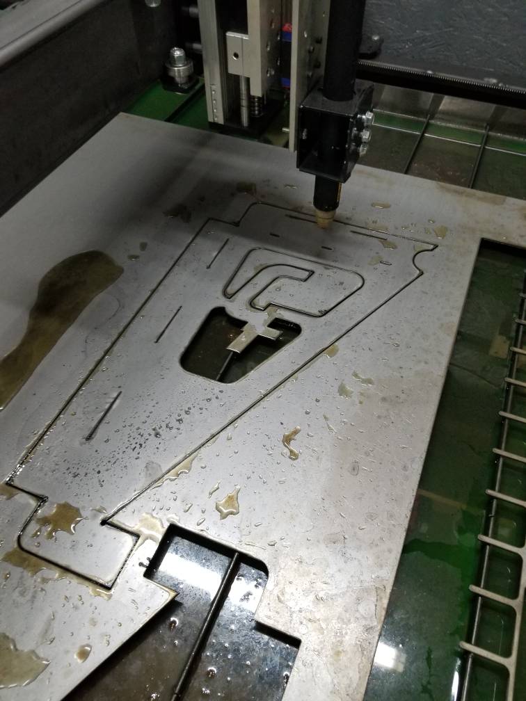

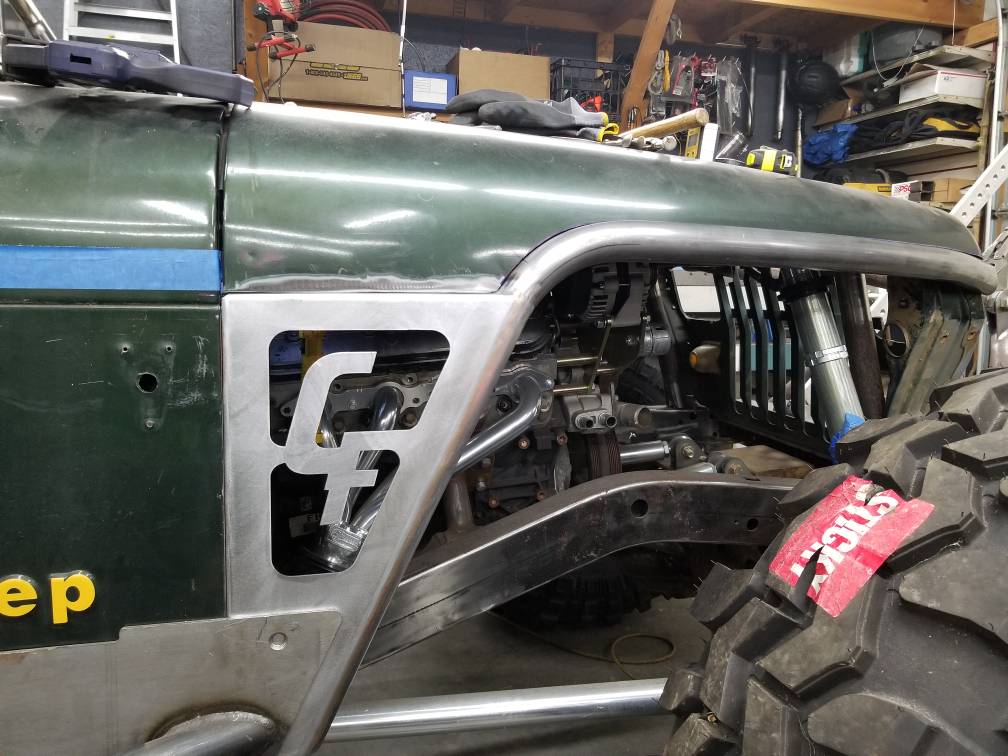

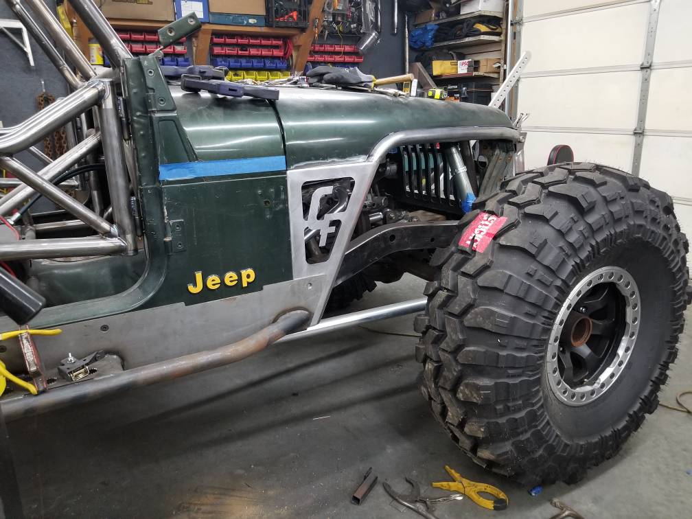

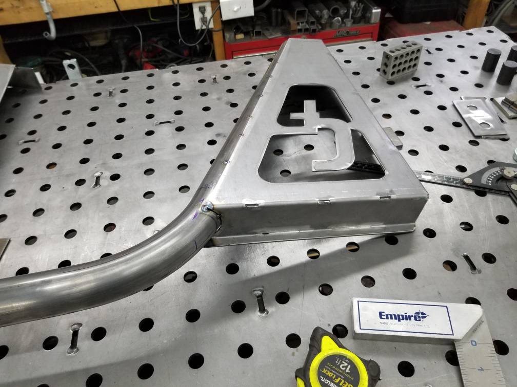

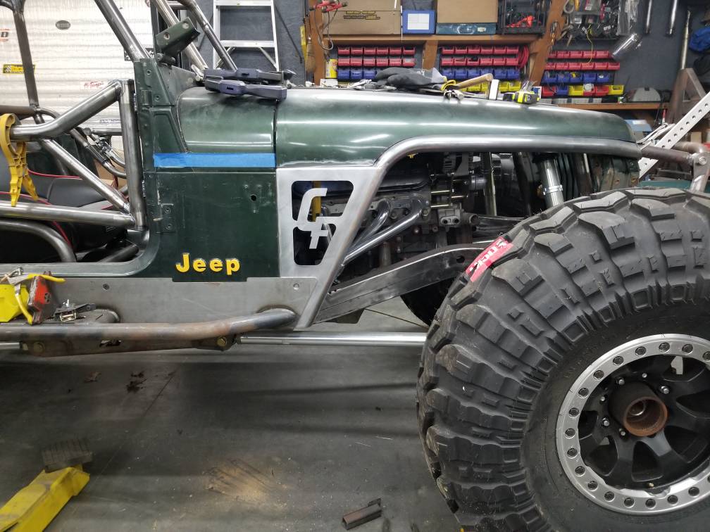

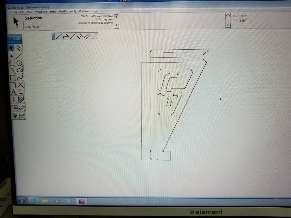

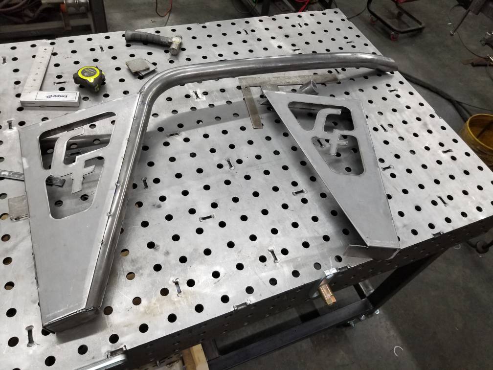

Added some branding to the new fender. It will have some stainless mesh on the back later. Learned the bend radius dimensions after 1st run, adjusted the drawing on this run, bent out in perfect x/y dims. Doesn't sound like much, but it really is from a fab stand point= less time and tweaking. Glued the skin to the tube with some silicon bronze; it blends much easier being a softer material; and less heat in the sheet metal.

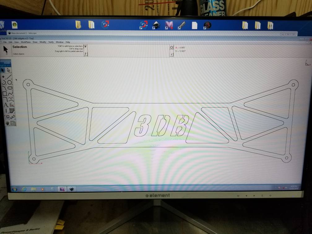

Also had some time to draw the tailgate opening replacement...
