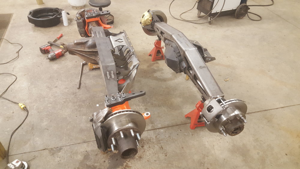

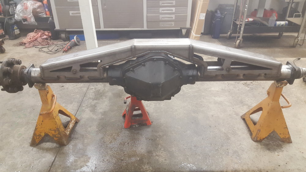

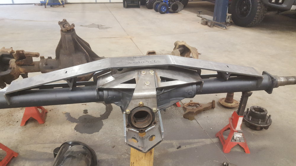

I have decided to build another crawler. YJ based as the original 3DKrawler. It most likely be Gen1 sbc with Holley EFI, TH350, Ford HP 60 front with a locker 5.13 and RCVS. Shaved 14 bolt with a spool and 5.13. Suspension is Fox 2.0 14 inch coilovers using Motobilt's 4 link system and rear frame kit.

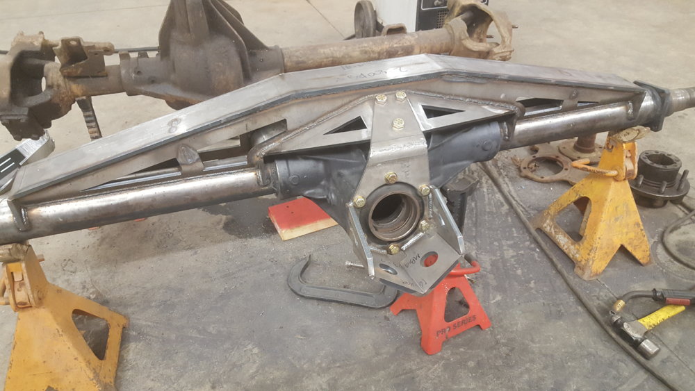

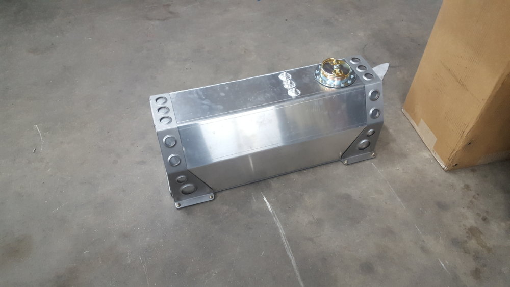

I got to see the Moto built 18 gallon fuel cell the other day. It's not welding, it's Art!

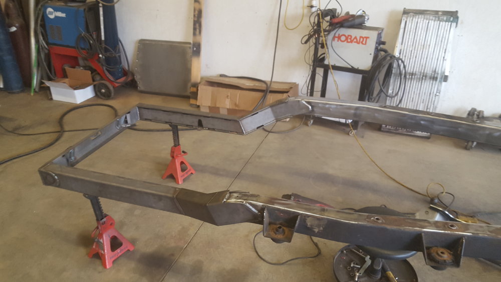

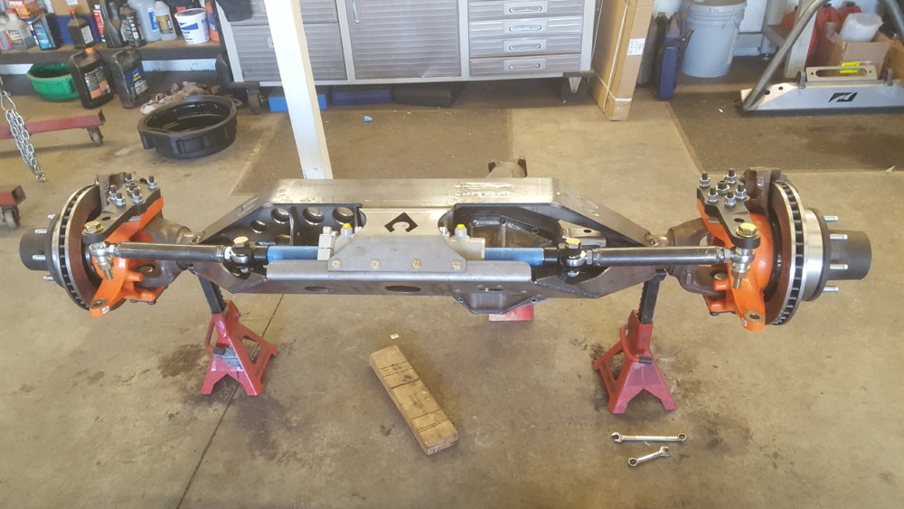

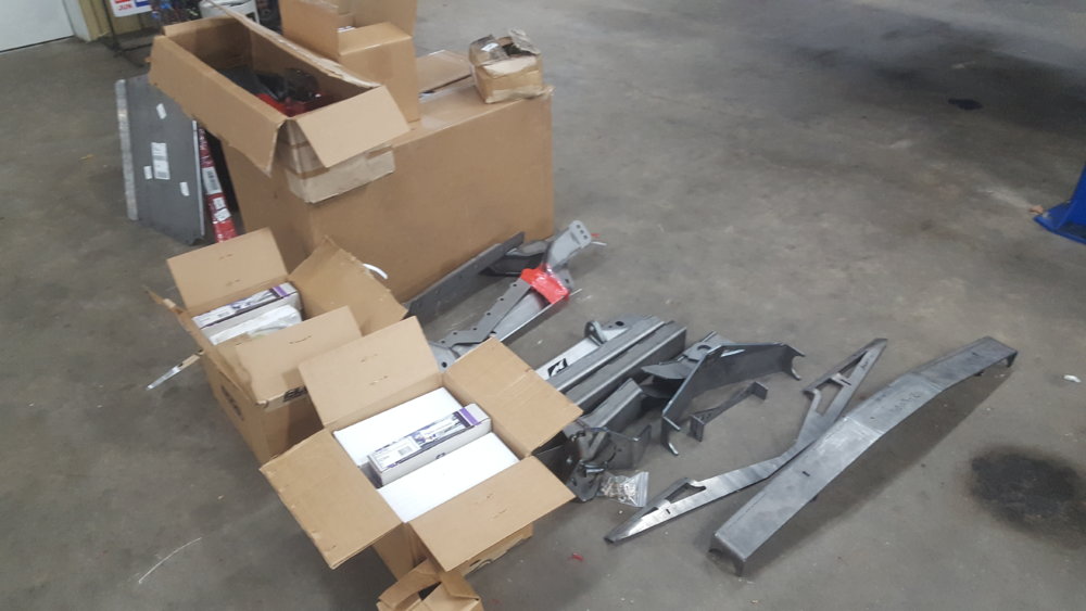

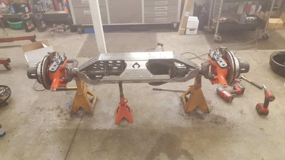

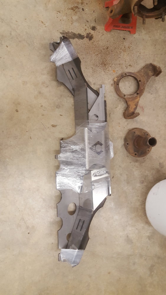

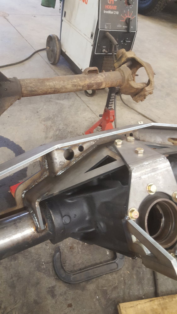

Thanks Matt, it fit very well with some slight grinding for a good tight fit. Hoping the Artec front truss is as quality of a kit as the Motobilt. Dan is working on a Ford 60 front truss.

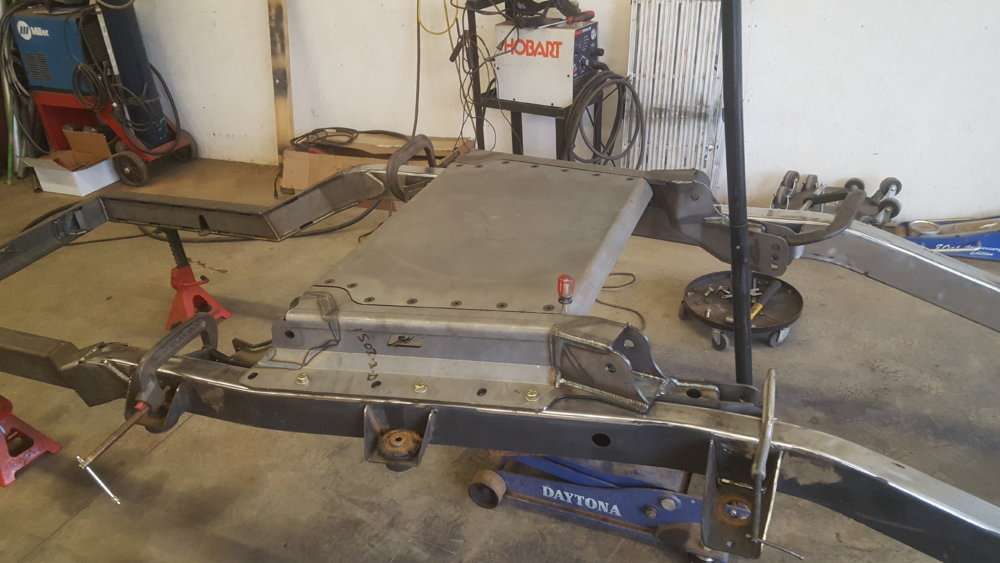

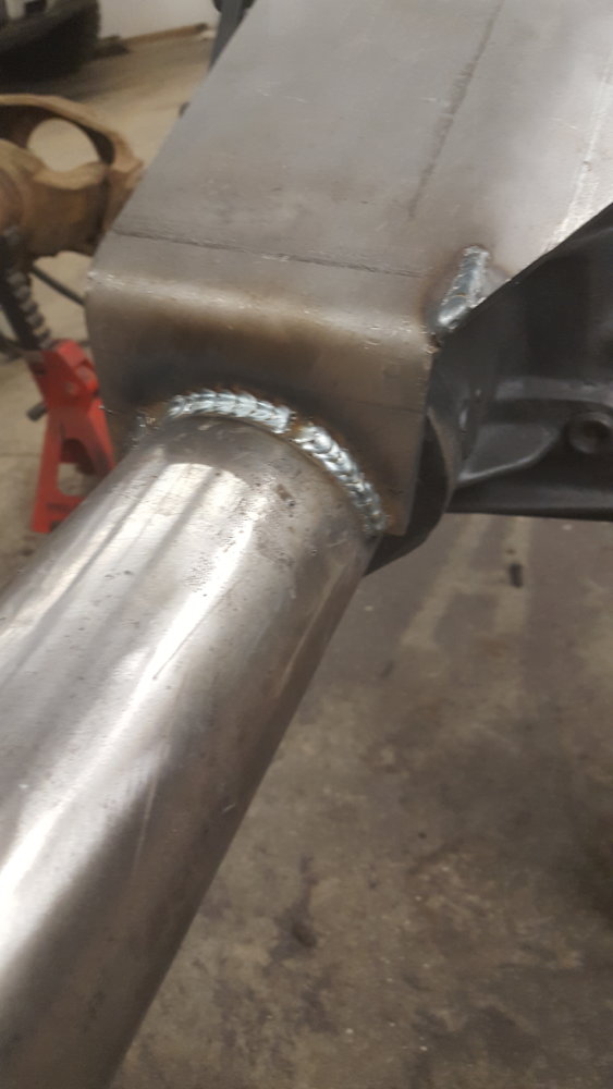

That's tight looking, Nice work.
Damn that's good looking!! Giving me some inspiration to drag my heap back up out of the weeds.
