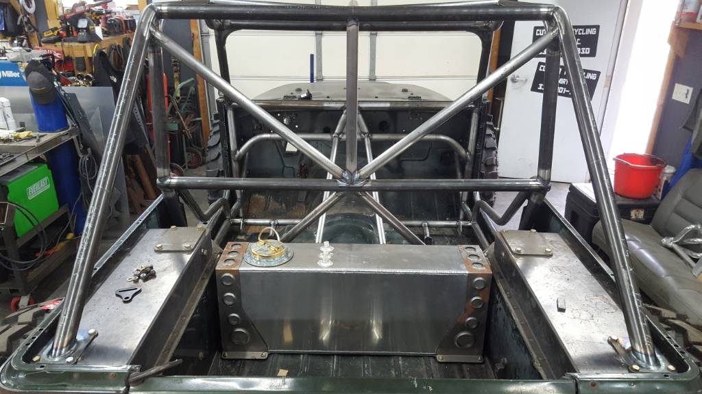

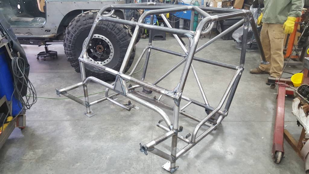

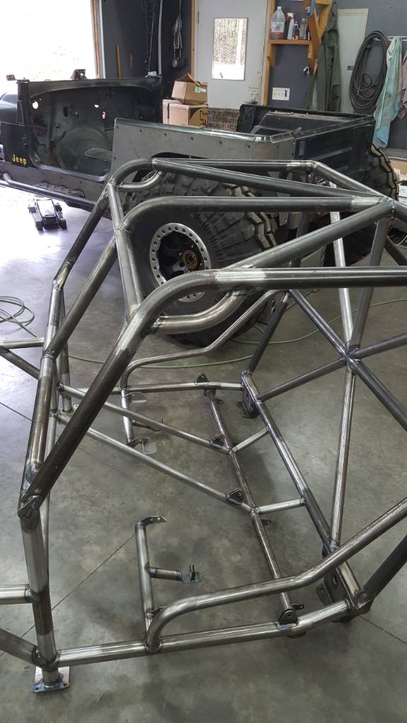

Cage has been removed, fully welded , and made its way back home. Ready for the last tie on to the engine cage/ front half.
Thanks @BigSouth for making the trek to Mayberry for couple days and giving me a hand with the heavy lifting. Nice to have a a willing shop hand for a bit.

Very nice. I dont have a jeep and Id like a family version :bounce::bounce2:
You have taken all the measurements from this cage, right? I could see potential buyers for a built cage that they could simply bolt into their jeep.

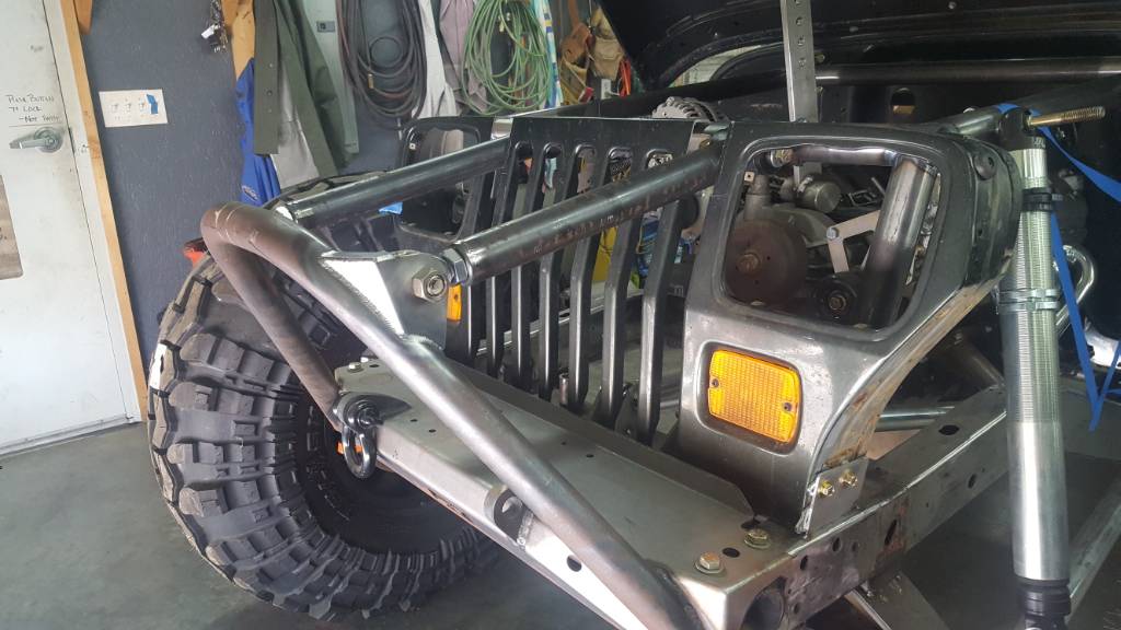

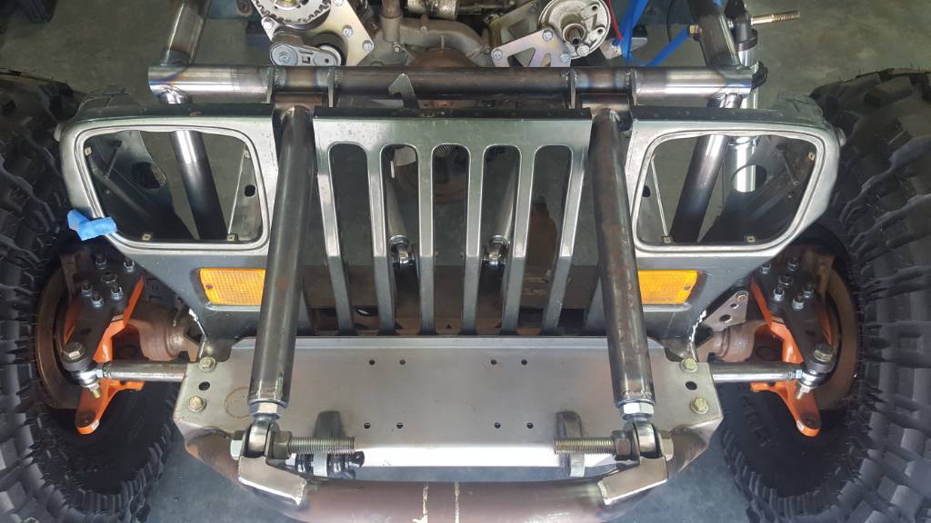

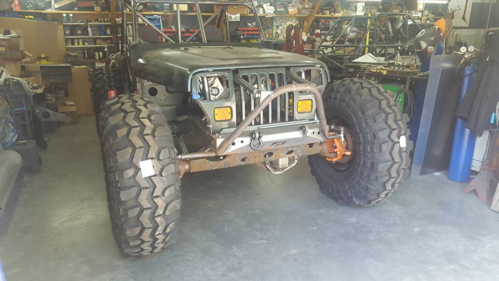

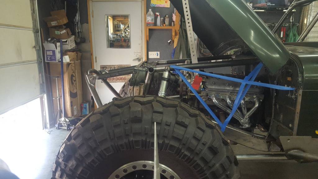

So I knocked out a small task, with the front bumper.

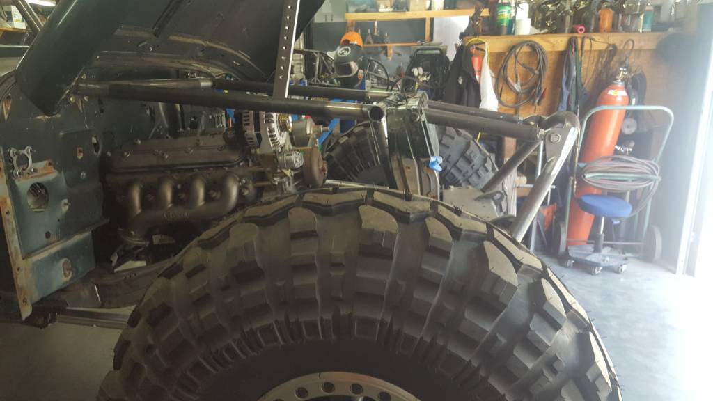

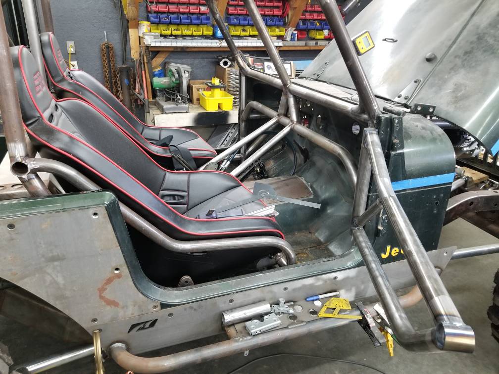

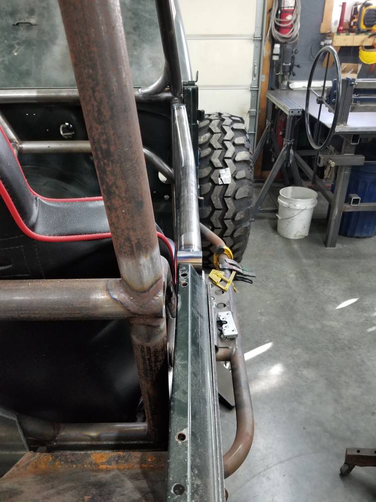

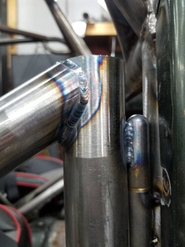

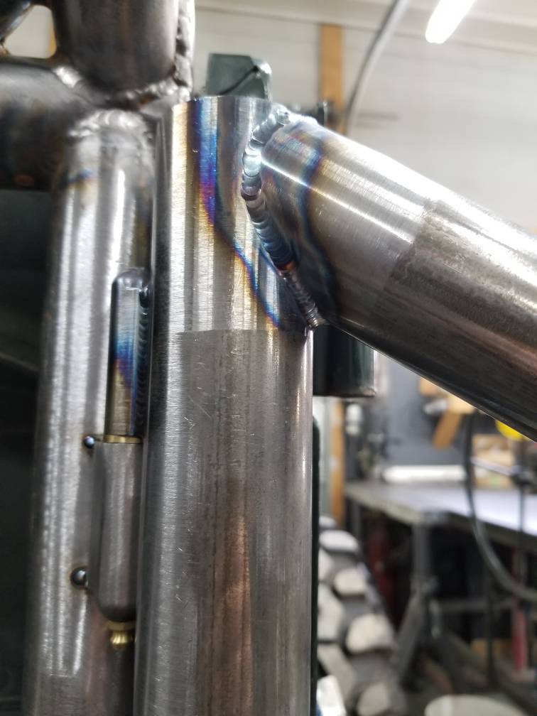

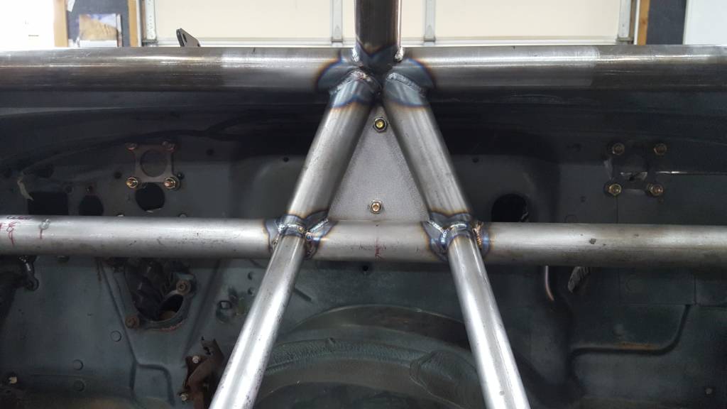

Working on finishing the tube work on the front half.

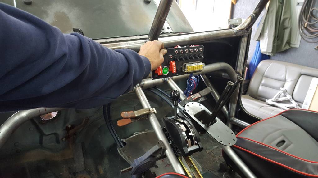

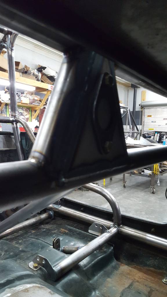

And a little brainstorming on console area.
Matt

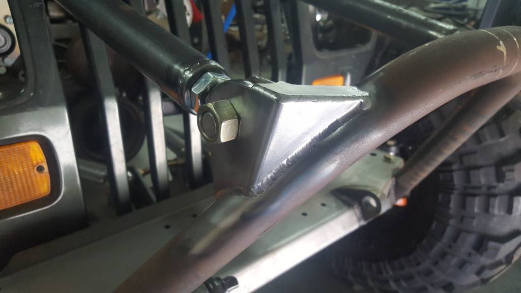

This might be a dumb question but what’s the purpose of the heim and bushing going from the tube behind the grill to the stinger? Is that just to keep it detachable if need be?
Awesome build by the way!
Sent from my iPhone using Tapatalk Pro
Bolt on bumper. Keeps it replaceable, and carry a couple spare suspension/ steering heims. It's not a coincidence that it's a straight line load path to the engine cage and roll cage.
