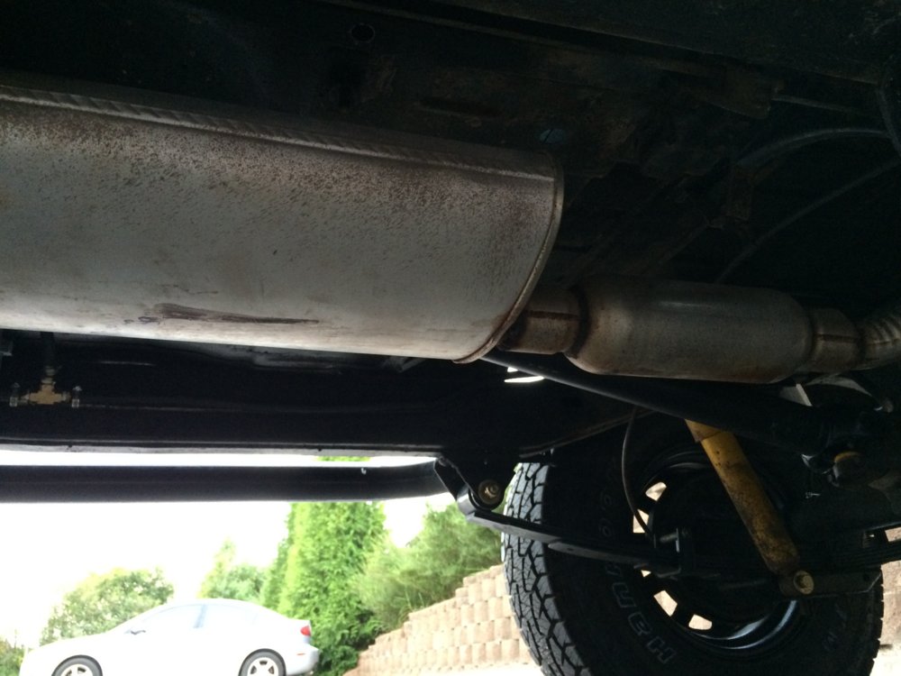

I wish I knew what mine was, but I absolutely love the way it sounds. It isn't loud but has a great burble at idle. I'm really hoping I can duplicate the sound when I upgrade my exhaust.

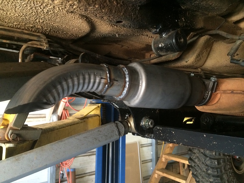

If you're not running a full tail pipe right now, that will make a huge difference. I tried my FM50DF with a turn down and hated it. With a full pipe exiting right under the bumper and it is a night and day difference.
Hood stack? Lol
I'd go with another Flowmaster and stuff a glasspack in front of it to act as a resonator. Should help pull some of that drone out.
Both TJs have a solid tailpipe that extends to the rear bumper.
The one with the Flowmaster is still loud as fuck.
