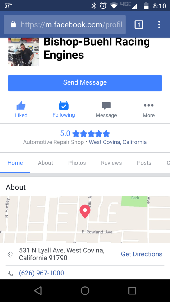

How does one contact this gentleman for purchase of pistons and rods?
Just ask yer buddy up the hill from ya
I'll give another +1 for Russ Pottinger. I ordered a cam from him the beginning of the year. Real nice fella and will take the time to talk to you about your build. I went a different route on my pistons to save a few bucks but I burnt up some of that savings on a little extra machine work, and mine are hyper not forged.
Russ and I talked a bit when I coming up with my valve setup. It took a little extra machining but I've got a set up now that'll give me a lightweight beehive spring, .570ish lift and safe open/seat pressure that won't eat a cam like some folks do. I'll be able to wind this one up with no worries. Hehe
Another vote for Russ. Most of the guys I know that have strokers on NAXJA over the years have dealt with him. If I ever build one he will be who I call.
