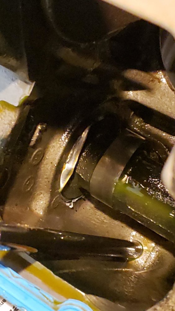

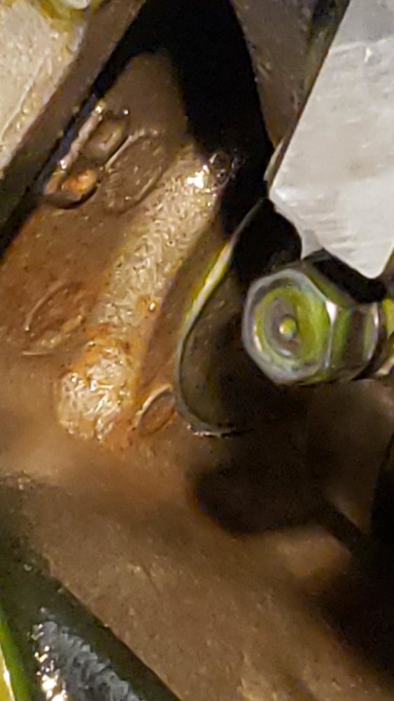

What causes cam bearings to push out like this? Also, half of my lifters I can move the inner with my little finger.

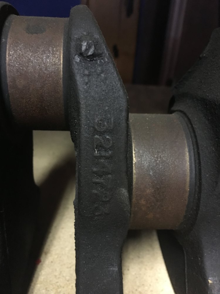

The cam still looks good.
Did you have the cam bores line honed? I'd think if it was run good and hot it might have distorted. or maybe if they didn't take force to drive in or maybe the cam out of true. Just a few ideas for thought food. Maybe are they supposed to be staked in?
I had them installed at the machinist. The bearing the were in the block looked good. So I did not request line boring. I'm going to drop off the cam to be checked tomorrow. It looks good though. All the lobes look fine as well as the bearing surfaces.

One of the bearing pics looks like the lead smeared, did it?
Yea, no oil psi at Idle and drove back from Uwharrie. I have all new bearings coming, will be here tomorrow. I hope to have the block back by friday so I can start putting it back together this weekend.
My Machinist has finished the inspection of the head and the block. no issues were found. He and one of his old engine builder buddies both looked at it. Their conclusion is the I got some shit bearings from 505 performance..
