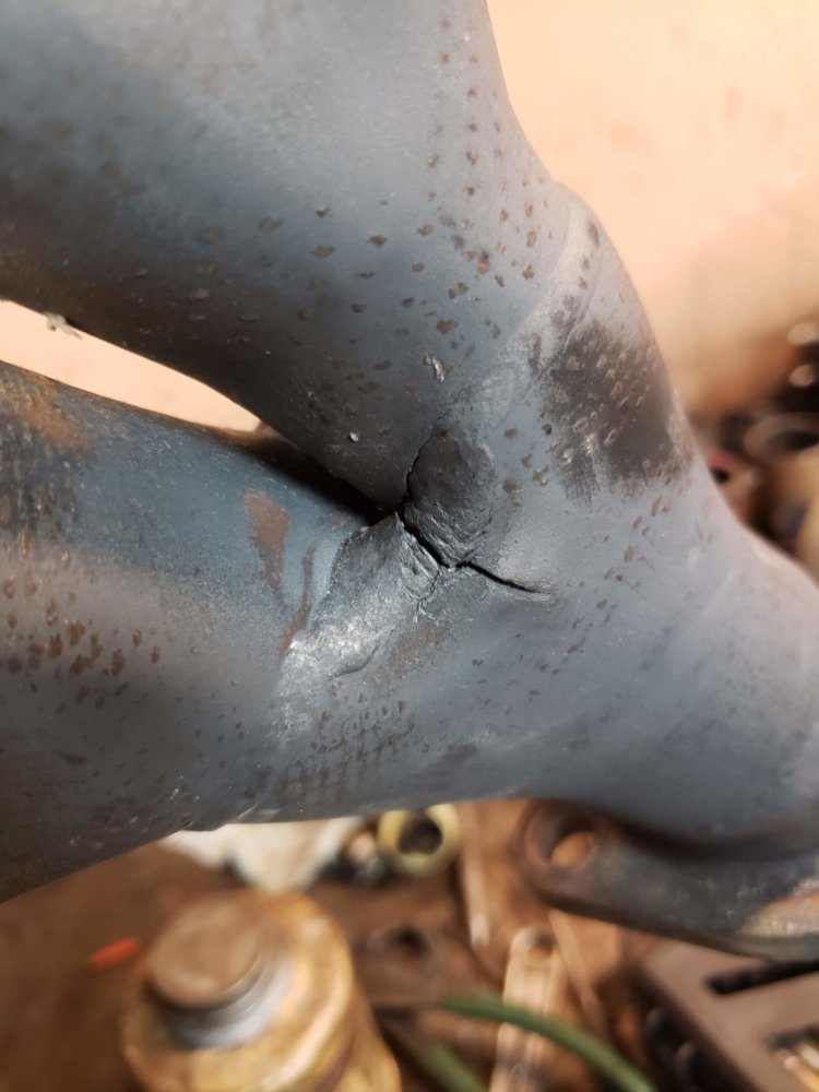

I found a crack in the new exhaust manifold. I had them wrapped, pulled it off last night and welded it up. Put the 24lb injectors back in. Still has the noise. The manifold crack is pushed out. looks like it's from heat and excessive back pressure, probably the lean injectors cooked it. High flow cat on the way.

Found it, dont know how I missed this crack..

Are you running a flex pipe after the manifold? Just curious.
I believe I caused this by wrapping the header. Held the heat in making the cheap grade stainless brittle.
I welded it with regular mig wire and used a 304 stainless tig rod to help as filler.
I will be, but that's not what caused these cracks.
