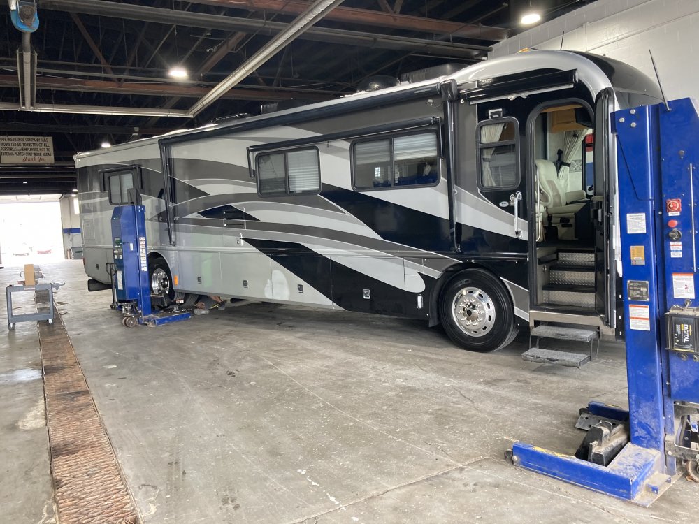

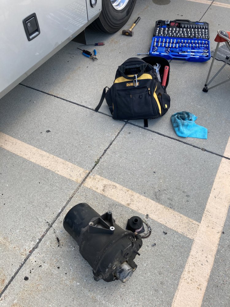

Rebuilt purge valve didn’t work. Replaced governor didn’t work. After 12 hours of tinkering with it through the night, I gave up and called in the pros. Looks like the air dryer went bad.
Dang dude that sucks. Hopefully this is the last kink you have to work out.
Hopefully you are back on the road now and that is it for the rest of the trip. Curious as to what the symptoms were that lead to the air dryer?. Keep the updates coming. Happy Father’s Day to ya!!
The air dryer...
we pulled into the Omaha Zoo parking lot and got a “low air” warning.
I checked it out and air was constantly coming out of the purge valve. These have a tendency to fail open and cause this issue. So naturally I did that first. No go. So I tinkered with it some. Found that if I have everything hooked up, I got just about 45psi of air instead of 125psi, even when I plugged the newly replaced purge valve. Hmm. So I started to focus on the compressor and governor. Pulled the hose off the air dryer coming from the governor and she built up to 110psi, even with the governor hose disconnected and blowing free. So figured it was not the compressor (whew!).
so I started to focus on the governor not controlling the air to the dryer. Bout a new one and replaced it. Same condition as before but the purge line quit blowing off constantly. Partially fixed! Now to get the air up to 125psi. Looked up some schematics of the dryer and saw some internal components that I hadn’t and couldn’t service.

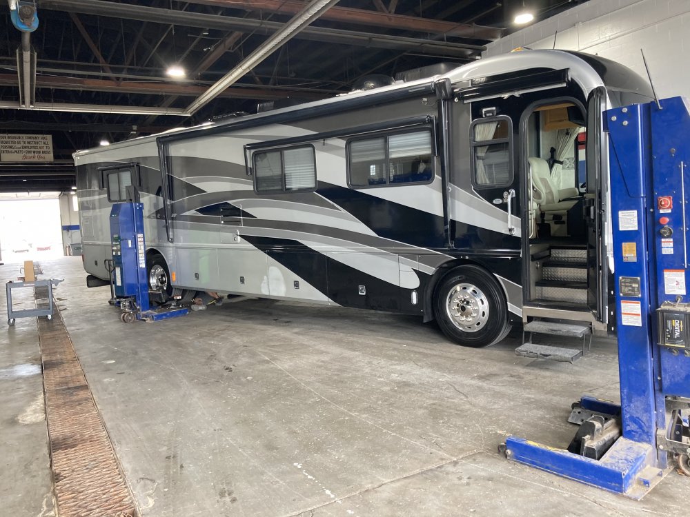

the road mechanic arrived and hooked up his air and verified the new governor operated correctly and the compressor u loaded at the proper psi. They both functioned good. We bypassed the dryer and everything worked flawless. So we determined something internal to the dryer had failed. So I drove to the shop and they swapped it out for a new one, never mind the new $125 filter and $110 purge valve that was now installed on it. Ugh.
But, it’s all fixed and now back on the road. For anyone with an older Bendix/HDX air dryer, I’d upgrade to the new, ADP one. It’s newer technology, easier to service, and parts/replacement is much cheaper.

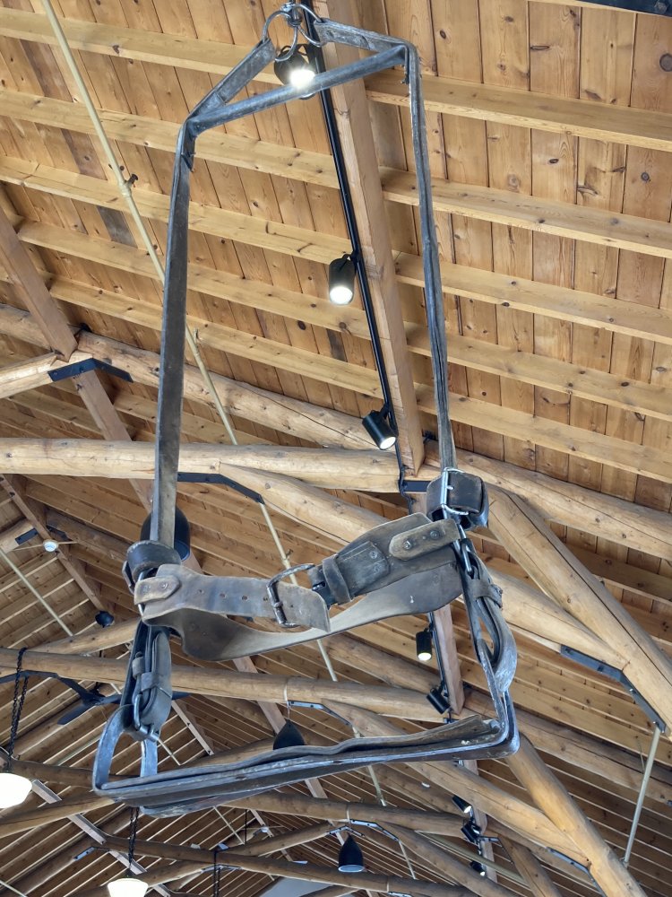

boatswain chair from construction of the sculpture. That’s a big NOPE for me even though I don’t mind heights as an old iron worker.
