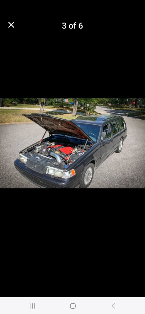

450 hp LS1 on 87?
Not sure, but I'll speculate oem. It's all tied in to the obd.
Gotcha. If its the oem ecu, it should pull some total timing, assuming the knock sensors are still in the chat. Personally, I'd buy that in a heartbeat and try it on 87. The cam probably does have more overlap (narrower than stock LSA) and that'll help. That would be a blast as a DD.
It's not a vette. It's a swapped volvo wagon with a gto drivetrain. I want a fun daily driver.
My point still stands.

Heard back. It is the gm ecu.
Had this one. Made 24lbs of boost. Was a cool ride. But not ls rear wheel drive cool lol šŸ˜‚
