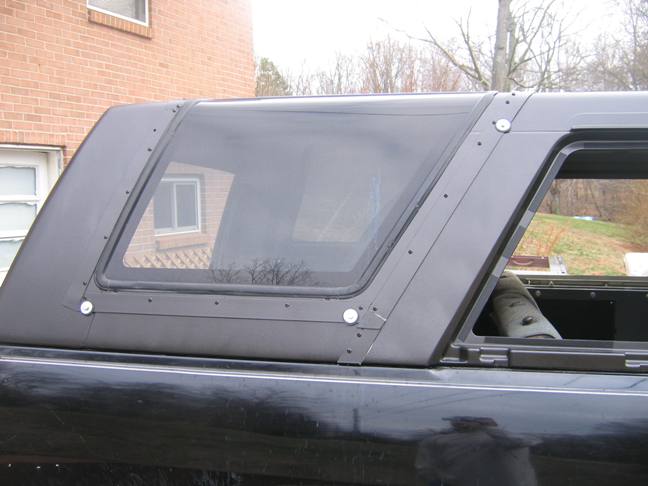

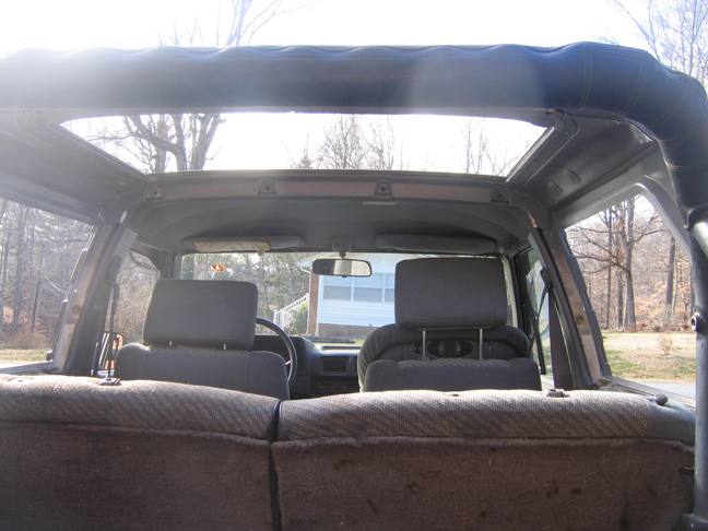

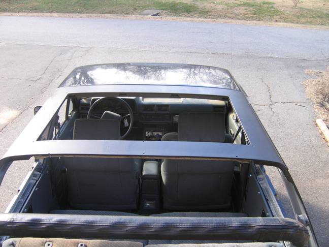

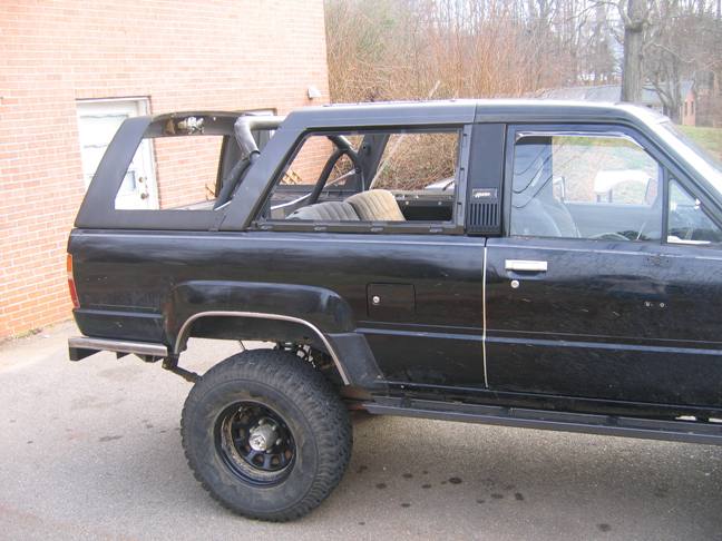

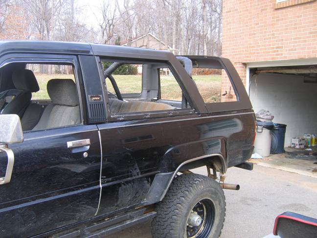

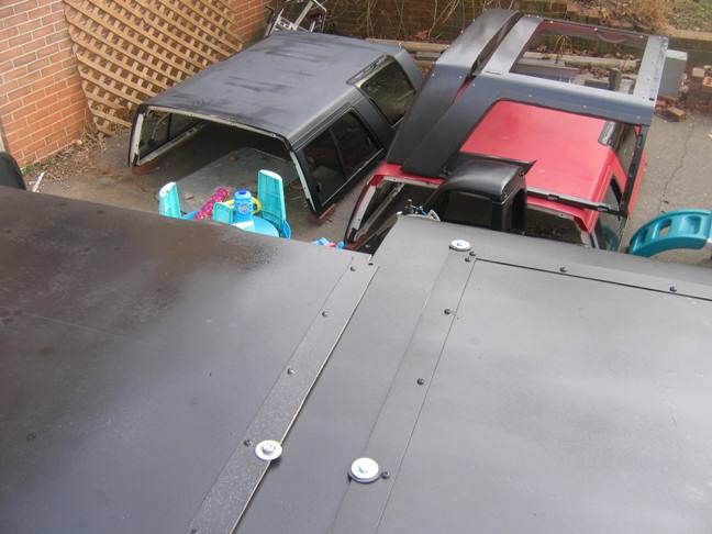

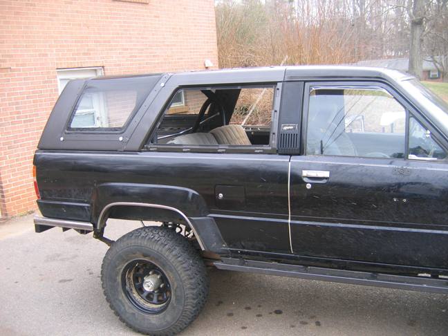

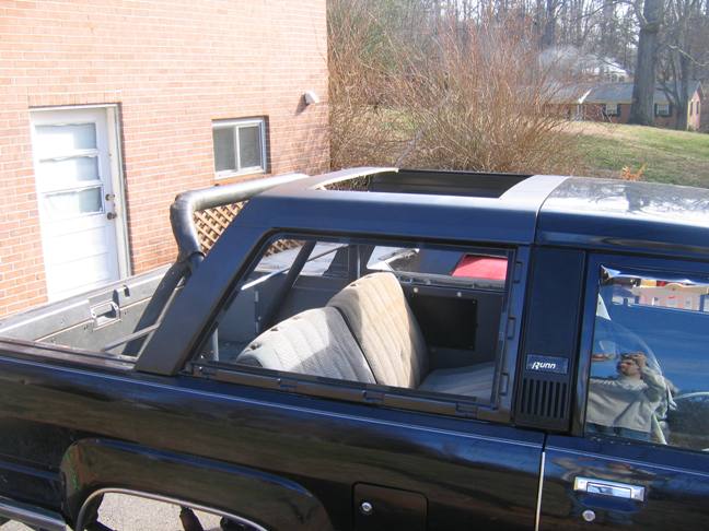

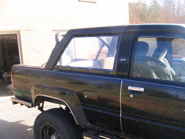

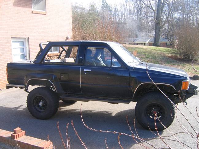

Here are some snapshots of the chop-top I recently fabbed up for a 4Runner.
It's made to be taken apart in panels for easy removal/storage.
Here's popping it together:

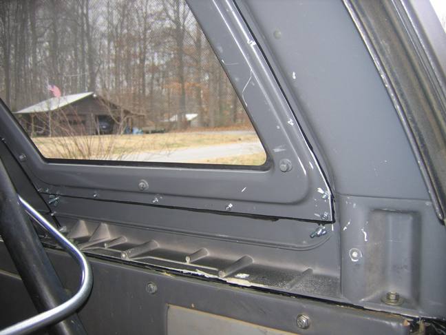

And the side windows, made of clear acrylic:

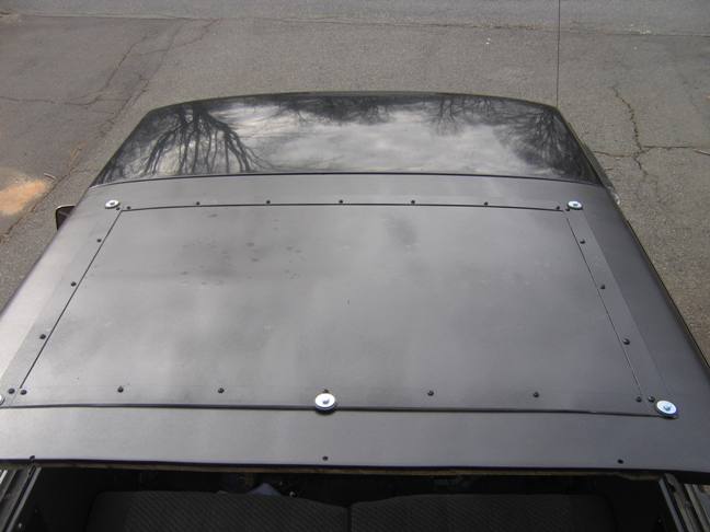

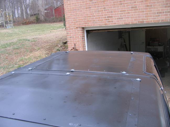

Looks good. have you run a water hose or it yet.. yo see if it is water tight?
I did this last Sat...
and found some nice puddles in the back.
Profanity ensued.
Glad I did it though!
There were some places where I'd missed putting waetherstripping on the inside of the corners.
I've re-sealed them... the new test comes this weekend....
And ifi t passes the "hose test" - then it's off to the ULTIMATE test at the drive-through car wash!

Most of it actually went pretty quickly, just messy.

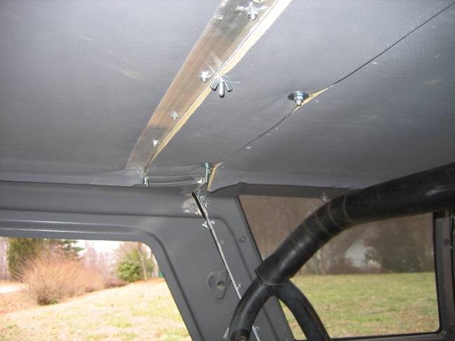

It's those damn aluminum channels... bending and bolting them... that took darn near forever.

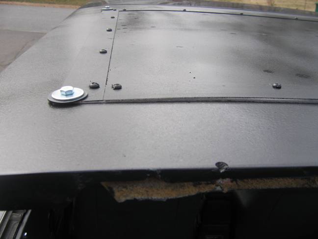

might want to consider caps on those bolts sticking down into the cabin; that would hurt like hell going into passengers head on a good bounce
Eh, good reason to keep a seat belt on!
