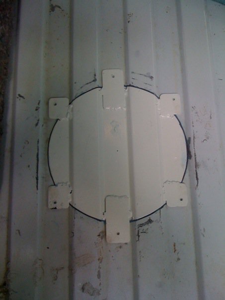

Anyone else cut a inspection hole for fuel pump work on a burb? I've done it on a Zj with great success did whole pump replacement in about 2 hours including cutting and riveting new metal back in! Rear carpet is ruined in the truck already so won't hurt my feeling to cut it and eventually replace it and I'll probably not sell this till it's not worth anything to anyone else!! Maybe I'm just being lazy haha
I did on my old 2500 Burb because I knew when the pump failed, the tank would be full (44 gallons)... and wasn't going to haul an empty 55gal drum & pump for that crap!
When it did finally die, @obxfisherman (got it from me) was VERY happy to turn a multi-hour repair into 20 minutes!
How did you figure out where to cut hole on it? The one one my jeep didn't look quite that good not gonna lie lol
