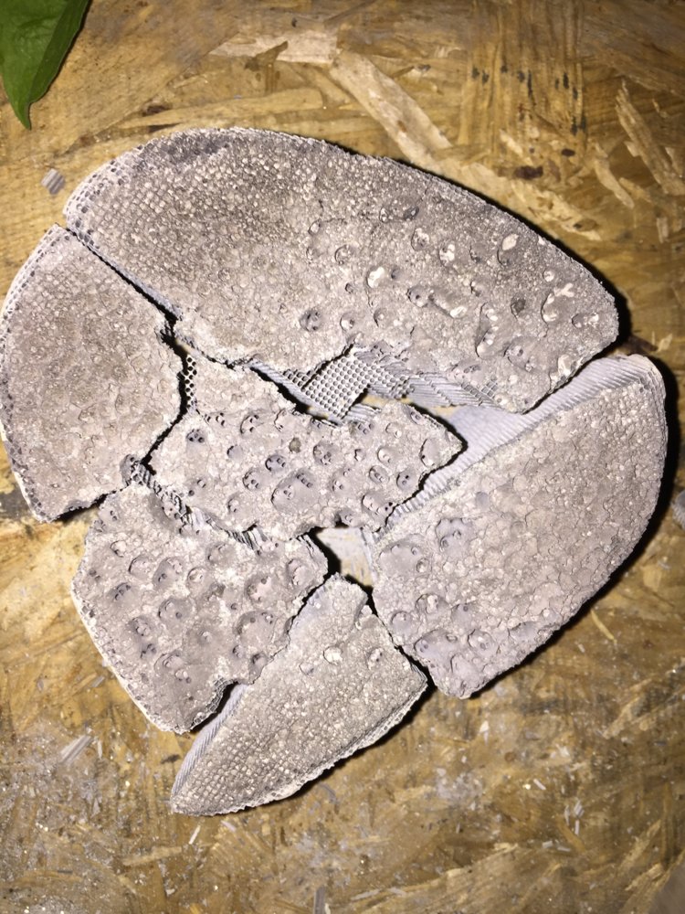

This is what I seen in my cat so it looked great imo...

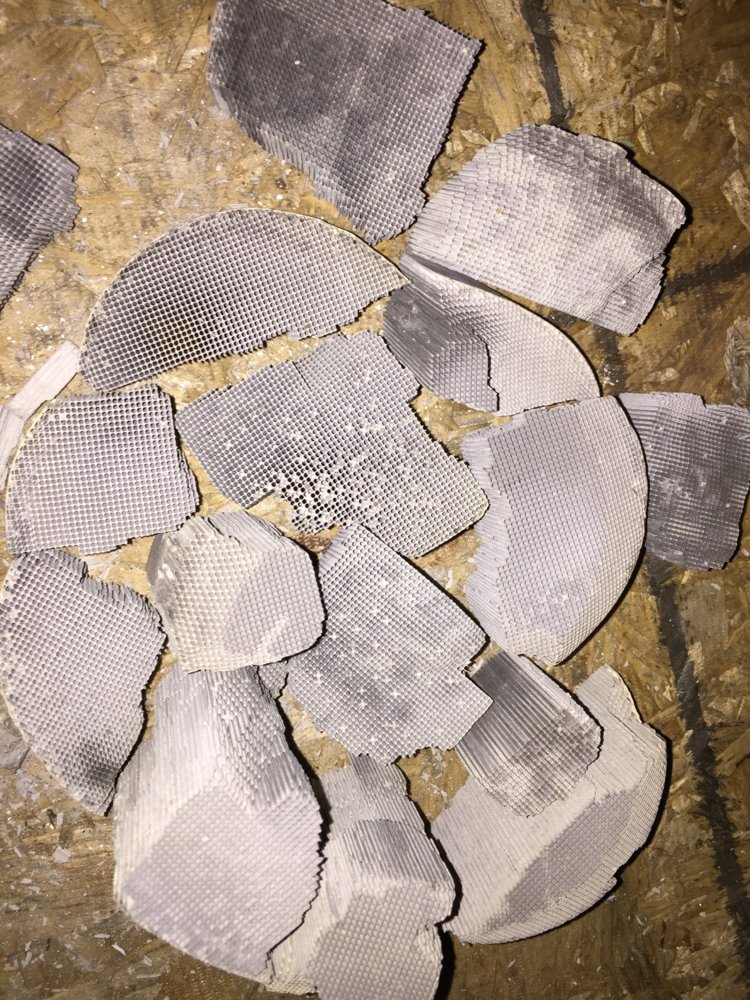

This is actually what was happening...
so that def fixed my slow ass acceleration through 1,2 gears and on hills it now down shifts and I’m not passin over 2500rpm to run 55/60 on big inclines. It’s still not got that 350 push ya back feeling unless I’m past 2nd gear tho but 4.10 gears makes diff, in 4th and it drops to 3rd to pass and throws ya back a little but the trucks driving better than ever. Now to order two new cats and a muffler bc I can’t do this loud exhaust crap lol fuel pressure still alarming that I’m under 60 psi driving but I’ll work in that now since my main issue is solved!
You could always reuse the "resonators" you made with new mufflers & be g2g. There is a simple fix for p0420/0430 codes. If it's got any real high miles on it, the engine may consume oil and cause the same issue down the road.. also if it's running pig rich will cause premature failure as well.
